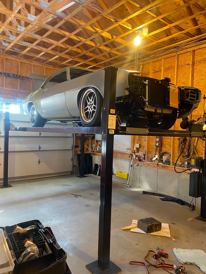

waynieZ 03-21-2021 08:06 PM
First time with the car up on the lift Smooooooth!
https://hosting.photobucket.com/imag...4/IMG_2614.JPG
I'm giddy like a school girl!

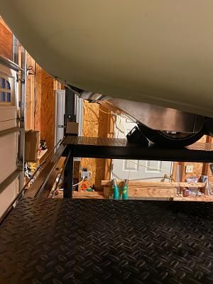

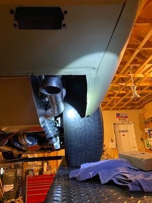

Since I got my Michelin Tires 345-30-19 I've been wanting to test fit. Mike at MCC built the rear and said it would be tight, Well he did an awesome job they fit with plenty of room. I worried they might be trouble, but today the car went to the guy who's doing the Chicane kit. He's also doing the exhaust so he needed the tire to make sure the tail pipe would clear. When I got to his place I asked him to try it while I was there, to either let me know I was all set or if I needed an antacid for the gut ache I would have if it was too tight. What a relief the ant acid stays in the cabinet!
Here are some pictures of them in the car.
https://hosting.photobucket.com/imag...720&fit=bounds
I could fit my hand between the tire and the fender as far as my knuckles. He's also going to weld the DSE frame connector brackets to the sub, they'll bolt to the connector.

ErikLS2 05-05-2021 11:21 AM
Quick question, is that the standard DSE mini-tub kit and directions that those tires fit into or did you do something extra?
waynieZ 05-05-2021 05:12 PM
My car rebuild was done by Mike’s custom Cars he did the DSE mini tubs the way they instruct you to do. He had me order the wheels and built the rear to what he figured from having the wheels. He got it perfect. I haven’t trimmed the wheel well lip and it looks good to go. If I lower the car I’ll have to check again to make sure.
dhutton 05-06-2021 04:30 AM
Hi Wayne. How much clearance do you have to the inner wheel housing?
Don

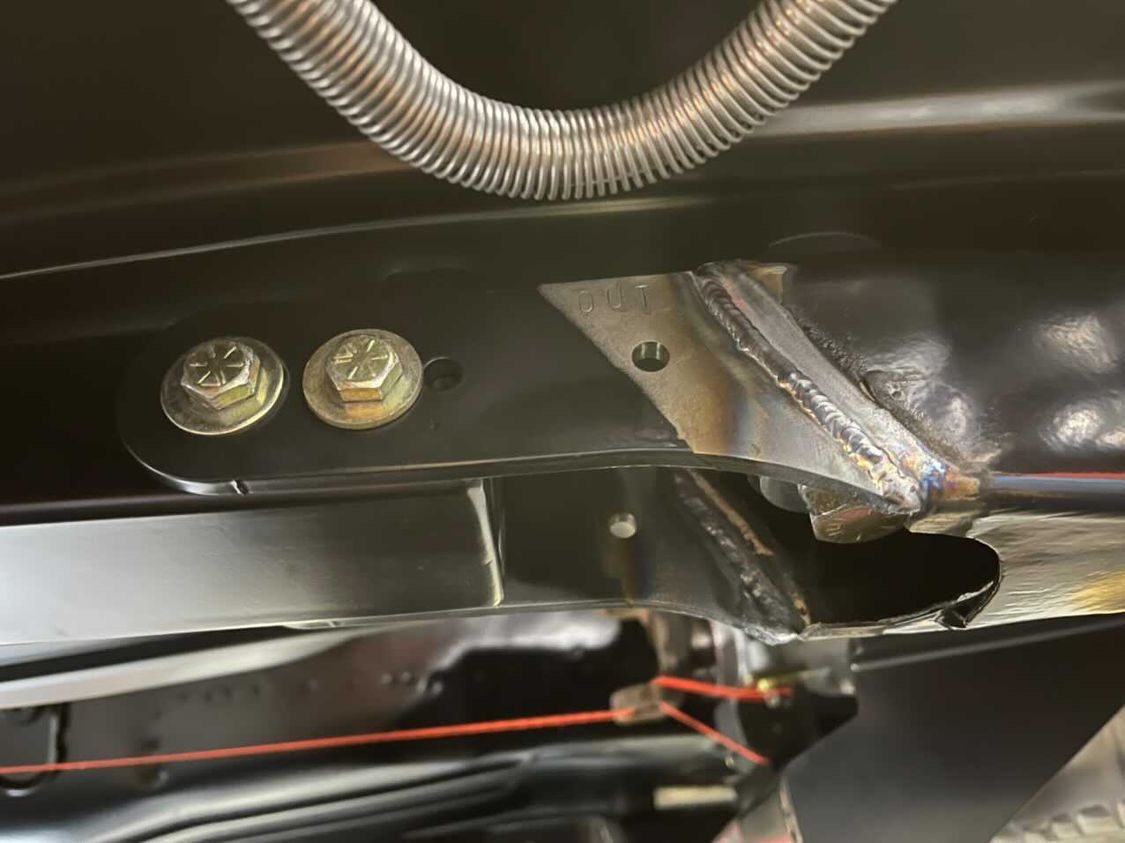

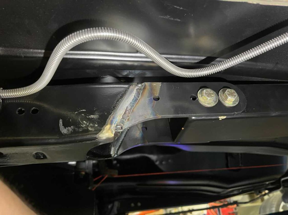

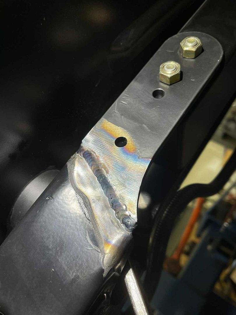

I got some pictures of the frame connector brackets welded to the sub.
https://hosting.photobucket.com/imag...080&fit=bounds
He has more welding and then dress them up
waynieZ 05-14-2021 07:35 PM
Don
Hi Don here is a picture of the distance from the frame to the tire.
The welder @akuma.fab said the distance was about 3/4" at that spot of the picture and up above at the closest is 1/2".

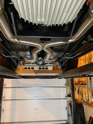

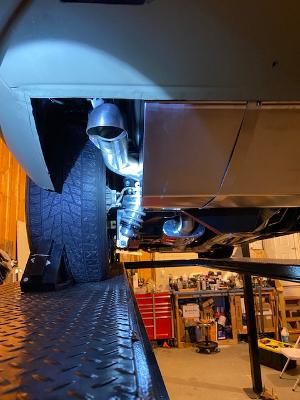

I just got some pictures of the work on the exhaust, he made an X pipe to fit around the 4l85. Here's a few pictures.
Here are a few pictures of it where it's going on the car.
This has me concerned. I'm planning to have the exhaust coated, I don't think they can do anything for the the flex coupler. I'm going to make a heat shield if there's room, I'll also put heat shield over the trans cable.
Some of his TIG work.

Vegas69 06-06-2021 10:08 PM
The X pipe fabrication looks top notch, but it appears to neck the exhaust down to basically single exhaust.
214Chevy 06-07-2021 03:29 PM
Beautiful Wayne...
waynieZ 06-08-2021 02:14 PM
I talked to him today and he offered to do it over on his dime, it ended up being a little over 3" so I told him to change it. Thanks

waynieZ 11-18-2021 07:38 PM

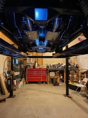

Here's some shots of the exhaust completed.

Wow, does the exhaust look incredible !
