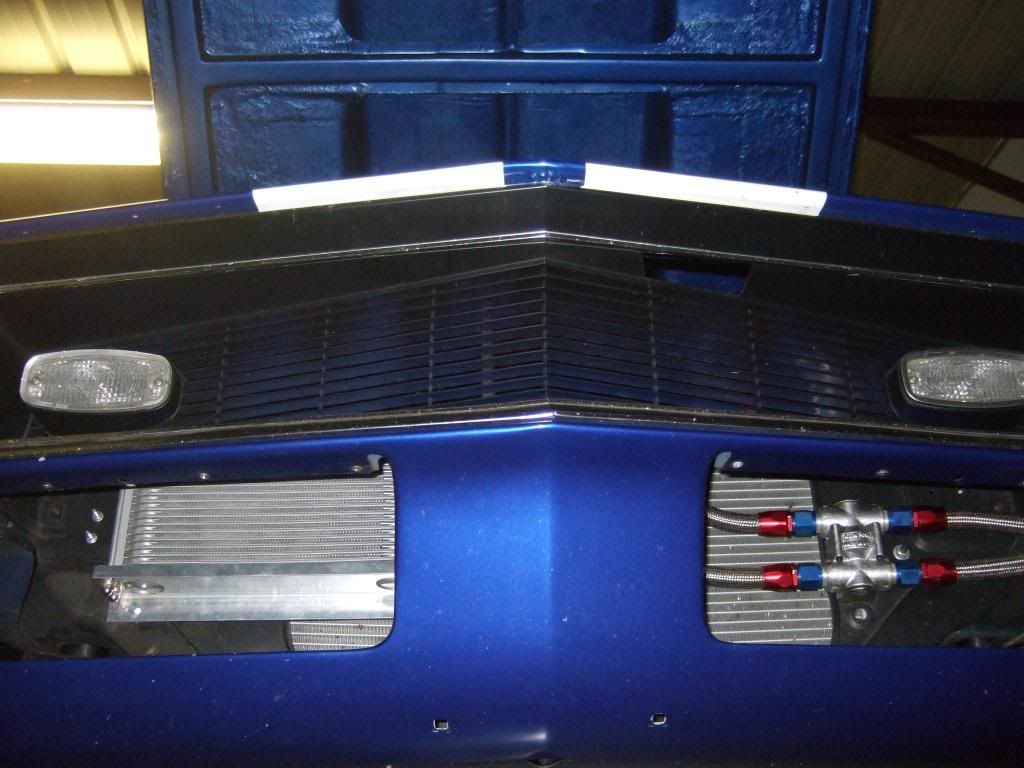

Good question. Sure there will be some more heat, but I have an aftermarket block now that should provide improved cooling and my radiator is a decent one that should handle the load. We are convinced the overheating issue at RTTC was a direct result of the prolonged detonation sustained. I really should have mixed race gas in the tank for protection and I will never do an event without throwing some in there in the future. It's fairly cheap protection but nice to not require it when street driving or even an autoX event I figure.
The oil cooling system seemed to be working and again until the detonation presented itself, thats when water and oil temps shot up. I recall I have read there may be a slight aid in oil cooling from the Accusump? Not sure if that's true or how significant that could be though.
So I hope no changes needed in this department. Thanks for asking.

Oh, oil cooler was already done last year. Decent sized Earl's piece with -10An lines and the Mocal 180* thermostat.
http://i236.photobucket.com/albums/f...8/DSCF3717.jpg

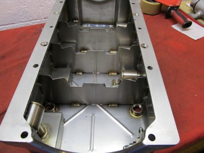

Yeah the take off Nascar pans are what I was looking at. They are all deep. 6" or deeper. That ain't workin with my clearance. I found some killer pans for great prices but just wasn't ready for it.
Yes the pickup points is an apples to oranges vs wet sump, but when I explained my goals/intentions with the car I was told a typical Nascar pan with pickup locations was not ideal, but they probably would be okay. I would want to be more than "probably okay". :D I was going to just have them add or relocate one of the pickups. Not a huge cost and still way cheaper than buying a brand new custom pan at over $1000.

1 - I looked for countless pans. I bet I am second to none in hours spent scouring for good used parts. Seriously, I am a legend in that department. :lol:
2 - The nice used pans I was finding for $250-350 sell for over $1000 new. They are amazing quality. Here is an example of one made by Weiss and it is top notch (verified by their competitor who I called. LOL)
http://i236.photobucket.com/albums/f...h68/A43006.jpg

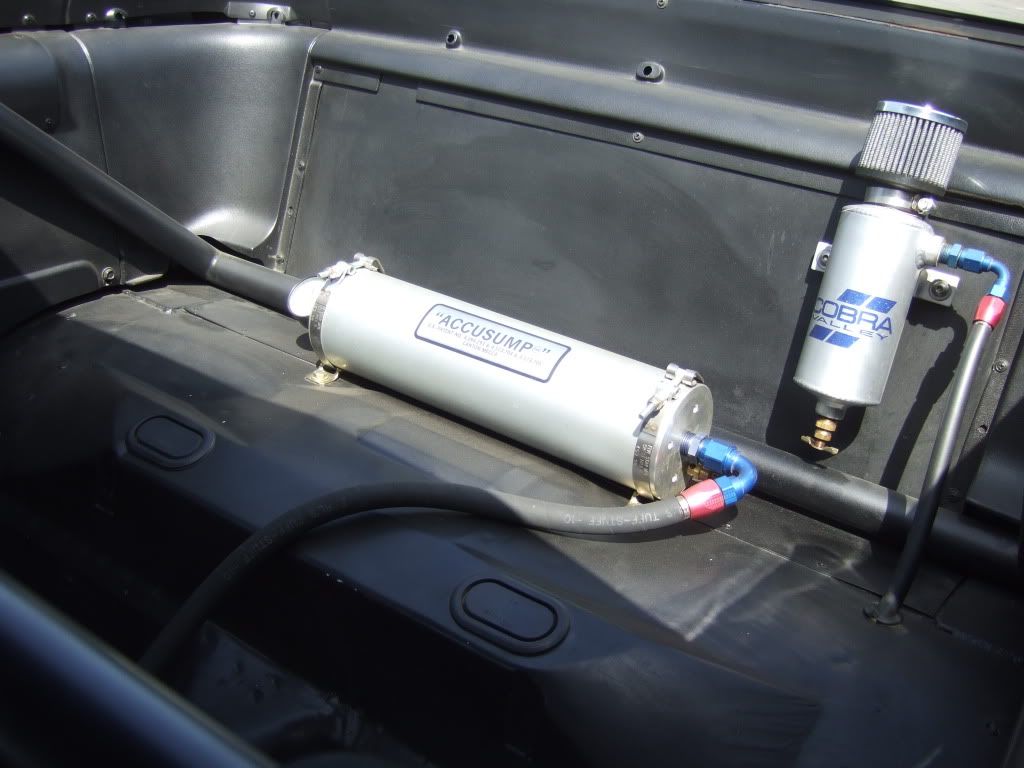

I'm debating where to mount my Accusump right now. I like where Weld's is mounted but I don't like oil and fuel in the passenger compartment. Still I'm considering it, or possibly right behind the rear firewall.
http://i236.photobucket.com/albums/f...8/DSCF4033.jpg
I read about LS guys on the Corvette Forum running their oil temps up to near 300 all the time, ideally not sustained, but still most of them don't seem to care too much.
When I am up to temp on the street and track, water is 180-190 and oil is 220-240. Right where it should be ideally and where it is for Gaetano and that's who I mimicked my system after. He has the same Stat and a Setrab cooler.
I at first was worried this system did not perform well enough but after the motor revealed serious detonation that seems to explain the issue. I was not having temp issues until about 3rd lap of the 2 sessions that went bad. Very bad. :willy:

Accusump location is a no brainer. Bottom back side of radiator support area. Thats where mine would go. Most likely fab something to attach Accusump straps/clamps to subframe cross member.
Flash68 05-05-2012 05:59 PM
Would go or will go?
That's one location I'm considering, but I have a PS steering cooler there (not a huge deal to relocate) and more importantly is more weight in the area I don't want more weight.
Chris Robinson has his mounted in front of his fuel tank on his 69.
intocarss 05-05-2012 06:21 PM
On Bob's 69 drag Camaro. I made a alum bracket and mounted it in front of the radiator up as high as I could go. I did have to mod the hood latch bracket some. I also put an on/off lever inline... off while going up to staging then turn it on just before you pull out to the track
