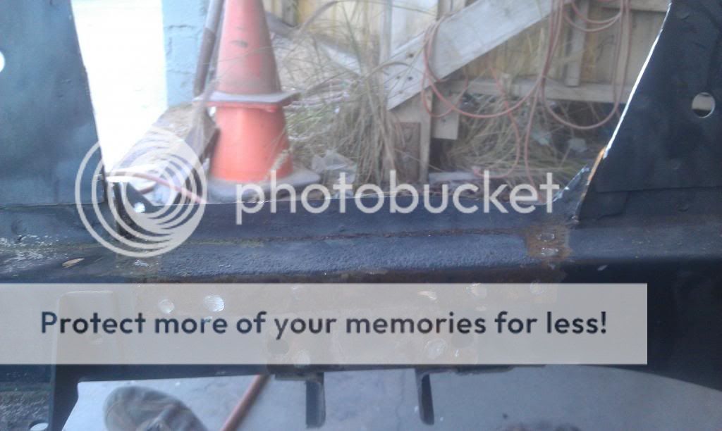

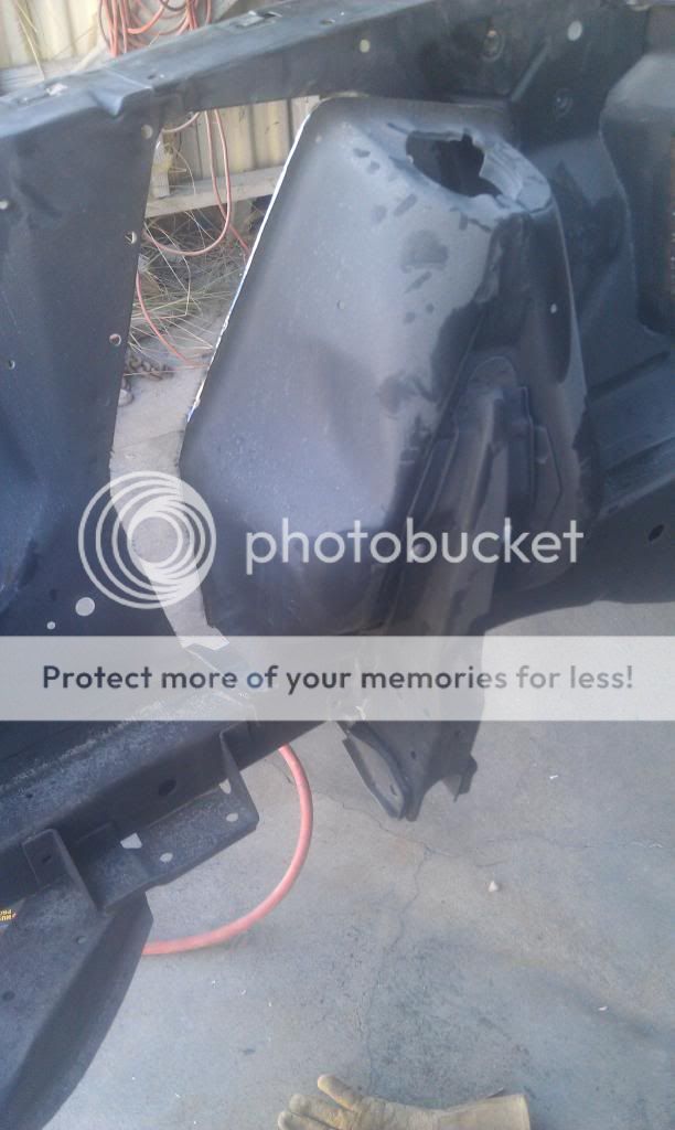

The first thing I did was cut out the original shock towers per DSE's instructions.Don't bother with the spot welds, just cut along the separation between the shock tower and inner fender.

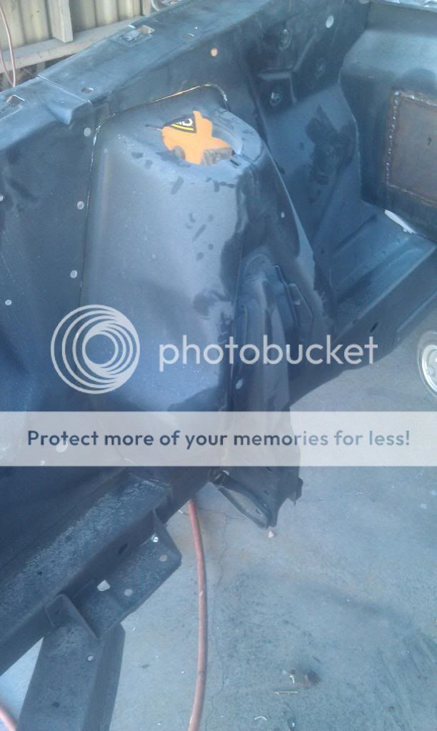

Once the big piece is out, drill (or my preference - grind) out all of the spot welds on the remaining little pieces so that you are left with bare frame rails.

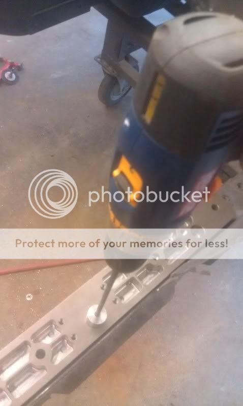

There will be one bolt hole underneath the frame rails boxed in by a stamped piece of metal. Per DSE's instructions this piece stays. These bolt holes serve to locate the aluminum cradle during mock up. Depending on your car, you may need to deviate from their instructions a little to cut out an embossed bump around the bolt hole.

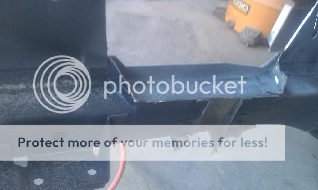

Once the cradle is mocked up, check the car front to back, and diagonally to make sure that everything is square.

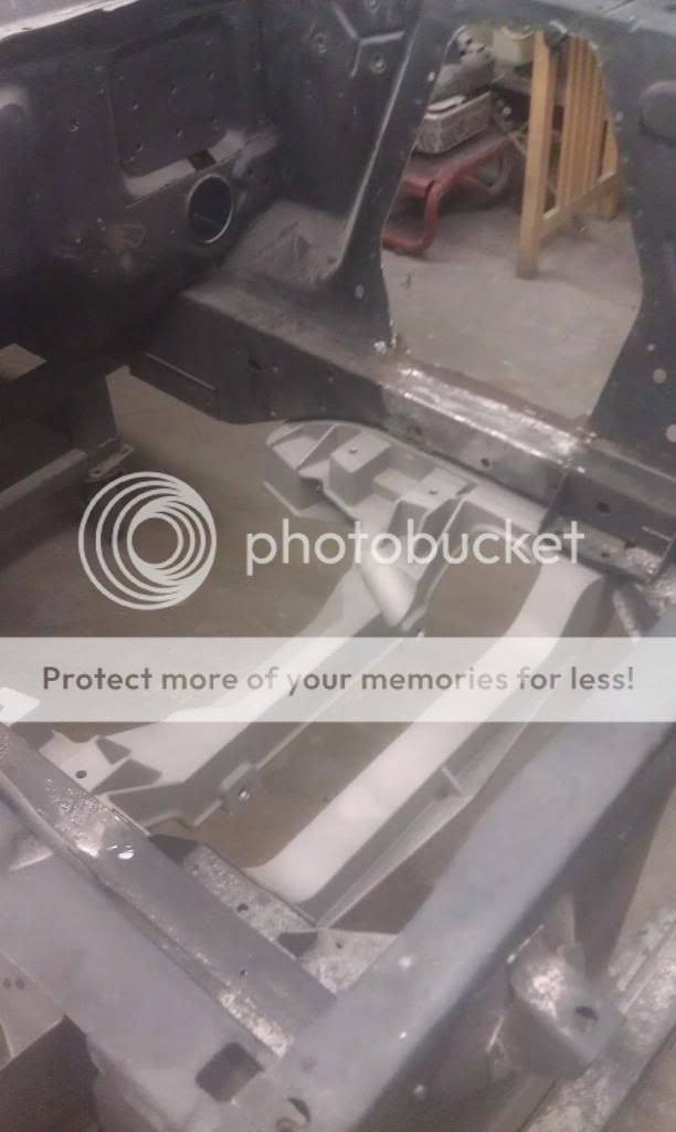

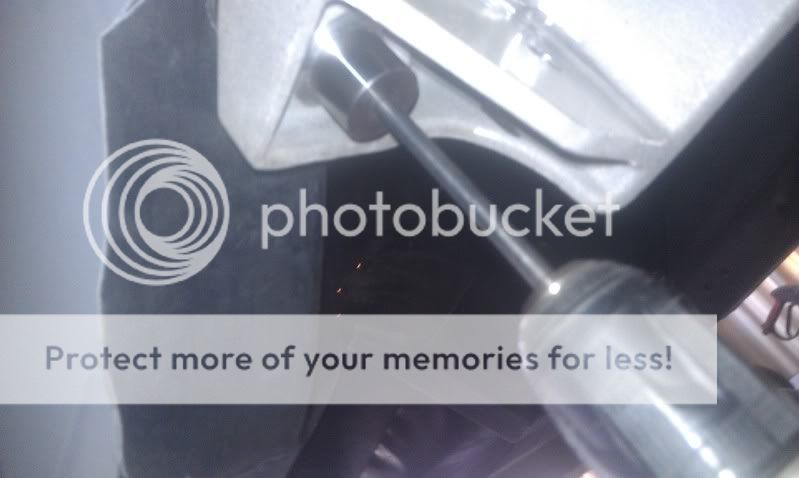

After squaring it up, the real fun begins. The next step involves installing the steel crush sleeves and adapter brackets to bolt the upper control arm and shock mounts onto the frame rails. You will need to locate where to drill the holes from underneath the car with the cradle bolted up. After marking your spots, break out the hole saws and go to town underneath the car. DSE now provides an alignment pin tool for drilling, and I would recommend using that to help locate your first holes, as opposed to a punch (It wasn't shown in their install video, and it showed up after everything else). After drilling holes for the four primary crush sleeves, test fit everything, check that it is square, and locate the hole for the shock mount on the steel adapter plate.

Drill that out with a hole saw, then bolt everything else back up. Now transfer the hole to the bottom.
http://i366.photobucket.com/albums/o...A/IMAG0806.jpg
That is it for pictures today. The next step is welding the adapter plates on and fitting the go fast parts up.
