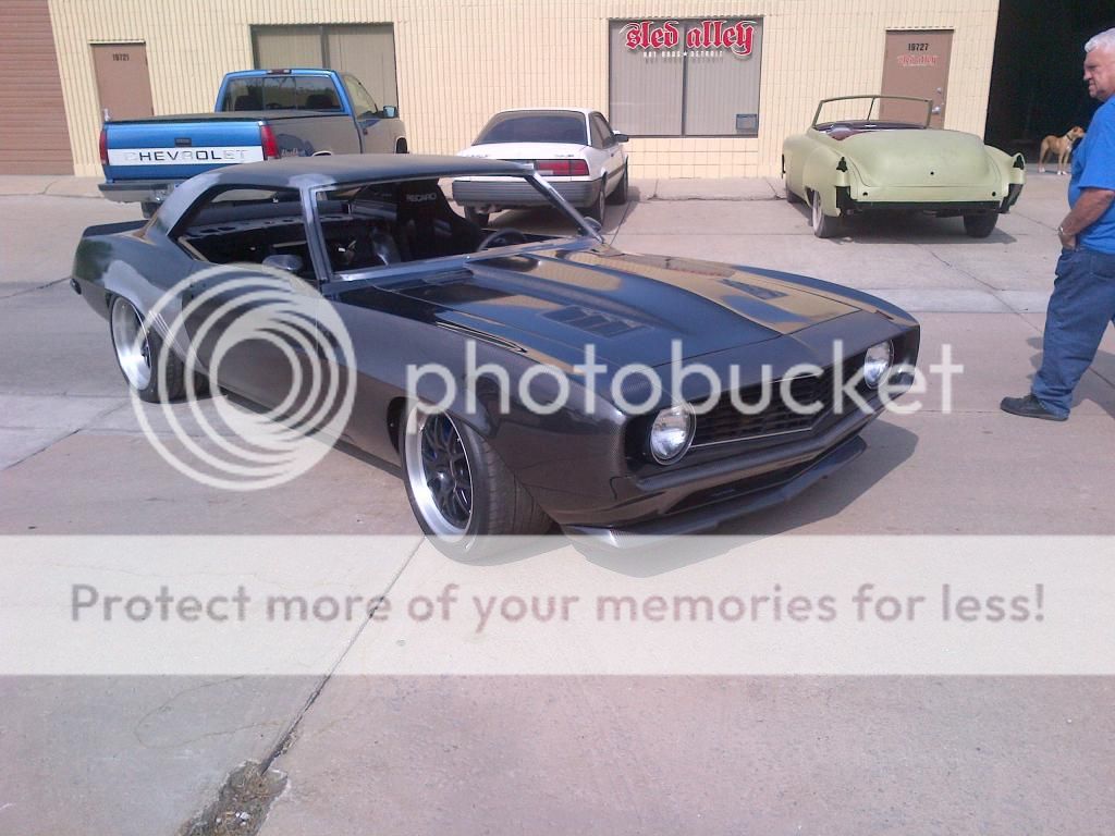

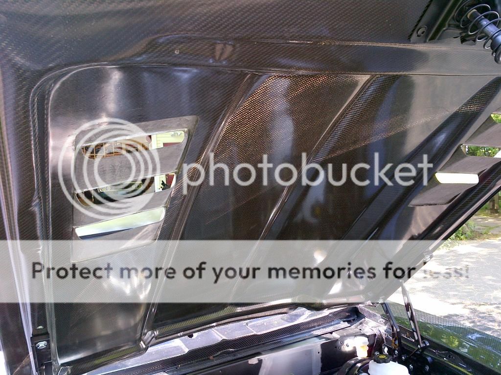

Guys a couple updates. I had my car together at my car party so a couple shots of the car.
http://i439.photobucket.com/albums/q...ps1af7e669.jpg
http://i439.photobucket.com/albums/q...psea0a5f1e.jpg
http://i439.photobucket.com/albums/q...ps04af887e.jpg
http://i439.photobucket.com/albums/q...psc90ce8ac.jpg
Mark

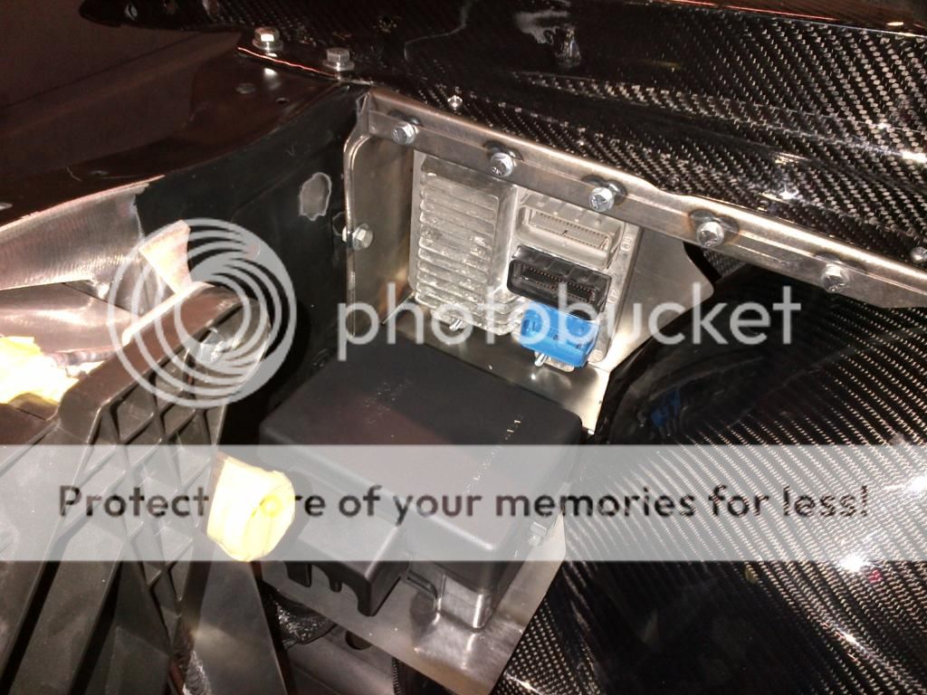

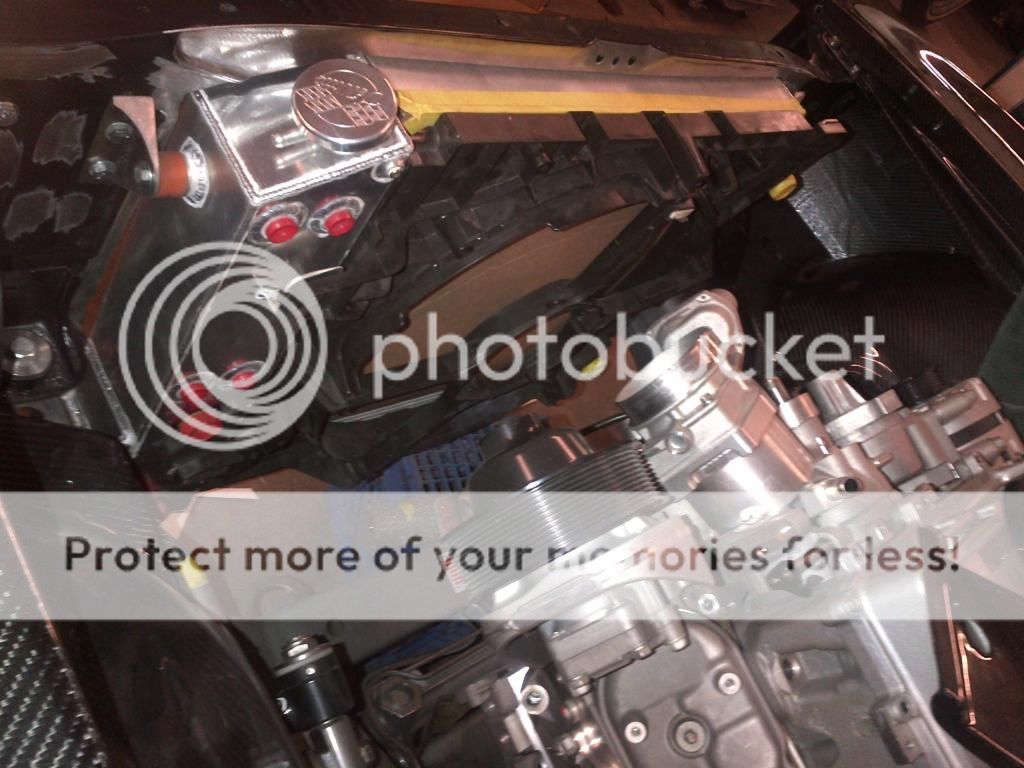

We have the Cooling "stack" in the car and the ECM and BCM mounted.
http://i439.photobucket.com/albums/q...ps88bab659.jpg
http://i439.photobucket.com/albums/q...ps15f40cf8.jpg
http://i439.photobucket.com/albums/q...ps224057ee.jpg
I have learned put the ECM and BCM (Fuse Block) where you can get to them easy.
http://i439.photobucket.com/albums/q...ps7cda2c73.jpg
Start of the inlet tube. It will flare from 4" to 4 3/4"
http://i439.photobucket.com/albums/q...ps59d12966.jpg
Mark
tubbed69 07-06-2013 06:49 PM
Mark great work as always,sure has a nice stance
Flash68 07-06-2013 06:51 PM
Wider tires and stance look killer.
Do you know the front and rear new track width by chance Mark?
fleet 07-06-2013 07:03 PM
Mark,
It appears lower than some of your other Camaros.
Is it, or will it be?
Sieg 07-06-2013 07:11 PM
Really like the front bodywork, the styling below the headlights is very clean, including the fender to lower cowl junction.
Have you designed a bumper bar behind the carbon yet? Alloy or CM?
Good Work Mr. Stielow :thumbsup:
