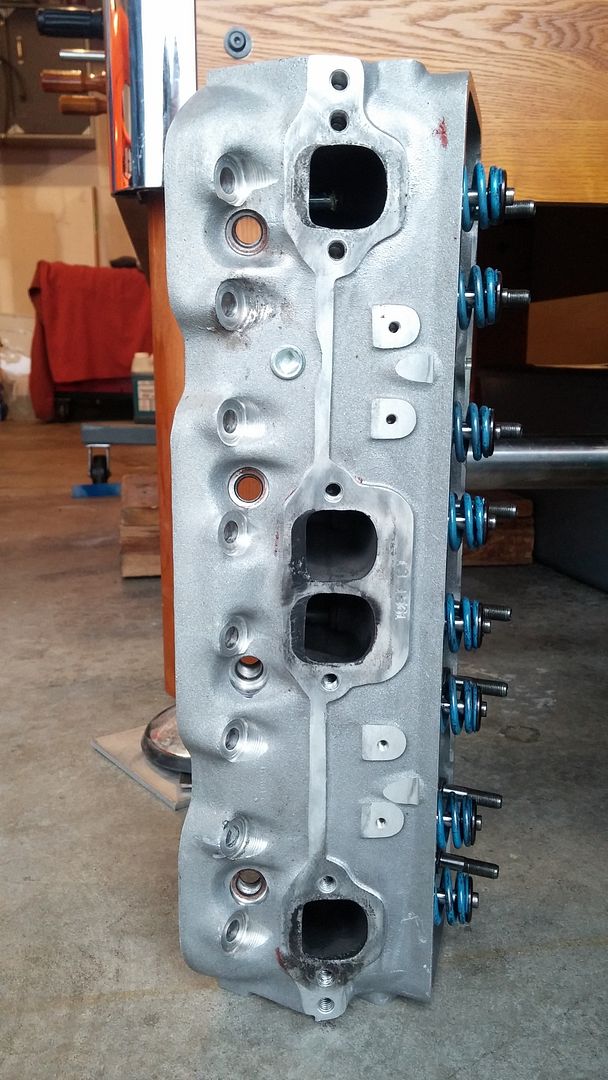

So a new phase of upgrades has officially started. I finally decided to crack the seal on the crate engine and upgrade the heads and cam in an effort to keep up with the LS powered cars I race against on the straights. I plan on doing more road course events from now on and less autoocross so this was a necessary upgrade and actually makes more sense than upgrading the rear suspension, wheels and tires just to try to keep up with all of the autocross specific CAM cars coming out of the woodwork.
I picked up the top end from a blown up 604 crate engine from a local racer, a set of worked over fastburn heads, 1.5 roller rockers, the 604 cam and a single plane intake. I had our local speed shop do a valve job on the heads since a few of the valves had been hit, ended up replacing three of them, all of the springs were checked and all of the valves were lapped in again.
I'm going to custom order a cam Monday to meet my needs and will reuse my dual plane intake, Q-jet, and MSD and just about everything else. Only thing I'm really swapping out is the heads and cam...but those alone should bump me about 100 hp in all the right spots with only giving up just a scant bit of torque way down low (built in traction control).

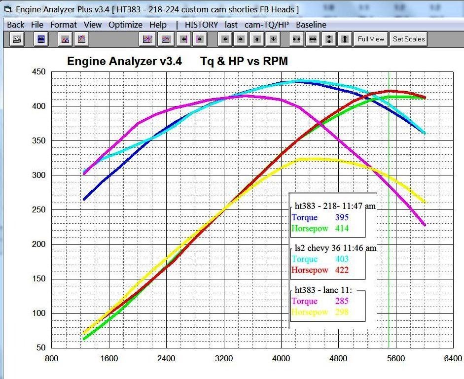

In the next day or so I'll start to tear this apart...
http://img.photobucket.com/albums/v3...psfkjy5kaj.jpg
and get ready to put these heads to good use.
http://img.photobucket.com/albums/v3...psug00kxe0.jpg
http://img.photobucket.com/albums/v3...pswlxbqq8b.jpg
http://img.photobucket.com/albums/v3...psbav4n7ul.jpg
Purple and yellow is my current engine, Dark blue and Green is what we are shooting for power wise and lite blue and red are a stock LS2 like I'll be racing against.
http://img.photobucket.com/albums/v3...psszoomcdi.jpg
