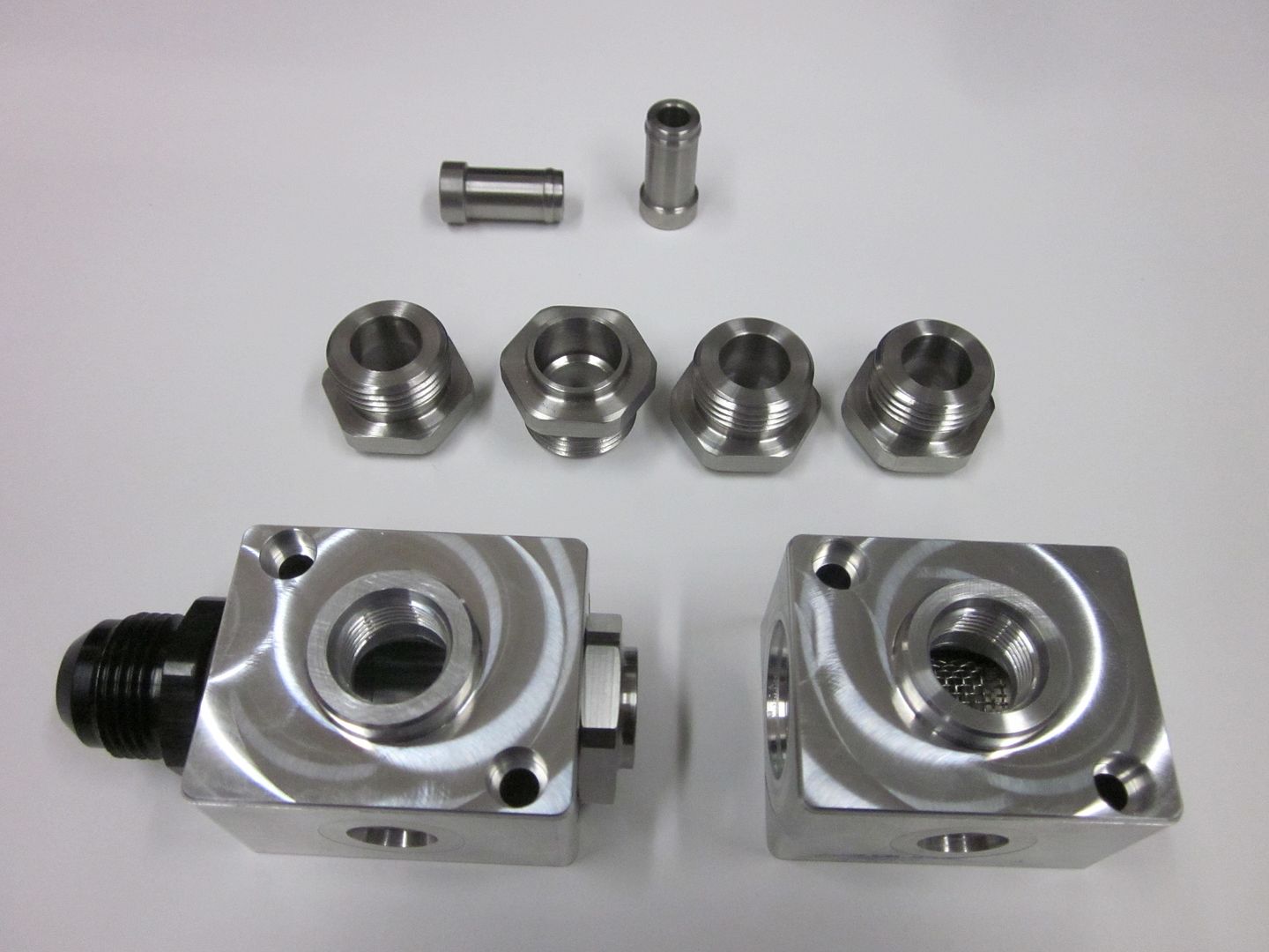

Machine shop just finished these pcs...
Dry sump oil tank distribution block it feeds oil to engine, it holds mesh filter, oil drain, & will be able to mount oil temp sensor.. & a few fittings to weld 3/4 stainless tubing..
Plus 1/2 barb fitting to weld to 3/8 tubing for the back of the intake for booster vaccum..

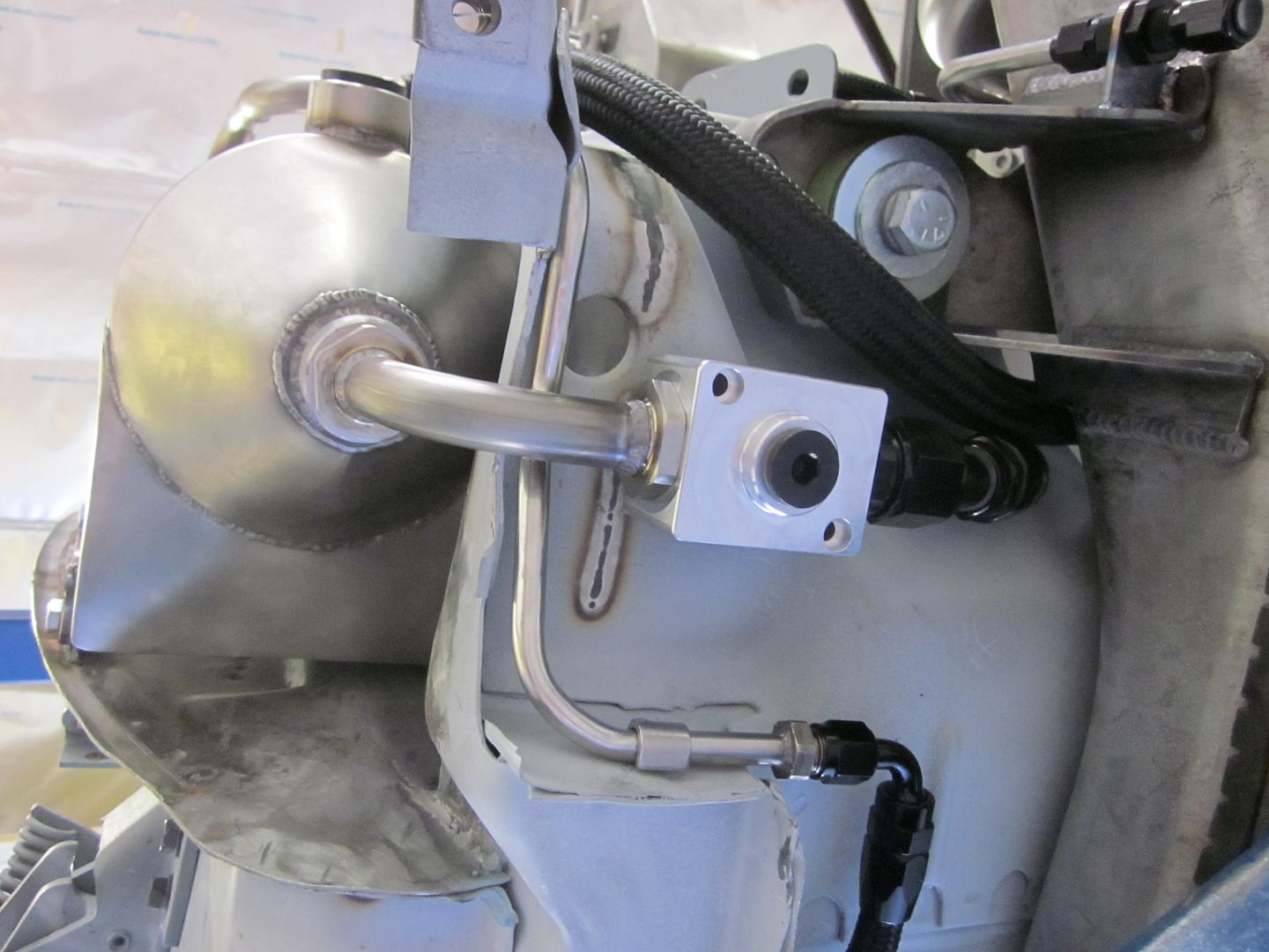

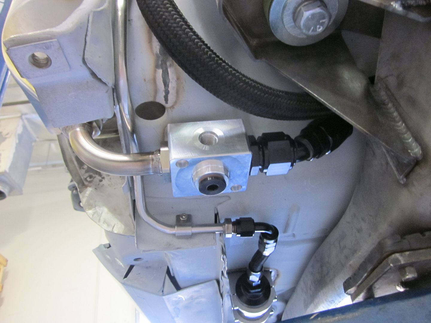

And here is the idea of where it will be mounted..
http://i1015.photobucket.com/albums/...n/IMG_1300.jpg
http://i1015.photobucket.com/albums/...n/IMG_1301.jpg
ErikLS2 06-28-2011 07:18 PM
Cris who makes that black hose and those fittings and is it a Teflon inner or CPE? Nice plumbing work too BTW.
Cris@JCG 06-29-2011 07:38 AM
WE are using XRP fittings.. they have a great assortment fitting available.. The hose you see in the pic is not the one we are using.. We will be changing it over to XR-31 hose that has a flat wound internal support coil.. That hose will be used for the dry sump & oil cooler lines..
