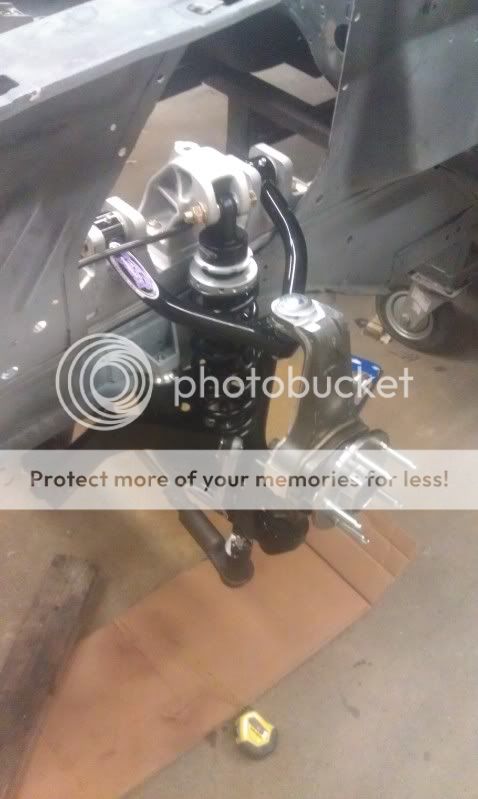

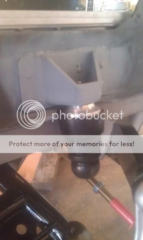

Ok, I think I left off the alum-frame install after I got the adapter brackets fit. From there you just weld them on. I forgot to take a picture of that part. Then it is pretty simple, you put the lower control arms on, figure out where to weld the bump stops, here:
http://i366.photobucket.com/albums/o...A/IMAG0811.jpg

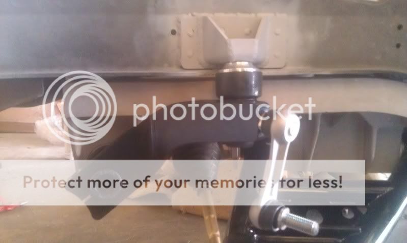

after that, put the rack and the anti-roll bar on. The best way to eyeball that the end links are even is the get them level, and parallel with the frame.
http://i366.photobucket.com/albums/o...A/IMAG0810.jpg

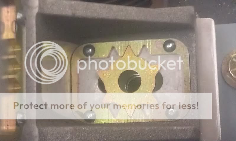

then you install a pair of aluminum shims on the steel adapter plates. The upper control arm mounts bolt on top of the two aluminum shim plates. Here is a shot of the cool speed-lign adjusters for caster.
http://i366.photobucket.com/albums/o...A/IMAG0813.jpg
Bolt the shock mounts, shocks, upper control arms, and spindles in place and you're just about good to go!
