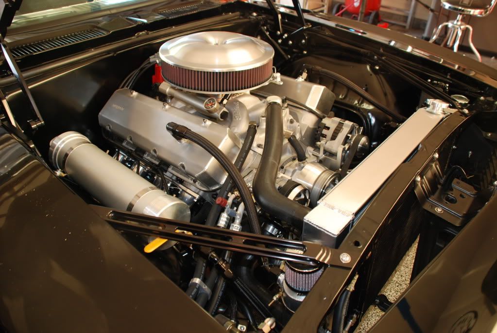

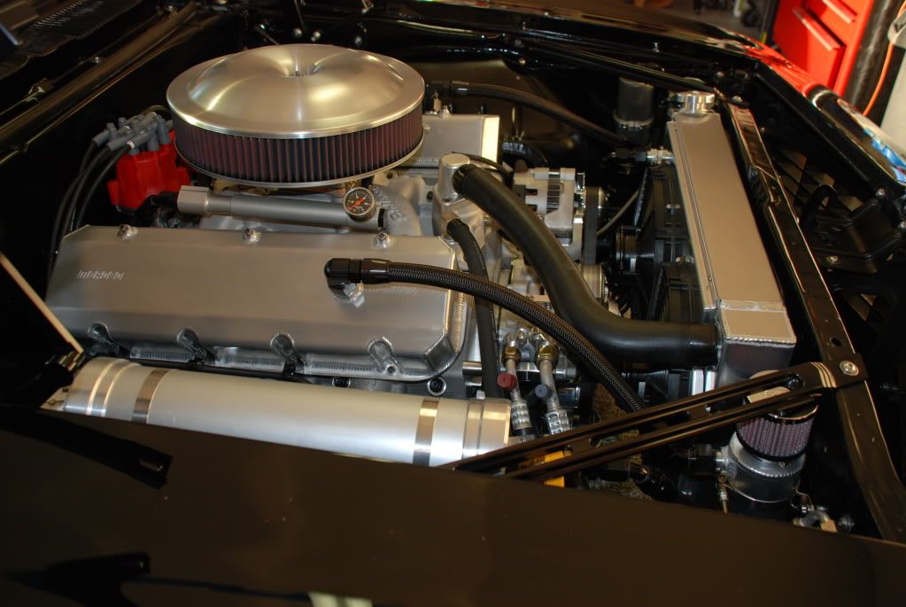

Most of you know I've spent many many late nights and afternoons away from work trying to get my car back on the road. It's been almost 4 months since I pulled the old engine out! While swapping engine sounds simple, I can't make anything simple. I can't leave anything alone either. I'm to the point now where I'm doing over before it ever leaves the garage. If I don't like it, I start over. Anyway, here's a list of the changes I made.
  • Aluminum block and all that entailed:willy:
    Oil cooler and all the plumbing
    Cooling system to dual pass with internal heat exchanger
    A/C
    Heat
    Custom condensor brackets
    Made all my own AC and heater hoses
    Re routing two wiring harnesses underneath
    Adding weatherpak connectors all over the place
    Rear sway bar with custom designed brackets and hardware
    Custom coil bracket
    Brushed valve covers
    Custom water recirc tank bracket
    Brushed all A/C/Heat fitting
    Added dual breather tanks and brushed them
    Different valve covers
    Re routed fuel lines to come in from the rear and take all 90's out at regulator
    Jet extensions
    Recoated headers
    Changed gates clamps
    Brushed the air cleaner lid(Took two ) lol
    And about 50 more I can't remember

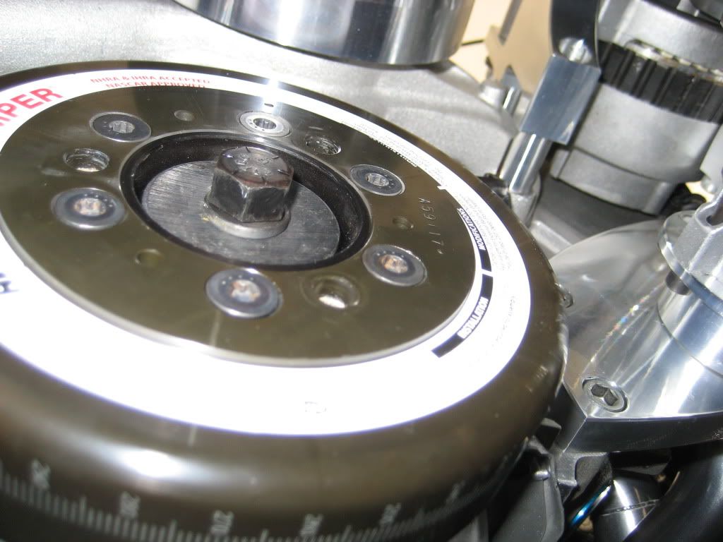

I fired her up around 4 or so. I had the timing light ready but noticed the crank pulley was wobbling badly. I couldn't of left it loose. So off comes the belt and it turns out that a couple bolts that hold the ATI balancer together were sticking out maybe .015 of an inch. I had some brake caliper shims handy and put them between the pulley and balancer and it's perfect. Once I had that fixed I cranked the idle up to about 2k and set the timing consservative. Then the cooling system belched and I topped it off. Dialed the idle down and had a 3"x3" oil puddle after about 15-20 minutes. It's leaking between my one way valve and 45. I loosened and retightened and it still leaks. Brand new earls stuff. I'll get it figured out. Other than that it sounds great. :thumbsup: The oil coolant temp was about 185 hot and the oil temp was 190. The heat exchanger is working perfectly.

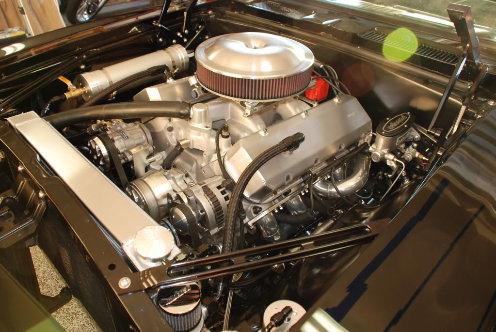

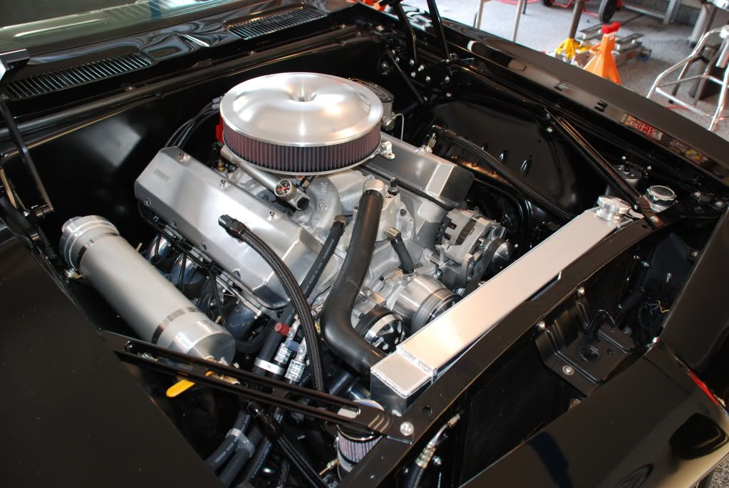

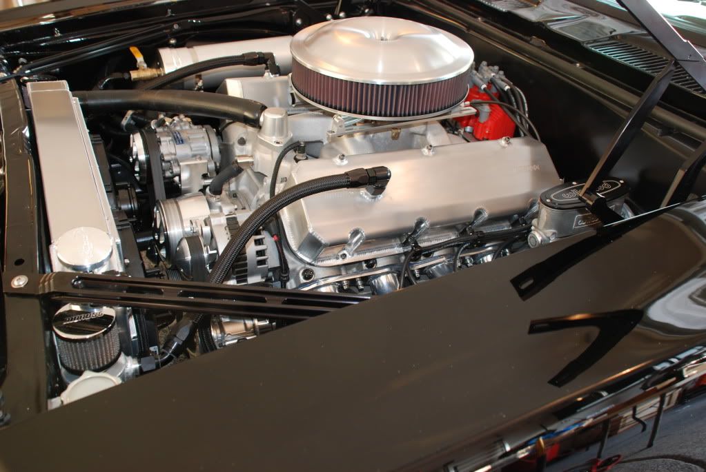

While the engine compartment is brand new I took the chance to shoot some photos. I'll post the old engine compartment last.

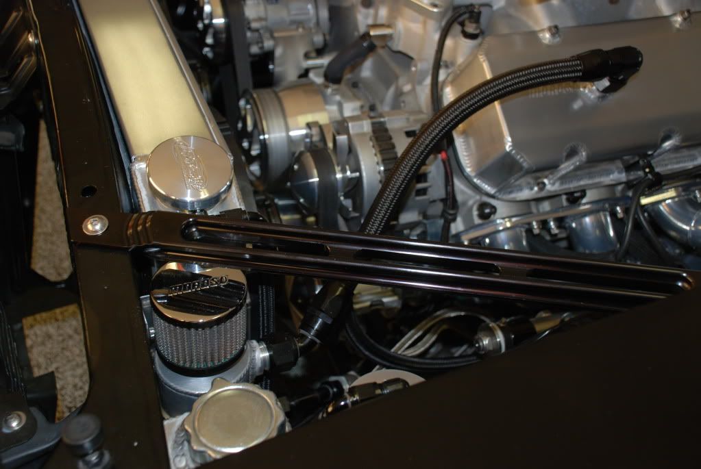

Remember the PM I sent the other day? So true! This is just awesome! Really nice work Todd. I really like the twin breather tanks and lines, nice touch.

Todd--it is beautiful man---that's the Schnizel for sure---love the breather lines---perfect blend of brushed aluminum and black hose/fittings. You did a great job. Can't wait to see it in 2 weeks bro. Let us know what you find on the oil leak.

WOW!! It's so tough to stuff that much crap under the hood and make it look good, but dude your engine bay looks sweet and sanitary!:thumbsup: I agree with the other guys your attention to details has stepped up. Good job, can't wait to hear how it drives.
Vegas69 03-20-2010 09:27 AM
You're not kidding Jack. That big block takes up a ton of Real Estate all by itself. It's a real jigsaw puzzle laying all the systems out and making them look good and most importantly, functional. Your car is the king of clean so I really appreciate the comment. :cheers:

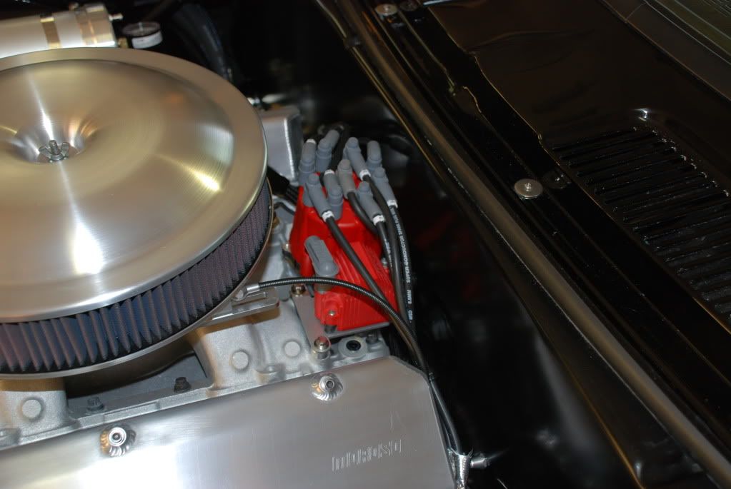

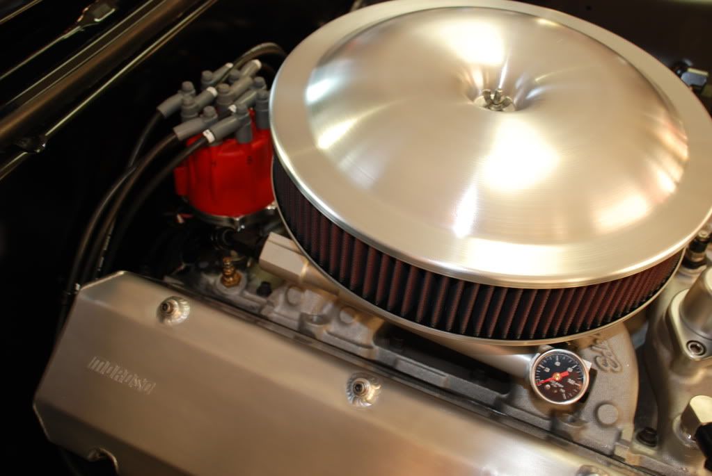

Awesome job Todd, you fit a lot of equipment in a tight space and made it look super clean. I love the way you handled all the hoses. When I get mine back your car will definately be one to study to help package mine. Great video too. How did you get the brushed finnish on the air cleaner so even did you mount it on a drill or something? It all looks great!
