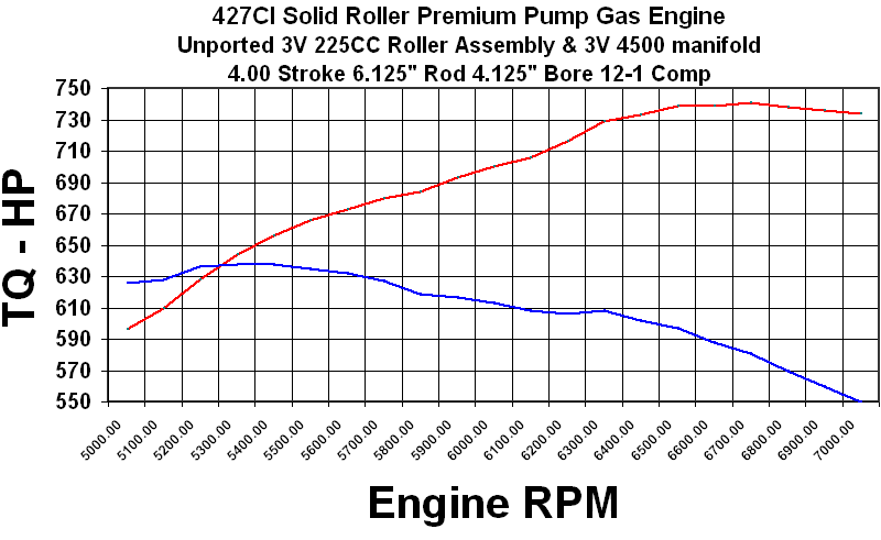

http://i291.photobucket.com/albums/l...nca/CHI427.gif

Originally Posted by FETorino (Post 413911)
Just a little SBF street mill.:unibrow:
Actually I think I've seen that dyno somewhere. Love it. But I didn't want that long stroke.
Gaetano's dyno should look like this since he has 427 cubes. :unibrow:
