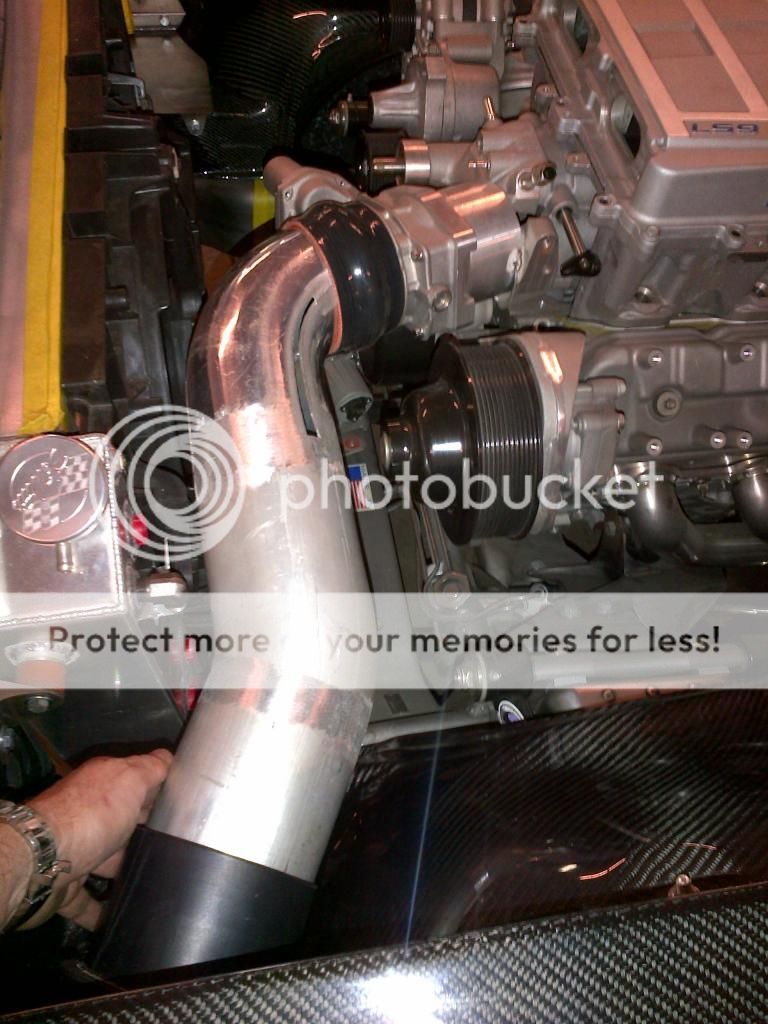

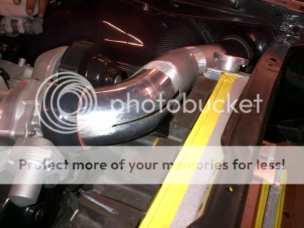

Matt at Sled Alley is doing a great job on the induction tube. It is 4" to 4.5" to 4.75" inch K&N MAF sensor. Going to a nice big 5 inch inlet K&N filter. We need a lot of air to make a lot of power.
http://i439.photobucket.com/albums/q...psb2a9ab11.jpg
http://i439.photobucket.com/albums/q...pse69fa9ad.jpg
Mark
