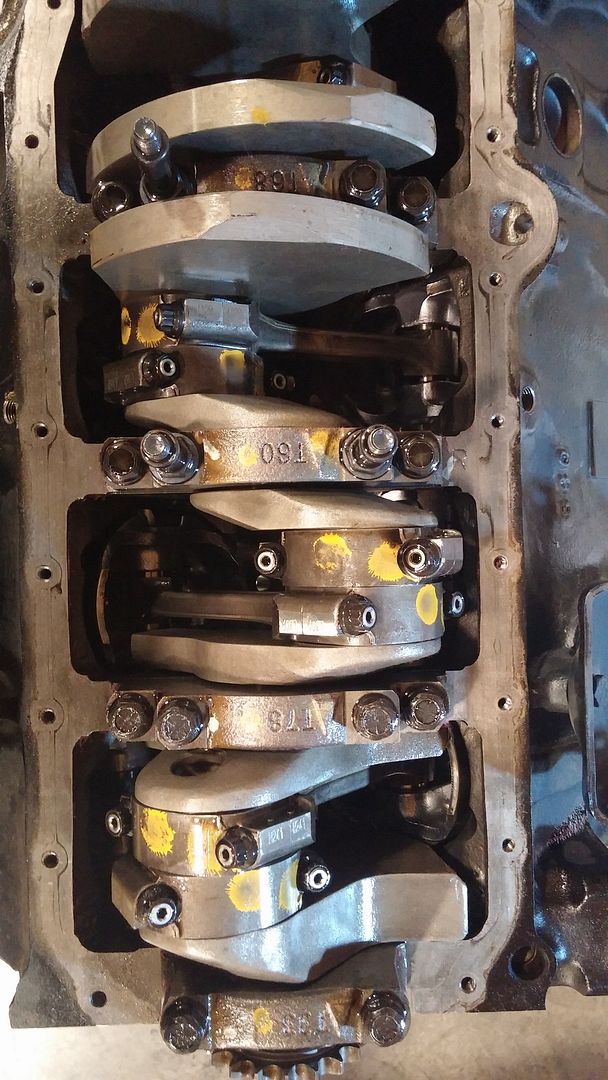

Rods, rod caps, and main caps are all marked with identifying marks (which have been recorded physically and photo documented.
http://img.photobucket.com/albums/v3...psh25ky3xp.jpg

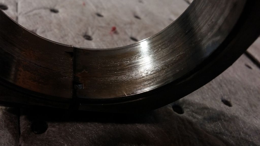

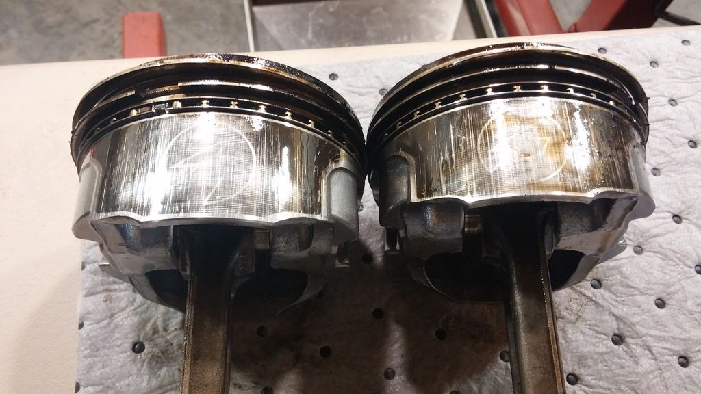

Pulled #1 and #2 piston
http://img.photobucket.com/albums/v3...pseberln2o.jpg
http://img.photobucket.com/albums/v3...pscw9kdruw.jpg
http://img.photobucket.com/albums/v3...ps5njcdbov.jpg
http://img.photobucket.com/albums/v3...ps454qru6r.jpg
Saw a bit more wear than I am comfortable putting back together...
I imagine that it would be okay...but considering the horsepower upgrade I'm adding and the abuse I'll be putting it through soon...I've decided to refresh it all. It's on the hook now waiting for the shop to let me know when I can bring it up.
GregWeld 01-02-2016 10:43 AM
Yeah -- Those bearings have lost their coating - next up - failure!
Good thinking on having it gone thru.
