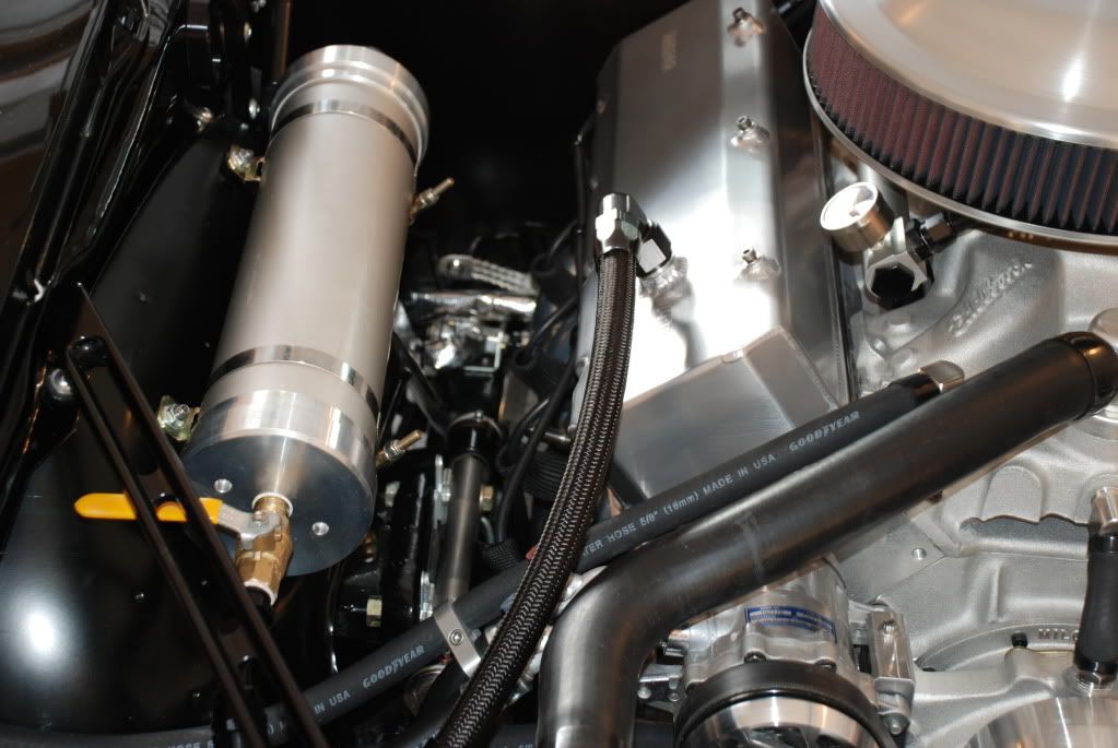

Originally Posted by Vegas69 (Post 276502)
What was the purpose of this canister again...may have missed it.
Aschle 03-20-2010 09:10 PM
I suggest an aluminum handle for the tank ball valve, likely will need to be fabbed. Brushed aluminum would look right at home, not the yellow...:D
The car looks GREAT !!!! :hail:
Jason
55Sedan 03-20-2010 10:20 PM
X infinity
Todd,
I hate to sound unoriginal, but the car is, well, beyond any words I am able to come up with right now.
I'd almost kill to see it in person.
Larry
Vegas69 03-21-2010 01:14 AM
LOL Larry, it's a nice car but I'd hate to see you sent up the river. :unibrow:
The canister is an accumulator. It holds 3 quarts of oil and is basically a cylinder with a piston. I start out by putting about 80psi of air in the gauge end and then bleed it off to 6psi. Once the engine is running it forces the piston all the way back to the gauge and if the engine loses oil pressure due to high g's the accumulator can supply up to 5 seconds of oil directly into the oil galleys. That's what the one way valve is for.(Causing my drip) I can also prime the engine by closing the valve with it running and opening it before the next start. It's probably over kill but it's to late now. :lol:

Neil B 03-22-2010 10:26 AM
Looks great! I'm curious where you mounted the fuel regulator.
Vegas69 03-22-2010 10:32 AM
It's in the corner of this photo. If I had it to do over again:D it would be under the car near the passenger foot panel. I used two 180 and one 45 fitting to make it work. At the time I wanted it as close to the carb but not mounted on the inner fender. :unibrow: It works great but it wasn't fun making it work with fittings. Seems easy now......
http://i200.photobucket.com/albums/a...toShoot043.jpg
Neil B 03-22-2010 11:28 AM
My eyes must be playing tricks on me. I see the fuel log with gauge and the fuel line coming in from the rear of the block, but I don't see the regulator.
Payton King 03-22-2010 11:36 AM
telll me how that works
I have the AX6's on all 4 corners for street and autocross. Was going to go more aggressive for the track, but if the 10's work up front and I can leave the AX6's in the rear, that would be a quick swap.
On a seperate note, the brushed aluminum really looks great against the black.
Vegas69 03-22-2010 12:04 PM
It's between the accumulator and and headers with heat wrap.
I'll let you know on the pads. I'm not sure I'll have the energy to put them on before my race Saturday since they won't be here until Friday and my folks will be in town. I will defiinitely have them on for the El Toro deal.
Neil B 03-22-2010 12:45 PM
Ah, I see it now. I'd love to see a close up of the fittings when you get time. It's hard to find a good spot for the regulator with the NHRA rule about no firewall mounting.

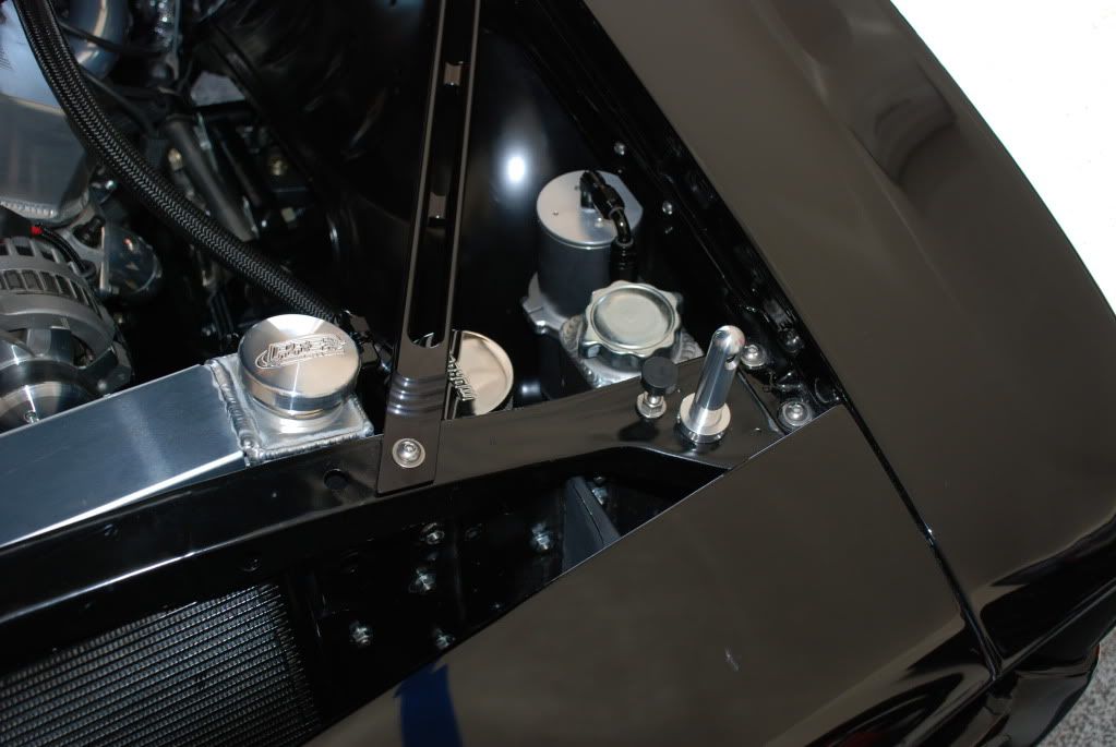

The interior is complete and vaccumed. I'm still waiting on my conical seal. Should have it tomorrow. I bought a set of Ring Brother hood pins about a week before I pulled the old engine. The car is done minus the conical seal so I spent a bunch of time getting the hood on as square as possible. It's the best it's ever been. Drilling 1 1/4 holes through my hood and radiator support was a blast. :unibrow: I decided to install the hood pin where the bump stop is factory. I then made my own bump stops out of stainless allen head button bolts and moved themat a 45 degree angle. Turned out sweet! :thumbsup: Last time I raced the hood popped and I don't want that happening again! Yep, that's a chip in the header panel. :thumbsup:
http://i200.photobucket.com/albums/a...oodPins008.jpg
http://i200.photobucket.com/albums/a...oodPins013.jpg
waynieZ 03-23-2010 07:31 PM
The hood pins look great , that hood won't be going anywhere. I love that radiator. I'd like one for mine but I would need to put it on a loooooong lay away payment plan. lol. I hope that seal comes in for you. Its got to be killing you to not be able to drive it yet.

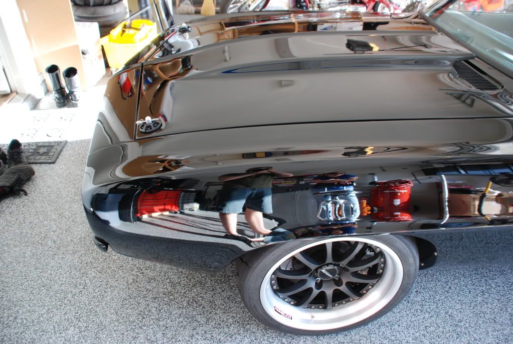

Originally Posted by Vegas69 (Post 277371)
First chip?? NOW it is a race car! :unibrow: The reflection looks like CalTrans... for every guy doing something there's at least one guy leaning on something else. :lol:
The car REALLY has turned out beautiful! I would love to be at El Toro to see it and all the other great machines but family must come first. And I have to ask, how many times over the years did you (if ever) screw something up before you got your fabrication skills to the point they are now? In my eyes you turn out the kind of work that comes out of the high dollar fab shops. "Where 'GOOD ENOUGH' isn't."
Larry
Vegas69 03-24-2010 10:11 AM
Larry, I'm no fabricator. I'm just decent at design, packaging, and making things work together. Parts like these Ring Bros hood pins and plates make me look great.
That chip happened with about 300 miles on the clock. It's go more than one.:D
