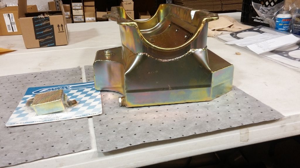

Greg, a 7 quart Canton 15-250T with appropriate pickup is already on the way to me (right Ron Sutton? :D )...this was ordered before I even started to disassemble the engine. https://www.cantonracingproducts.com...-1-PIECE-SEAL/
Probably also looking at an oil pump upgrade, don't need to get crazy here with a HV pump but an upgrade to a Melling 10552 seems like a prudent choice.
The idea is to do everything I can to help keep this engine alive given the abuse I plan on putting it through. A combination of parts and labor that all work well together without completely blowing the budget out of the water or compromising reliability.

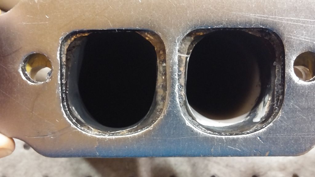

One issue that I knew I was going to have to deal with when changing to the fastburn heads was header fitment. It wasn't until yesterday when my fastburn specific header gaskets finally got here that I was able to determine exactly what I was going to have to change to use my headers with these heads.
The fastburn exhaust ports are raised approx 3/16"s vs regular SBC heads while the bolt holes appear to be in the same spot. This header gasket fits the exhaust port on the heads perfectly. Here it is up against my 1 5/8" header flange with the bolt holes lined up.
http://img.photobucket.com/albums/v3...psckrzsxrw.jpg
You can see how the top of the gasket is covering about 1/8-3/16" of the exhaust port. If the header was just bolted to the heads like this it would not only most likely leak like a siv but also kill the exhaust port flow.
Here is the header gasket lined up with the header tube openings.
http://img.photobucket.com/albums/v3...psaayifjxo.jpg
The header openings are large enough to cover the exhaust ports but the holes are going to have to be slotted to move the header up on the head. I have commissioned John to this task as I'm certain that I'd bugger it all up. :D
Opening the holes up shouldn't be that big of a deal but we want to fill in at least a couple of the holes on each side to give the header bolts something to sit against to keep them from sliding back down during or after install.
Since these are mid-length headers, raising the headers shouldn't cause me any other fitment issues on the car. If they were full long tubes I might be concerned about floor clearance or something like that but I don't think there will be any other issues.

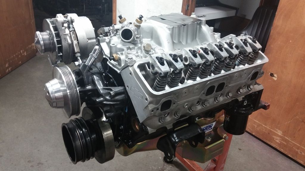

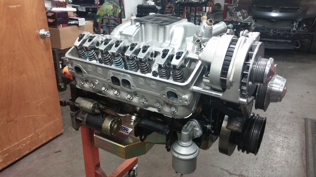

Not many pictures but I did get to visit my engine at the shop yesterday while delivering the rest of the parts for assembly. The machine work on the block is finished and the rotating assembly is installed. I dropped the cam and rest of the parts off and in the next day or so they'll finish up reassembly and prepare the engine for a dyno session.
One side of the block had a bad taper to the deck so he decked both sides to square it up, pistons now sit .0015 in the hole. The crank was 30 grams out of balance and that was cleaned up as well as a fresh plate hone and new rings and bearings installed.
This showed up the other day which hopefully along with a new oil pump will help with any future oil starvation issues.

Dyno day tomorrow...
http://img.photobucket.com/albums/v3...psrqfopsk6.jpg
http://img.photobucket.com/albums/v3...psntp2zidb.jpg
Still working on a few small issues, like the headers. We'll run the shop headers if I don't get mine ready but there is still a chance. Also want to change up the valve covers a bit now that I have heads that will take a perimeter bolt set. Again, this won't stop us from running it on the dyno.
