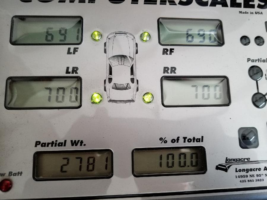

Ron Sutton 06-29-2018 12:36 PM
This scale numbers are complete with driver weight, fuel, etc. But once the car gets wrapped, interior sealed, exhaust coated & chassis & sheet metal power coated, the total weight will be around 2840+/-
