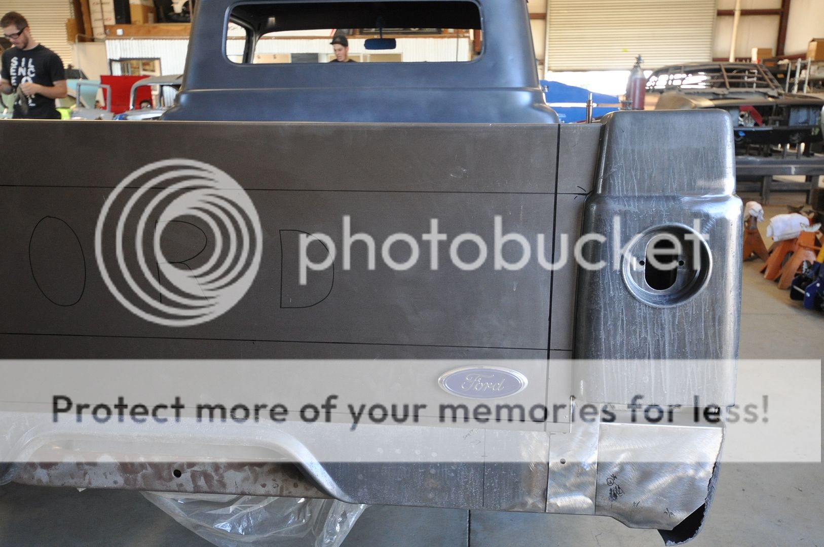

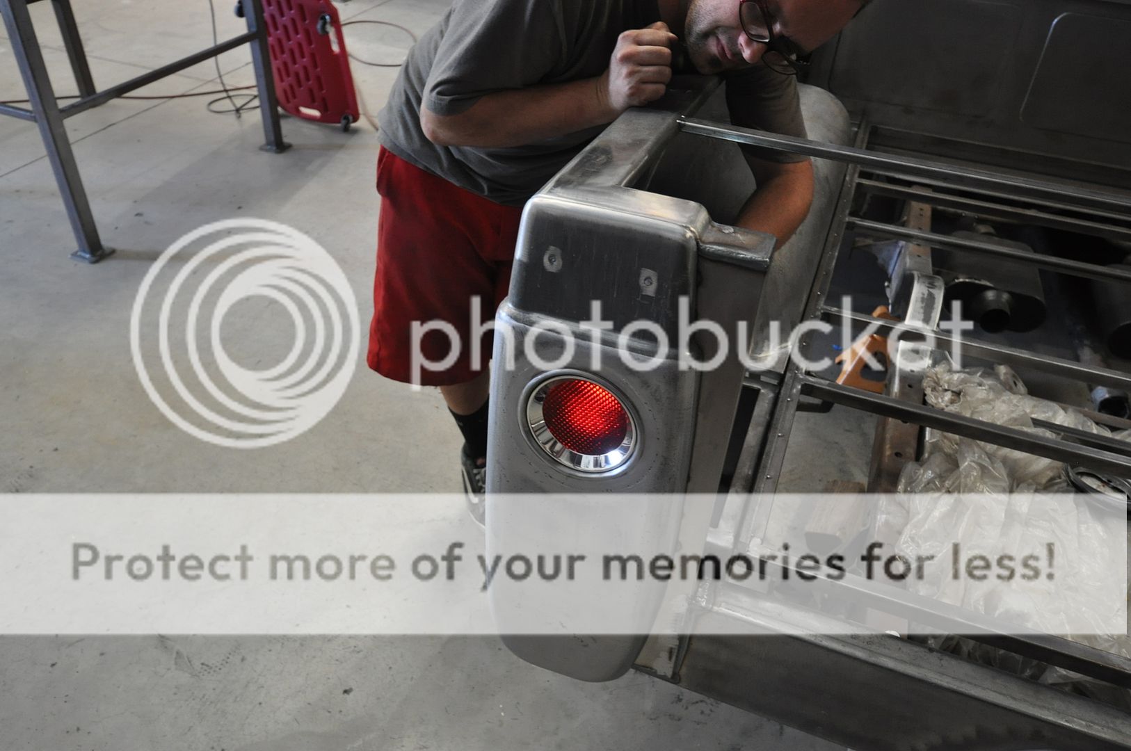

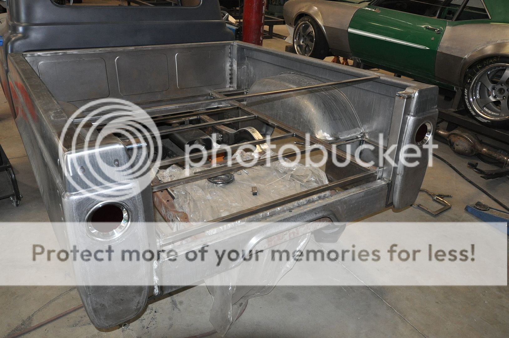

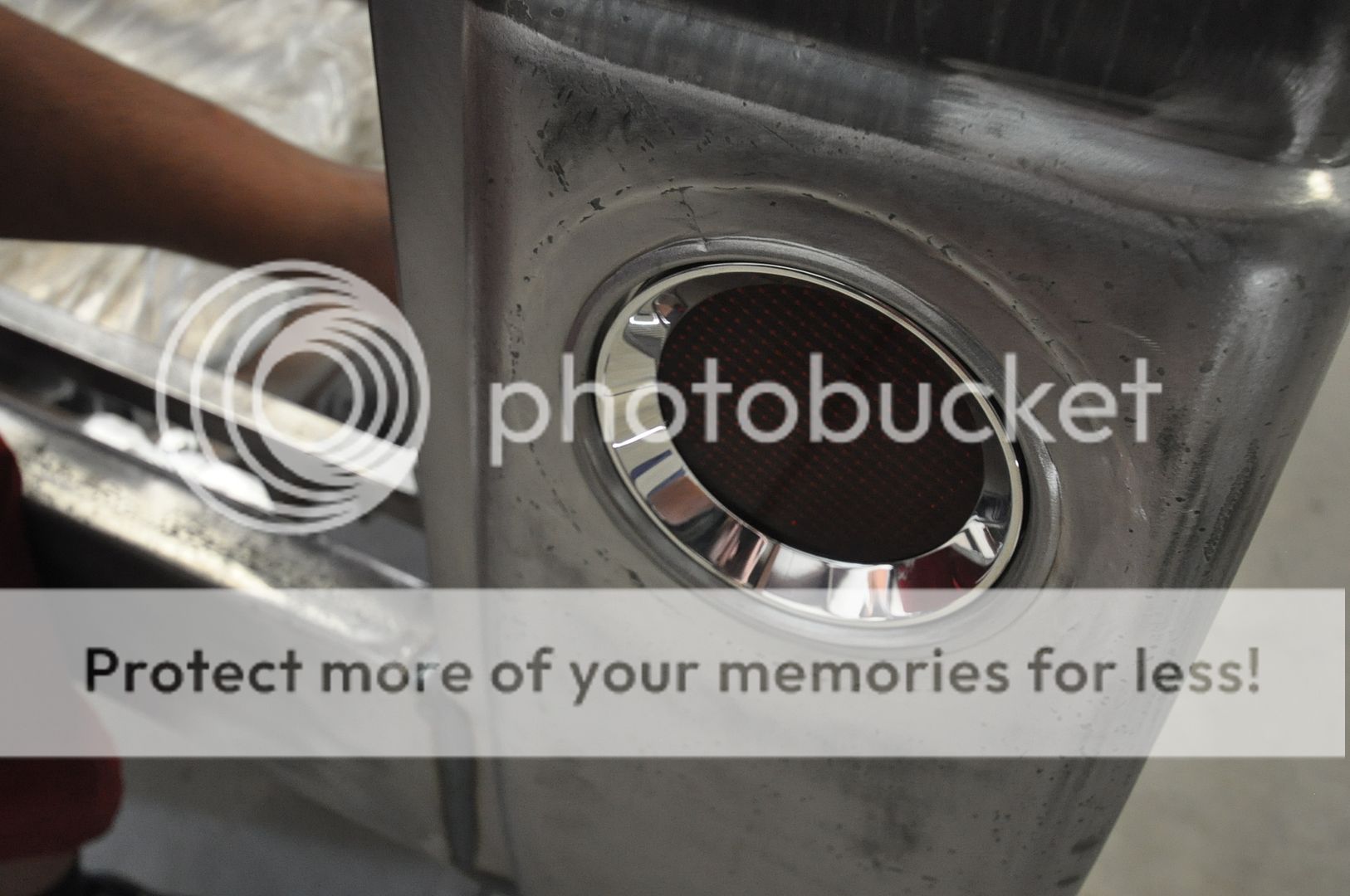

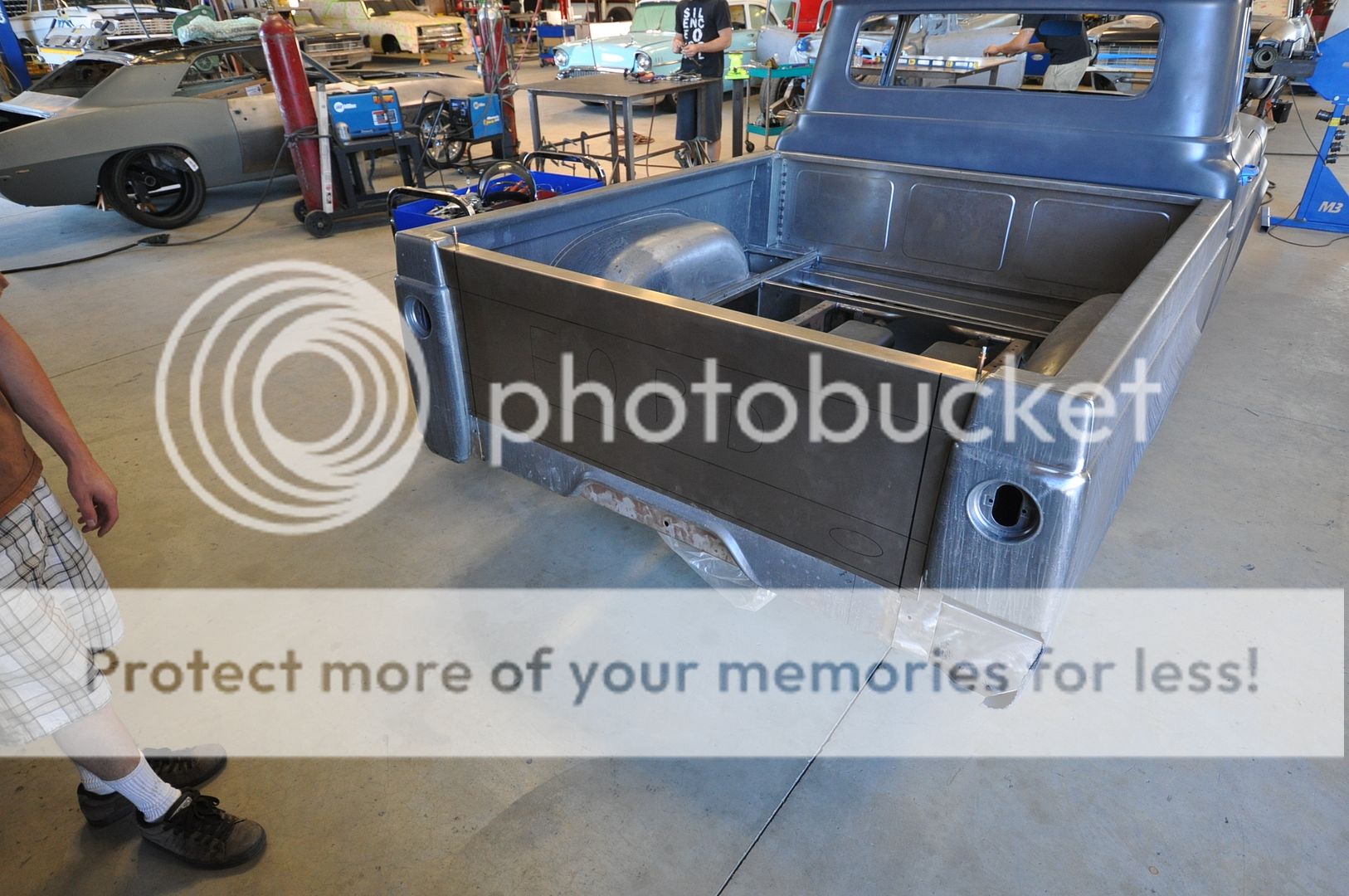

Well we did some custom taillight work on the 1960 Ford. We used some custom tail lights from Marquez for this project. We had to form the reveal around the taillights and build everything to get it to fit the slightly bigger light diameter. I like it. Check it out
Stock with mock up tailgate installed
http://i616.photobucket.com/albums/t...t2011044-1.jpg
http://i616.photobucket.com/albums/t...t2011048-1.jpg

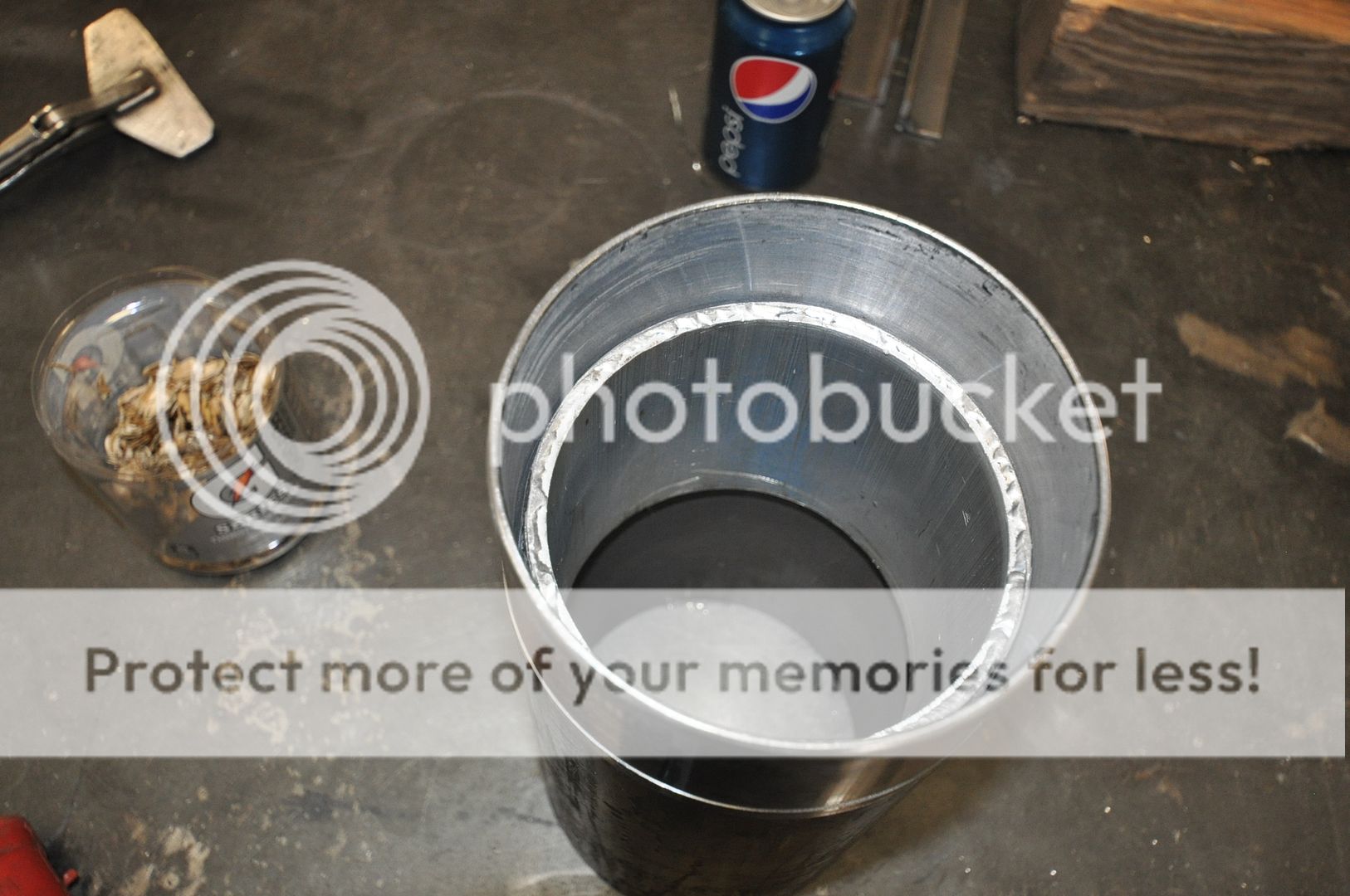

The Die we made to form the bigger reveal around the taillight. Just some 5" drill pipe Machined for the desired reveal.
http://i616.photobucket.com/albums/t...ust2011107.jpg

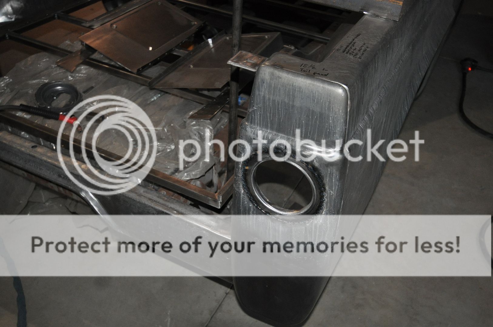

The formed ring tacked in place.
http://i616.photobucket.com/albums/t...ust2011113.jpg

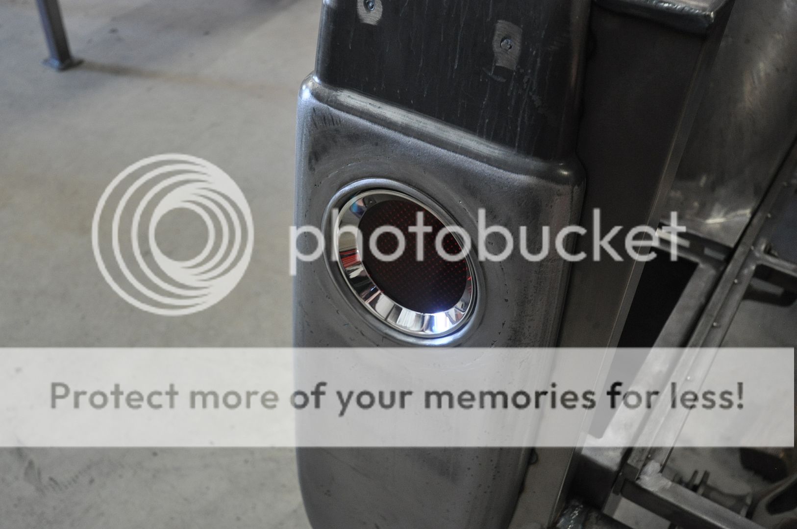

The almost end result
http://i616.photobucket.com/albums/t...ept2011006.jpg
http://i616.photobucket.com/albums/t...ept2011005.jpg

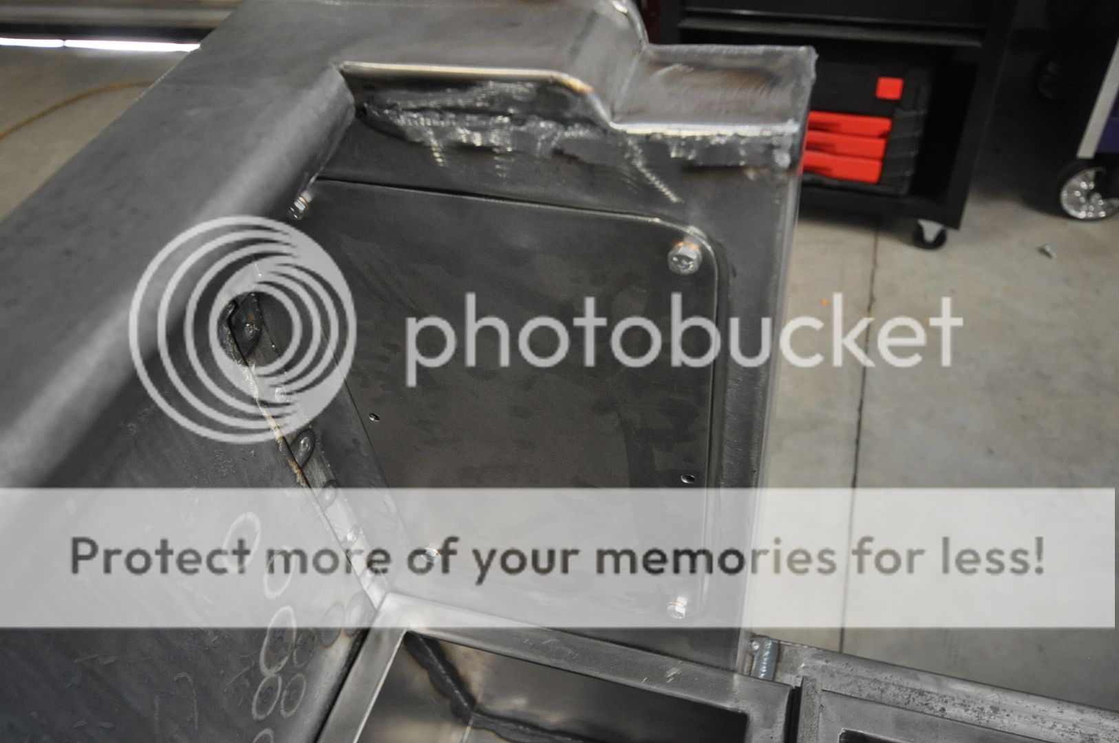

From the back side
http://i616.photobucket.com/albums/t...ept2011007.jpg
With the access panel cover and mock up bolts
http://i616.photobucket.com/albums/t...ept2011008.jpg

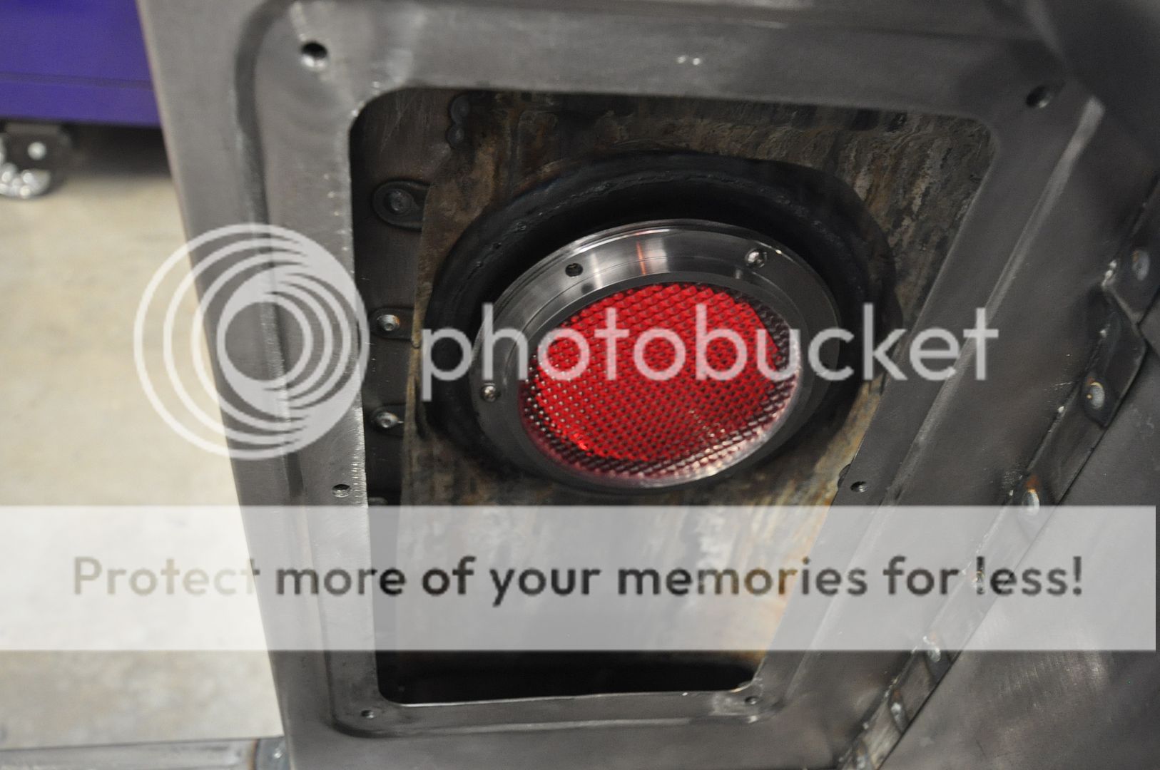

Doing the flashlight test.
http://i616.photobucket.com/albums/t...ept2011009.jpg
And both sides. Now time for a very custom tailgate. And modifying 2 nova bumpers to create the desired bumper we want. Should be cool.
