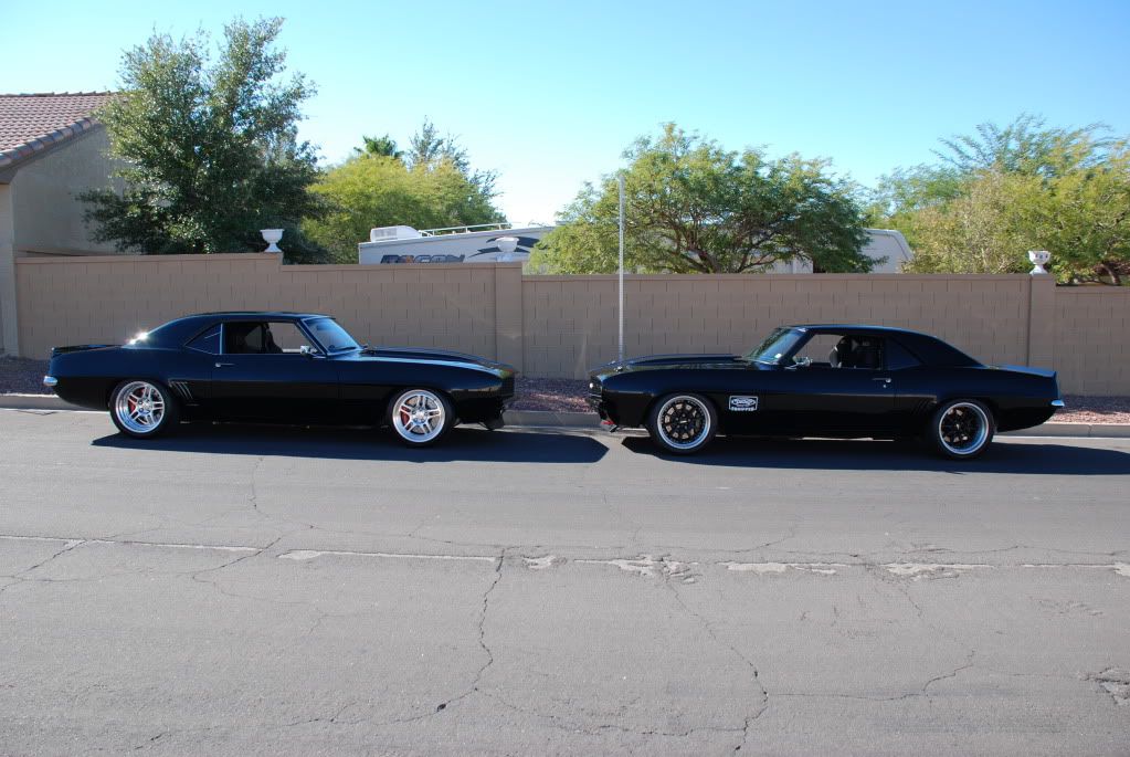

But, one of the worst things I could have done for that day was ride shotgun in Rich's flagship build car (for his buddy/customer Eric David). It's very similar to Todd's 69 in a lot of ways, and it ruined me for the day. What a beast and beautiful car (Eric's on left, Todd's on right for those that just registered yesterday). We are working on convincing him to come to RTTC with us. :thumbsup:

Eric has a gorgeous car. I mentioned how loose the track is at El Toro and how he would likely do some damage when he was here in November. It's my fault. :D That photo is the perfect example of different blacks. His has a blue tinge while mine is dark.
As we discussed, it's the pads. I can lock up my rears easily with a larger bore master cylinder and my Carbotechs. It's an amazing difference. I ended up needing to dial out about 5-6 turns. They are an autocross pad with good initial bite. The wilwood pads they send with the street kits don't squeak and have great life. They just don't work that great. My rear pads were nearly brand new after 3-4k on them. I haven't had them squeak like my front road race pads.
