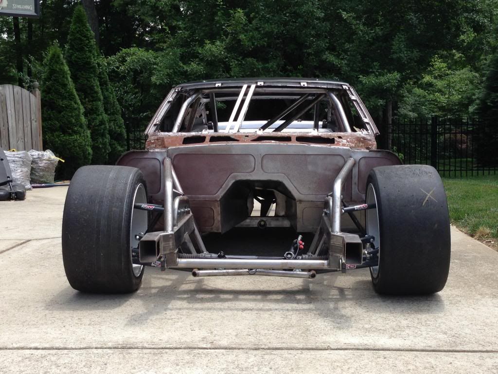

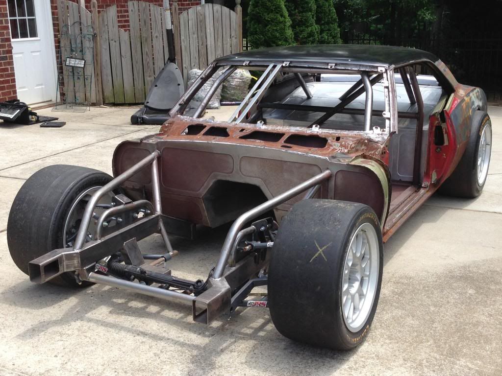

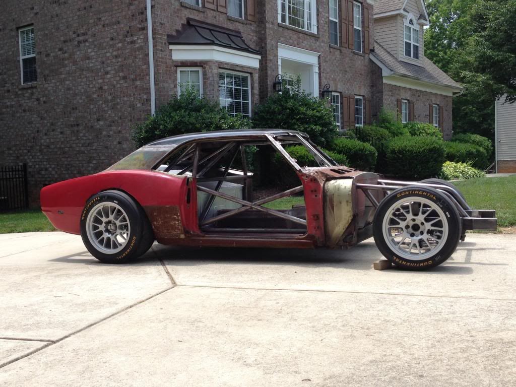

Flash68 06-11-2014 02:29 PM
Originally Posted by Matt.A (Post 555606)
Holy hell! So the front suspension is an inch or so forward? I remember Ron/Dave/Rob being concerned about the ride height being 4x4ish, but it sounds like you've go a bunch of other issues that are worse.
Sadly it's a long list. :mad:
Vince@Meanstreets 06-11-2014 03:02 PM
Originally Posted by Payton King (Post 555609)
My car has 110 inch wheel base, the extra 2 inches are from the firewall forward. Rear is in correct spot. The front will have to be cut off and moved back 2 inches. Probably up 2 inches as well to correct some geometry problems.
ok, well that changes things. I surprised he didn't build it with a mock up body so he could center everything.
57hemicuda 06-11-2014 04:08 PM
Well if it was 108", he wouldn't have needed a mock up body. LOL
Matt@BOS 06-11-2014 07:20 PM
I don't get how this happens. I've seen sub frames from one manufacturer go through the shop where the lower control arms were all off a half inch, or so, but building a 110" wheel base? :headscratch:

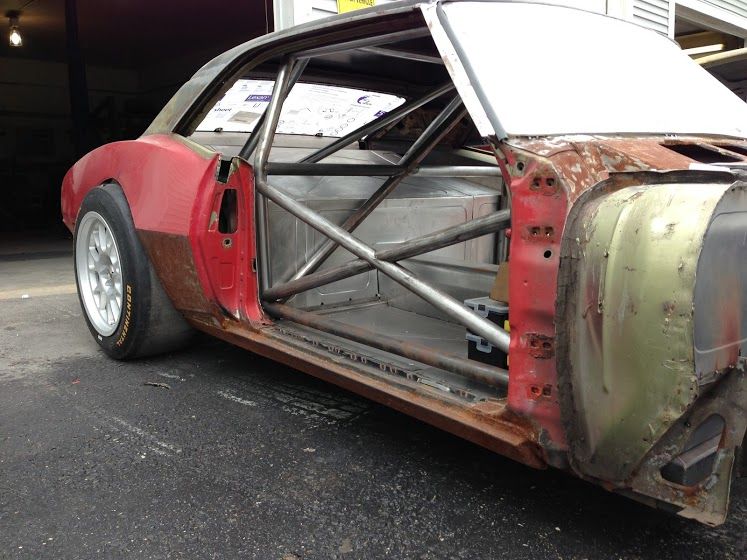

Payton King 06-12-2014 06:19 AM
It is actually at Jim Pettigrew's. Been a frabricator in NASCAR for 30+ years and is currently working at Hendrick.
The only thing that I can figure is Jake was building a car for Mulvey, he built Mulvey's car 110 inches because he was going to run Maxton Mile and someother high speed events. He must have forgotten and did not change the jig. That is not an excuse for him, he is still a dumb ass. How do you build a full frame car and not check wheel base? I am guessing he knew what he did and decided to send the car on to me instead of correcting.

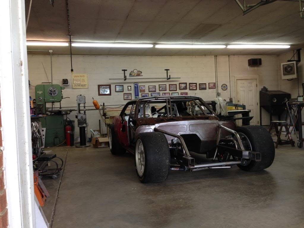

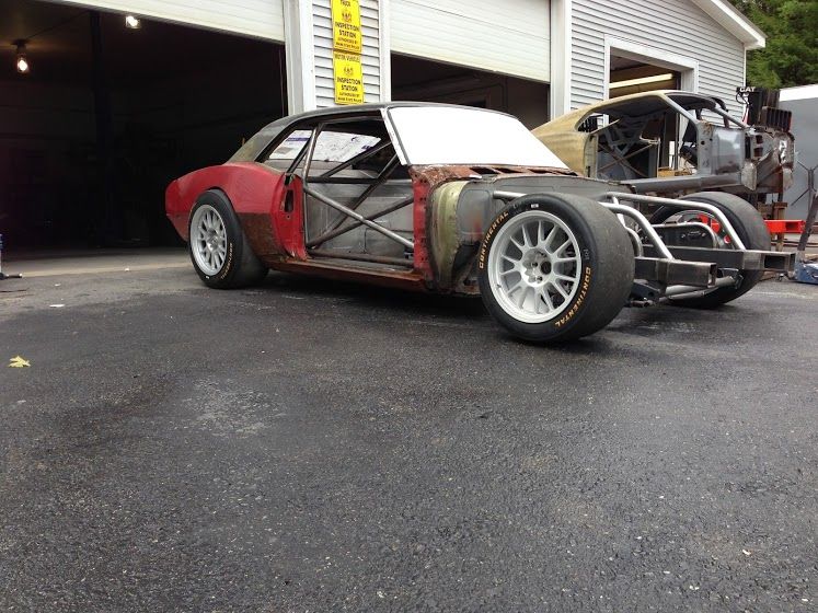

Payton King 06-12-2014 06:23 AM
Here it is at Pettigrews
http://i1138.photobucket.com/albums/...ps1j3yhy7o.jpg
If any of you remember, I ran a 21st Century front clip on my yellow car and Rupp had one in Bad Penny. That is the jig for it on the left

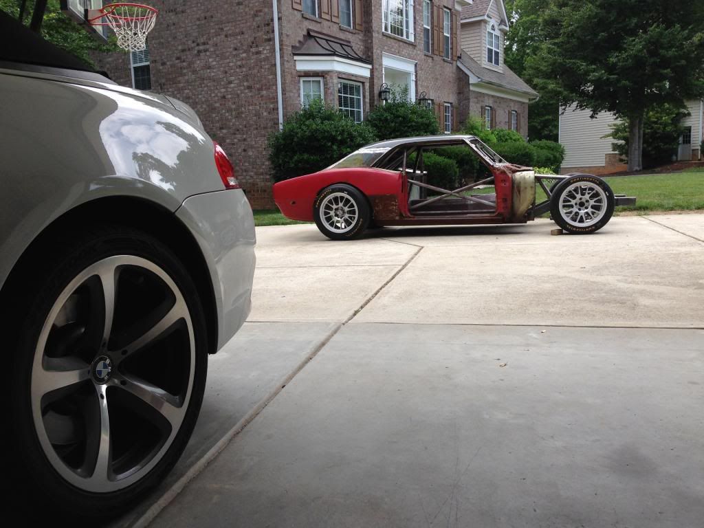

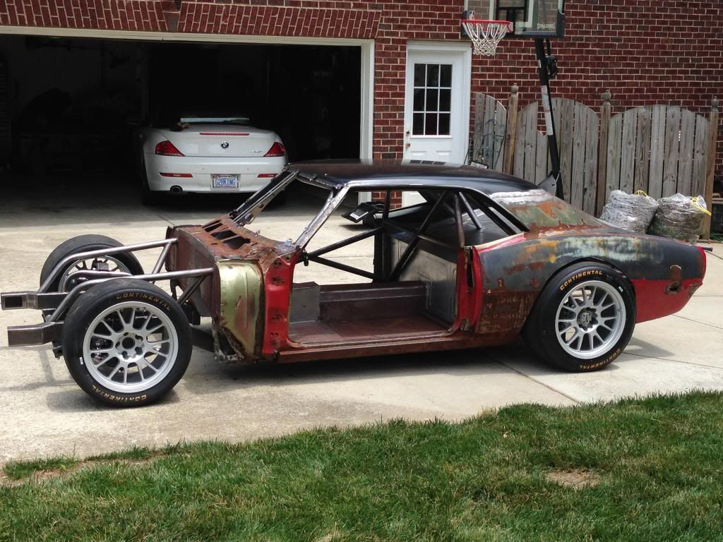

Payton King 06-12-2014 06:28 AM
Here are a few shots of it while I was waiting for the roll back
http://i1138.photobucket.com/albums/...psyejczp0u.jpg
http://i1138.photobucket.com/albums/...psvqlponq8.jpg
http://i1138.photobucket.com/albums/...psyuw04ygq.jpg
Payton King 06-12-2014 06:29 AM
Few more
http://i1138.photobucket.com/albums/...pstau2bage.jpg
http://i1138.photobucket.com/albums/...psmxjmifmx.jpg
and attempt at an artistic shot
http://i1138.photobucket.com/albums/...psdotmyfnf.jpg
