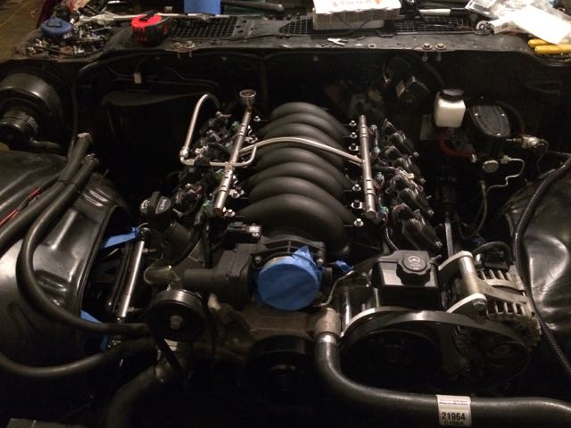

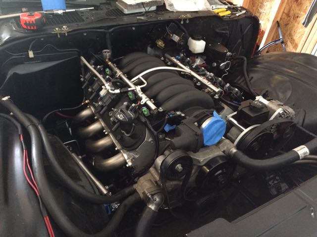

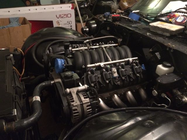

Made a bit more progress this weekend. Finally have the top side wiring , under dash wiring , fuel lines fully ran, and the ECM/fuse block mounted under the dash. I had to pull the new harness apart to move the MAF to the passenger side of the engine. I also needed to reduce the length of many of the wires. It took forever but I think the result it not too bad.
I also cut out a piece of steel plate to use as a clutch reservoir mount.
Attachment 51169
Attachment 51170
Attachment 51171
Tonight I hope to get the knock sensors, main battery and starter solenoid all hooked up. I also want to complete the relay block for the fuel pump in the trunk.

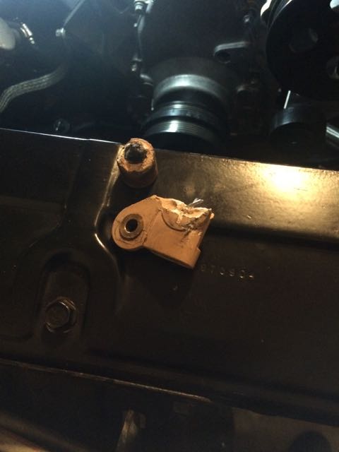

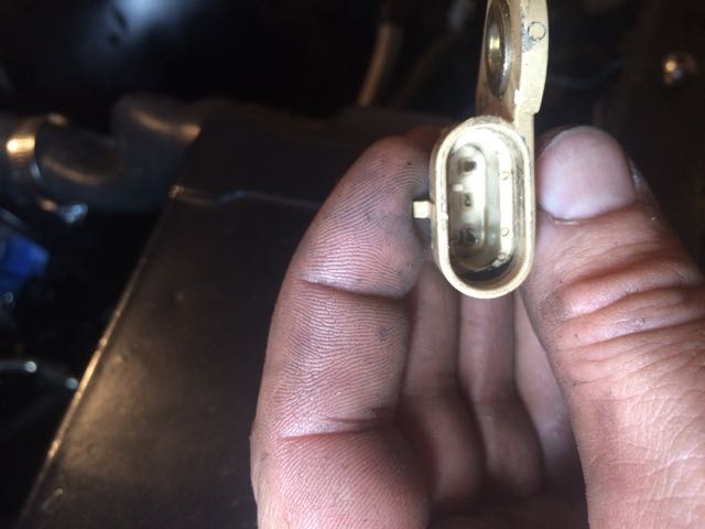

After all this I was ready to start it. I crank is over and nothing…. It spins just fine but doesn’t even think to fire. I put a scanner on the car and noticed a P0010 code for the Cam sensor and a few codes for the accelerator pedal. I decided to pull the cam sensor to make sure it isn’t damaged. It decides it wants to stay where it is and breaks into pieces. I have to pull the front cover off and push the sensor in but do get it of. Looking at the sensor I also see 1 of the 3 connections is missing so think I found the issue. I grab a replacement sensor, put it all back together and try to fire. NOTHING…..
