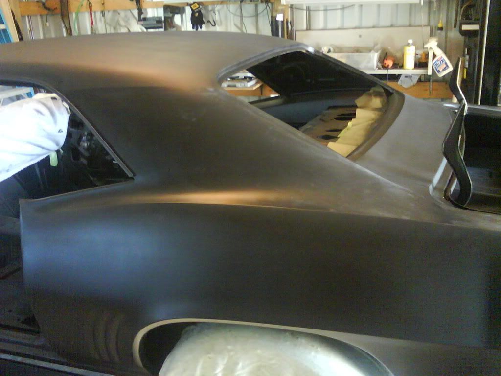

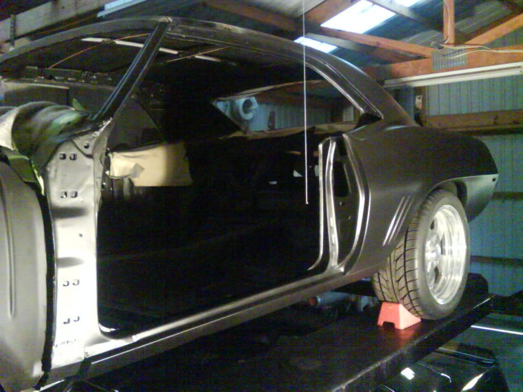

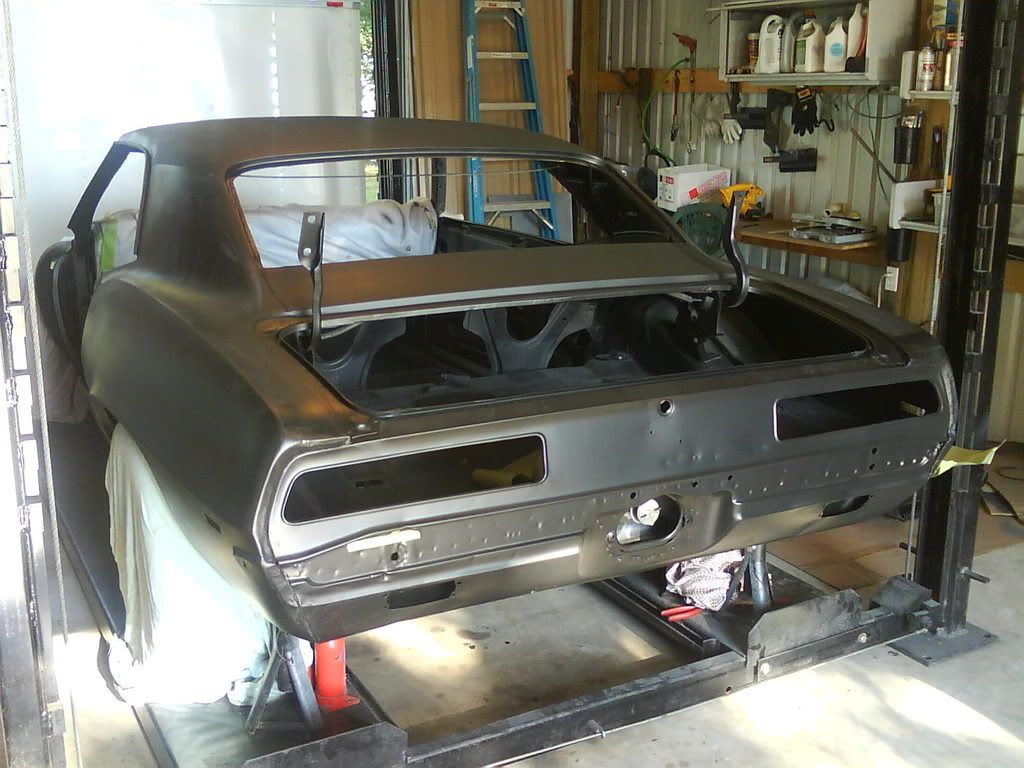

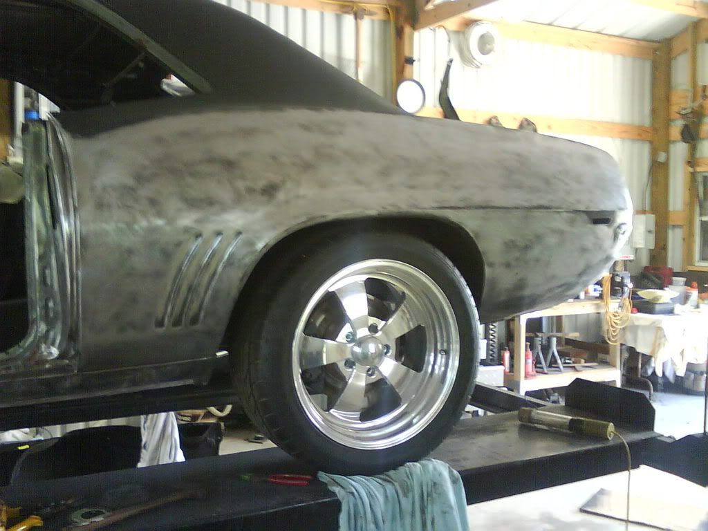

I am doing mine at home - here are some pics of the progress:
I am doing it piece by piece... started with the sails... then stripped and painted the tailpanel and then moved onto the roof and quarters...
http://i205.photobucket.com/albums/b...9/DSC00003.jpg
http://i205.photobucket.com/albums/b...9/DSC00011.jpg
http://i205.photobucket.com/albums/b...9/DSC00009.jpg
http://i205.photobucket.com/albums/b...9/DSC00012.jpg
After that is all done I plan to do the bodywork where necessary, block the whole car and then spray the entire thing with dp90 again... Then on to the doors, fenders, hood, trunk, etc.
:wow:
70TWO NOVA 06-11-2008 03:26 PM
lookin sweet, always loved the look of a first gen in dp90!
