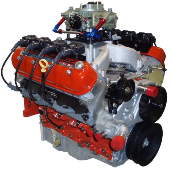

I am still talking with Jason up at Katech on the motor but I think I'm leaning towards this....
Hot Rod LSX 427
http://i931.photobucket.com/albums/a...Engine_low.jpg
Bore: 4.220
Stroke: 3.819
Displacement: 427ci
Horsepower: 656 @ 6800rpm
Torque: 563 @ 5200
Compression ratio: 11:1
Fuel: Premium pump gas
Redline: 7500rpm
Block: LSX iron, billet steel main caps
Crank: Callies Magnum forged steel
Rods: Callies H-beam forged steel
Pistons: custom forged aluminum
Heads: ported LS3, chamber enlarge for big bore
Valves: LS3
Intake: GMPP LS3 single plane with Holley 850 carburetor
Camshaft: GM Stage 3
Lifters: GM racing, hydraulic roller
Oiling system: Wet sump
Ignition: MSD programmable spark controller with software, LS6 coils
Appearance: Katech valve covers powdercoated orange, Katech coil relocation kit

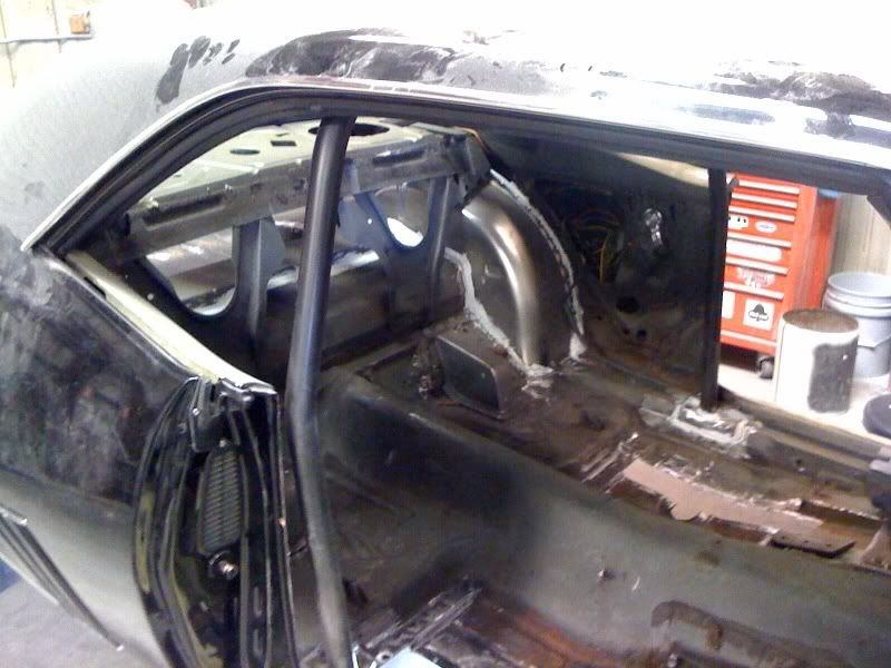

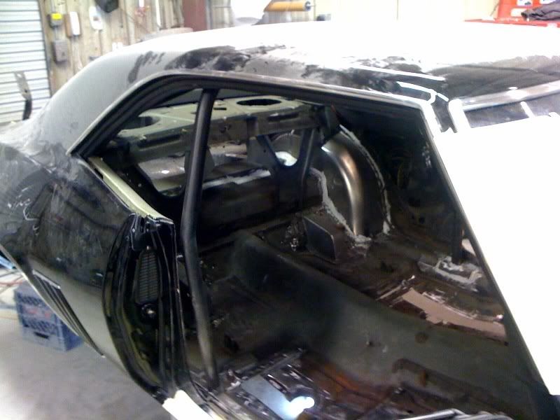

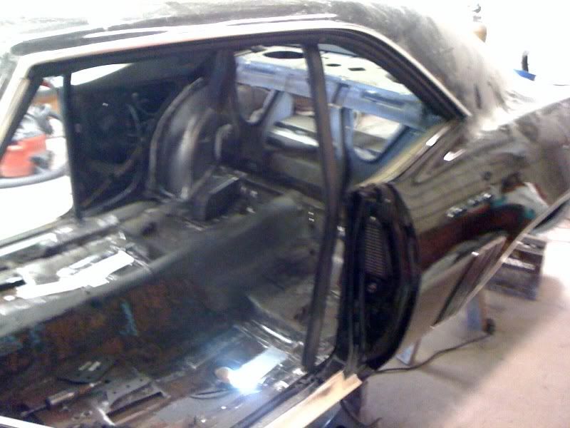

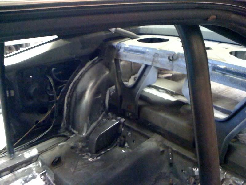

As of yesterday the mini tubs & roll bar is in and undercoated. The fire wall is sanded down and ready for some paint. I am now having problems with the wheel fitment because I'm using the Baer Exterme Plus but I think with Franks help we have the solution. Thanks Frank, your help is greatly appreciated!!! I have also decided I should of named this "Project Indecisive" since I could not make up my mind on the motor so yesterday the decision was made to keep the 396 and to guarantee that I ordered the Billet Tru Trac system in black anodized, were painting the block in an aluminum, and I ordered fabricated moroso aluminum valve covers with breather tubes, 14" air cleaner cover and swivel thermostat housing. Now that I've spent some money to dress up this motor I have to keep it.....for now :unibrow: Also ordered a TKO-600 5 speed yesterday and that should be shipping today :thumbsup:
Here are a few pics:

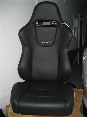

Got these bad a$$ seats in the other day!!:D
