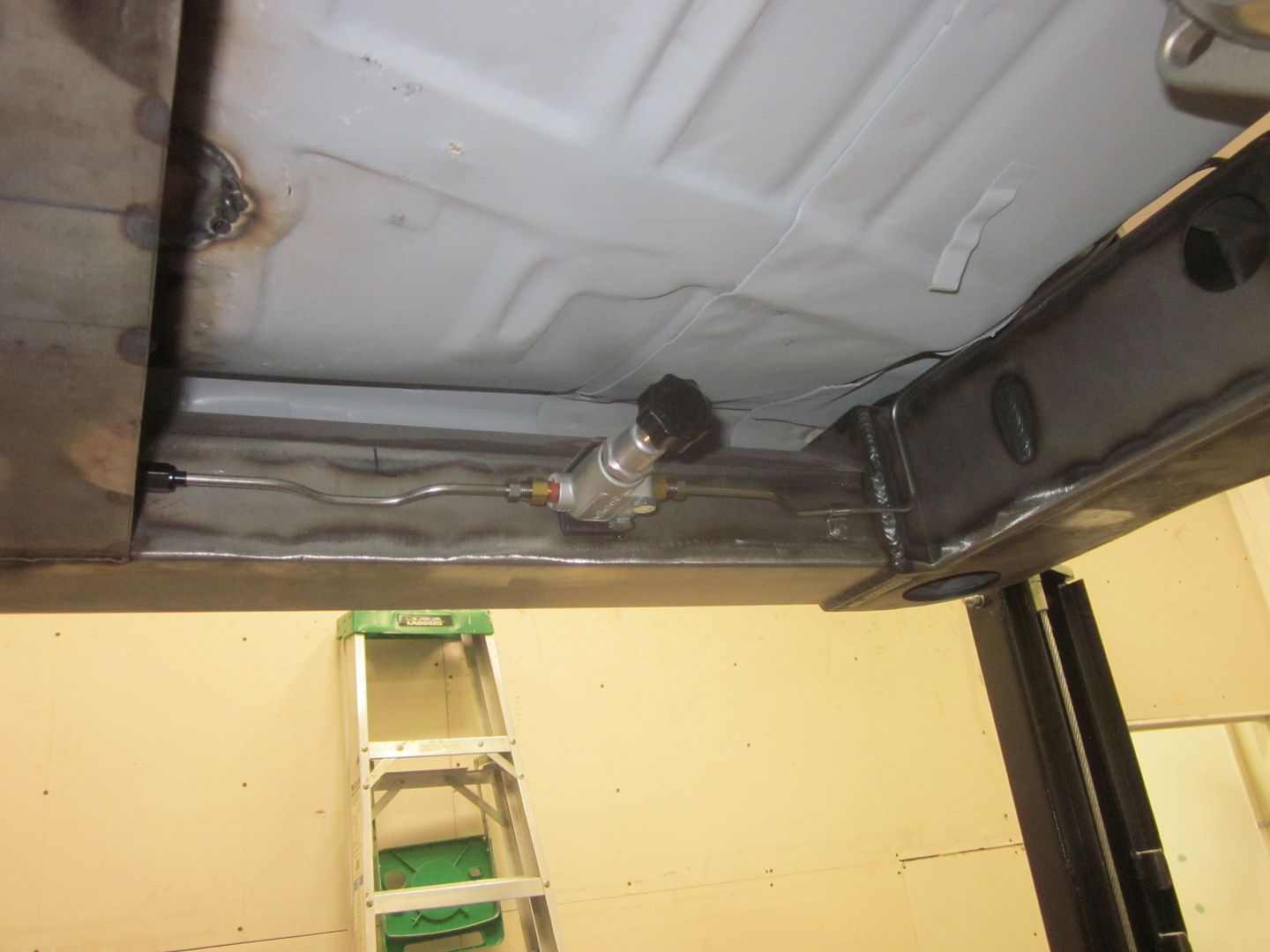

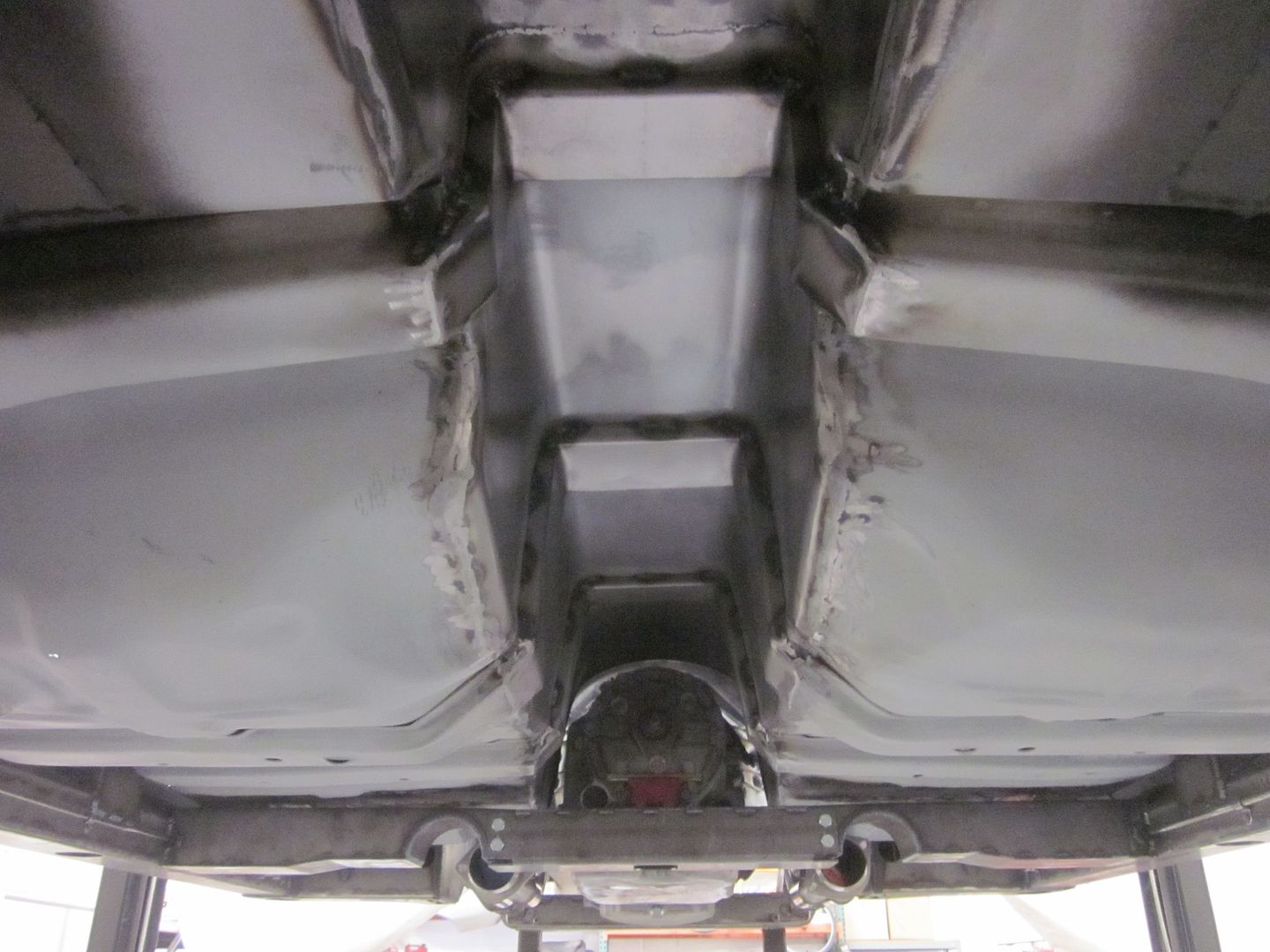

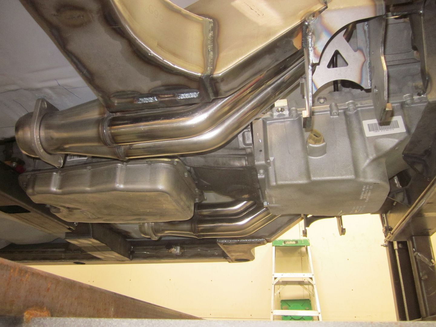

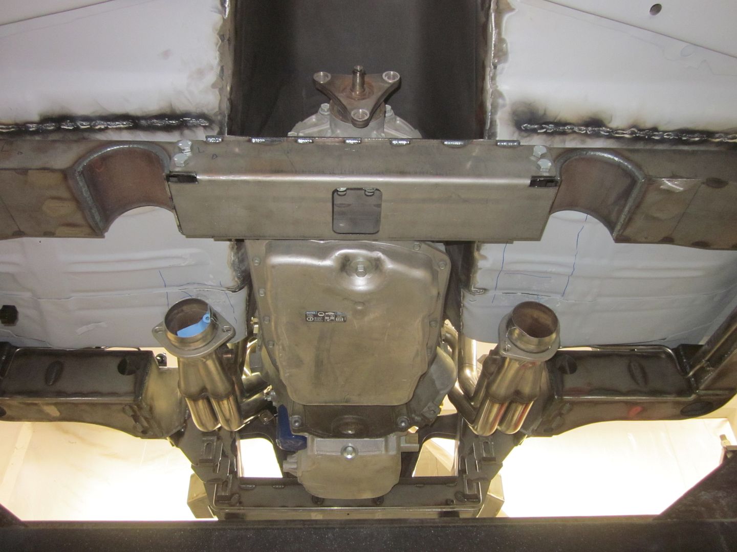

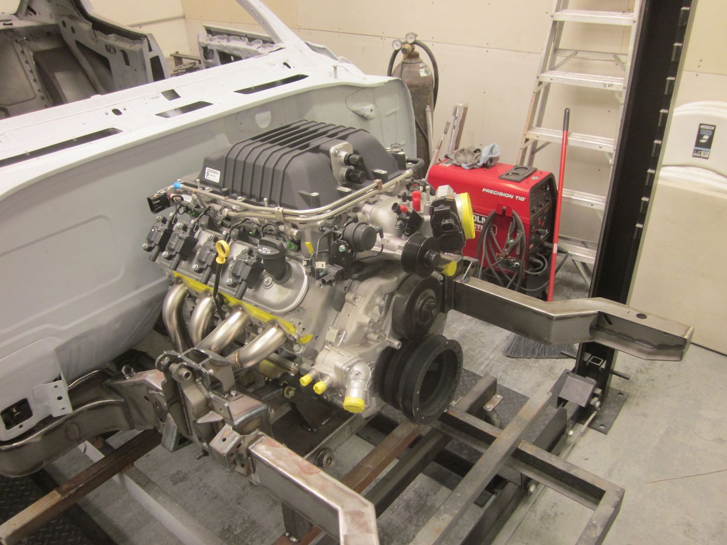

Here are some quick updates!
Engine & trans in place
Upgraded to a 6L80
Trans tunnel with raising is complete
Hard Plumbing on underside of car is complete
Rear-end is getting cut with housing ends welded & axles on order
Owner comes in this week to get wheels on order! Forgelines!

Cris@JCG 06-03-2013 06:45 PM
Here is what it looks like on the underside of the trans tunnel..
http://i1015.photobucket.com/albums/...psc6b14cc1.jpg

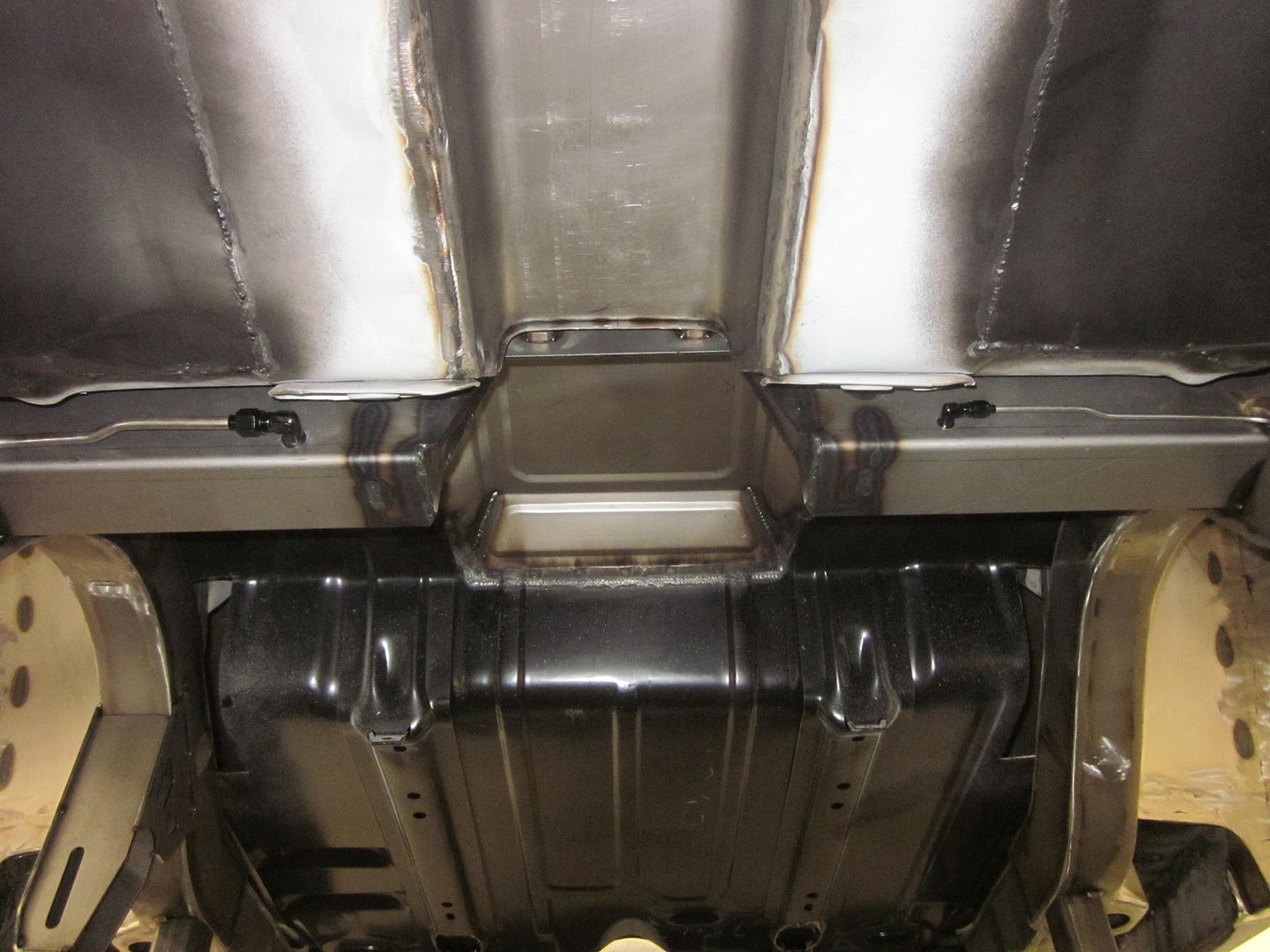

Cris@JCG 06-04-2013 08:38 AM
Hey Marty-
This tank will be specific to my chassis.. We just built the tank to look the best for the rear section of the car.. requires more modification to mount but wanted to keep the volume of fuel in the tank.. Basically we grabbed as much area we could & moved the sump of the tank to the front..

syborg tt 06-04-2013 09:19 AM
That is what I thought.
Looks like we will be making a custom tank as the Ricks tank sits way to low

Marty, I'm dealing with a design now as well due to the IRS on my chassis. I knew I would have to get a custom tank, but I'm wanting to keep the volume like Chris said.
syborg tt 06-04-2013 11:45 AM
Were looking at doing a mustang style tank and dropping it into the trunk floor. Just raise the darn thing up and it should solve the problem.
