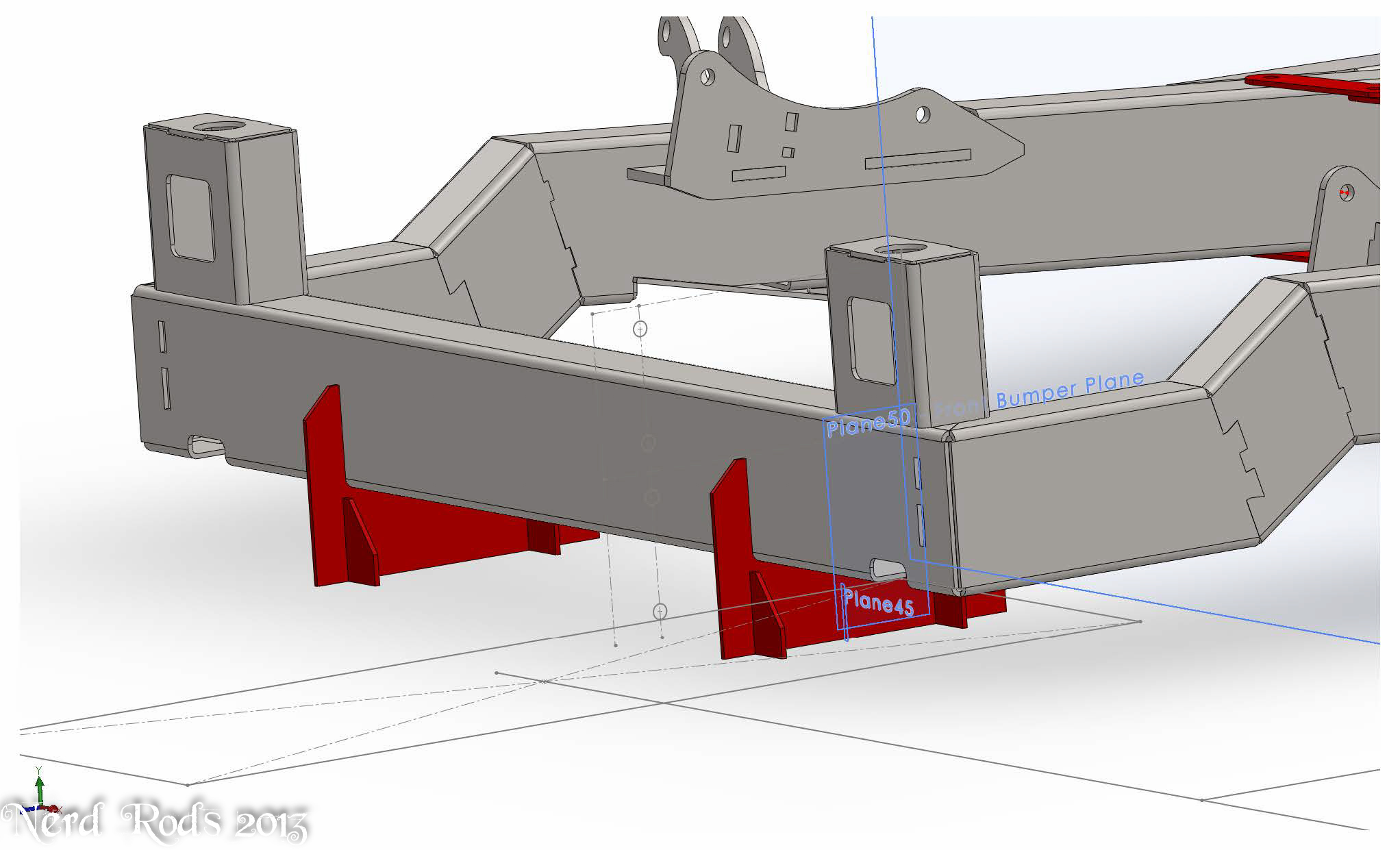

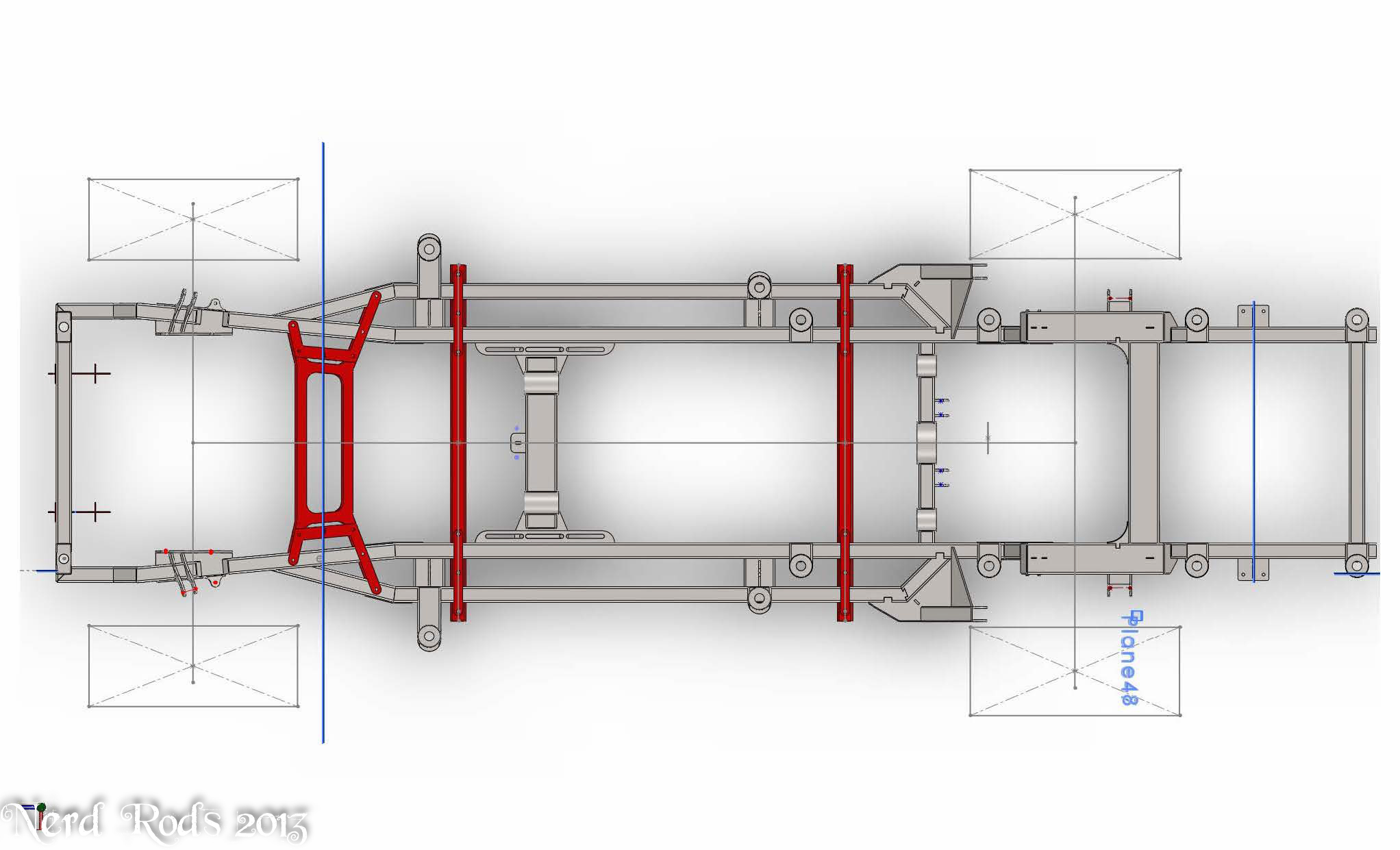

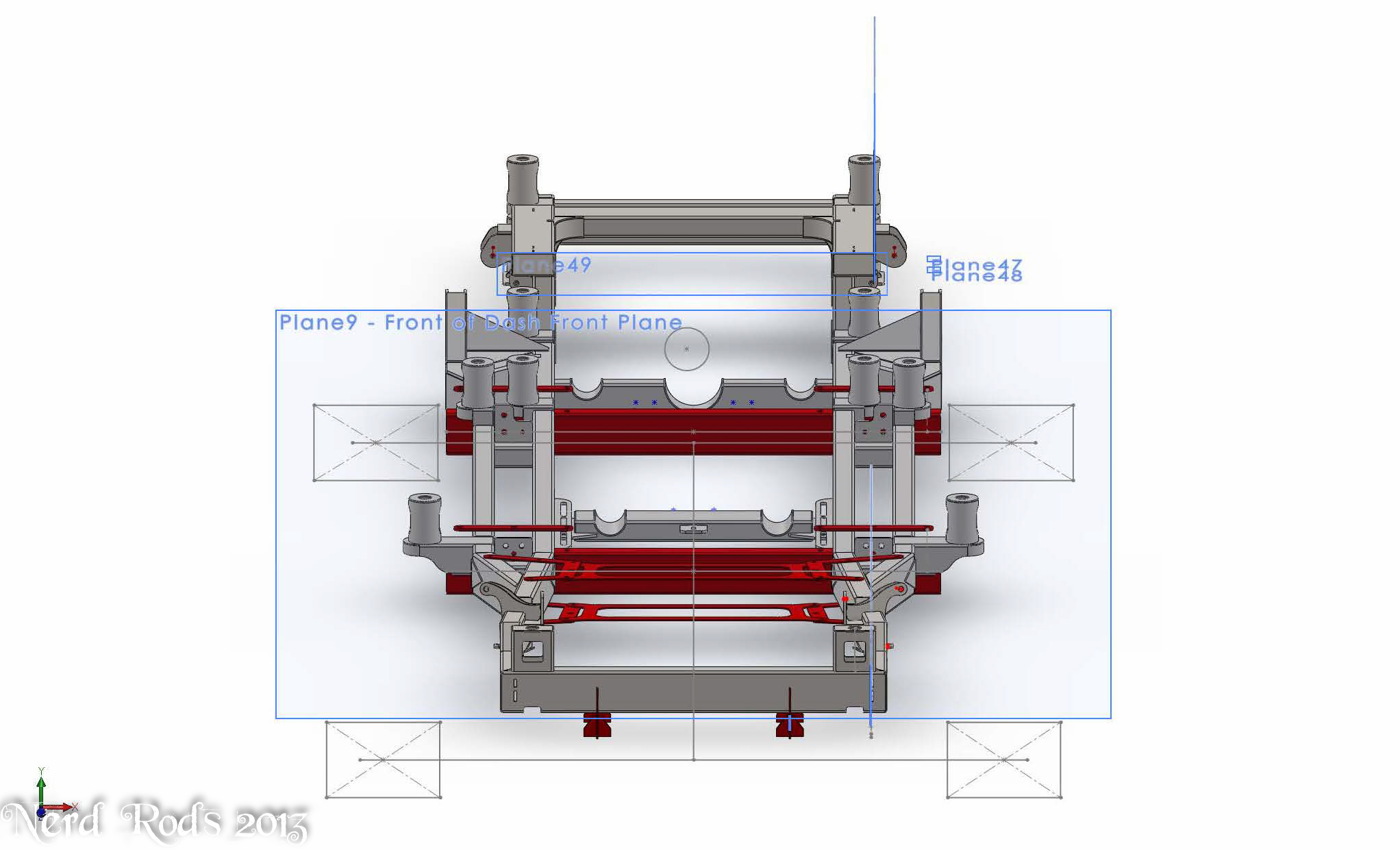

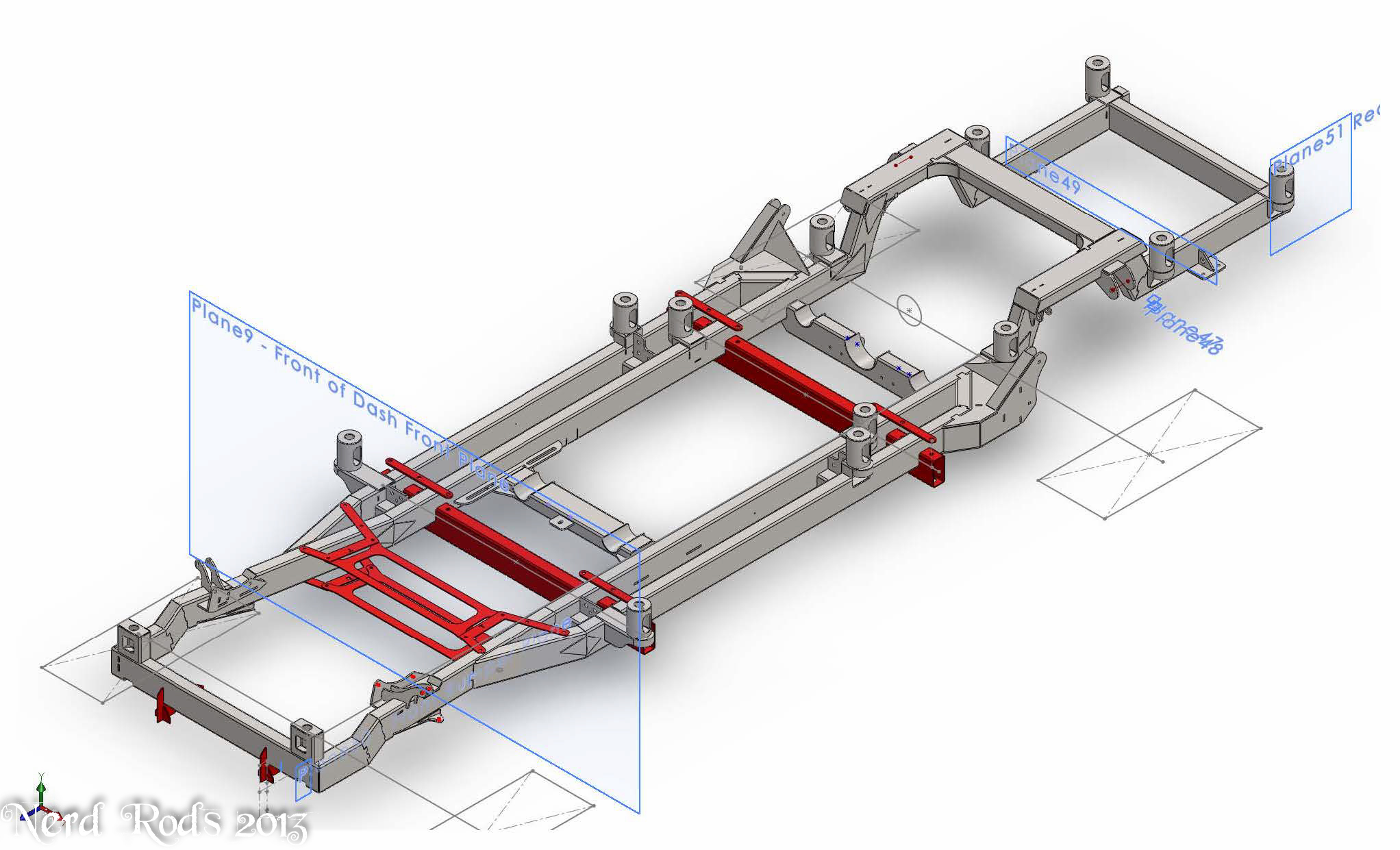

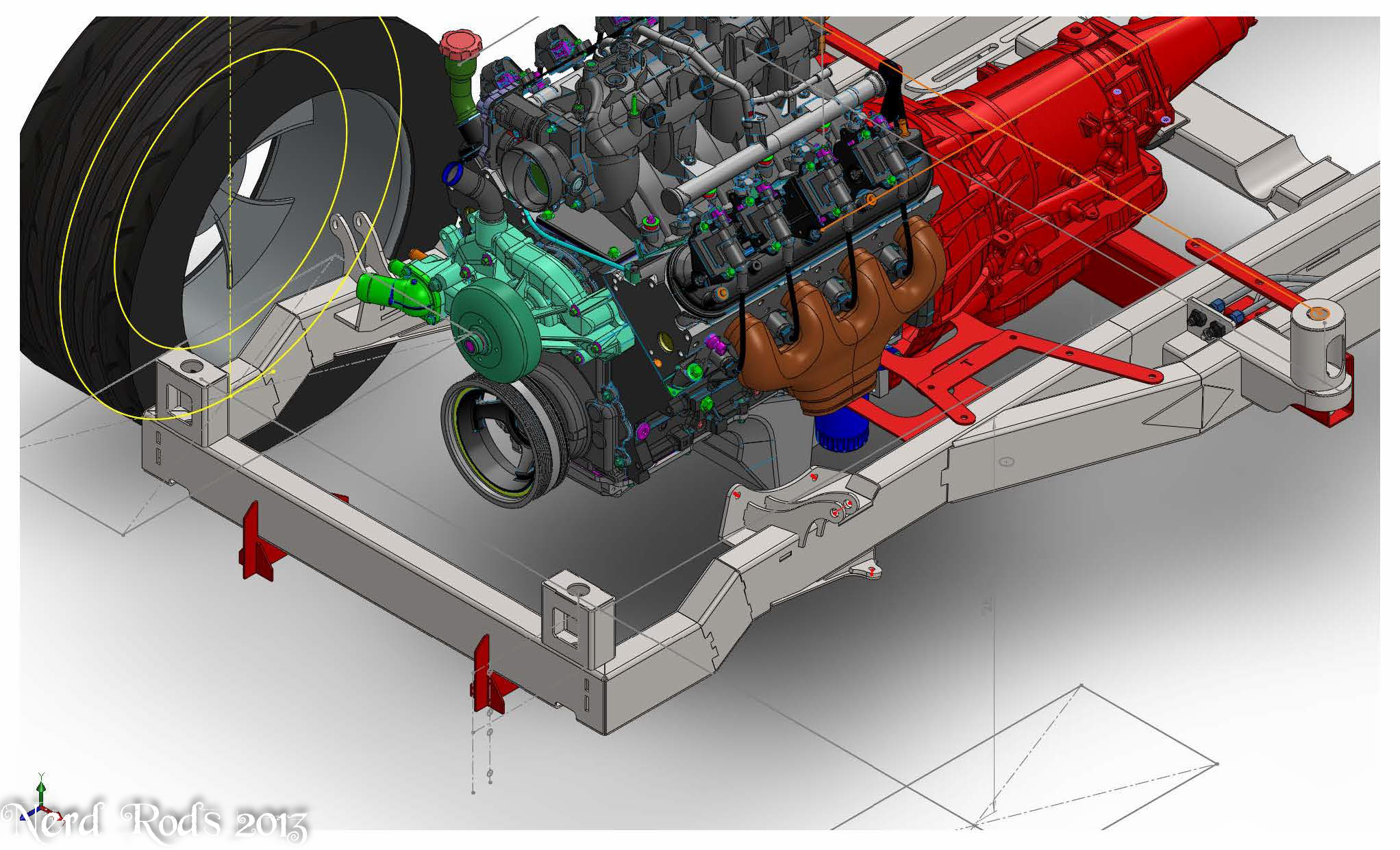

ALMOST!!!!!
I'm looking for another frame to measure bumper mounting holes. I've measured one already but I like to check 2 and average the two or three to find my locations all dialed in. But until then, pictures of the 99% completed frame!!!!
http://www.nerdrods.com/Images/custo...ll/08/S-01.jpg http://www.nerdrods.com/Images/custo...ll/08/S-02.jpg http://www.nerdrods.com/Images/custo...ll/08/S-03.jpg
http://www.nerdrods.com/Images/custo...ll/08/S-04.jpg http://www.nerdrods.com/Images/custo...ll/08/S-05.jpg http://www.nerdrods.com/Images/custo...ll/08/S-06.jpg
http://www.nerdrods.com/Images/custo...ll/08/S-07.jpg http://www.nerdrods.com/Images/custo...ll/08/S-08.jpg

It does look awesome! Just wanted to say that I had to cut the front of my 58 frame to fit the 57 clip, that and other things Ive read suggest the 58-59 frames are longer in the front.
rat_rod_russell 08-30-2013 02:49 PM
Yes indeed! That and because the front bumper bolting face will have different heights due to the multiple ride heights the bumper parts will be bolt on's.
