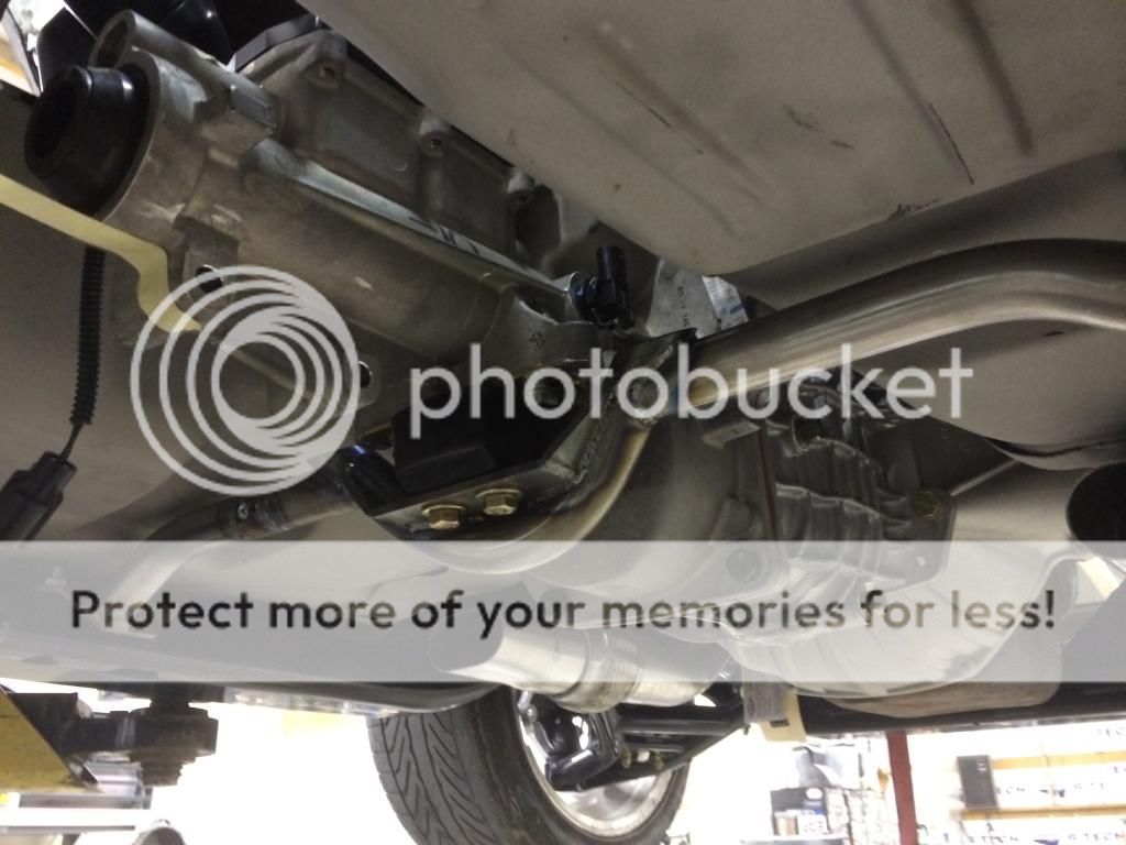

The UCA has poly bushings inside and out, the lower uses the factory rubber bushing on the upright with the joint on the cradle side...
Here are some more pics!

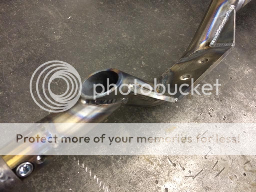

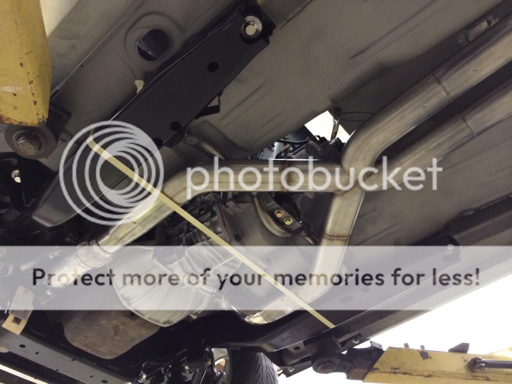

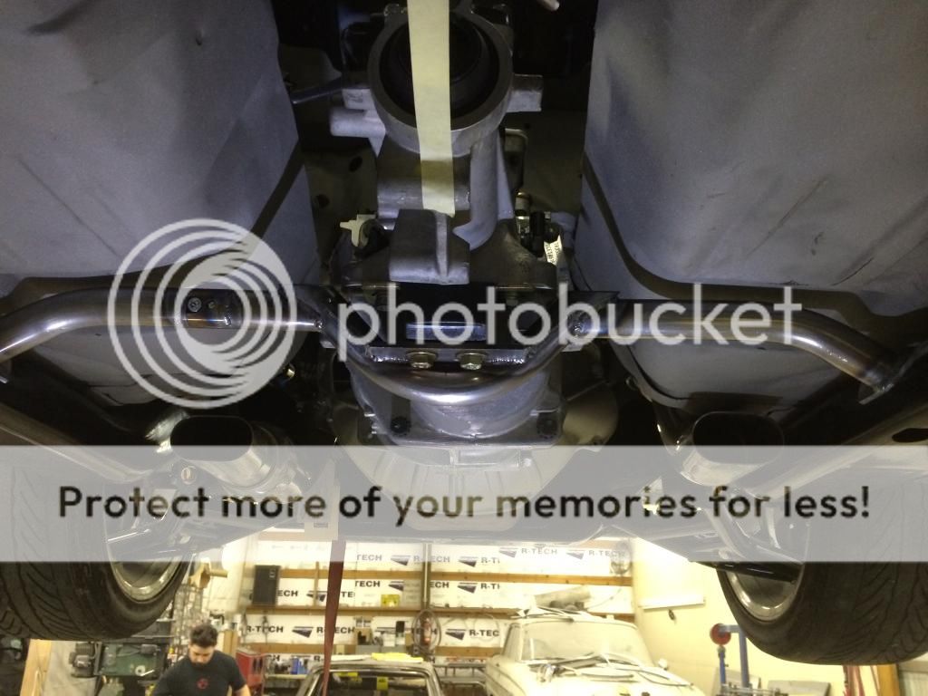

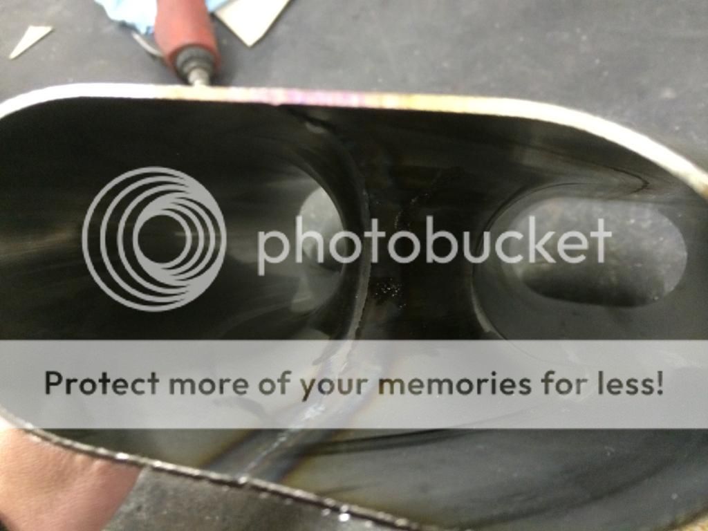

We had to make a new trans x-member. The aftermarket one we had didn't allow enough room for the exhaust... The new x-member fits very tight to the floor, that did force us into making it come apart on one side... If we didn't put the joint in it, it would be stuck in the car... (half height body mounts)
http://i461.photobucket.com/albums/q...00F9EF8B7F.jpg
http://i461.photobucket.com/albums/q...EEE1A36B70.jpg
http://i461.photobucket.com/albums/q...74A5E302FC.jpg
http://i461.photobucket.com/albums/q...AB3C42E1D8.jpg

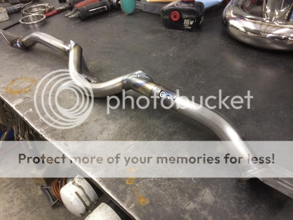

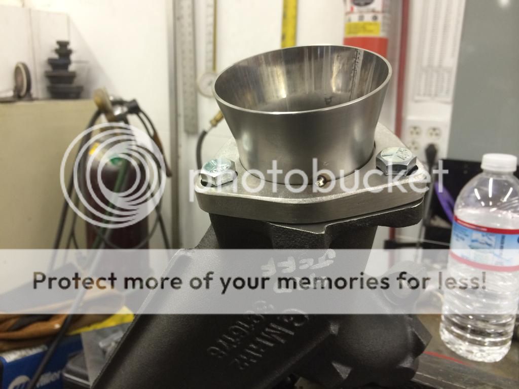

Starting on the exhaust also!
http://i461.photobucket.com/albums/q...B0B5071F85.jpg
http://i461.photobucket.com/albums/q...6D793ED696.jpg
http://i461.photobucket.com/albums/q...23F745C6C6.jpg

So..... Not to question the owners build but cast manifolds on a bbc on a car w/a DSE front/AME rear seems.....
Uhmmm..... out of place??
omiotek 11-25-2014 07:44 AM
My opinion is for a car that sees a lot of driving or track time I feel cast is best. Even though it looks no where near as pretty and doesn't perform as well as a good header they are less prone to cracking. Even the best headers sooner or later crack. it's the nature of expansion and contraction. now days a lot of cast manifolds flow equally as good too. I agree some tubular long tubes would look nicer but to each is their own.

Exactly what I want to do with my exhaust system. Keep it away from the speed bumps. The trans. cross-member is very clever !
Honestly, I love that about this car. Cast manifolds look super oem, and it's not like he's gonna miss the power.
