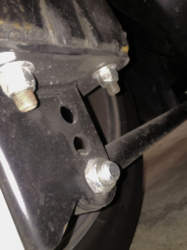

dhutton 09-11-2015 05:55 AM
Aren't those lower coilover mounts adjustable? Just raise them one notch.

dhutton 09-11-2015 11:04 AM
Originally Posted by cpd004 (Post 616278)
The coil over mounts are not adjustable. Only the lower control arms are.
I think they are and I see a hole above where yours are installed. I think you can move the mount up one hole. I know the first gen four bars are able to do this. When I look at the installation instructions your mounts appear to be lower. I don't see the unused hole in the instruction photos.
Don

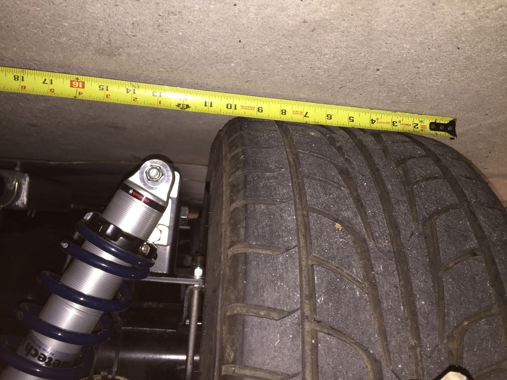

cpd004 09-11-2015 05:46 PM
That block actually can't go up or down. I'll try and get a better pic tomorrow. The lower control arm can move up or down, but it will change the angle of the rear end. Here's another pic I had, but it doesn't really show much else other than the old tires.

dhutton 09-11-2015 06:22 PM
Originally Posted by cpd004 (Post 616344)
That block actually can't go up or down. I'll try and get a better pic tomorrow. The lower control arm can move up or down, but it will change the angle of the rear.
If it could move up like the first gens you would be in good shape.
Don
cpd004 09-13-2015 03:59 PM
Don
It can...I'd guess that it would throw the rear end pinion angle off. That bracket and the control arm can move up. It still wouldn't raise the front at this point. It's definitely something to consider though.

WSSix 09-14-2015 05:54 AM
Your coil overs in the rear are set very differently. Was that done in an attempt to correct the height issues or some other reason? How are the fronts adjusted compared to one another?
cpd004 09-14-2015 06:05 AM
Yes...to correct the height issue. The fronts are exact opposite of the rear as far as preload goes on the coils. The front passenger has barely any preload compared to the drivers side on the front. I believe there is bind somewhere and have gone over everything a few times with nothing jumping out as obvious. The ride, as you can imagine, is not confidence inspiring by any means.
