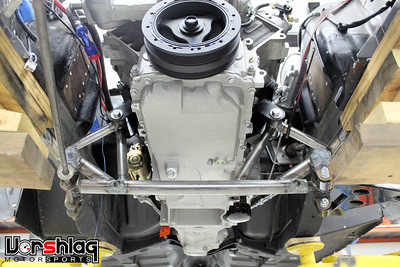

As the strut towers were reconfigured to take full suspension loads and not just shock loads, the steel plates we CNC cut were welded in and massively reinforced the whole area. A well anchored strut tower brace will also be designed and added. A temporary CNC plasma cut camber plate was cut and installed, but the final version will be CNC machined from aluminum and use counter sunk (flush) bolts for the caster adjustment.
https://www.lateral-g.net/forums/cac...IMG_9157-L.jpg
By the end of June we had strut towers modified, the MCS struts / brakes / hubs installed, and both of my 18x11" MOMO Heritage 6 wheels and 315mm Hoosiers installed. The car was on the ground and rolling again - the dolly that had been holding up the front end for months was taken apart and put away.

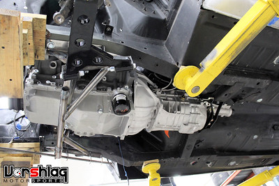

One thing I was under NDA not to disclose until November 2020 was the Tremec TKX 5 speed manual transmission, which we got early due to our testing relationship with Tremec.
https://www.lateral-g.net/forums/cac...IMG_8315-S.jpghttps://www.lateral-g.net/forums/cac...IMG_8318-S.jpg
This is a clean slate redesign of the old TKO transmission with modern 3-piece synchros, carbon blocker rings, a new case, new everything. It is still very compact and lighter than any T56 Magnum, which would have taken tunnel surgery work to make fit. As it is the TKX was a super easy install. We did zero cutting, just made the transmission crossmember shown. That's it. It bolts right in.
https://www.lateral-g.net/forums/cac...IMG_6657-S.jpghttps://www.lateral-g.net/forums/cac...IMG_6731-S.jpg
The T56 Magnum was what we would have used, but when the opportunity came up to test the TKX on two chassis in our shop (E46 LS swap endurance car + this 67 Mustang) we jumped at the chance. The TKX seems perfect for this build, as it is lighter (95.9 lbs vs 128 pounds for Magnum XL) and smaller than the Magnums in every dimension.
https://www.lateral-g.net/forums/cac...IMG_6732-S.jpghttps://www.lateral-g.net/forums/cac...IMG_6736-S.jpg
The TKX is a great size for this car, and I took a measurement showing the bellhousing to rear most shifter location above. It is rated for 600 ft-lbs of torque and comes in several gearing options. We had this bolted up to his crate LS7 engine in early May 2020.

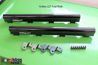

An aftermarket Holley LS7 fuel rail kit was ordered and installed in late June. This will allow us to install a fuel "return style" fuel system in this car more easily and cleanly.

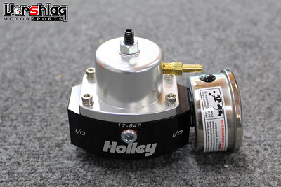

Along with the rail kit, the pressure regulator also came from Holley. We're trying to stick within this brand when we can, for several reasons.

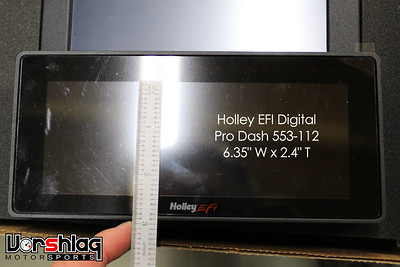

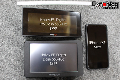

We gave Adam several digital dash choices as well, including these two Holley versions above. He went with their Pro Dash 553-112, which is shown above right. This has touch screen capability so you can literally create buttons on the screen to touch to turn on or off systems. Full color TFT display, should be pretty slick.

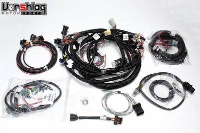

Within a few hours the plug-and-play harness was installed, the ECU was wired in, and the digital dash was connected. It all fired up and communicated perfectly.

After Jason and I looked at both SN95 and Fox racks, I purchased a brand new Fox Mustang GT power steering rack, which has a known amount of travel and 15:1 assist. This was one the AJE crossmember was made to accept. This was installed and it was time to find the right tie rod ends to connect the Fox rack and S197 front spindle.
https://www.lateral-g.net/forums/cac...IMG_4049-S.jpghttps://www.lateral-g.net/forums/cac...IMG_4050-S.jpg
I purchased both Fox Mustang and S197 Mustang tie rod ends - these arrived and we got to work finding the right solution - which might include a hybrid of both.
https://www.lateral-g.net/forums/cac...IMG_4052-S.jpghttps://www.lateral-g.net/forums/cac...IMG_4054-S.jpg
Seeing both parts let us measure the different tie rod threads but similar tapers on the ball joint end, where it needed to connect to the steering arm on the S197 spindles. So the Fox tie rods were utilized.
https://www.lateral-g.net/forums/cac...IMG_4053-S.jpghttps://www.lateral-g.net/forums/cac...IMG_9818-S.jpg
With the rack connected to the spindles it was time for the final install of the long tube headers. We needed these in place to verify the steering shaft clearances.
