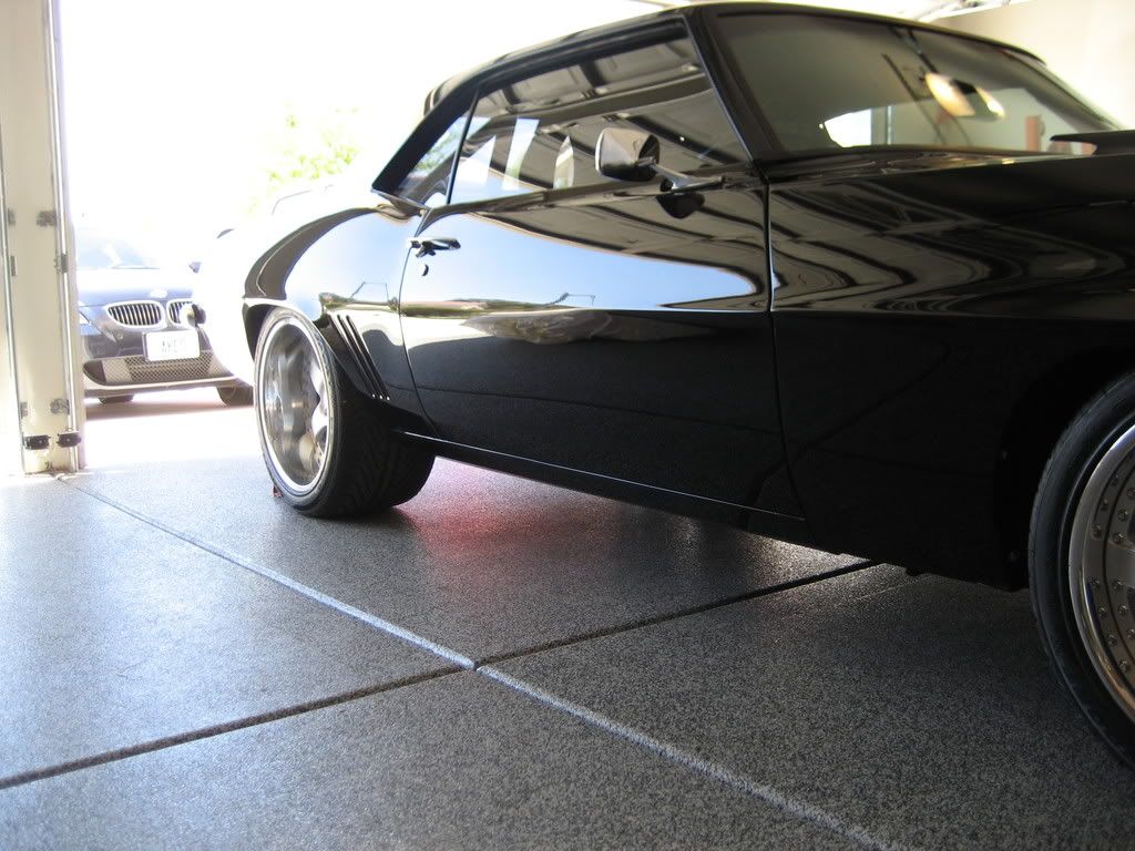

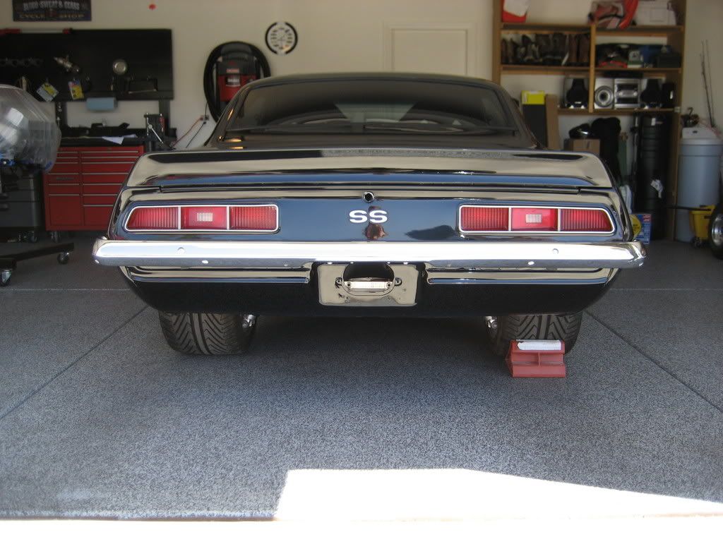

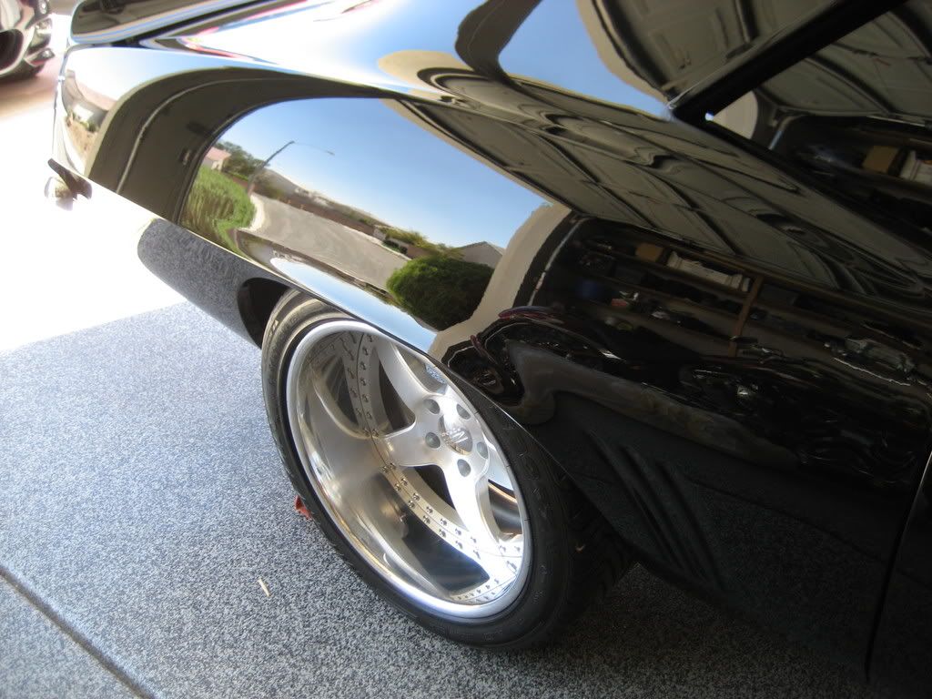

Check out my payback is on the ground thread for the delivery. Here are the photos from today after some elbow grease. :D
http://i200.photobucket.com/albums/a...9/IMG_0651.jpg
http://i200.photobucket.com/albums/a...9/IMG_0655.jpg
http://i200.photobucket.com/albums/a...9/IMG_0657.jpg
http://i200.photobucket.com/albums/a...9/IMG_0654.jpg
Vegas69 03-31-2008 01:40 PM
http://i200.photobucket.com/albums/a...9/IMG_0652.jpg
http://i200.photobucket.com/albums/a...9/IMG_0658.jpg
http://i200.photobucket.com/albums/a...9/IMG_0653.jpg

Vegas69 03-31-2008 10:53 PM
Thanks guys....ZE Boost brushed centers and the wheels had to be narrowed from 13 to 12". It was originally around 6.25 but probably closer to 5.25 now. Lenie you would have to call Frank at Prodigy on the rear and backspacing currently. They are pretty damn tight in there. I guarantee Frank will tell you to order your wheels and measure regardless since you can't be off by much. Specs on wheels and tires is 19x12 345/30/19 Michelin Pilot Sports 18x8.5 front 255/40/18 Pilot Sport(More than likely will be changed to 18x10 with a 275/35/18) I have bigger fish to fry now.

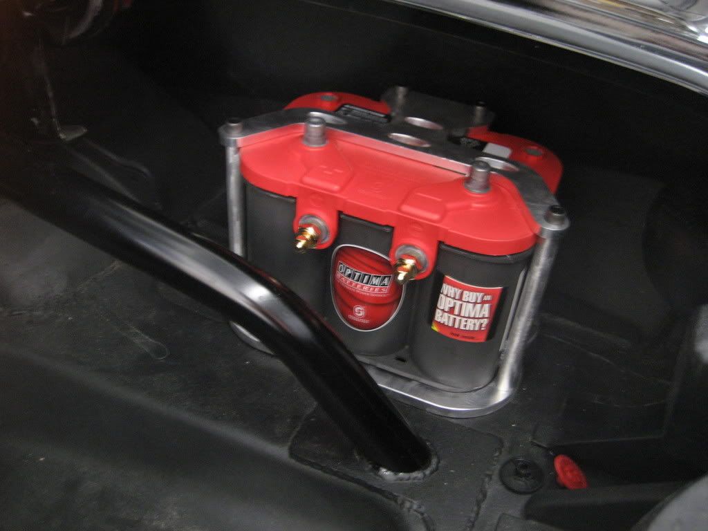

First thing I did was mount the battery in the trunk. It is made for a red top Optima. Mother F....er didn't fit of course. I had to flip over the top bracket and egg out the hole and switch hardware. Turned out nice though.:thumbsup:

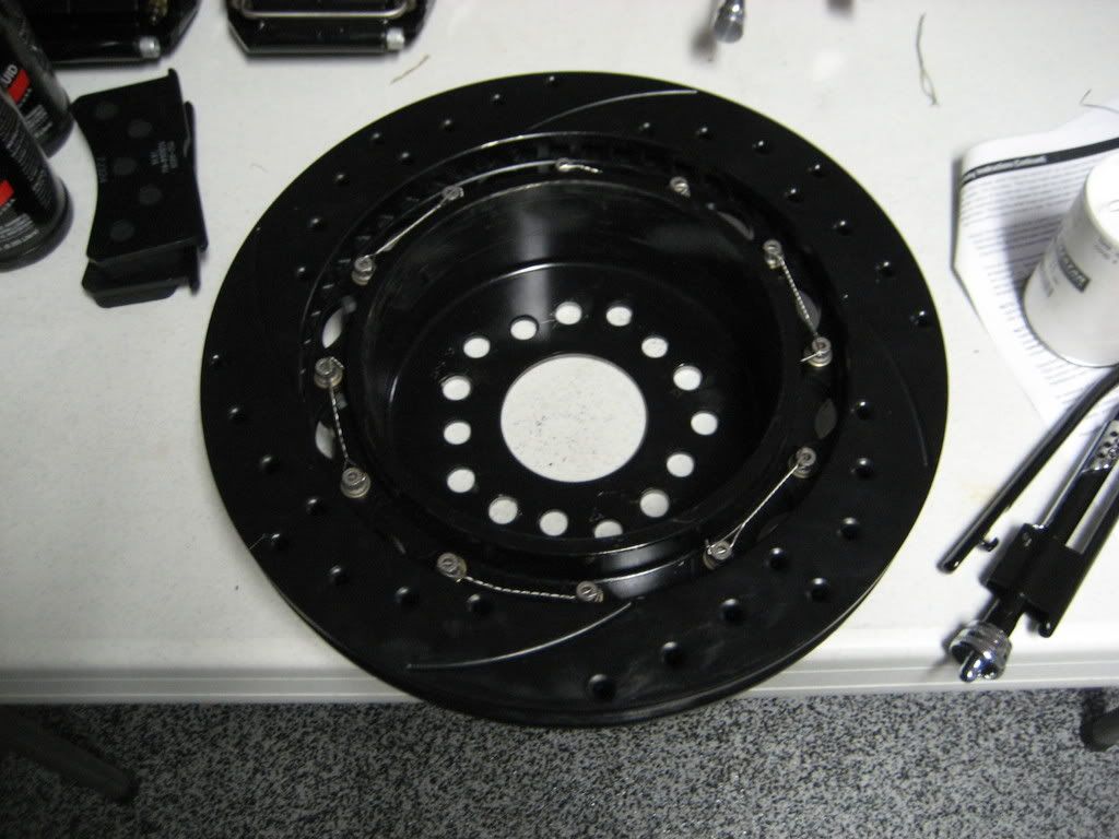

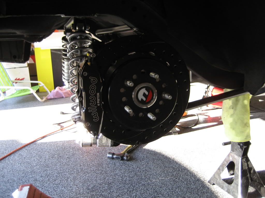

My brakes showed up, unfortunately my subframe change screwed me on the front brakes and they sent brakes for a stock sub. Wilwood dropped the ball there. I do have the rear brakes all ready to go minus the brake lines from the hose to the calipers. Just waiting on the rear end bracket. I did have to enlarge the stud holes in the rotors quite a bit. There is a shoulder about an 1/8 inch off the flange. The center hole needed enlarged very little. They fit perfect now and I have the parking brake adjusted and the rotor to caliper clearance is within spec. They look gooooood withthe wheels on but I was to lazy to lift those heavy sucker on there for the photo.

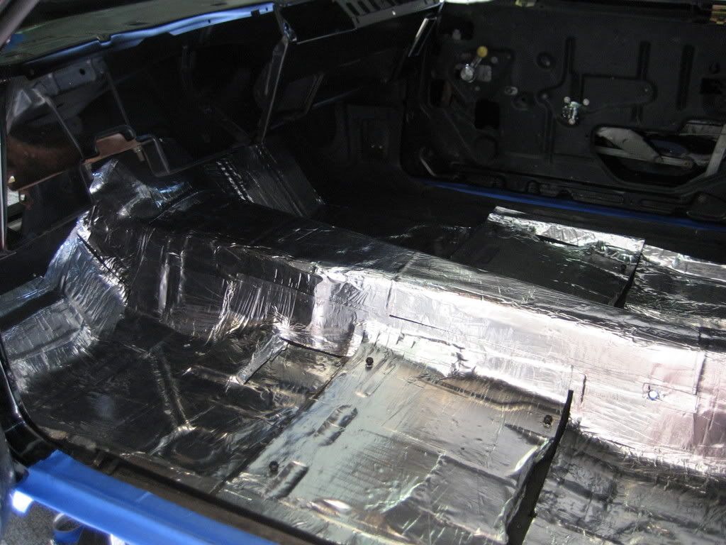

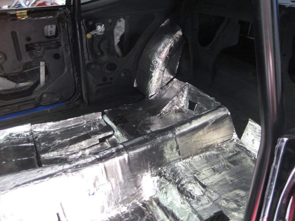

Next I ordered 40 sqft of second skin sound deadener. It wasn't to bad once I got the hang of it. Undecided on the firewall. Not real excited about using an insulator that could be very messy incase it decides it wan't to come loose. This should help substantially with road noise and exhaust resonance.
http://i200.photobucket.com/albums/a...9/IMG_0707.jpg
http://i200.photobucket.com/albums/a...9/IMG_0706.jpg
