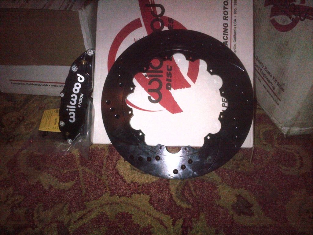

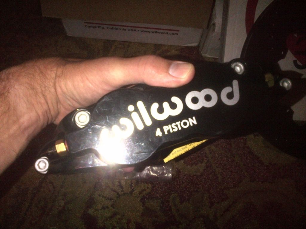

Hm no progress:( just some shiny parts to look at:D
http://i291.photobucket.com/albums/l...ca/wilwood.jpg
http://i291.photobucket.com/albums/l...inca/wildo.jpg

Flash68 07-13-2012 11:12 PM
I'm a little disappointed this didn't get the 12 piston Wilwoods. :unibrow:

Rick D 07-14-2012 05:36 AM
Rob how come no 6 piston?? Even Dave has 6 pistons now :lol:

FETorino 07-14-2012 02:06 PM

Thanks the new Wilwoods are a work of art JMO.

I can't hope to compete with the brake bling Dave scored a deal on. I'll just have to settle for this small stuff:lol:
So you're calling my Torino a truck? OK As RS and Summers & Sons showed trucks are really fast:unibrow:
Silly rabbit these are for the rears.:D I had a rear set up for a non floater and Mike at Wilwood was a huge help in working to get Speedway the right parts to use my stuff on the new floater. The new calipers are pretty cool with an internal crossover passage that eliminates the exterior stainless tubing.
The front will get matching 6 piston calipers with 14" rotors all the way around (yes 14 is overkill and yes in addition to my 19 or 20" rear wheels I know I'm adding unneeded unsprung weight)

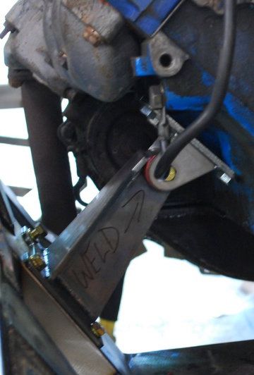

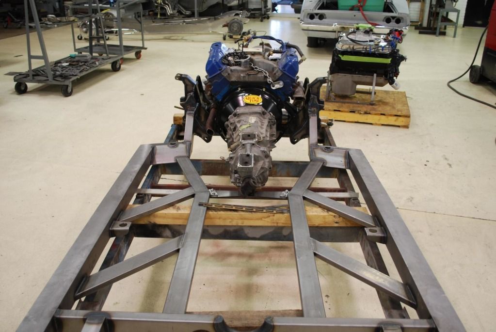

FETorino 07-16-2012 08:23 PM
Phil and Chris sent me some progress pics.
This is my dirty old 390 sitting in the chassis but dimensionally it's identical to my AL Pond side oiler. It's sitting nice and low and back thanks to that shiney low profile Dailey dry sump.
The Wilwood 4 piston calipers and 14" rotors will look better when they are bolted to that Speedway mod-lite floater.
It's getting closer.
http://i291.photobucket.com/albums/l...inca/rsch8.jpg
http://i291.photobucket.com/albums/l...inca/rsch2.jpg
http://i291.photobucket.com/albums/l...inca/rsch7.jpg
http://i291.photobucket.com/albums/l...inca/rsch5.jpg
Ron in SoCal 07-16-2012 09:23 PM
Looks sick Dog. :thumbsup: Do the frame rails extend out to the rockers on your love boat? :D
214Chevy 07-16-2012 10:51 PM
Sweet frame bro!! :thumbsup: :thumbsup: What color are you powdercoating it?
Roadster Shop 07-17-2012 08:38 AM
The frame rails do extend all the way out to both port and starboard rocker panels. :unibrow:
The design of the floor allowed us to give the car/boat a wide platform with out a lot of modification to the original floor. We are going to be making mounts to tie in a roll cage to the frame rails as well which will give it much more strength than just going to the floor.

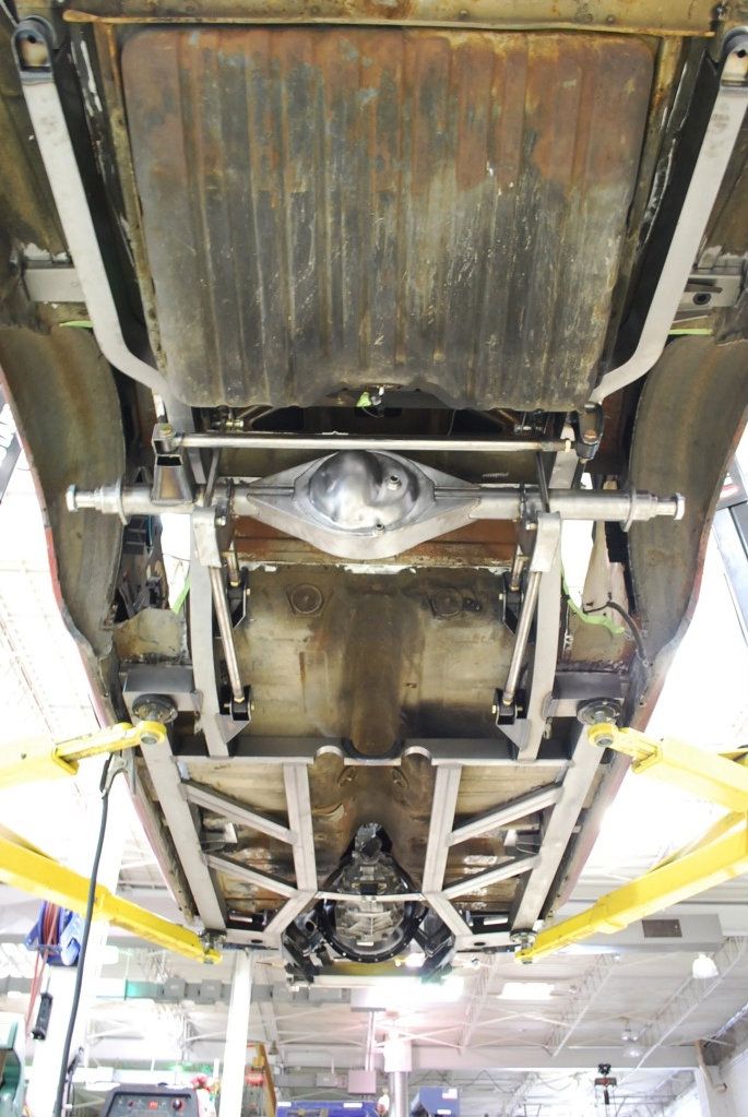

Somebody is working on my car. Phil shot me some pics today. They are making some custom new torque boxes to mount the body to the frame. Of course they found some rust in a floorpan so I need to have some additional metal work done.
http://i291.photobucket.com/albums/l...storquebox.jpg
http://i291.photobucket.com/albums/l...rsunderTor.jpg
http://i291.photobucket.com/albums/l.../rsundertr.jpg
Speaking of rust look how good that gas tank looks next to the chassis:rofl:
http://i291.photobucket.com/albums/l...a/rsundert.jpg
