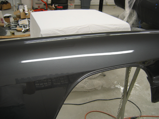

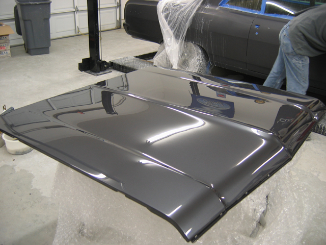

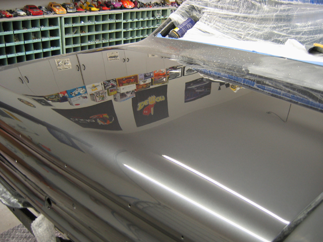

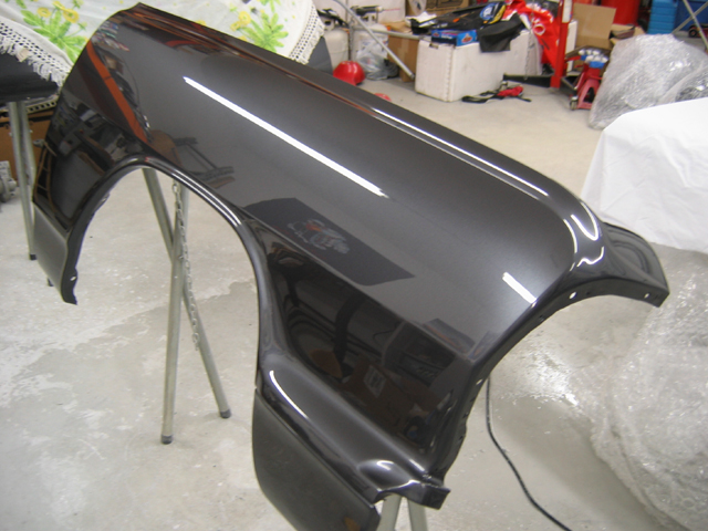

camcojb 03-21-2008 10:26 PM
finished up the other front fender and hood.
http://www.camcojb.com/temp/malitude 332.jpg
http://www.camcojb.com/temp/malitude 329.jpg
http://www.camcojb.com/temp/malitude 327.jpg

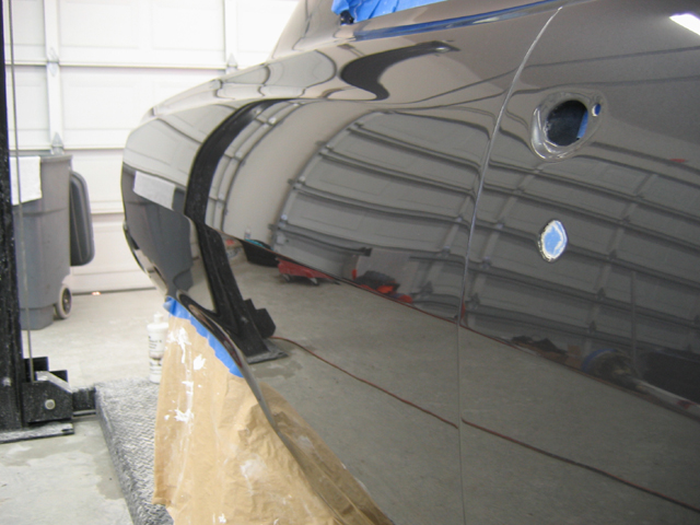

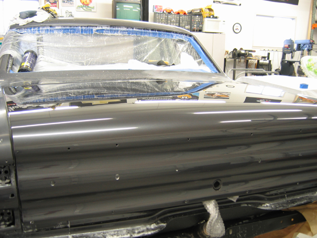

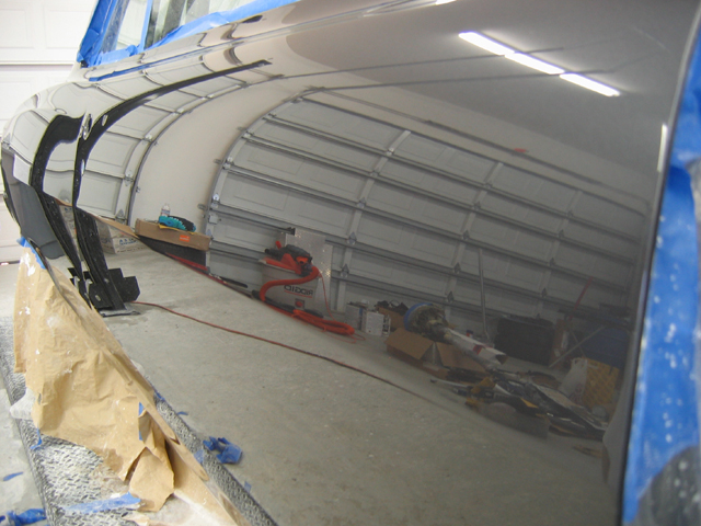

camcojb 03-22-2008 06:58 PM
ok, this will be the last paint update until the car is more completed. Today Jim and I finished off the passenger door, 1/4 panel, and trunk lid, along with some misc small stuff. Should be done buffing tomorrow........... :thumbsup:
Here's the trunk; ignore the mess in the background, the shop is thrashed right now.
http://www.camcojb.com/temp/malitude 334.jpg
http://www.camcojb.com/temp/malitude 339.jpg
here's the door and 1/4 panel; the door is not fully closed but it's taped up so I didn't want to untape it to close it completely...............
http://www.camcojb.com/temp/malitude 336.jpg
http://www.camcojb.com/temp/malitude 337.jpg
awr68 03-22-2008 07:11 PM
Like a mirror!! :bow:
camcojb 03-22-2008 07:15 PM
thanks Tony. It takes great bodywork, great painter, and then TONS of sanding and buffing.............. :faint: I am completely beat up right now, no idea how Jim does this on a daily basis (and loves it!!!!!!!!!!) Guys a nutball................ :rofl:
