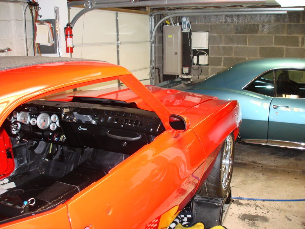

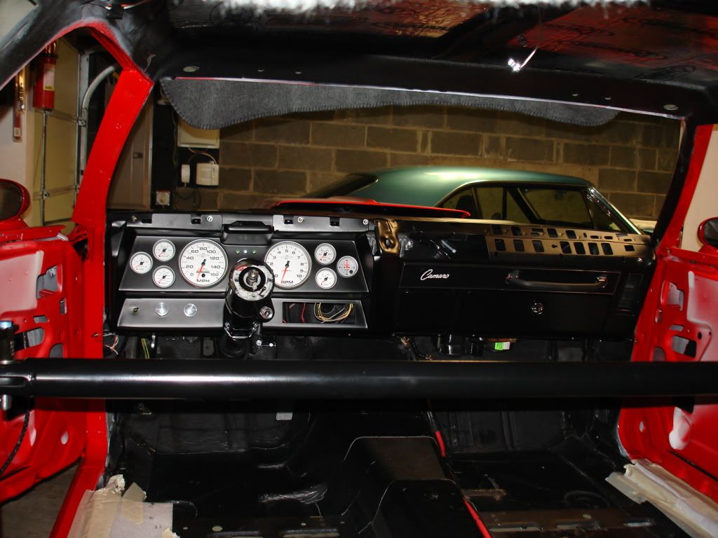

The gauge cluster really motivated me. Wired all the guages and bolted it in the car. I cant believe how nice the DSE dash fit, and how structural it feels once bolted up to the dash frame. I think I have over 75 hours invested in wiring, my OCD kicked in while in the dash harness soldering all connections even crimp connectors that go in a connector housing and using two to three pieces of shrink tubing on every joint :willy: . I guess you cant be to safe, I have this rubber strip edgeing that I applied to all sheet metal edges that wires were resting on(I need a wiring detox program). I think I see the light at the end of the tunnel, just have to install the front light harness and maybe the engine will go in next. The engine compartment harness hopefully will be mostly plug in and dress.

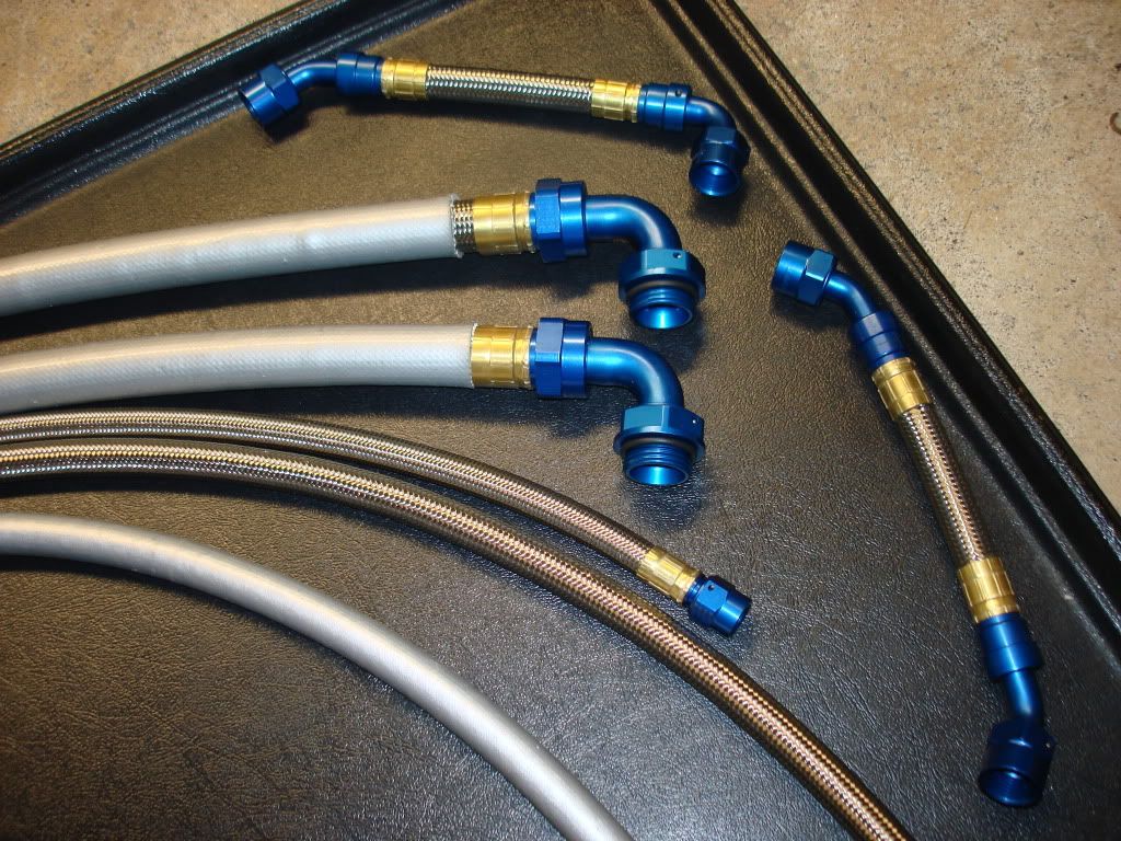

So the tubing benders I use are the Rigid 400 Series... and they have these various markings on them for where you need to start your bend - and this depends on where you MEASURED from.... whether you measured from the left of the tube or the right - and if you FLIP the tubing 180* then you need to reverse where you set the mark. SO if you measured from the left and you need to flip the bend then you'd set your mark using the R (right) instead.
Personally -- some times I get so turned around that I have to just stop and regroup! :rofl:
This is a photo of what I use. Note the bend radius. This has to be subtracted from your measurement. So lets say you're going to need a tube 9" long that is straight line measurement - but it hits the frame and goes 90* at the 9" point --- then your mark would be make at 8 1/16" because if you then set that mark in the bender - your tube is going to come out at the 9" point -- but this is where you get into the "right" - "left" - or "center".
Maybe Mark will jump in here and try to help me out -- cause it gets real confusing and is even worse trying to write it up here in a post!
http://i919.photobucket.com/albums/a...x/IMG_1026.jpg

My signature shows that tool line... and 67 mentioned the PTFE lines. I have a special saw set up - for cutting braided lines. It doesn't mash the ends of the PTFE - it doesn't melt them - and it cuts the braided part absolutely square and without fraying. The other thing I found that really helps is the have the aluminum jaws for the vice... set up to clamp and hold the fitting ends. And the other tool for the PTFE is a hand operated tool to set the ferrel. Without this stuff -- you're just in for a fight... So it's the tools that make me "smart" not anything else. My problem is - I can't remember I have the tool! :rofl:

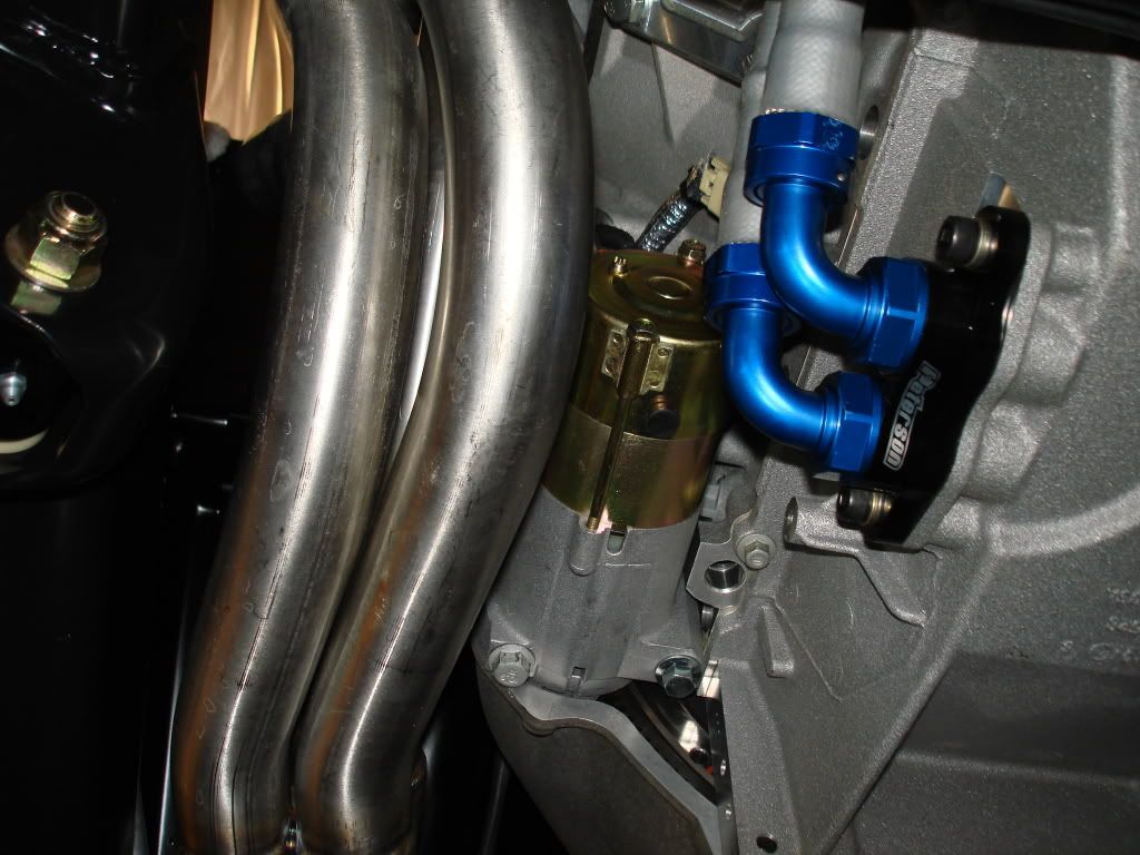

Had a bit of a clearance issue with the dry sump fittings being so close to the header tubes, so I got rid of the male theard to male AN12 adapter.
http://i168.photobucket.com/albums/u...Picture013.jpg
This is the difference in space between the two fittings.
http://i168.photobucket.com/albums/u...Picture026.jpg
