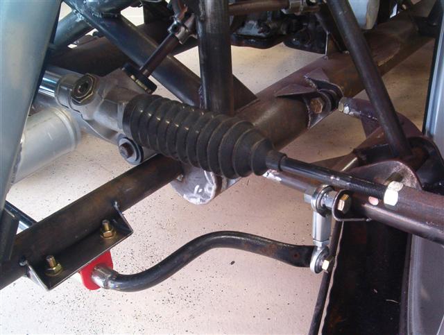

I have gotten a few more things done, and continue to move closer to wheels on. Steering is back on and all hooked up. Also I have plumbed all the brakes. Still haven't tightened all the bolts yet, I will have to soon, but I will have to find time in large enough blocks to do all the squaring. But now to get to why you all tune in here. PICTURES http://www.clubcobra.com/photopost/d...206_Small_.JPG http://www.clubcobra.com/photopost/d...207_Small_.JPG http://www.clubcobra.com/photopost/d...209_Small_.JPG http://www.clubcobra.com/photopost/d...210_Small_.JPG (etc....) |

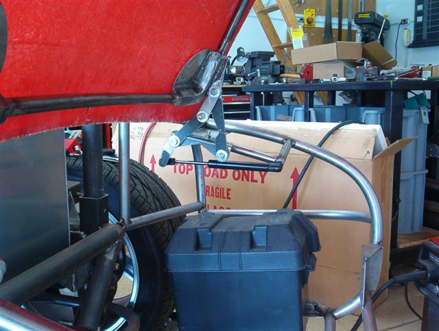

Well, It's time for another installment from "I really don't have a life". I wanted to run the battery cable along the frame before I took the car off the jack stands, Yaaaa-Riiiiight (think Office Space). Turns out I would have to install some of the fiberglass panels I made two winters ago before I could do the job properly. So I had to refit, clean up, and coat them with bedliner before putting them in, but hey it's done now. Have the main battery cable and the ground run. Time for the pics....
Refit the trunk parts (done). http://www.clubcobra.com/photopost/d...233_Small_.JPG Should I go with or with out the battery box? http://www.clubcobra.com/photopost/d...234_Small_.JPG I have the fuel tank out for a better view http://www.clubcobra.com/photopost/d...235_Small_.JPG http://www.clubcobra.com/photopost/d...236_Small_.JPG battery cut off switch http://www.clubcobra.com/photopost/d...237_Small_.JPG Rear panel with access cutout not mounted yet http://www.clubcobra.com/photopost/d...238_Small_.JPG And finally out to the starter http://www.clubcobra.com/photopost/d...239_Small_.JPG Now once again it's time to start begging for feedback so I may receive the energy to keep going, so lurkers speak up, old friends keep it up. Patrick |

I suggest that you run a battery box. Some of the rules may stipulate that you must have a box and it would stink to have to go back and put one in later. did i mention that the car looks incredible. |

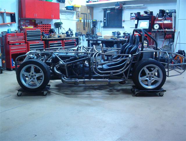

Hey, I think I have the under car stuff run, now I can get this thing on the ground. Ye-Ha so I put her shoes on and set her on the ground. How does she look? I think with the engine in and body on it should sit down a little more. Don't fret about the roll bar height it is just sitting on the mounts not in them.
http://www.clubcobra.com/photopost/d...242_Small_.JPG http://www.clubcobra.com/photopost/d...243_Small_.JPG Time to go I have to put her back in the dollies Patrick |
