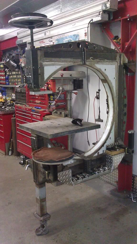

What did you use to cut out that sheet metal with?
E.rodz 05-29-2012 12:18 PM

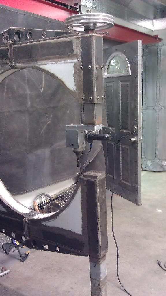

A little bit of everything. shear,tin snips right and left cut,hand nibbler,and a power nibbler that I have been working on this contraption for years just had a chance to use it on the center hole and it works!
