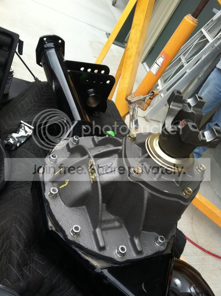

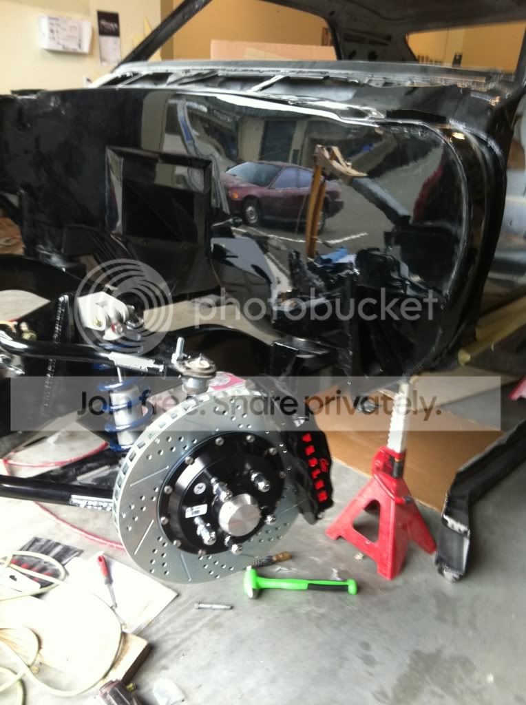

I did some more work today. Finished installing the subframe and installed a Currie center section into my Fab 9. Going to bolt in the rear end tomorrow and hopefully have the engine in tomorrow.

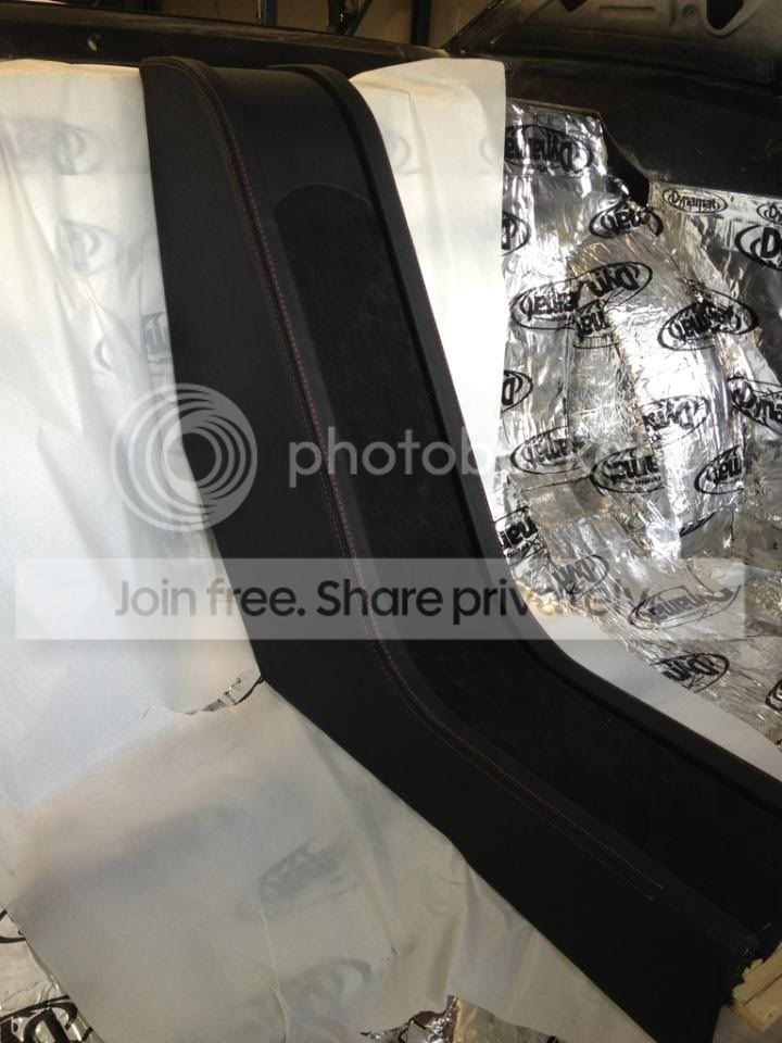

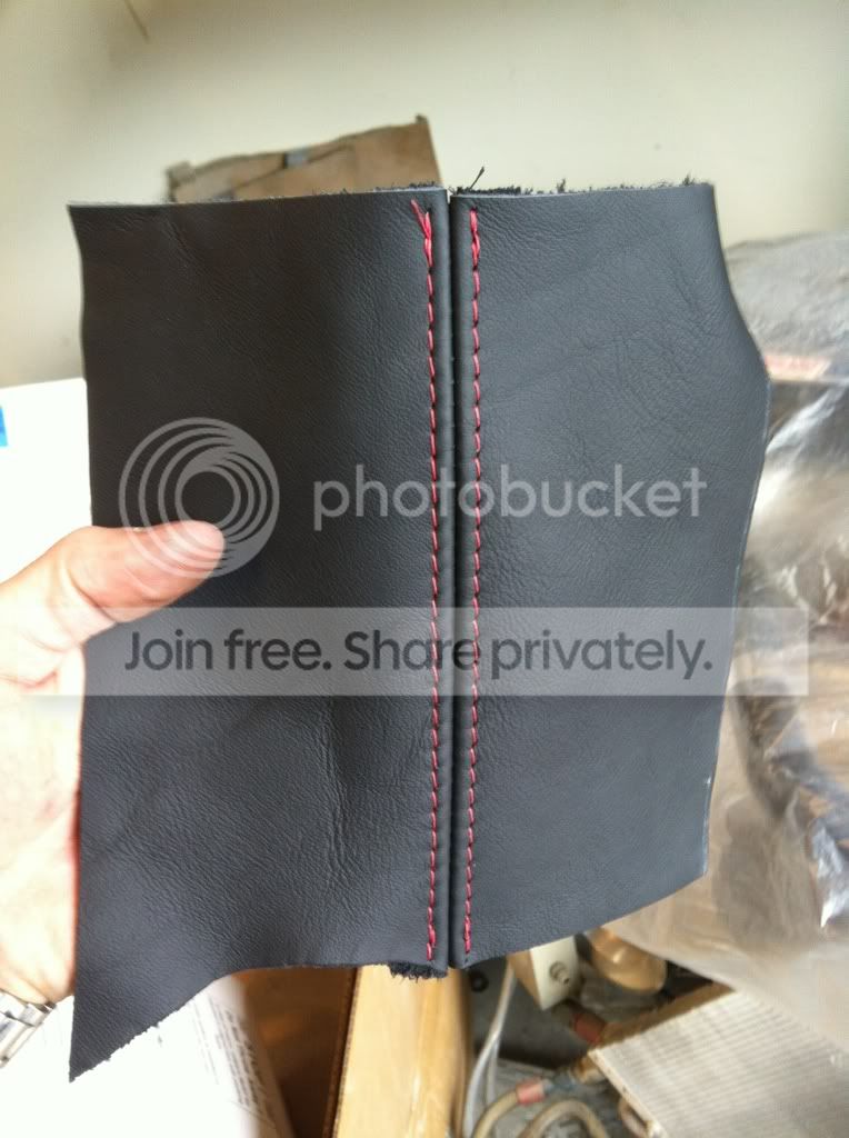

Did a test stitch of the new leather with the red thread. Should look good. Smells good

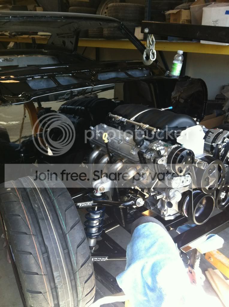

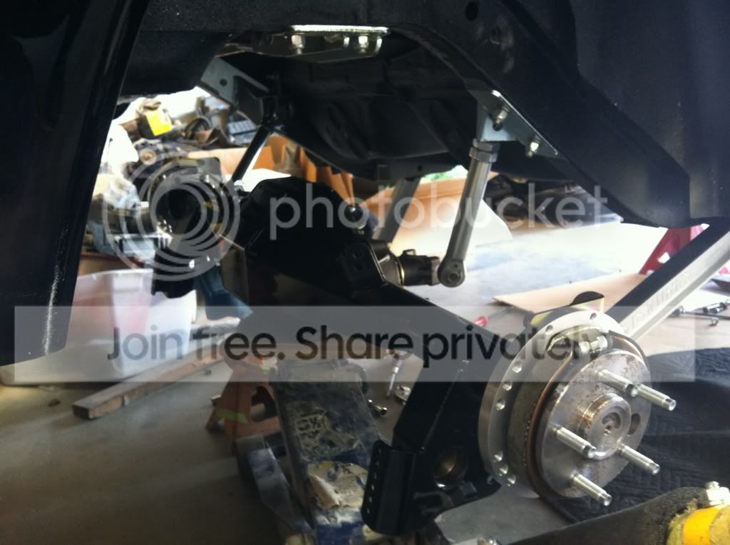

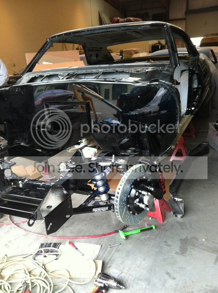

Spent another 9 hours today putting her together. She sits about 3" too high in the rear and I have everything at its lowest point. Maybe I need some shorter shocks?
Rear end is in, engine/tranny mounted and got her rolling finally!

Vince@Meanstreets 03-22-2012 09:18 PM
don't swap shocks till you get it all together. It will take time to settle. Nice work John....I hope your getting better valve covers later. :P.... or maybe just dip the engine in clear.
John510 03-22-2012 09:22 PM
Yeah I have some carbon fiber valve covers I still need to install.
Will it settle at least 2 inches?

scherp69 03-22-2012 09:43 PM
It's looking amazing John. I love the way the firewall turned out, especially this shot
http://i527.photobucket.com/albums/c...0/525d2326.jpg
Bryan O 03-23-2012 09:31 AM
While I did not measure how much my car settled, it did lower significantly. I think two inches is possible. Give it awhile is my advice. If I recall correctly, it could take a couple months to settle to its lowest point.
ps...I added a couple of pictures to my build thread showing the settle over three months. I didn't want to post them here and jack your thread. Nice progress, btw. :thumbsup:
Matt@BOS 03-23-2012 09:54 AM
I wouldn't worry right now. You still have A LOT of weight to add into the car. Sound deadening, carpet, seats, headliner, interior panels, glass, audio, front sheetmetal, exhaust, and fluids are going to add a significant amount of weight. I know Bryan just posted up pictures of his, and it isn't even done yet. When it is done, it is going to have to be raised not just once, but also after a few months of settling, maybe a third time after 9 months or so. DSE's springs never seem to stop settling. I've heard hypercoils are better, but who knows. I think with the 19" wheels your car's stance even with the G Bar will be just fine!
Matt

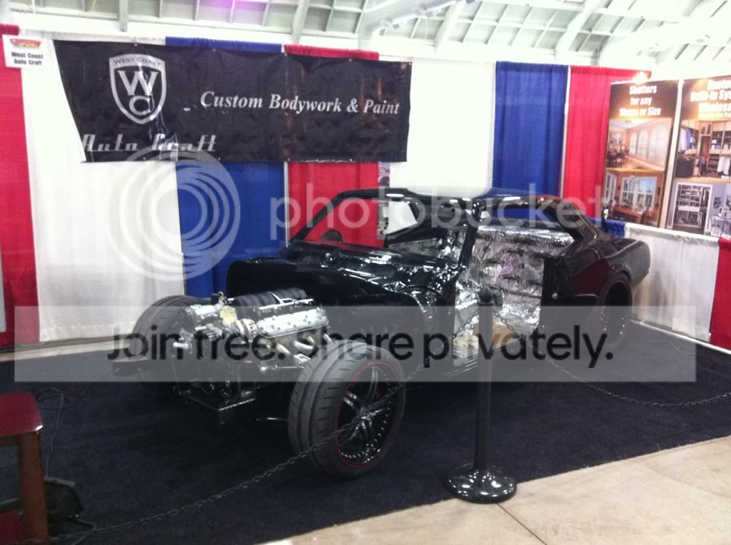

For now the coil overs are removed and a metal rod was placed in there for the show to have it sit lower until I get my correct springs.
WCAC guys pulled an all nighter and got the Dynamat in and got it ready to be a roller. I have a permanent smile today knowing that it rolls! Manifold is still in production at Ozmo so that didn't get to be displayed.

Blake Foster 03-24-2012 01:28 PM
Hey John car looks GREAT!!
to your question of will the car settle over time, Answer NO not at all with the Hyperco Springs.they are gaurenteed not to change in spring rate by more than 2% for 10 years if i remember correctly. You will need to geet shorter springs and shocks if your out of adjustment.
you now know the exact length of shock you need at ride heigth witht eh bars in the back so that will make it easy. you may still be able to reuse the springs. make sure the shock is close to the center of it's travel at ride height.

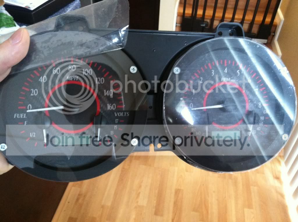

John you are going to love those gauges, we just did a set in a truck.. It measures top speed. 1/4 hour time, 0-60, and more- love it, and easy to program

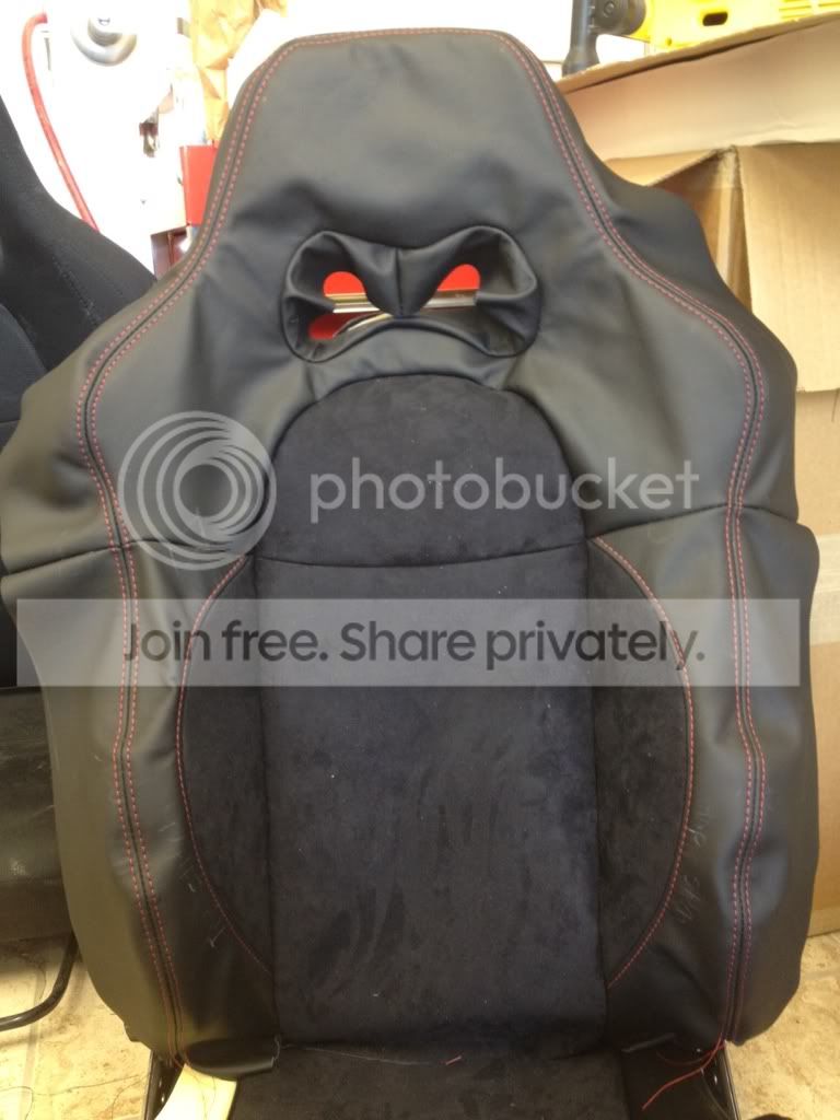

Got a sneak peak of my seat cover today!
http://i527.photobucket.com/albums/c...0/e6bacf91.jpg
