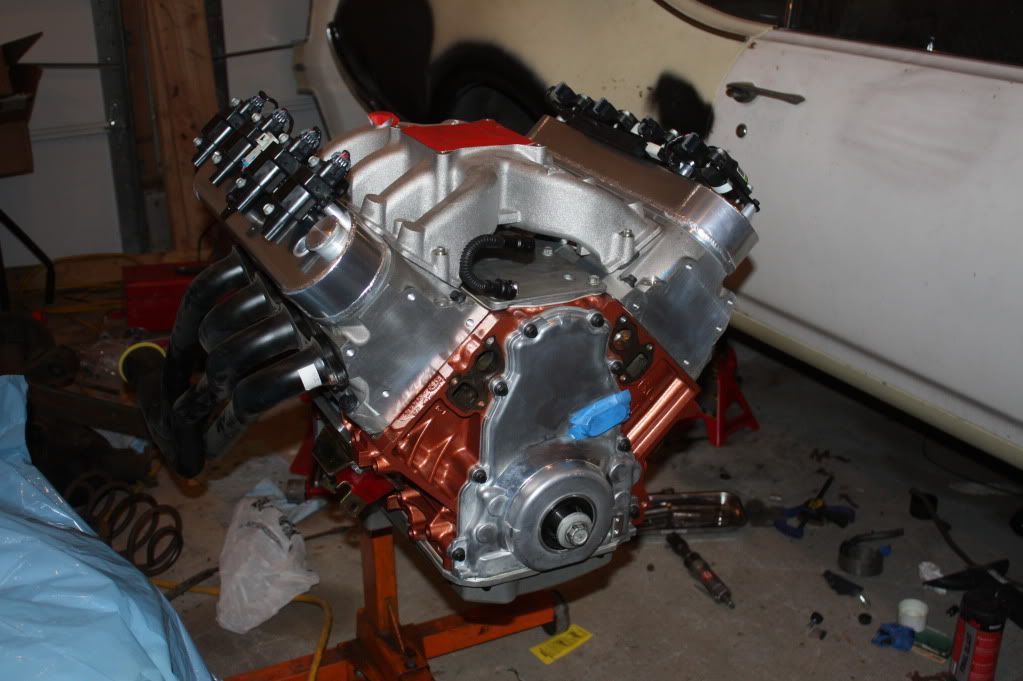

http://i908.photobucket.com/albums/a...1/IMG_8905.jpg
Project Red Rocket off this page: https://lateral-g.net/forums/showthread.php4?t=27033
Chad, special thanks to you as you have the exact same deal as I. I am planning on eventually going boosted with the Vaporworx set-up and need to give Carl a call to talk to him about the controller he is working on that is vacuum referenced.
Anyways, thanks a lot guys!!! I will let you know of my progress!
