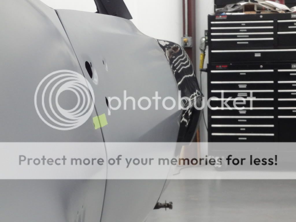

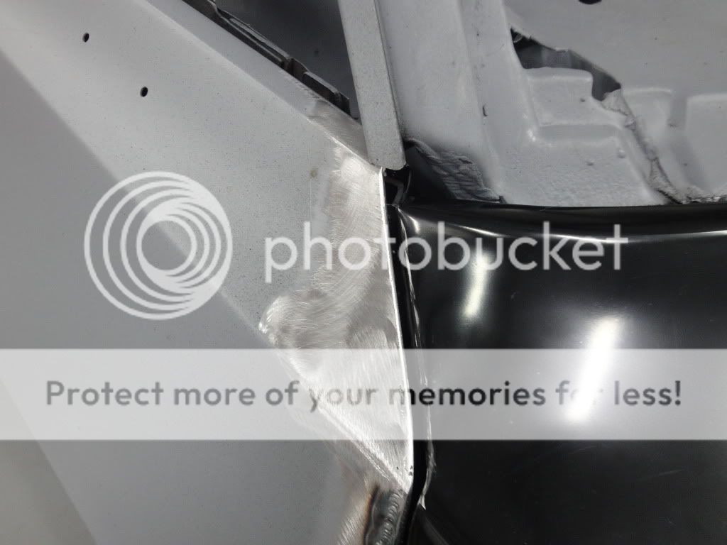

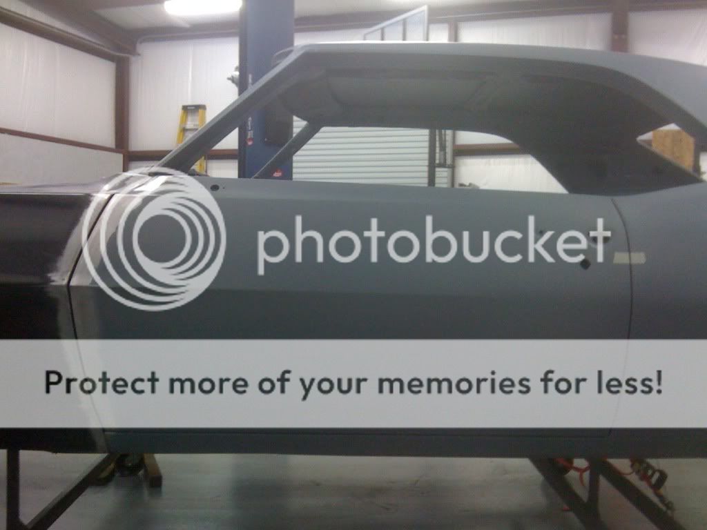

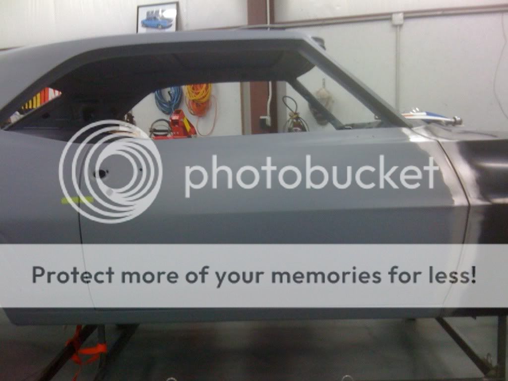

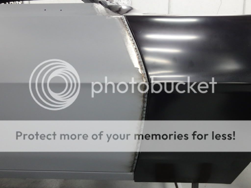

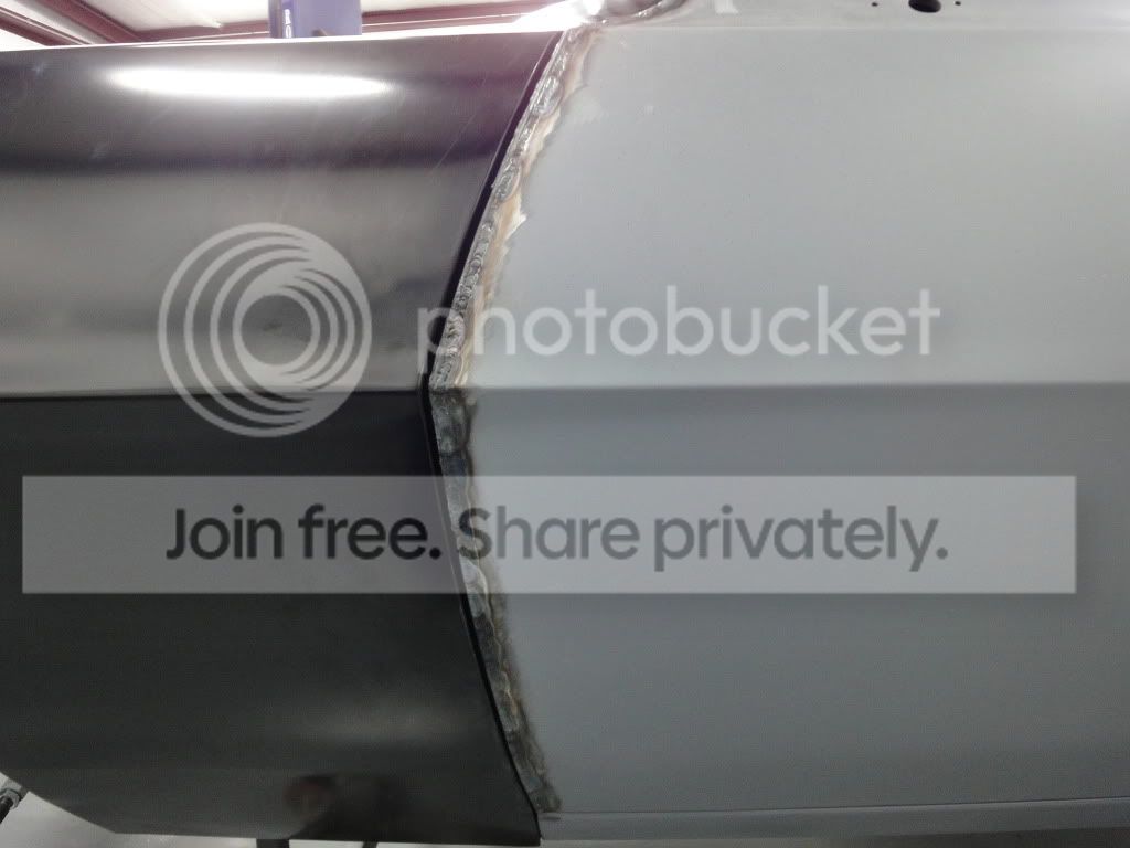

Over the holidays I had the car primed, installed the subframe and starting hanging the repop fenders. The first set was way off with the brackets, so I sent them back and got and another pair in. The brackets were correct but the gaps were huge and was going to require major attention to keep my 6 year old son from fall ing in and never to been seen again. Ok, Im exaggerating some, but 5/16"-3/8" gaps from fender to door was nothing to take lightly.
So, not exactly sure what my best option was and needing an expert opinion, I called the the resident expert fabricator and gave Dan from Holohan's HotRod Shop in Mooresville a call. I described the situation to Dan and was surprised when he told me, "No problem, I will come down Saturday, take a look at it and we'll work on it". I was not expecting that.
Talk about customer service, and having a passion for cars and wanting them look right, Dan (true to his word) drove 1hr 45 minutes along with Jack (the dog..aka "fur person")to my house, checked everything over and we started on the fix, which was to add filler rod to the door and alot of it.
Many thanks my friend for coming down and on a Saturday. Thanks for the help and pointers. It is very much appreciated!!
Now time to do some grinding and final gapping.

Did you guys just lay a bead on the edge ? mig ? tig ?
Jay Hilliard 01-11-2011 05:04 AM
No, we used 1/8" & 3/16" rod then TIG welded the rod to the door.

I needed advice as I wasnt sure what the best fix was with my situation. Add to door and/or fender, disect part of the fender or cut fender brackets and move. This was my first outing with repop fenders. I have read numerous threads, etc but I guess you have to experience it yourself. :D

My doors are original with AMD skins. I used AMD qtrs and fenders. The fenders had nice crisp lines and aligned to the door peak nicely. I was disappointed with the size of the gap between door and fender. However, adding some filler rod to the doors fixed the gap issue and its a nice 3/16"-1/4" gap now. I am pleased with AMD sheetmetal, especially the gauge of the metal and lines compared to other makes.

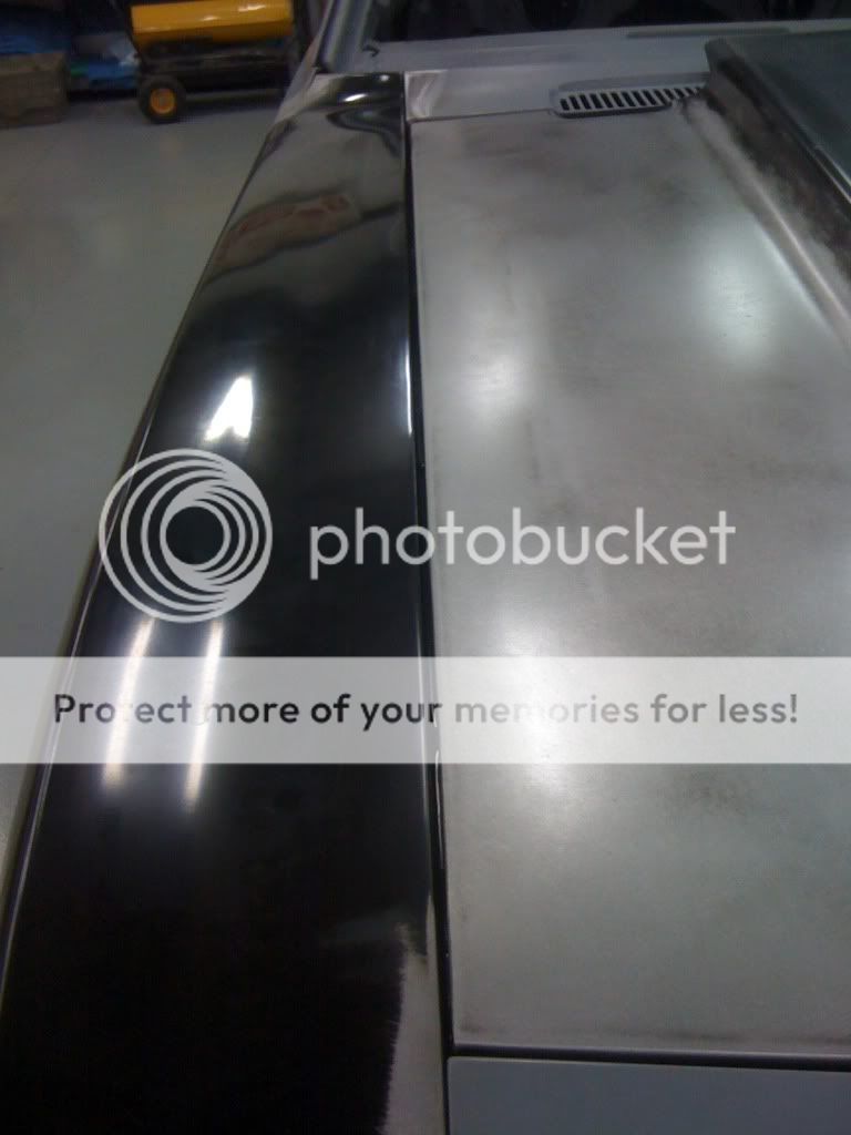

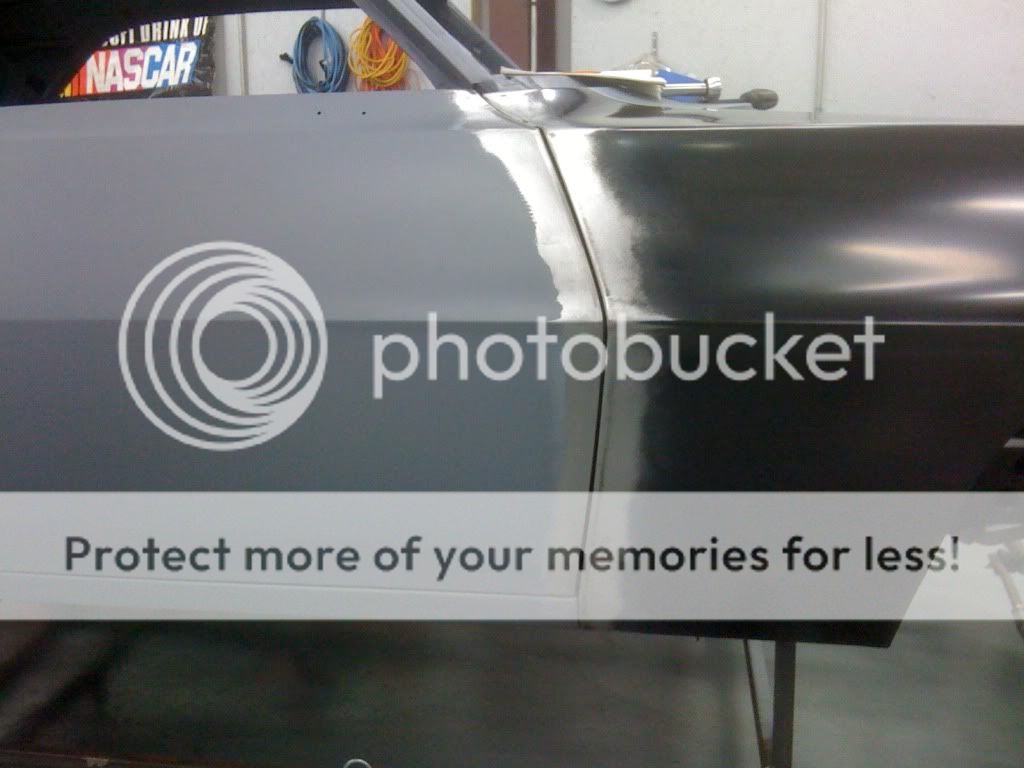

Here are some pics of the final door/fender gaps. I think they turned out awesome. I'm happy with the end result.

Thanks Jay for the picks on the door gaps, those are very tite, what would be the norm on door gaps? you and Dan are doing some sweet work. Makes me want to get started on my ride.:thumbsup:

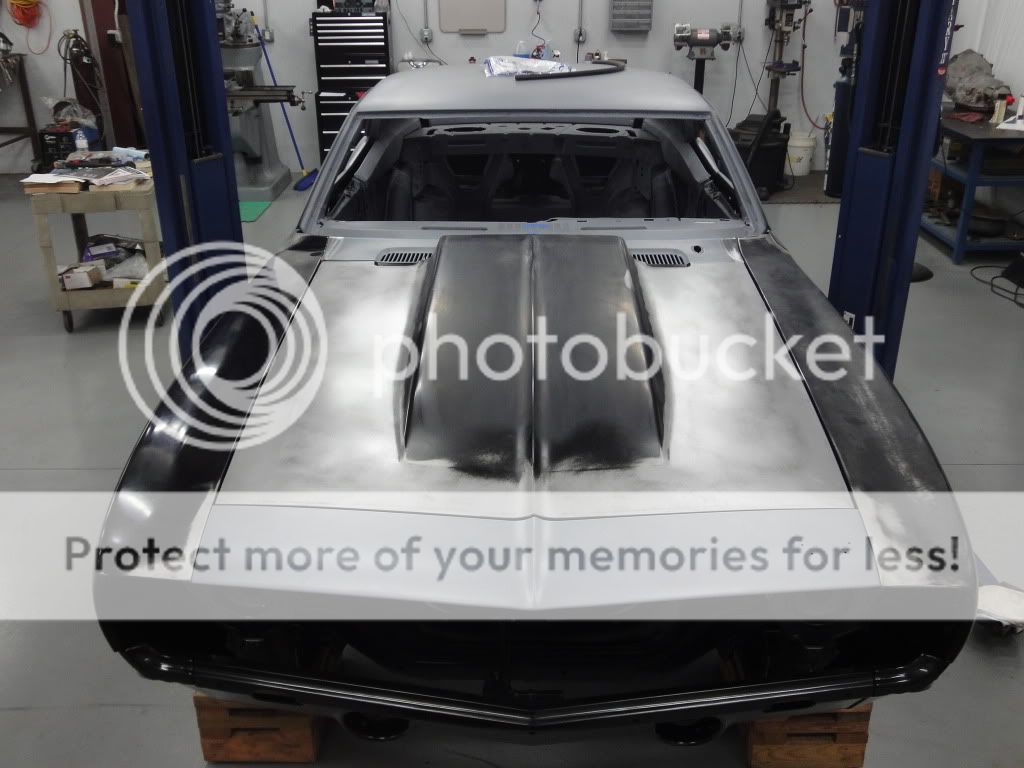

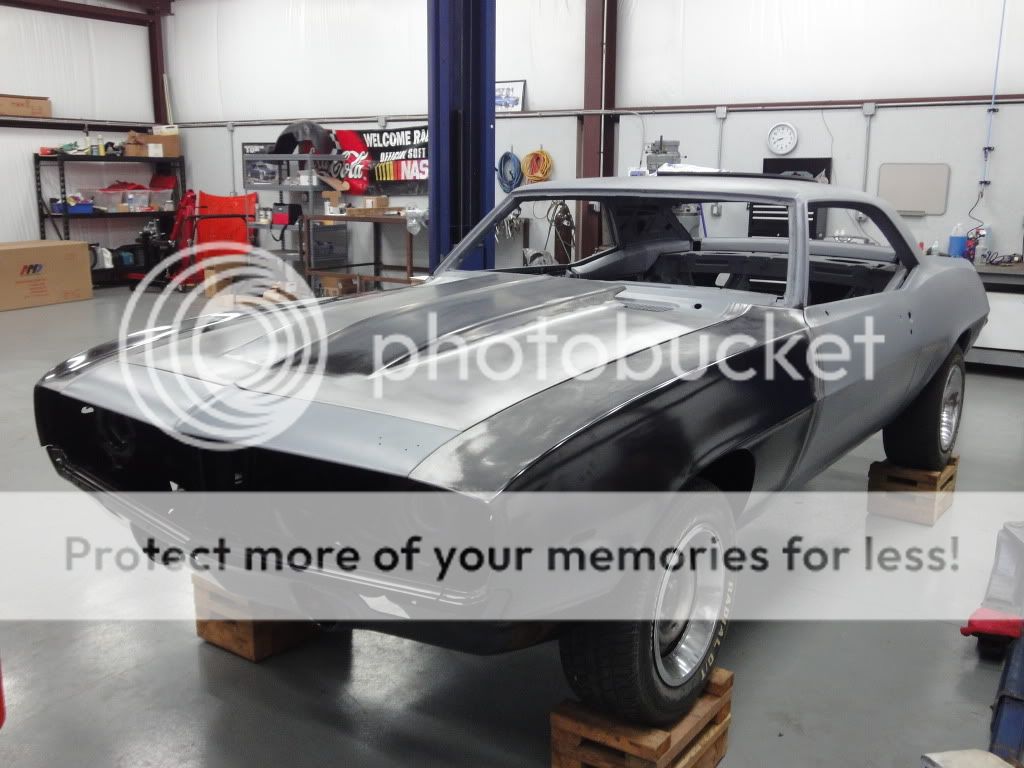

I took a break for awhile. I have been busy lately doing the small things, like fitting hood, headlight housings, grille, subframe connectors etc. I plan to get all this wrapped up soon so I can disassemble and put it on rotissere for seam sealing and spraying undercoating.
Jay Hilliard 06-06-2011 01:29 PM
Getting closer

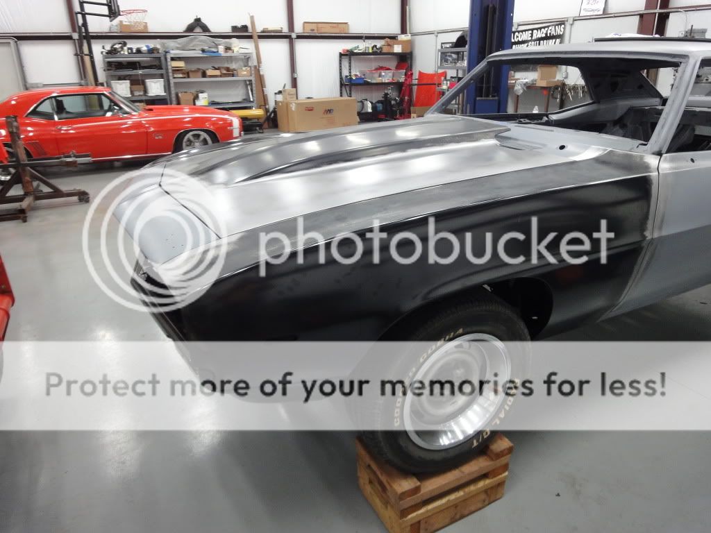

Finally got my hood gaps and cowl gaps like I wanted, etc. Put the leaf springs and rear under it Sat. and will install Hotchkis subframe connectors in this week.
