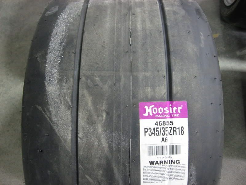

Drag Radials, Yummy! I wish there was a good 345 / 35 / 18 road race tire. I sure do like the way this looks!

73CPCAMARO 07-22-2010 12:23 PM
Originally Posted by ProdigyCustoms (Post 297549)
http://i169.photobucket.com/albums/u...r/DSC_0378.jpg
Hoosier and Kuhmo make a 345/35/18 autocross and road race compound tire. They are 26.8" tall. This is the size I am using on my Camaro.
https://lateral-g.net/forums/showthread.php4?t=23997
http://i80.photobucket.com/albums/j1...b/IMG_2722.jpg
