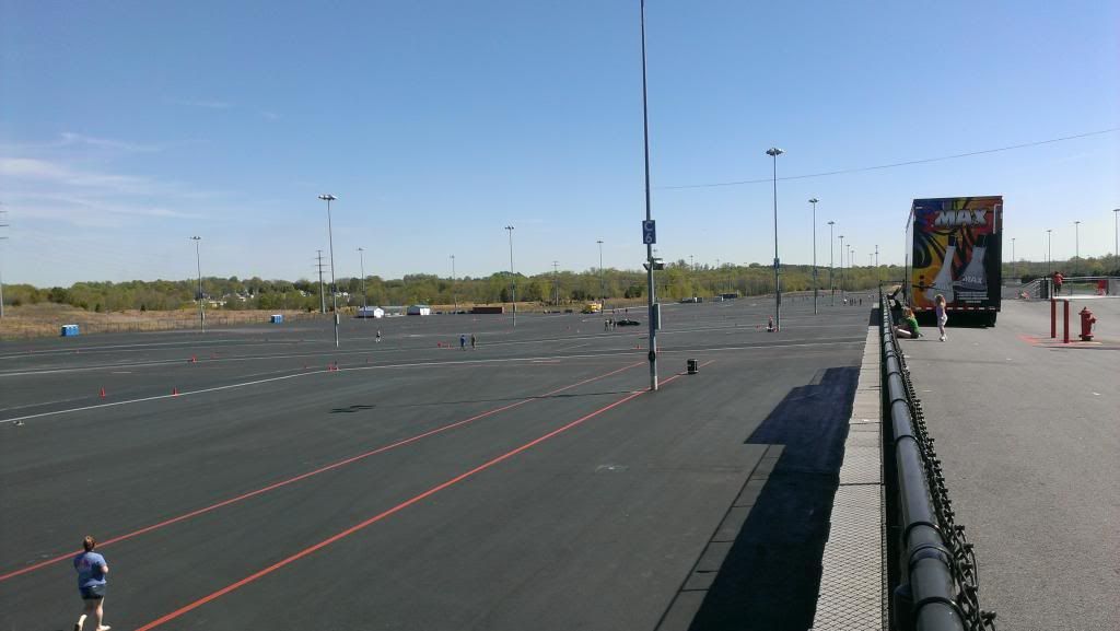

Last - I participated in the local SCCA autocross event @ Zmax Dragway this past weekend.
I saw Mike with his Duster there - he did pretty good as he beat my times.
This has been the first time that I autocrossed in over a year - and I have a set of Michelin Pilot Sport Cups on the back that are very worn - I was having a hell of a time getting traction out back when I was gassing it through the corners - it basically felt like a drift car and I was steering the car with the throttle. My times dropped throughout the day - and I manged to kill a few cones.
I actually finished second in Super Stock - Street Prepared at the event - I supposedly got a trophy but I had to leave when the last group was running due to other plans.
Pics and Vids below:

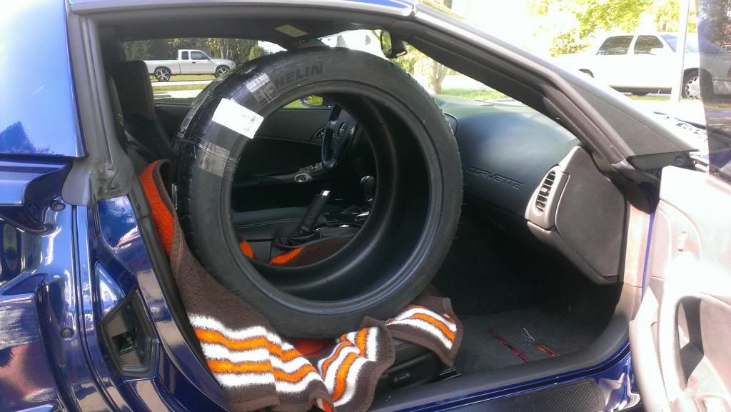

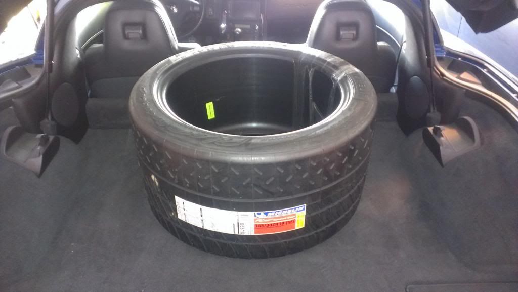

Still keeping busy around here.
I ended up selling the z06 exhaust mufflers and the wireless vacuum kit I had on the car on Craigslist. I listed them as soon as I put the Corsa's on.
I used that money to buy new set of rear tires.
The set of Pilot Sport Cups that I had put on previously where used - and well they are down to the wear bars after the Power Tour and a few Autocrosses this year.
Tirerack had a deal with these being over half off.
Talking about steam rollers - I ended up getting a set of 345x30x19's that will fit onto the stock z06 rear wheels.

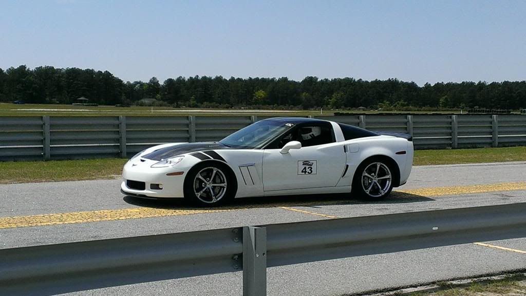

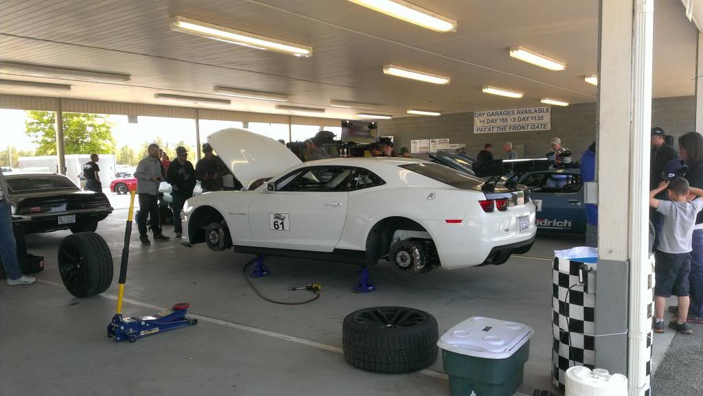

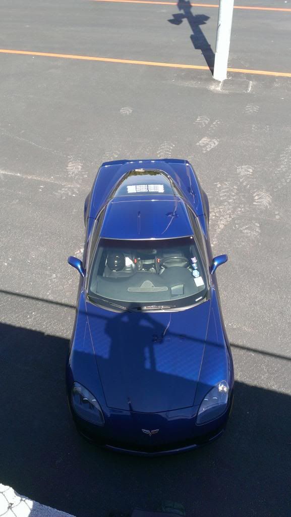

bonecrrusher 04-16-2013 05:22 PM

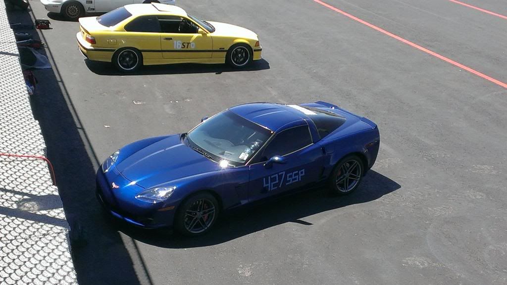

Time for some updates to this thread - its been a crazy couple of weeks.
This past weekend I particpated with my local SCCA club - and autocrossed @ Zmax dragway again.
I got 4 runs in on Saturday - and my first run was an 84.xx, and my last run was a 76.xx - not a bad way to drop almost 10 seconds.
I do not think there where any photographers there - but I got a couple pics - and vids.
Run 1:
Run 2:
Run 3:
Run 4:

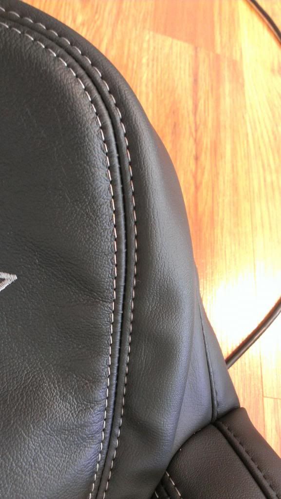

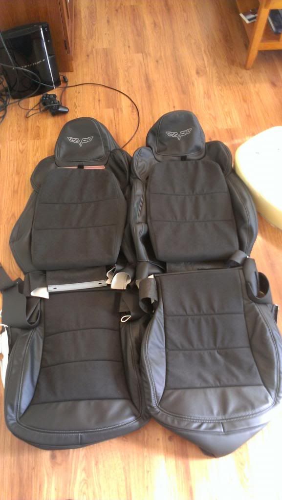

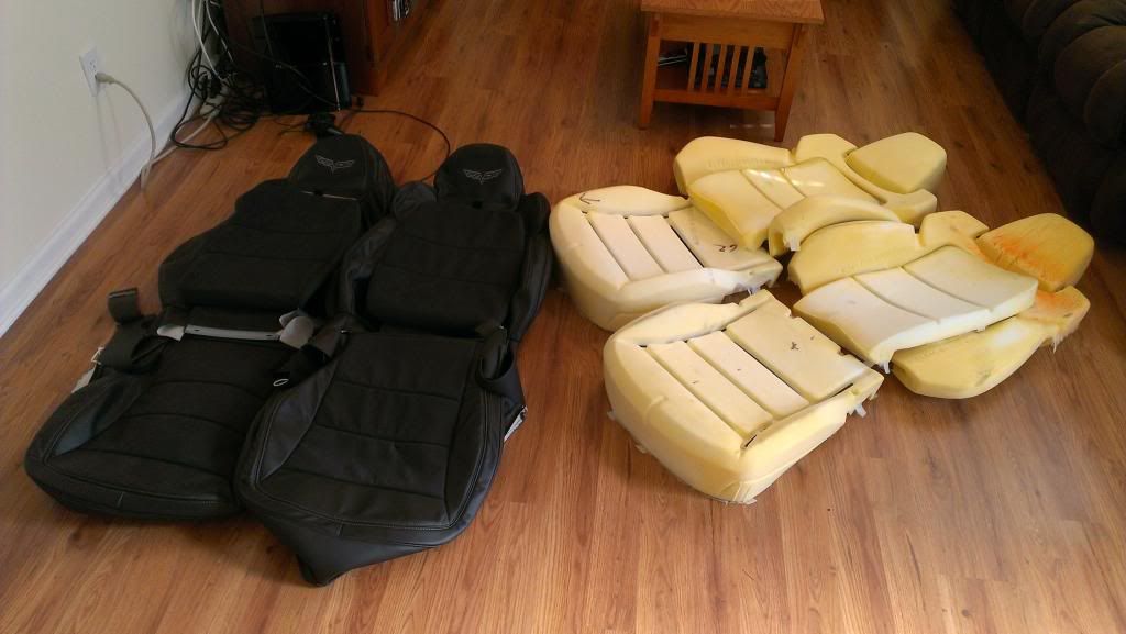

Second update - since I have the Hot Rod Power Tour coming up - and I am long hauling to Dallas TX and back to Charlotte - I have decided to rebuild the seats in the Vette.
They only have 40k miles on them - but after 5 Power Tours - they are showing there age and trust me after 8 hours the padding starts to suck horribly and gets uncomfortable.
So I ordered new 2013 seat leather skins, and foam from GM. I also ordered a seat rebuild foam kit that I am going to put in that adds a bit more padding as well.
The seat skins are black leather with Alacanta black suede inserts - also these have titanium stitching to match the rest of the interior - and have the C6 flags on them.
Pics:

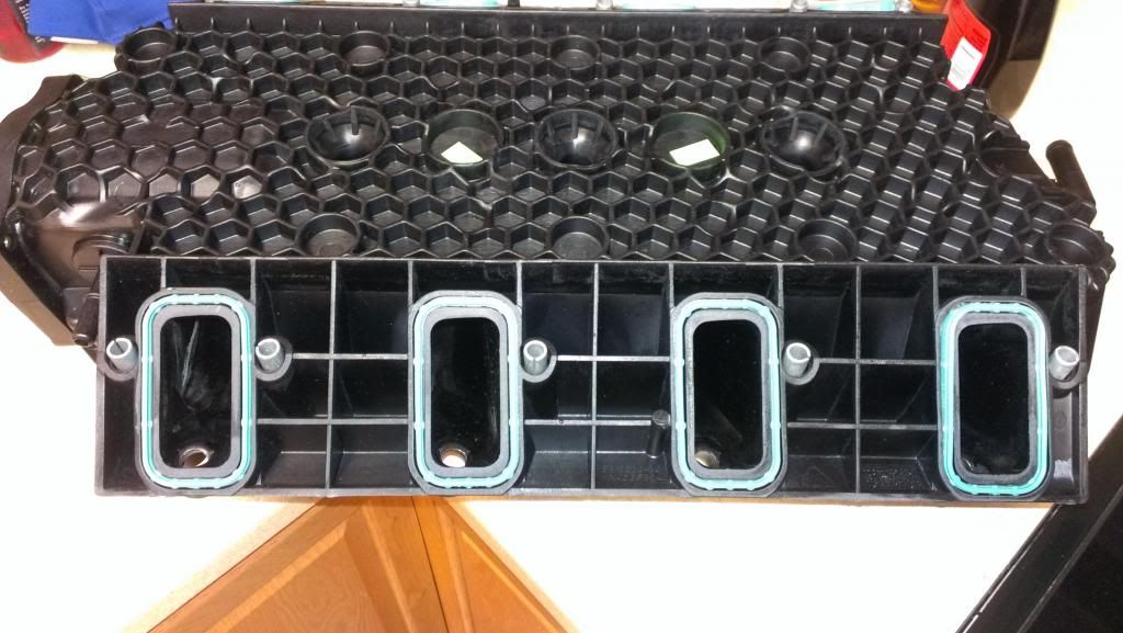

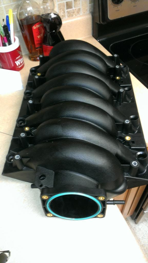

Third update - I have decided that this car will not be see boost in the immediate future - those Edelbrock blowers are in no way affordable - and are too rich for my blood.
So I am going to build up the LS2 that I have with the following:
CNC ported L92 heads.
LS9 camshaft.
GM LS3 intake manifold.
Lunati upgraded trunion bearings on brand new LS3 intake/exhaust rockers - on order.
LS3 intake valves - still need to order these.
The intake just came in - I ended up ordering it from Amazon - and got it for about 200 to my door.

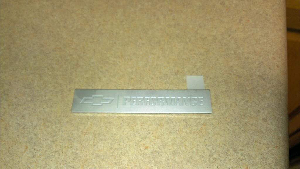

I also ordered this - not sure where I will use it - but this is the new Chevrolet Performance badge that comes on the new 2013 Camaro ZL1.

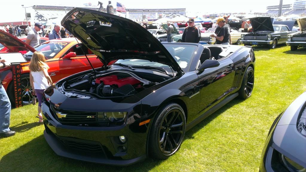

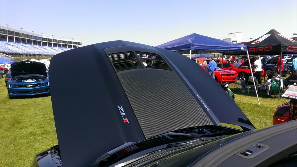

A few weeks back was the Food Lion Autofair @ Charlotte Motor Speedway - its a huge car show that encompasses the entire speedway.
I entered my car with the Corvette club that I am in - and brought home some bling.
A few select pics:

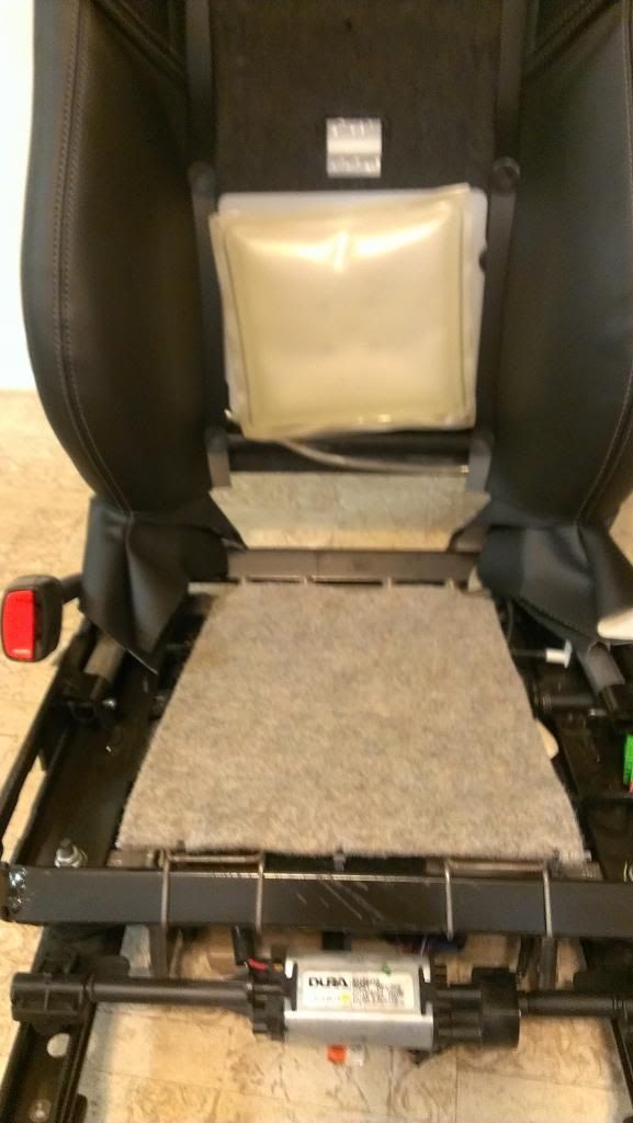

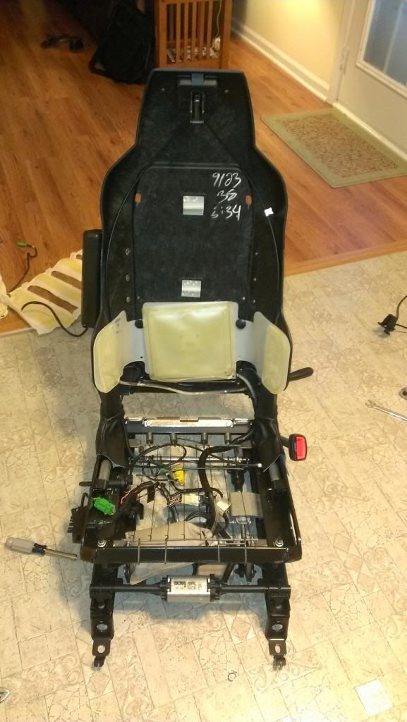

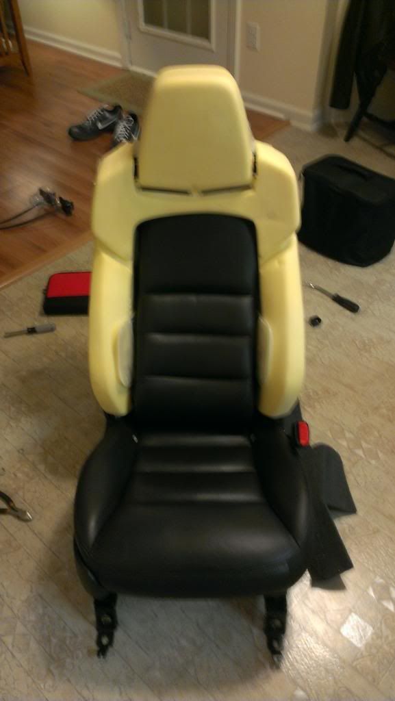

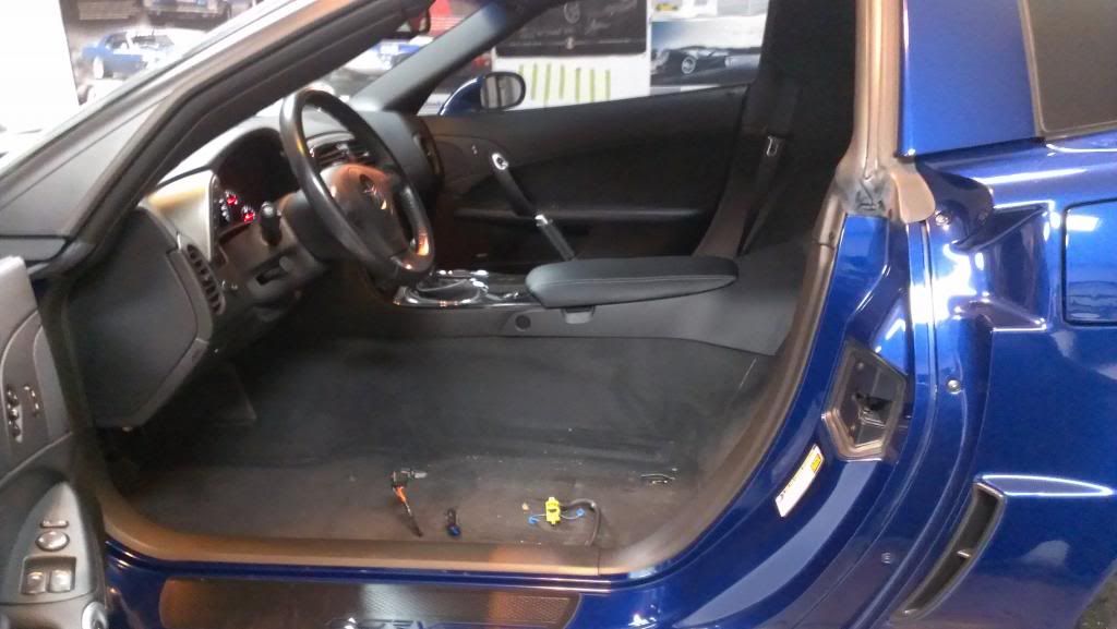

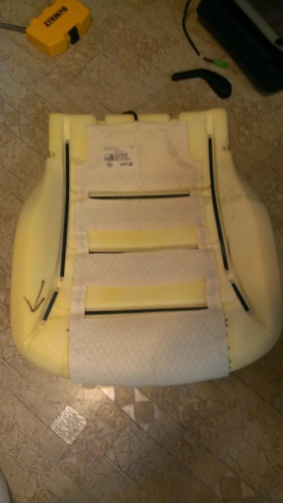

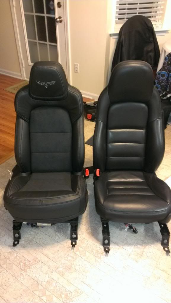

As for the Vette - the interior is currently in pieces.
I am 50% done with the seat swap - and doing upholstry work is a total PITA! Between the airbags, the heated seat element, lumbar support - these seats are stupid complicated - and it doesnt help that I am putting in upgrade/rebuild kit all in at the same time making it even more complex.
I am probably 40% done on the second seat - but I am going to have to take a break for awhile as I am going out of town this weekend and headed up to Nashville TN for some vacation time.
Seat pics:

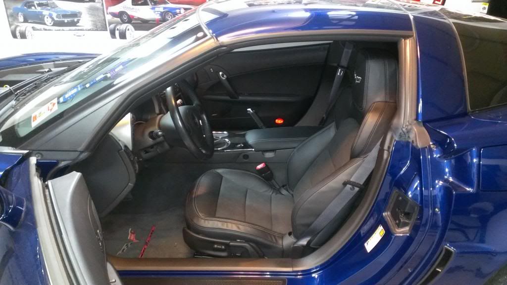

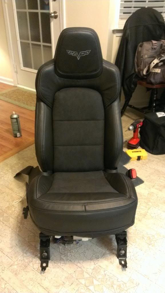

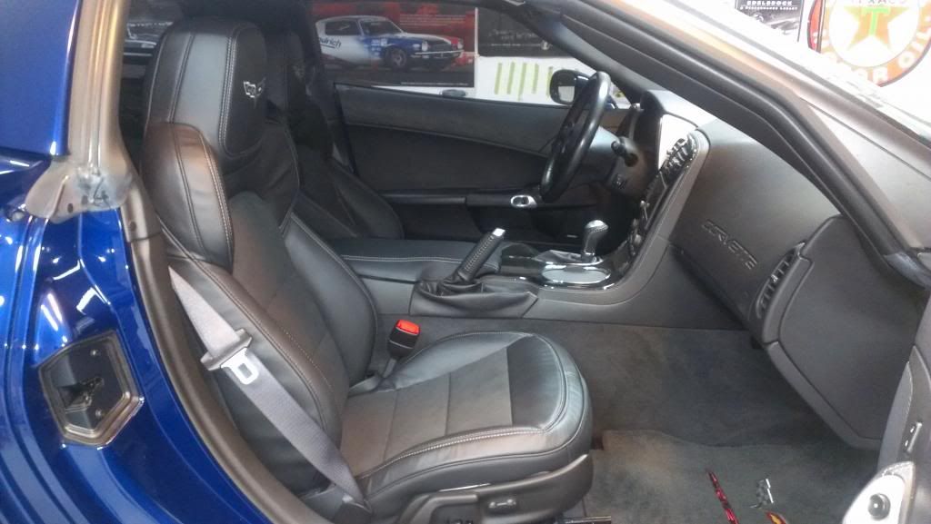

bonecrrusher 05-07-2013 06:43 PM

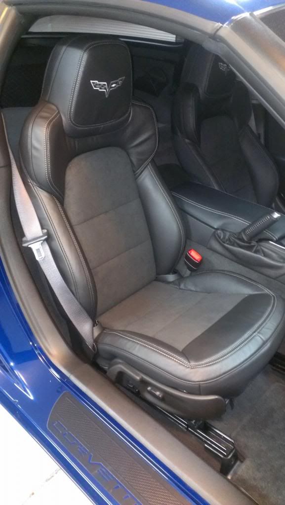

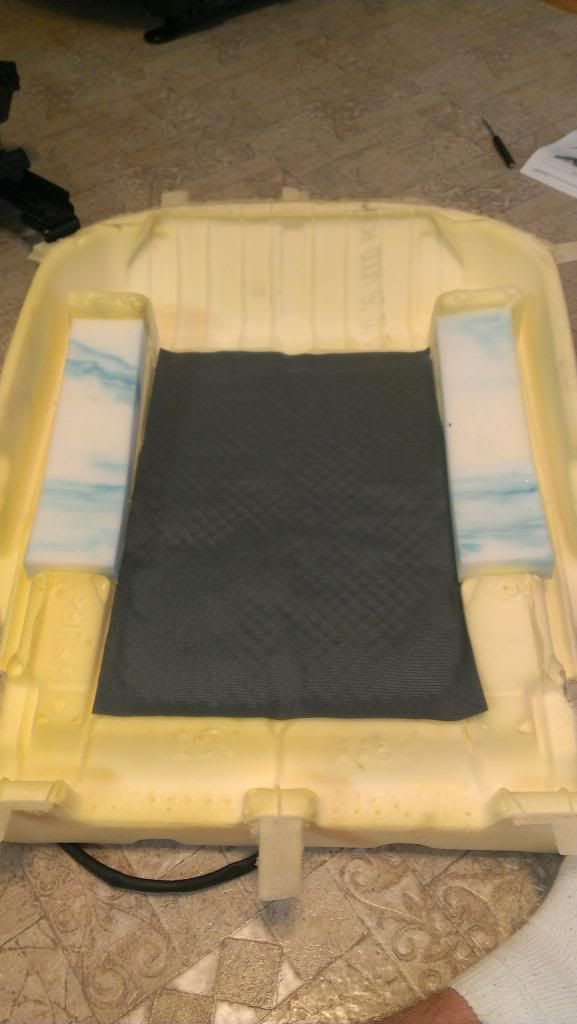

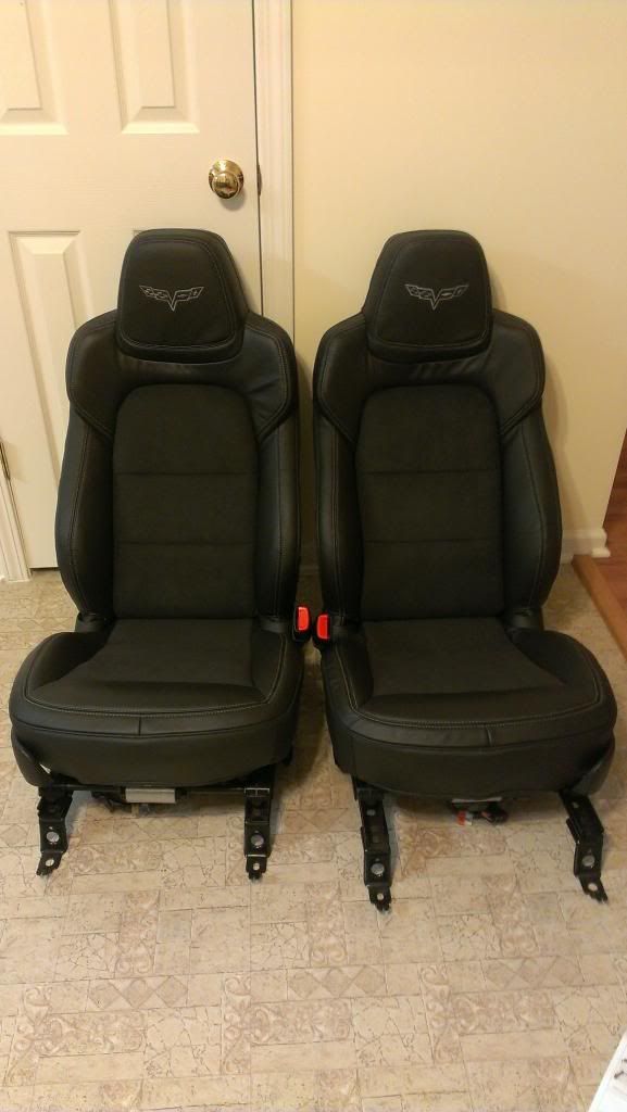

So after starting on this seat project for what seems to have been a month ago - I finally got the last seat installed tonight.
I picked up some 3M 90 adhesive from my local Lowes to glue the seat heating elements to the new foam.
I also used it to glue the fabric and new extra cushion pads to the bottom of the seat foam as well.
Overall I would rate this project an 8 just because I have never torn apart seats before - and getting everything back together was kind of a pain.
Now for teh pics!

tones2SS 05-08-2013 05:13 PM
Very nice. New seats look killer!
Payton King 05-09-2013 06:51 AM
Nice upgrade
You will be riding in style on the power tour.
Jay Hilliard 05-10-2013 04:37 AM
Very nice job on the seats. Seems to be an excellent upgrade.
bonecrrusher 05-11-2013 07:36 AM
Thanks guys!
The seats are a ton more comfortable! I actually look forward to driving the Tour in them!

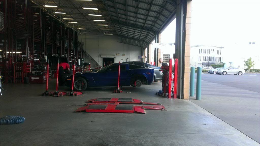

Another update for the Tour - I finally got those 345's mounted last night.
I'll tell you what - these tires are much beefier then even the 325's and not having bald a## tires is nice!

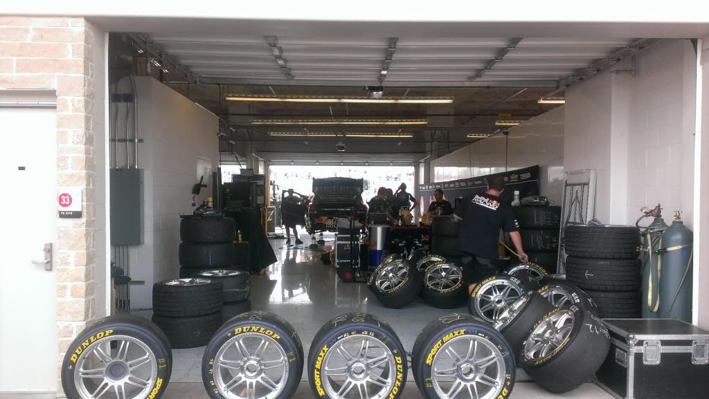

A few updates here - I was in Austin TX a few weeks back for the V8 Supercar race.
It was pretty cool seeing the Holden race cars drive around the track.
COTA is a real nice facility - only problem was the heat - the weekend we went to Austin it was the first weekend it got hot and it was 100+ degrees the entire weekend.
Here are a few pics:

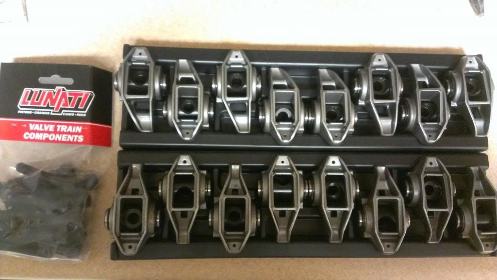

The roller rockers that I ordered like 2 months ago FINALLY arrived!
These are LS3 units that I need with the new CNC ported L92 heads that I have. They are have the upgraded trunion bearings since I have seen multiple posts with messed up rockers.

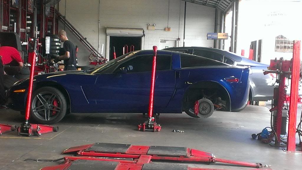

I had the car re-aligned and man was that thing off - took them over an hour to get it corrected. The swaybar install might have had something to do with that.

So now I am in the middle of tearing down the Corvette - I have gotten the intake, the exhaust off the car, and thats when I hit a snag.
I got the manifold bolts out of the heads with no problem but one of the bolts holding the manifold to the cat/collector pipe rounded off last night.
So that ended my night as I didn't have the proper size Bolt Out tool. I went to Sears tonight and got the whole set - so I should get that manifold off tonight.
