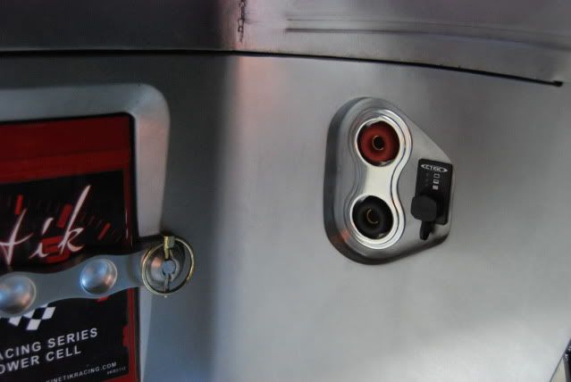

We've got the drivers side battery trim panel all finished up. On this one we included some high amp battery service ports and a charging port for a CTek charger to plug into. On this car, you can't do anything without battery power, including opening the doors or hood or anything to get access to the battery (when the air is out of the suspension), so this spot can be accessed when the truck is on the ground should you ever need to! Better to be safe then sorry... We also recessed the piece in to protect it since it is inside the wheel well.
http://i55.photobucket.com/albums/g1.../DSC_02592.jpg
http://i55.photobucket.com/albums/g1.../DSC_02502.jpg
http://i55.photobucket.com/albums/g1.../DSC_02522.jpg

Looks great Robbie. I like that charge port for the ctek. Are those chargers for AGM's? I was mounting my charger in the trunk but I like that better.
pacificustoms 05-17-2011 10:57 AM
Yea, I believe all C-Tek chargers have a setting for it now, but maybe only a couple of the models. They have this panel mount now which is new and has a weathertight plug with a rubber cover and you just plug the charger into that and plug the other end of the charger into the wall. The panel mount piece has a red, yellow and green light to let you know its charged (the charger has lights as well). We have a C-Tek on pretty much every car we have that isn't driven on a weekly basis.

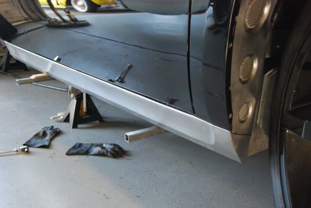

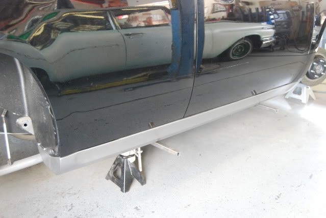

Here's what's been the most difficult project on this vehicle to date. It looks fairly simple on outside, but was everything but that to fab up. There's literally no room to work the panel from behind either and we attached it using all factory mounting locations, or to the other panels we've made.
The truck just didn't look good with the running boards and looked dumber without them as the proportions were lost in the body. We made the decision to make a rocker panel that would bolt on the truck and finish off the lower portion of the body. I figured also why not incorporate the body line that runs around both wheel wells that GM seemed to have forgotten about in the center of the car.

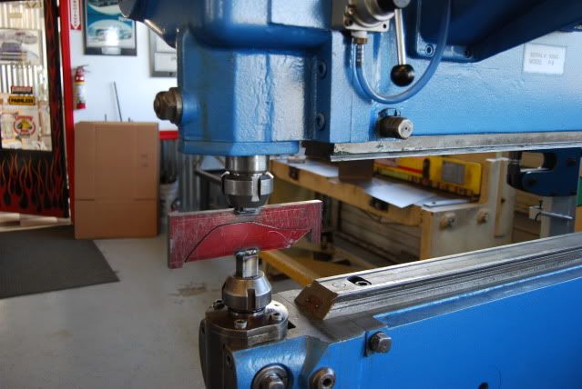

I made up these dies for the pullmax to stamp out the pieces I need. This is quickly becoming my favorite piece of equipment...
http://i55.photobucket.com/albums/g1...s/DSC_0227.jpg
Here's the outcome:
http://i55.photobucket.com/albums/g1...s/DSC_0247.jpg
http://i55.photobucket.com/albums/g1...s/DSC_0342.jpg
http://i55.photobucket.com/albums/g1...s/DSC_0345.jpg
http://i55.photobucket.com/albums/g1...s/DSC_0348.jpg
Here's where it meets up with the inner fender panels we'd built earlier. I pre-planned (almost never happens) it by putting the notch in the panel in the beginning.
http://i55.photobucket.com/albums/g1...DSC_0351-1.jpg
War 05-19-2011 04:38 PM
That turned out incredible. Like how you followed the body line around. I would love to have a pullmax.

Are you finishing your metal off with like 220 or 320 grit sandpaper? Or finer yet?
pacificustoms 05-19-2011 06:44 PM
Usually just 120, sometimes I'll lightly go over it with 220 on a da. It'll probably go back to 80 when it gets to the bodyshop anyhow just to get some mechanical adhesion. The aluminum stuff we take all the way to 600, but that's all going to stay raw.

pacificustoms 06-02-2011 09:26 AM

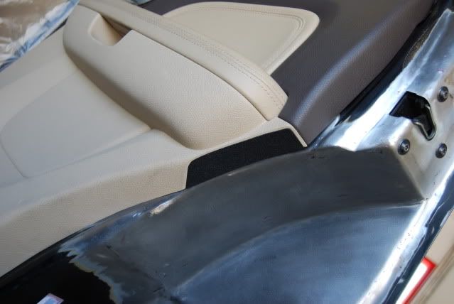

A couple small last minute touches. We finished up the rear door panels and built a piece of grained plastic that fits perfect and screws in from the back. All we have to do is die it to match the color of the door panels.
http://i55.photobucket.com/albums/g1...s/DSC_0222.jpg

Got it on the ground with the stock wheels. All the effort in the rocker kind of disappears, but oh well, I know it's down there!

elitecustombody 06-02-2011 09:33 AM
Robbie, I think the rockers came out beautiful and finish that area nicely. :thumbsup: I'll be doing something like that on my TBSS but in plastic,keeping the original lines just bringing it down few inches to cover up the frame.
pacificustoms 06-02-2011 09:36 AM
Thanks! I was dreading building those things and they did prove to be the hardest part to build on the entire project. In the end though, they were worth it! In person the car has a trailblazer look to me now for some reason.

elitecustombody 06-02-2011 11:05 AM
Now that you mentioned it,it does look like trailblazer,just fatter.
BTW, if you haven't thought about it yet, if you want the paint to last on the rockers,I'd advise getting them wrapped in clear protective film or they will get sandblasted in no time.

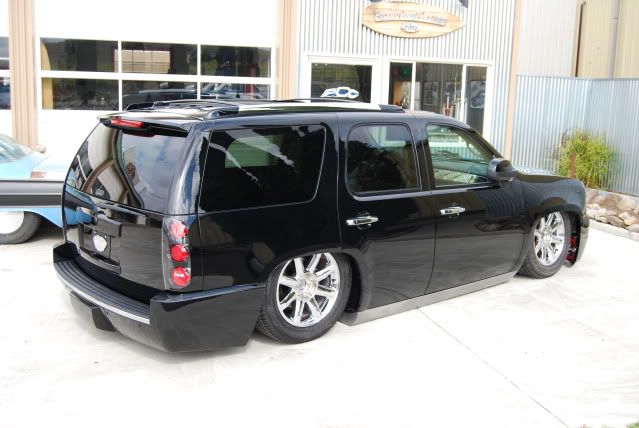

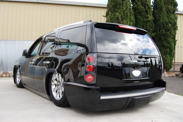

elitecustombody 06-03-2011 12:35 PM
Looking good:thumbsup: But the rack needs to go and rear bumper shortened IMO to compliment the rockers.
To give you an idea ,here are few pics of the rear I modified on Fernando's (killer67) Escalade.Don't mind how dirty or high it is, we dropped it 3" front & 4" rear ,just don't have pics.
http://i274.photobucket.com/albums/j...l292011275.jpg
http://i274.photobucket.com/albums/j...l292011271.jpg
http://i274.photobucket.com/albums/j...l292011269.jpg
http://i274.photobucket.com/albums/j...l292011268.jpg

It'll be good to leave it the way it is now. The roof rack has to stay because the ribs I think will look pretty ugly without it and it has a wierd big dip behind the sunroof which really stands out with it off. You're eye level to the roof so all that stands out.
As far as the bumper, you did and awesome job on it. We're going to leave it alone for now, it always gives the customer something to change up a year from now. Tuck the bumper, throw on a different set of wheels and have a whole different look for the following year. It was tough to find a spot to, but the line had to be drawn somewhere so that we can get it done and the customer can start enjoying it!
elitecustombody 06-03-2011 05:38 PM
Thanks Robbie, I see what you're saying on the roof, it's not flat like the previous gen. I guess you can always cut it out and fab up a flat skin:D
I agree about drawing the line somewhere,it's always hard. I guess you'll have something to do in a year or two:)
killer67 06-03-2011 10:48 PM
Originally Posted by mexMan (Post 351369)
Elite, are those tailights painted or covered?
They are painted body color on the side and tinted clear (smoked) on the rear face. Stefan did them with laser precision :thumbsup: Could not be happier
