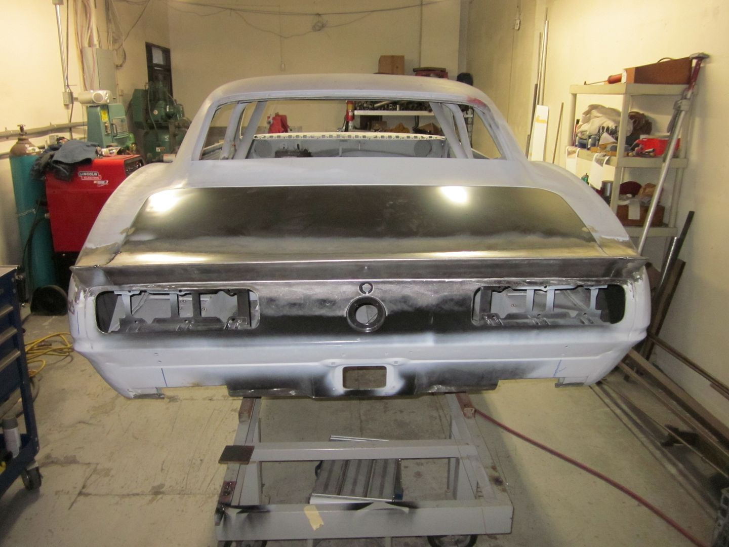

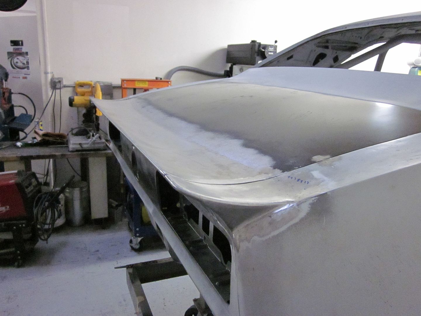

Rear Spoiler
This weeks update is rear spoiler.. We almost got it done.. few more things to weld.. then we need to eliminate the key hole & move the gas cap hole to the center of the tail panel.. Tail lights!! I got an idea..

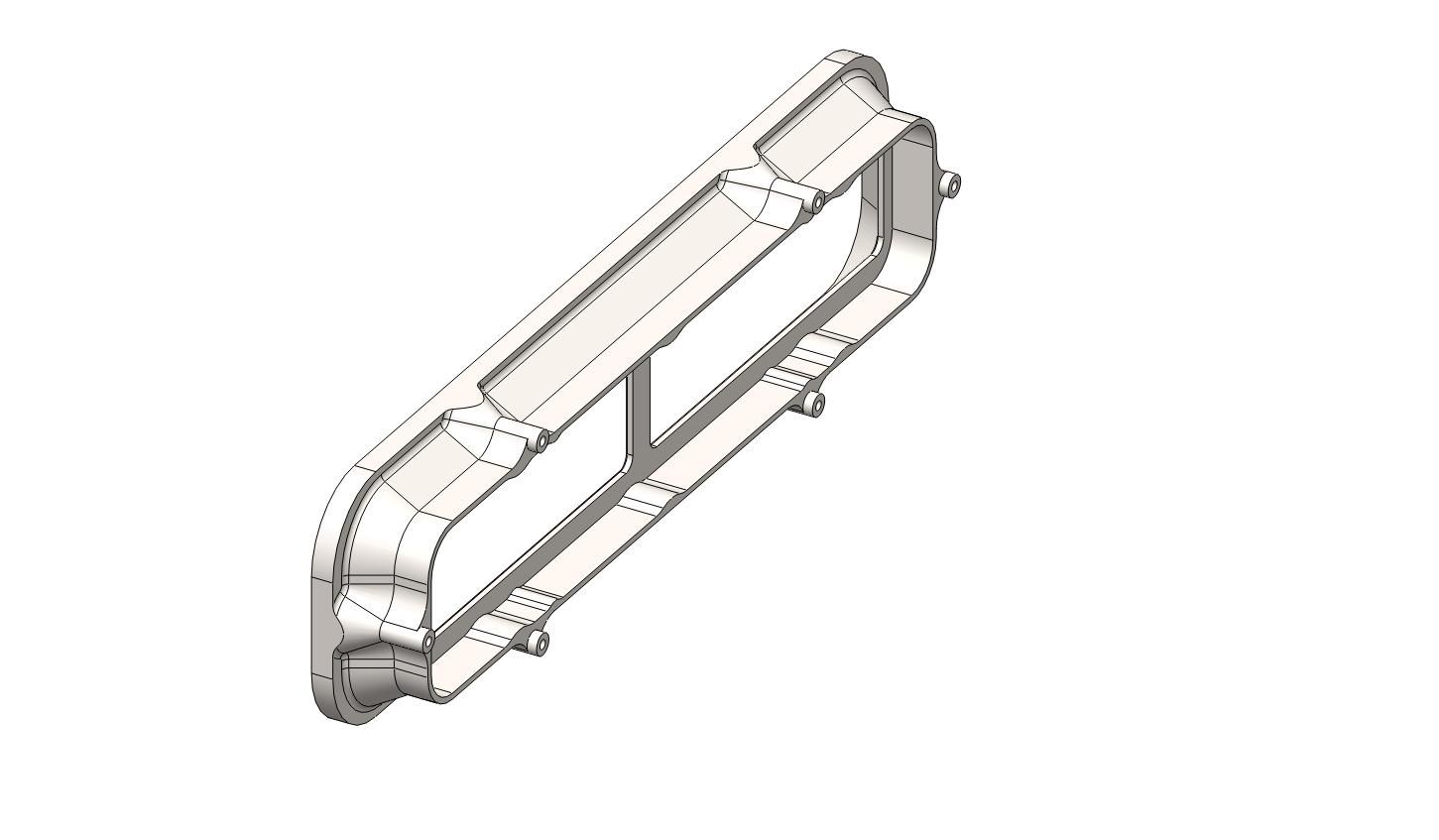

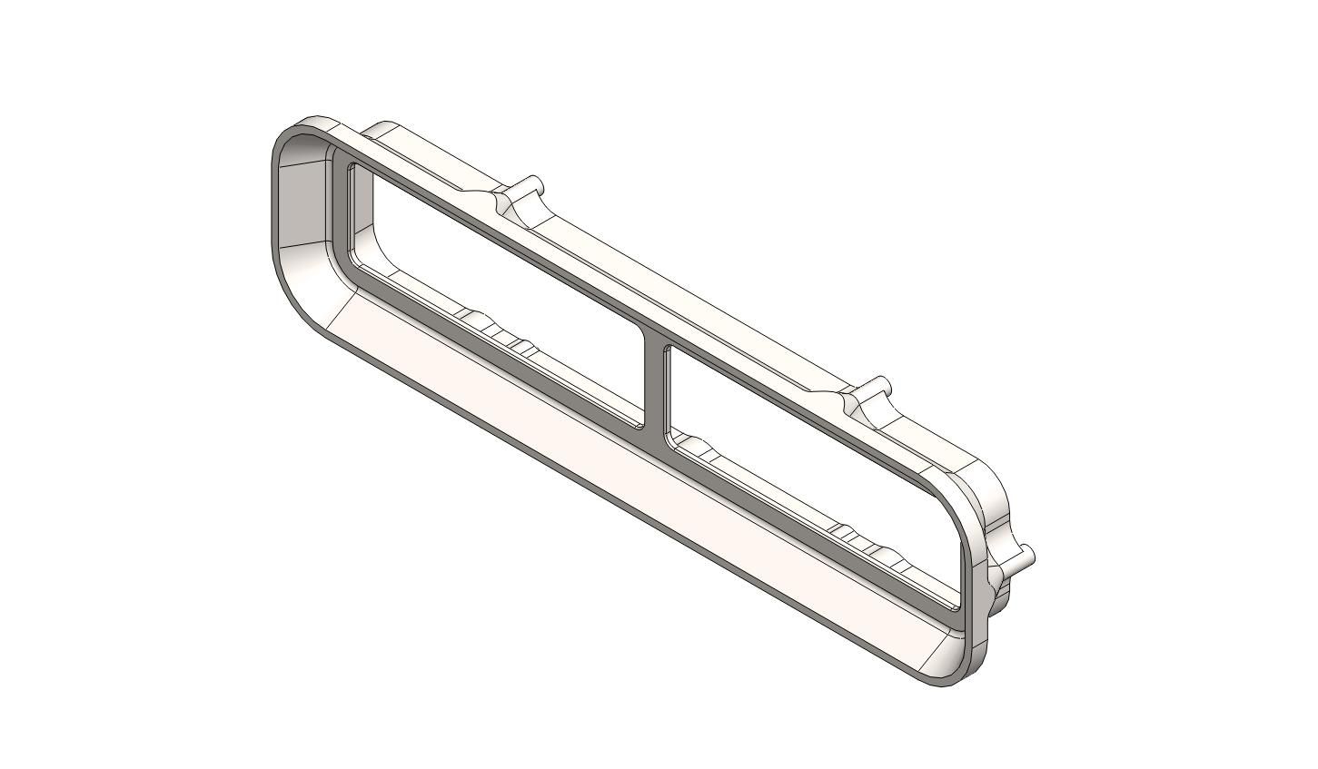

Tail lights
My tail light idea is close to being designed... gotta get LED lights before we can get some parts machined to finish design... :D

Cris@JCG 10-18-2010 08:28 PM
Thanks Mike! We are machining them out of steel & welding them to the tail panel...

dunnjun 10-19-2010 07:50 AM
Cris, awesome job! How do you determine what the angle of the spoiler should be?
Cris@JCG 10-19-2010 08:04 AM
We made templates out of cardboard set them on the side to see where the angle would look the best.. then we fabricated corner pcs out of sheetmetal & looked @ it a every angle to see where I was going to like the position..
Here are some more pics of it completed..
