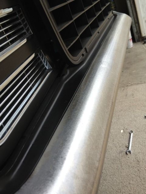

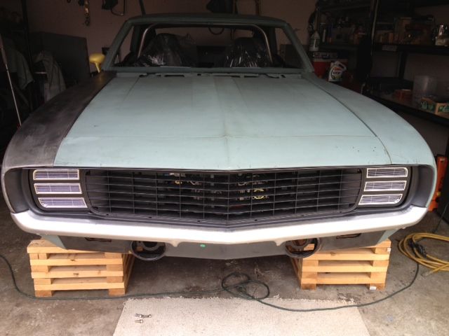

frankv11 03-31-2013 03:23 PM

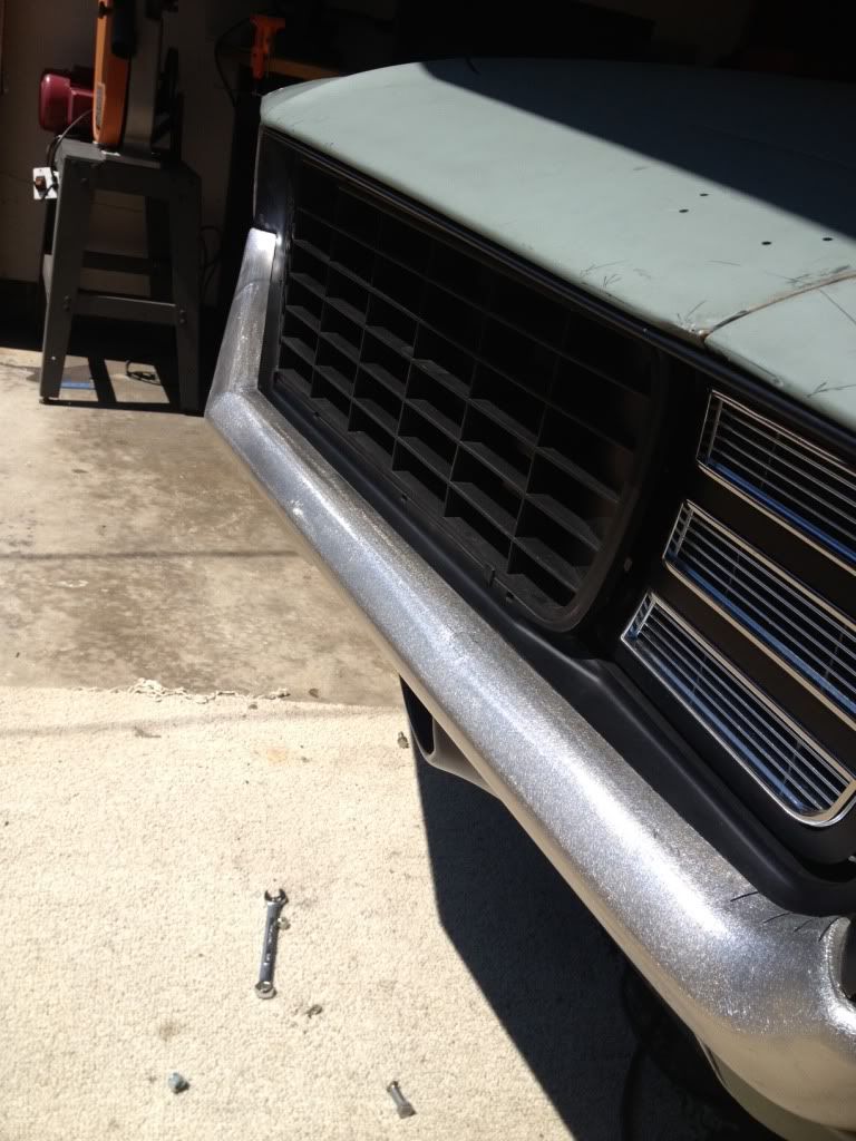

little progress better than none at all. so my bumper is 99% done
http://i1232.photobucket.com/albums/...ps8c4c2f70.jpg
http://i1232.photobucket.com/albums/...ps69267ec6.jpg
http://i1232.photobucket.com/albums/...ps97d852c5.jpg
214Chevy 03-31-2013 03:38 PM
Bumper looks good and those headers are flawless.
waynieZ 03-31-2013 09:18 PM
Wow I love it, nice work the front of the car looks great.
tubbed69 04-01-2013 03:30 AM
that bumper and grille fit looks great Frank,time for paint?

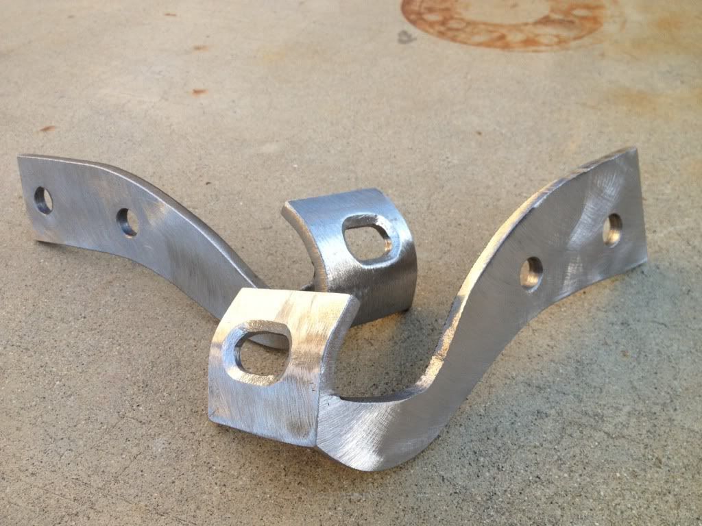

new bumper brackets. by the time i got done tucking in bumper, there was not much left of the original.

They look great. I even like the mini-truck grinder marks.

Vince@Meanstreets 04-09-2013 09:41 AM
Nice work. did you strip all of the chrome or just finish the surface?
I actually made these from 1/4" steel and just cleaned up with angle grinder

sorry, I meant from the bumpers.
frankv11 04-11-2013 11:51 PM
:headscratch: well dahhh, was not thinking over here. No I did not stripped it , I ground most of it of with angle grinder

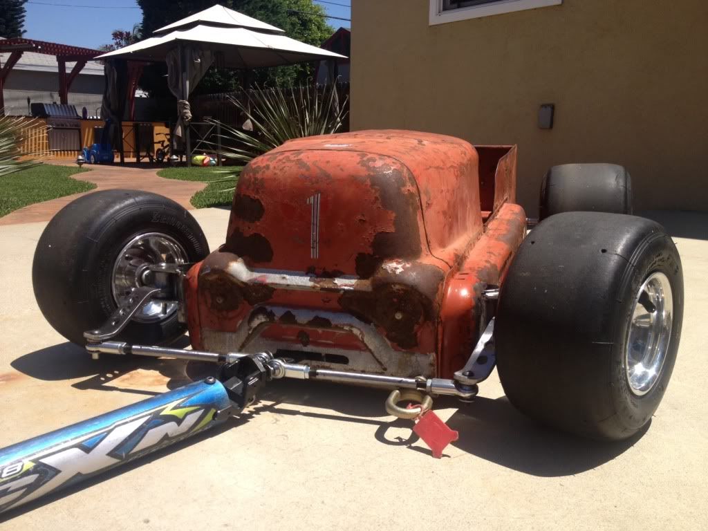

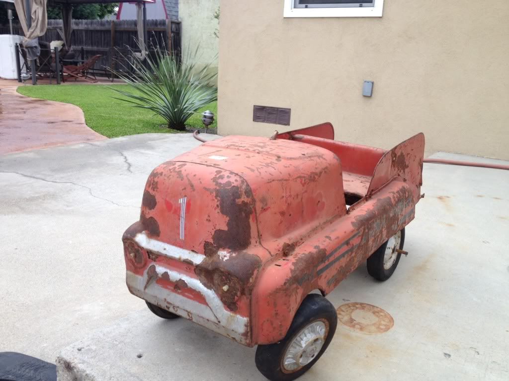

no updates but have a new project.
so figured i would hijack my own thread
had this on open discussion but it probably fits here a bit better

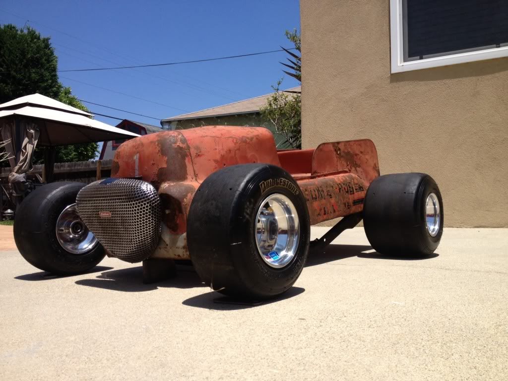

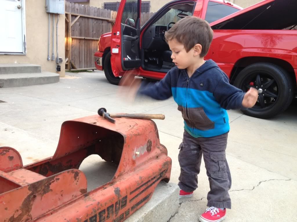

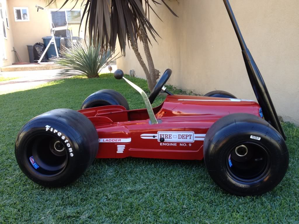

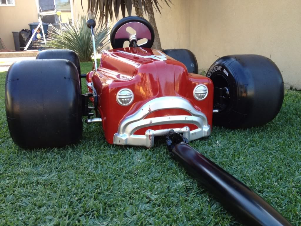

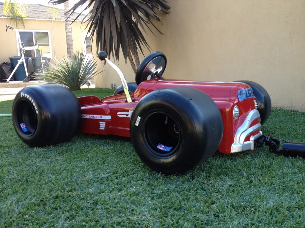

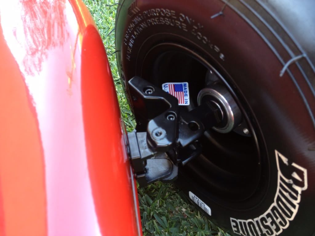

working on pedal hot rod car for my 2 year old.
before
http://i1232.photobucket.com/albums/...ps698b726f.jpg
during
http://i1232.photobucket.com/albums/...psc1fd0e22.jpg
mock uphttp://i1232.photobucket.com/albums/...psbf66a226.jpg
by the way HAPPY FATHER'S DAY TO ALL !!!

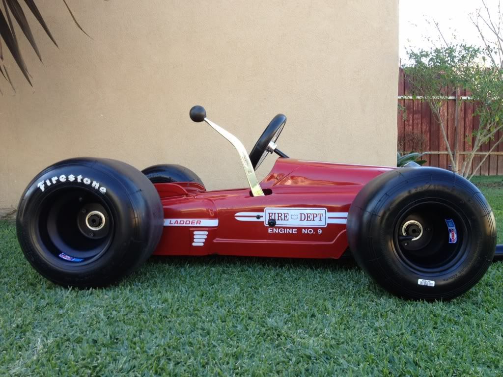

done with my boys project. more work than anticipated and I will still be making a HURST shifter pull handle. the bat is just temporary also working or rear defuser not final http://i1232.photobucket.com/albums/...ps252c74be.jpg
getting back to 69 , hoping to put in a few weeks worth of work.

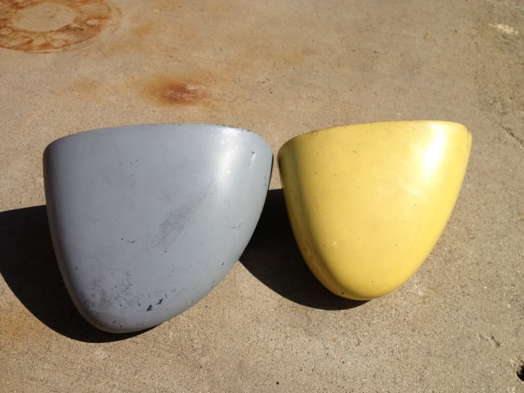

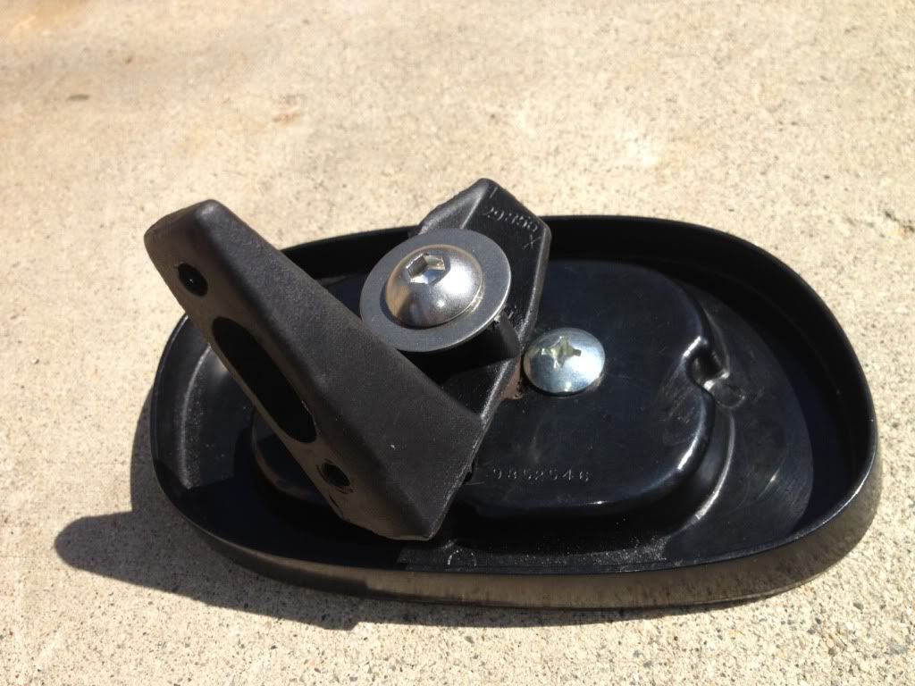

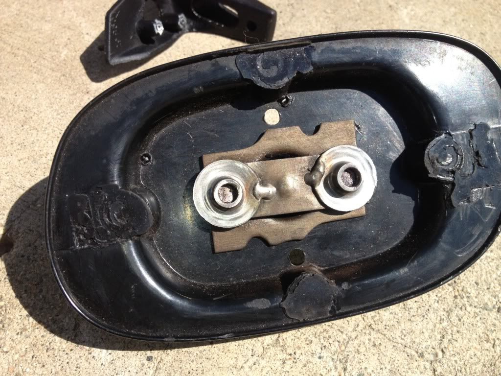

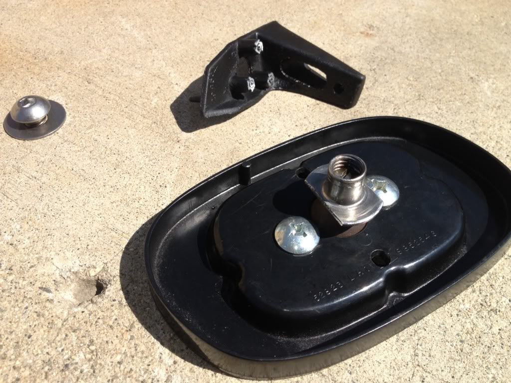

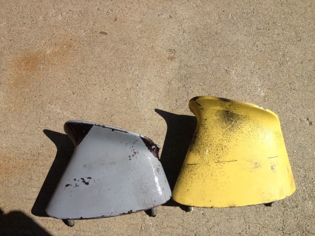

working on mirrors had two pairs. yellow ones have a smaller mirror housing and mirror sits flush to it which i like but had taller mounting stems than others as you can see. will be using the shorter one to get mirrors tucked in as close as possible.
http://i1232.photobucket.com/albums/...ps72ff093d.jpg
in order to swap base / stem. remote had to be cut and that just opened a can of warms. everything just fell apart as it held on by the tension on the remote. in order to make it manual swivel type for driver side.I hacked up a passenger side mirror to use it's swivel but being that it was a passenger side made it difficult. after a few hours of trial and error and some fine tuning it got done. very happy with solid and crisp the mirror motion.
http://i1232.photobucket.com/albums/...psff1ac6b7.jpg
http://i1232.photobucket.com/albums/...psecb77c37.jpghttp://i1232.photobucket.com/albums/...psf86d8908.jpghttp://i1232.photobucket.com/albums/...ps64595587.jpg
looking to recess them into door for final level.

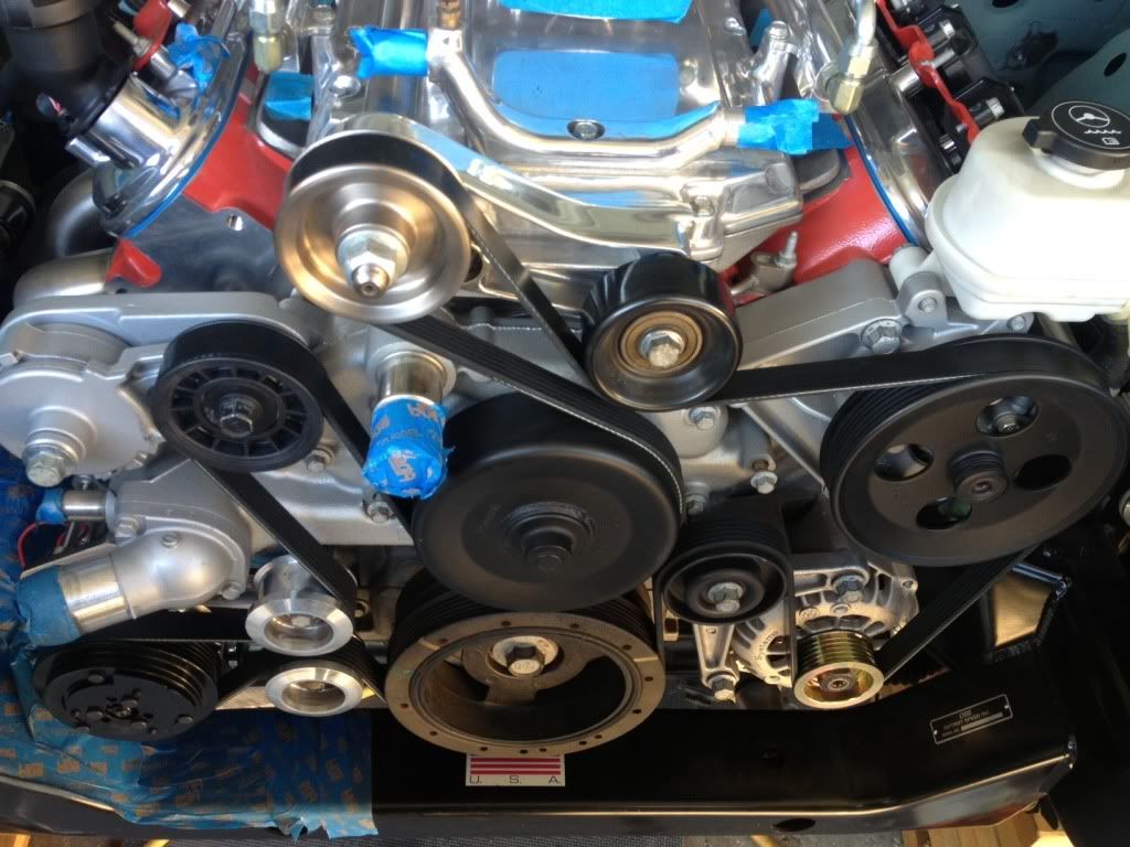

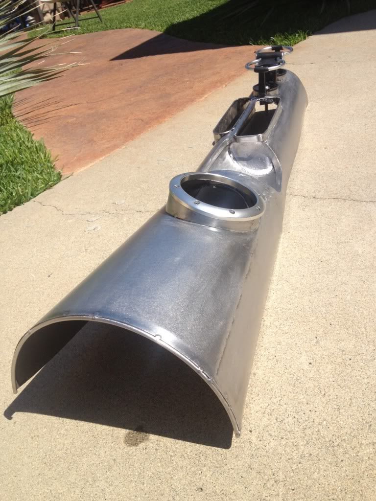

frankv11 09-25-2013 08:41 AM
got AC compressor in stock location and now clears DSE sub.http://i1232.photobucket.com/albums/...ps6e54a696.jpg
also been working on my center console.http://i1232.photobucket.com/albums/...ps83bbdf68.jpghttp://i1232.photobucket.com/albums/...pscf9a388d.jpghttp://i1232.photobucket.com/albums/...psefbe2118.jpg
and of course what every protouring car needs ( a cup holder )http://i1232.photobucket.com/albums/...psdbc673a4.jpg

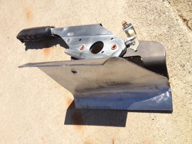

reinforced E brake. my first one was collapsing the floor.http://i1232.photobucket.com/albums/...ps04fcf8a5.jpg

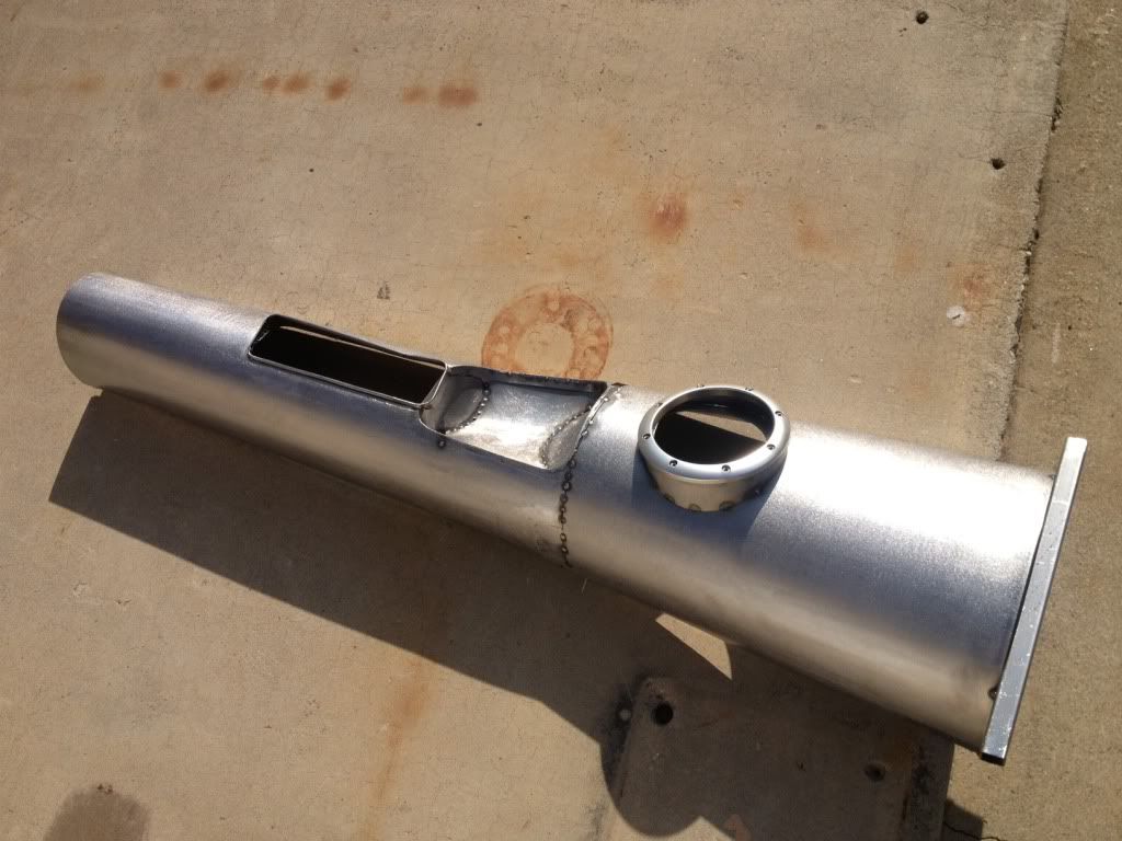

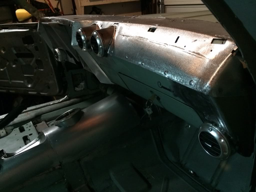

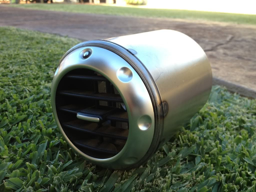

also working on dashboard design , made these AC vents , planning to run four. two on top center and one per side at mid way. http://i1232.photobucket.com/albums/...ps9e26294d.jpgwill also begin work on cluster panel just waiting on some gauges.
got a few other items done like pedals and EXHAUST.

incredible work..... wow i love your ebrake setup and tackling the accessory drives with the dse subframe. Great great work
Ron in SoCal 09-26-2013 10:30 AM
Hey Frank! Love how you're carrying the indented rings theme through the console and vents :thumbsup:
You've got style Bro.
Can't take credit for that one Ron. Stole it from Audi.

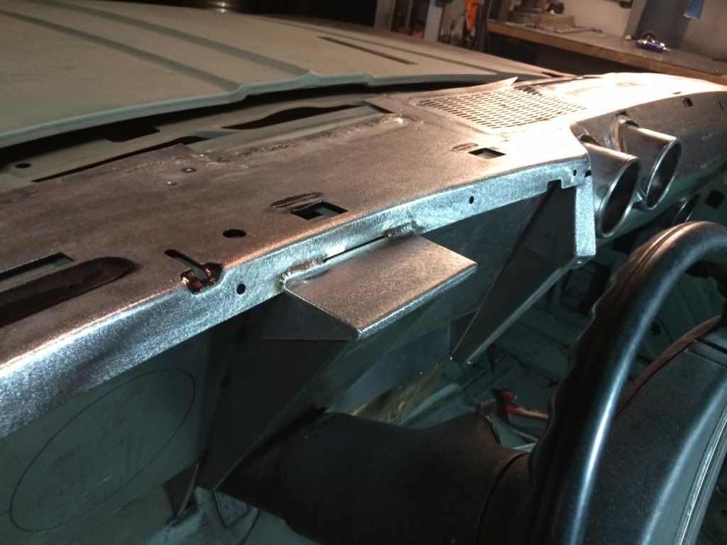

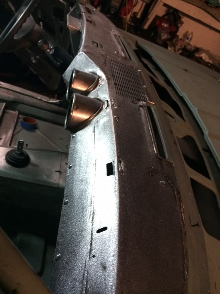

frankv11 01-24-2014 09:58 PM

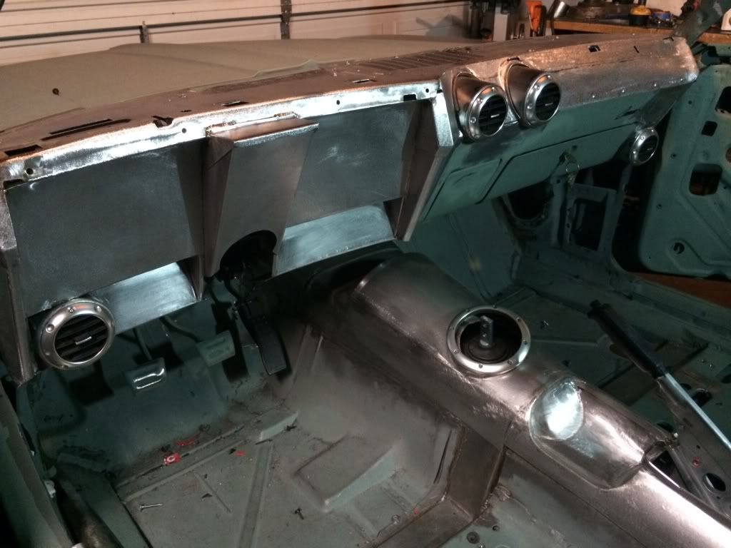

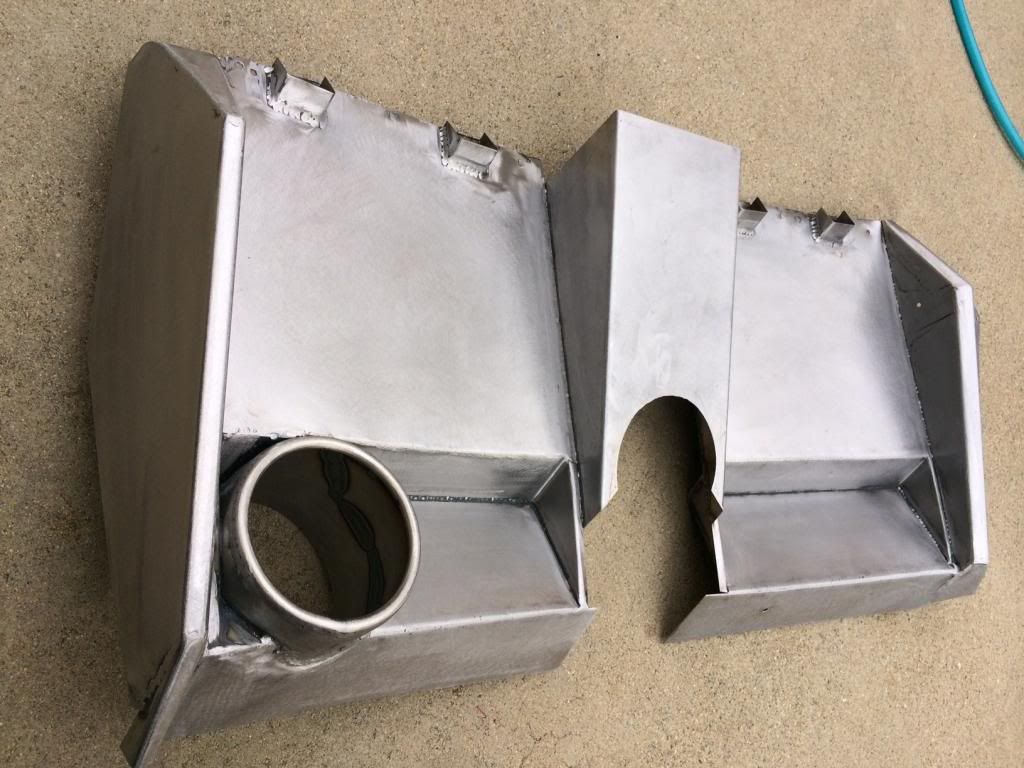

got some progress done.

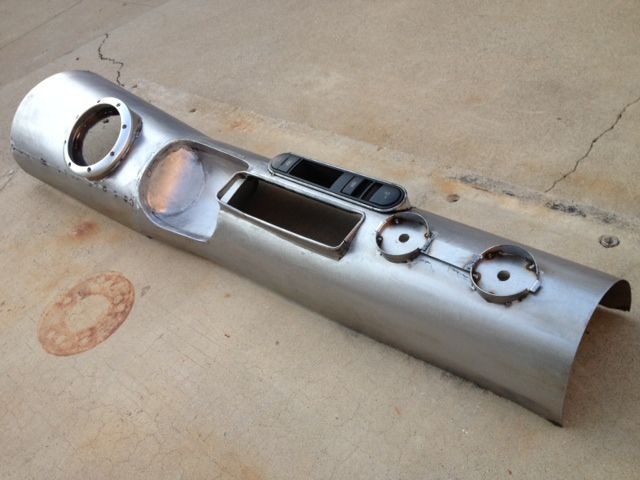

made a gauge panel from scratch almost exact as stock because i like the look of original (the way it curves and kind of hugs driver )the curve was key and the most difficult part to get right. needed to be metal so I can weld AC vents plus some other "little plans i have for it".
just got Classic Instruments Autocross Gauges ( YELLOW ONES ), Restomod Air unit, Radiator coming by way of ENTROPY radiator w built in oil cooler. Engine harness is next on list.
back to dash I'm also changing dash pad completely ( stock is just so crappy ) so I got to building the base / structure for it, to incorporate the upper AC vents into it and getting rid of flat vertical portion on passenger side. new pad will follow the curve of the actual dashboard structure so the ac vents will pop out a bit more.
this upper portion is a separate piece that will get foam and then leather. so this piece below comes off less the AC vent housing those are welded to dashboard.
http://i1232.photobucket.com/albums/...ps89a0d55c.jpg
this is not even halfway done and been at it for a week ( just want a very tight fit ) NICE SURPRICE COMING ON for this clusterhttp://i1232.photobucket.com/albums/...ps87356fc3.jpg
this is the passenger portion mentioned http://i1232.photobucket.com/albums/...ps452f1234.jpghttp://i1232.photobucket.com/albums/...psf087876d.jpghttp://i1232.photobucket.com/albums/...psdfddaabd.jpg
made cluster panel to fit OEM dash pad just incase I didn't like the new design,but no going back. i'm feeling the new look.
Restomod air is one nice unit. a friend of mine brought one over by another manufacturer and its no comparison built him his bracket and sent him on his wayhttp://i1232.photobucket.com/albums/...ps09d7c060.jpg
