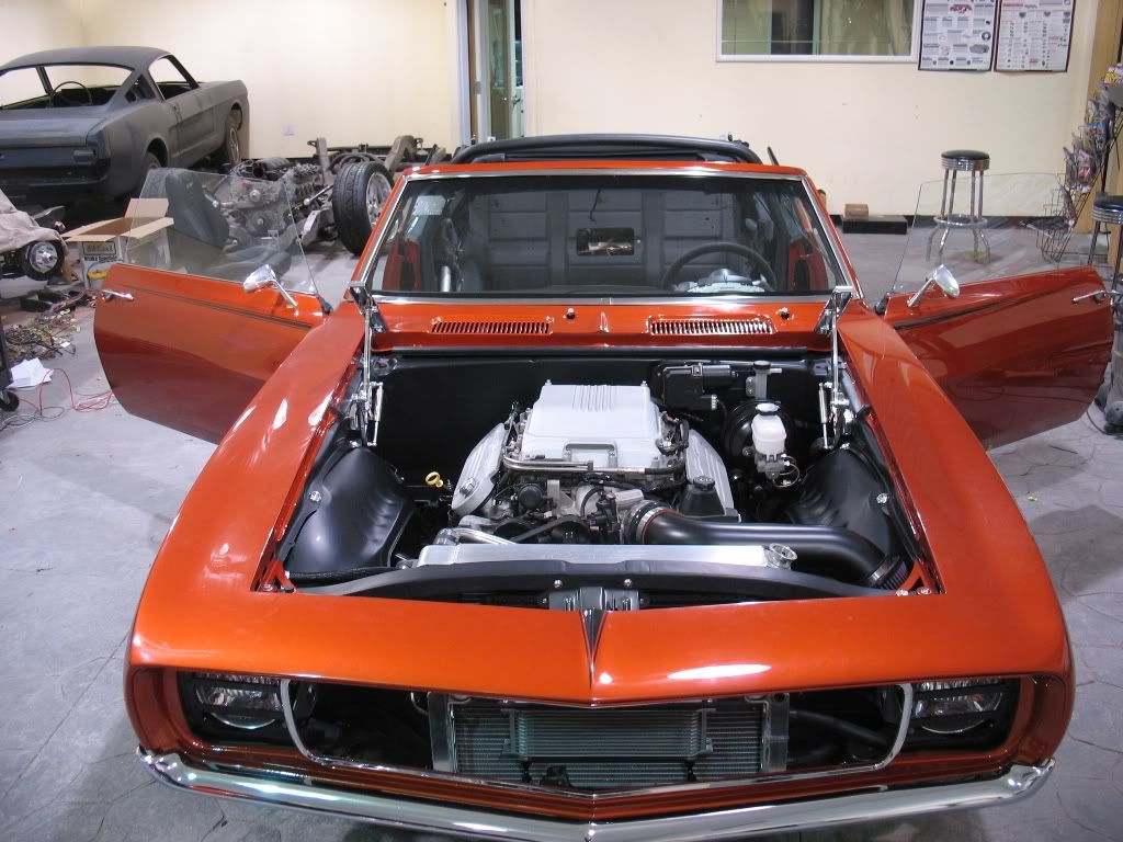

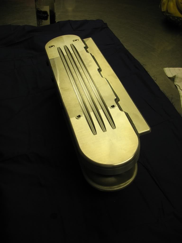

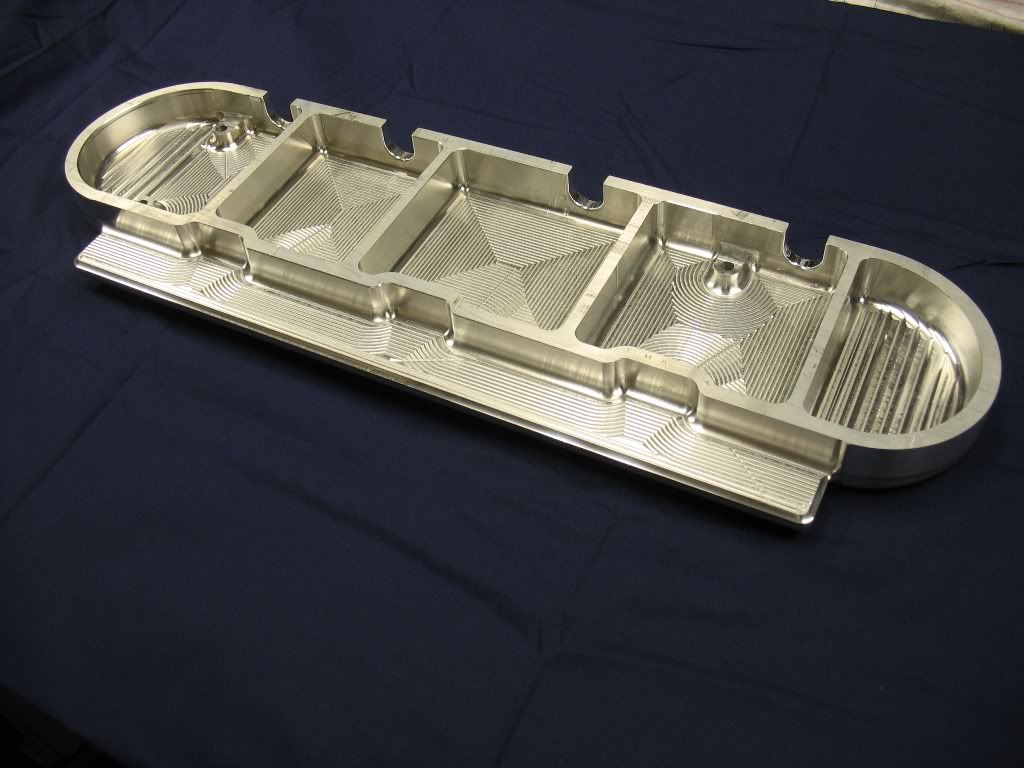

So the SEMA push is on!!! We are finishing up all the plumbing right now, wiring loose ends, and our cnc machining. Picking off the list steady now!
Finished modifying the marquez panels for interior, they are off to get covered.
Here is the first coil pack cover.... we tried to mimic the look of the supercharger top. They look awesome on the car, took them off to media blast them so they match the blower.
http://i1204.photobucket.com/albums/...valvecover.jpg
http://i1204.photobucket.com/albums/...alvecover2.jpg
waynieZ 09-15-2011 08:04 AM
They look sweet Tyler.

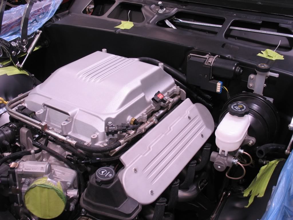

knockin some stuff of the list, got the intake done to send out for finishing.
Tons of little plumbing things..... all the trim is fit and clips etc installed, ready for final installation. Waiting on a pile of black AN fittings and plumbing will be finished off..... just doing the overflow tanks and then the rad is done.... Almost there!!!

The coil covers work very weel with the intake. That motor sure does look nice in there.
64pontiac 09-16-2011 10:58 AM
Thanks! Once they are blasted they will match the blower nicely.
Most of the plumbing is done, and all the engine bay wiring is done. It may look like its not there, but it is!!

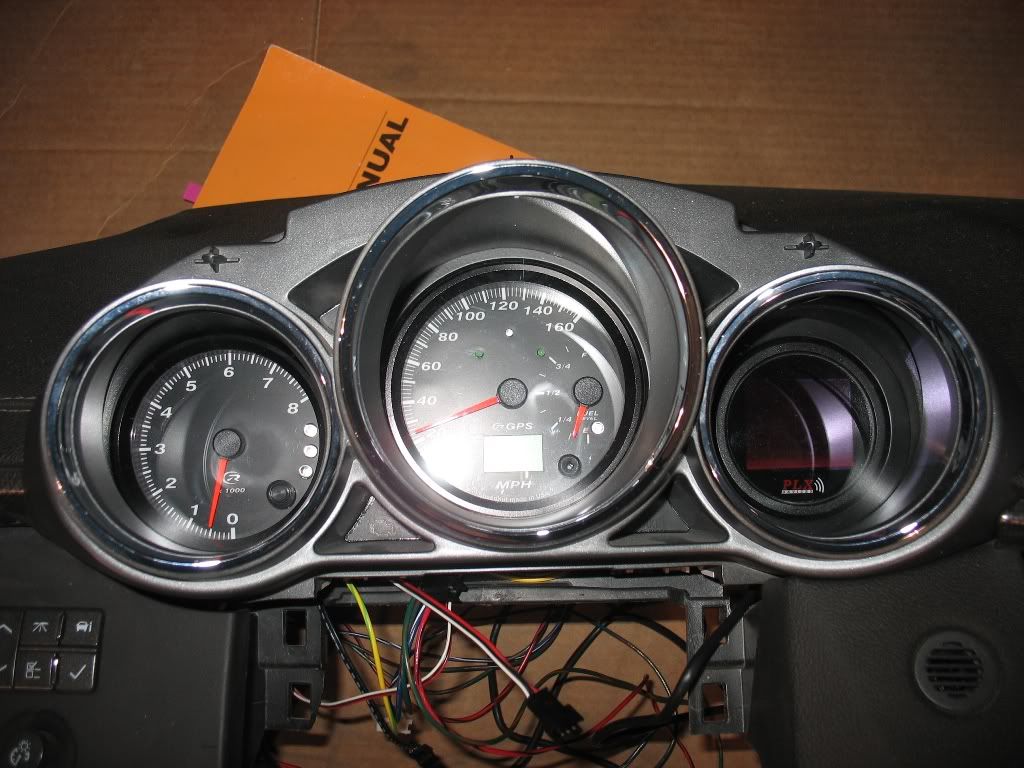

Got the gauge cluster together.....we had to axe the caddy stuff in it, no way to make it work. But all in all, its tough to tell the difference!

The car is looking great, I love the gauges.
64pontiac 10-13-2011 08:17 PM
Thanks. They are speedhut gauges and plx devices.... we have been using speedhut for a couple projects....nice product

Where you not able to get the V gauges working because of time?
Theres been a few swaps that have gotten the 04-06 GTO cluster to work by using the BCM as well in the swap.

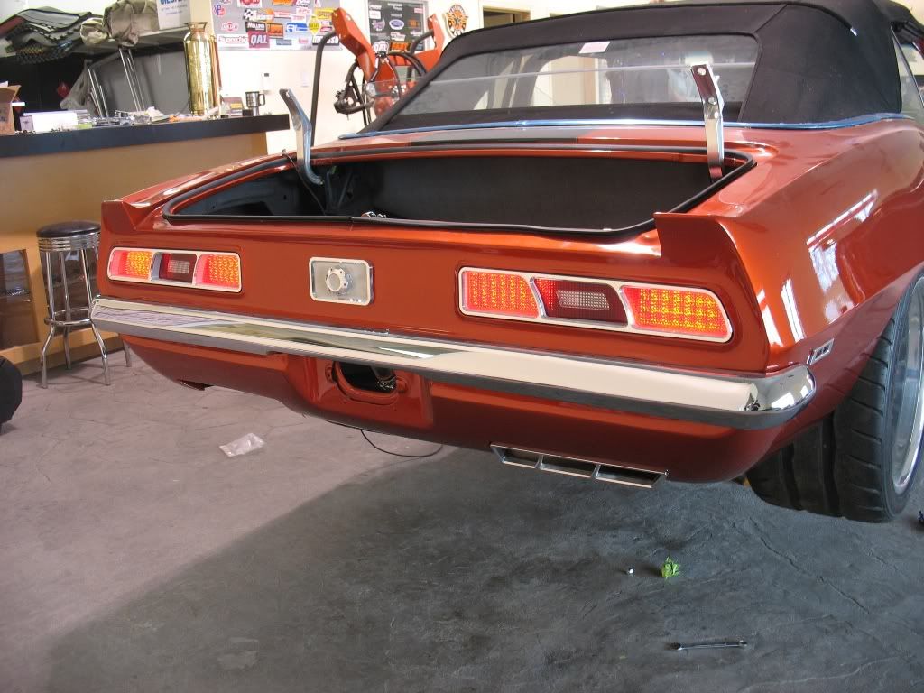

Who's digital tail lights did you use?
64pontiac 10-16-2011 01:50 PM
The tail lights are marquez with spahgetti engineering led cards.
Ok the new 09/10 gauges are 100% Can-bus communication with the factory bcm and ecm in the caddy. Since we are using a MAST ecu and TCI TCU the caddy bcm is only doing the stereo switching etc. There was NO way to get the right signal to the BCM to then send it to the gauge cluster. Not any way I could figure anyways. I think our gauge cluster is actually going to be cooler than the caddy's anyway, and most people don't even realize the new gauges?

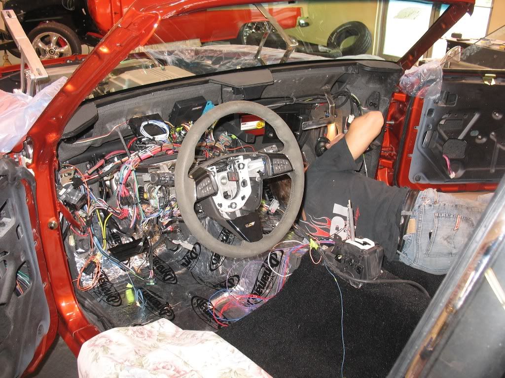

64pontiac 10-17-2011 06:30 AM

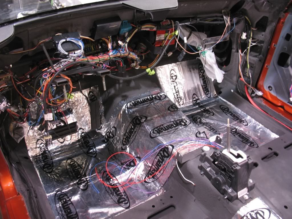

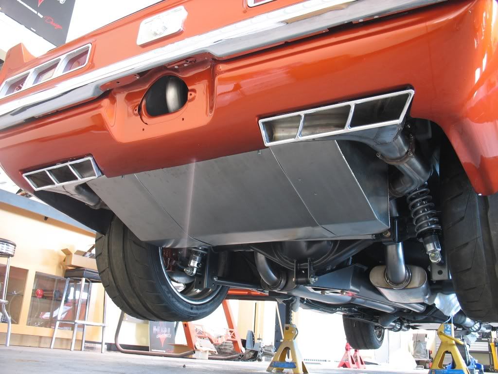

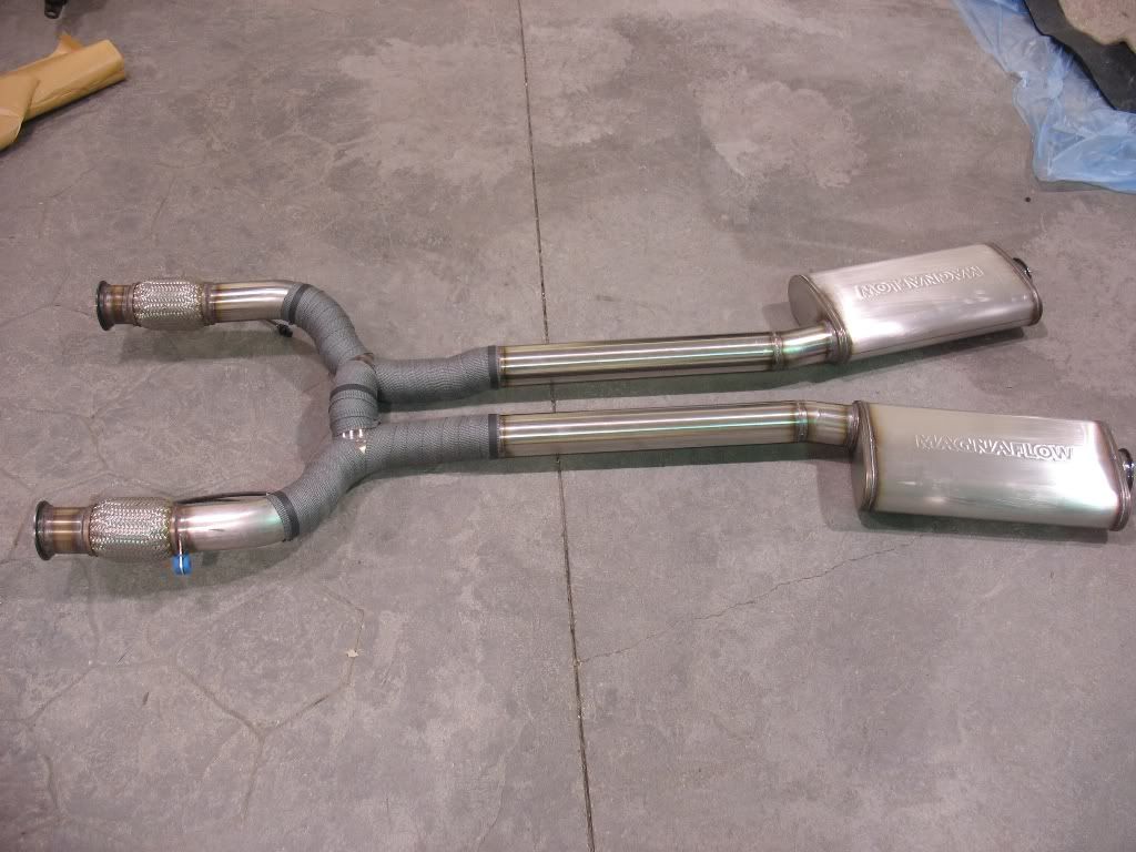

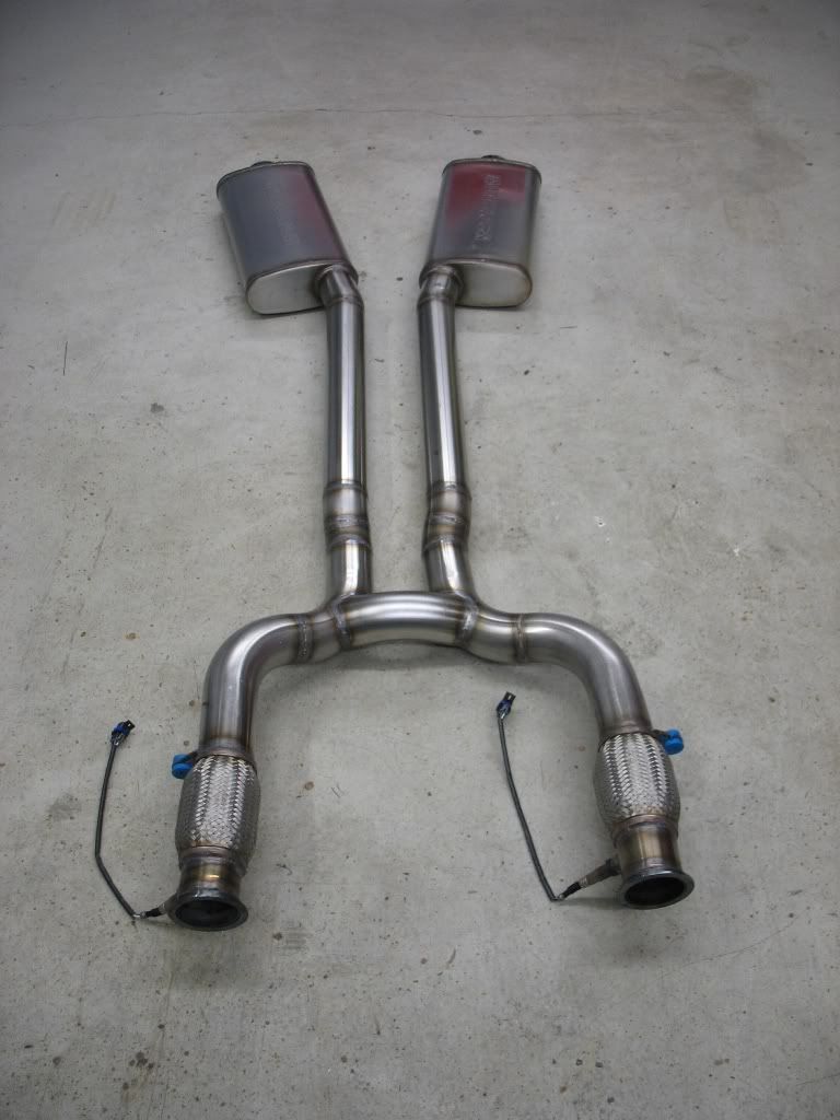

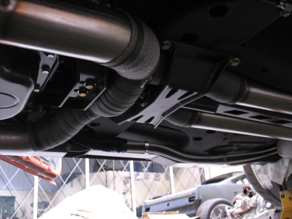

Some updates from the weekend work.

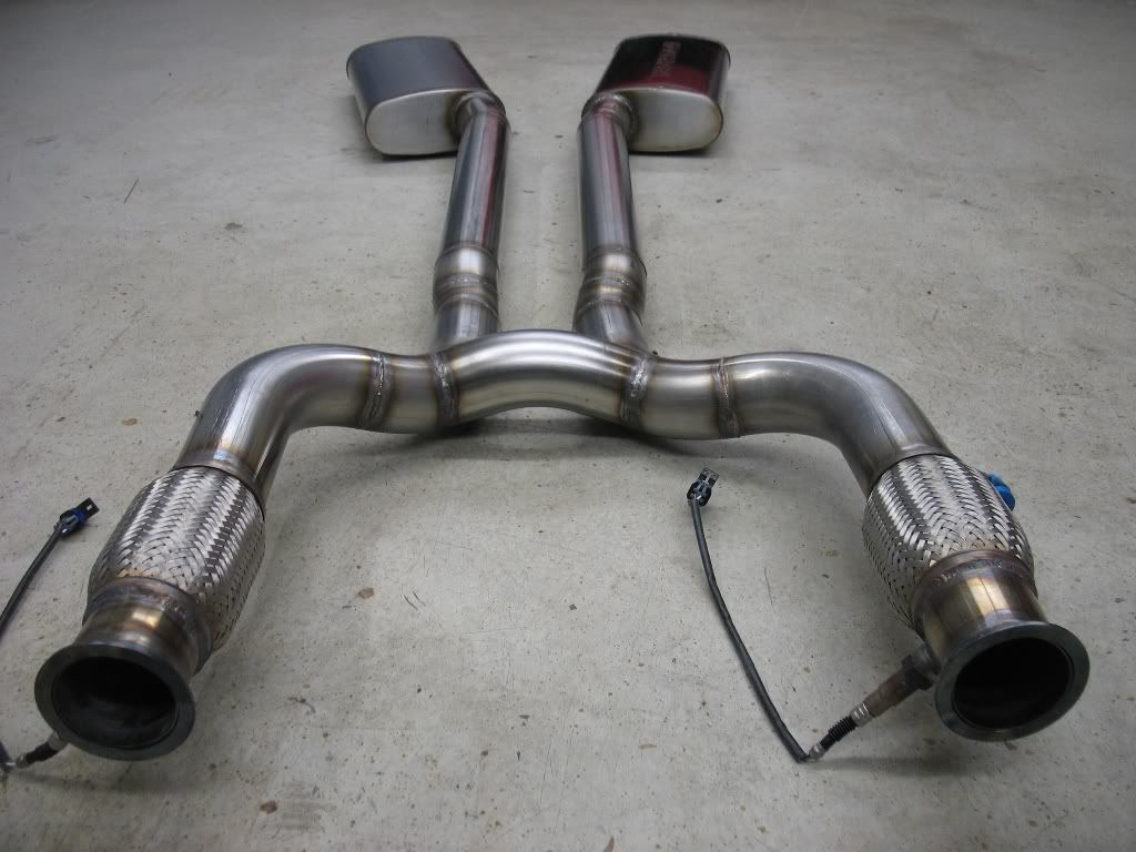

Exhaust is done. everything under the car is done. Lizard skin and Dynamat done. Carpet trimmed now. Interior wiring 95% done. Interior going in as soon as I get the door panels back from the "slow-polsterer".
http://i1204.photobucket.com/albums/...o/IMG_5995.jpg
http://i1204.photobucket.com/albums/...o/IMG_5996.jpg
http://i1204.photobucket.com/albums/...o/IMG_6022.jpg
http://i1204.photobucket.com/albums/...o/IMG_6031.jpg
http://i1204.photobucket.com/albums/...o/IMG_6027.jpg

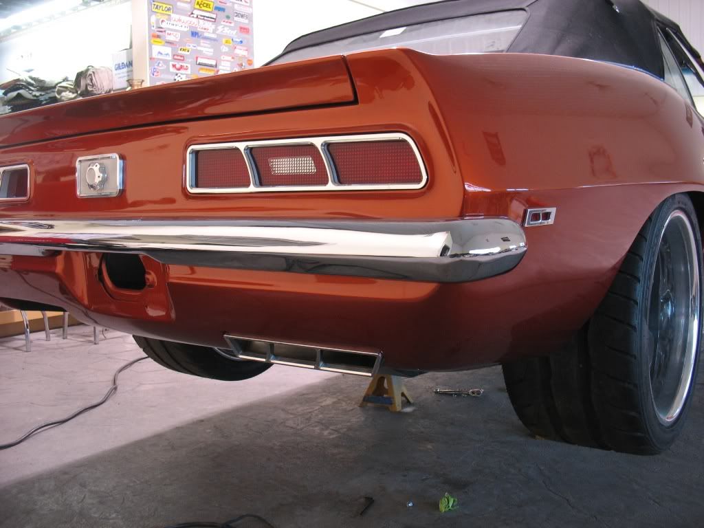

fleet 10-17-2011 08:59 AM
Congrats on SEMA Tyler. It's certainly a unique build which ain't easy when you're building a '69 as we all know. :thumbsup:
What else will be done to the gas cap?
RECOVERY ROOM 10-17-2011 09:24 AM
I'll have to look it up at Sema :thumbsup:
64pontiac 10-17-2011 08:04 PM

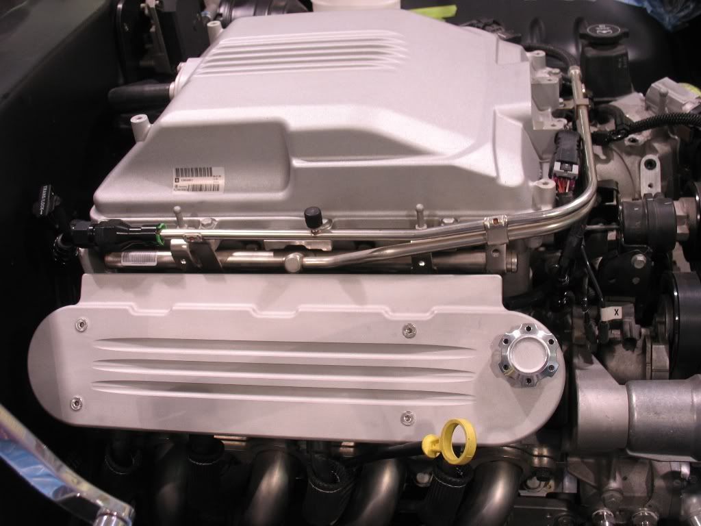

I put socket head cap screws in a radial pattern around the cap (and all the caps under the hood too, they match the gas cap) so that the cap matches the ring brother door handles, kind of.
The center of the cap and the center of the bezel are medai blasted like the inside of the marquez tail lights....... we DIDnt recess the cap into a pocket to perfectly match the tail lights because we were trying to think outside the box, ie sell the cap to someone else or use it on any of our customer's camaros without body mods, and you gotta leave room for improvement on the next one right?

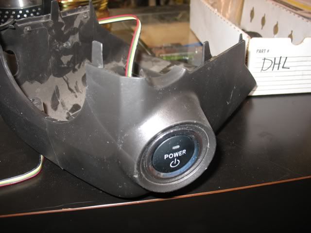

Got the column done and all the features functioning......gotta love the 4 way power tilt/tele
http://i1204.photobucket.com/albums/...o/IMG_6040.jpg
The lexus push button we use with the RFID keyless entry system that we are using on alot of stuff

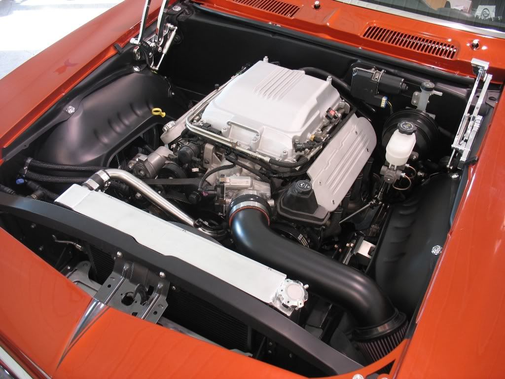

Coil covers went on for the last time
http://i1204.photobucket.com/albums/...o/IMG_6045.jpg
http://i1204.photobucket.com/albums/...o/IMG_6048.jpg
Please dont say anything about our dipstick!!! If you guys know of any fast pre done handles for it (other than a lokar, they take me forever to get up here) then I am more than open, with the last bunch of stuff I have to machine I highly doubt I will have any time to make a custom handle.....
Oh and the oil filler matches the gas cap!
wellis77 10-18-2011 12:34 AM
Hey Tyler,
Can you share a bit about the RFID keyless entry? Is this an oem product you've adapted to your builds, is it an aftermarket kit? Thanks.
64pontiac 10-18-2011 06:14 AM
It's an aftermarket kit that comes out of canada. Very well put together, fairly straightforward to install (if you do any alarm stuff the instructions and wiring diagrams always suck!) and it has a ton of features, such as auto window roll up etc.
The kit comes with two RFID key fobs that give you around 10 feet of range (you don't push any buttons, just walk up and it unlocks and powers up the push button switch) AND there is an emergency antenna/credit card transponder that you keep in your wallet in case you leave the key fob at the girlfriends?
Its a very nice kit and a good price. I have put three in, and keep a couple on the shelf.

Tyler the coil covers match perfect. Nice job on them.

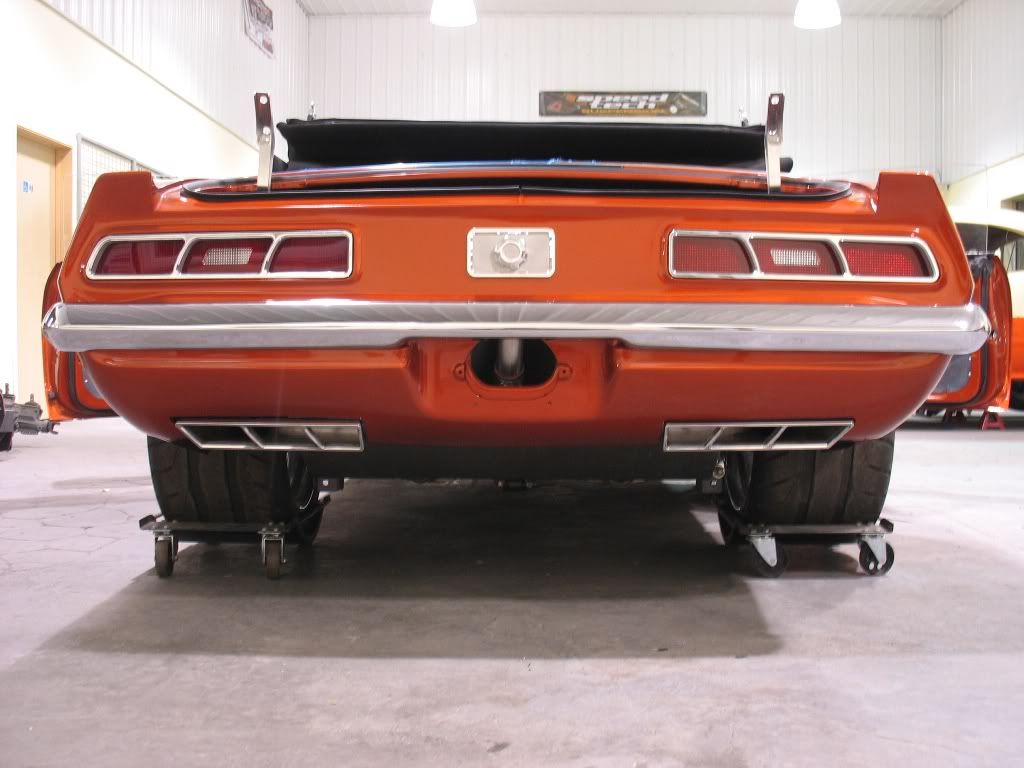

64pontiac 10-22-2011 07:03 PM
PMs sent.

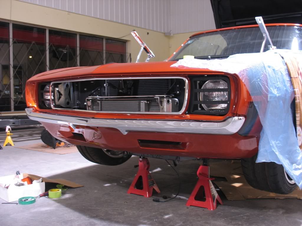

5 Days till trailer time! (Don't even ask about the body panels........we are in a huge fight to get the painter to get his arse in gear here....if you have heard anything about the situation you can sympathise.....)
Burning the midnite oil here......

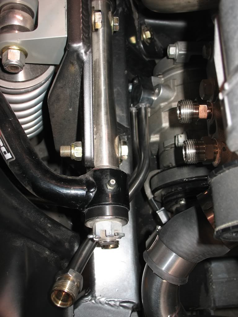

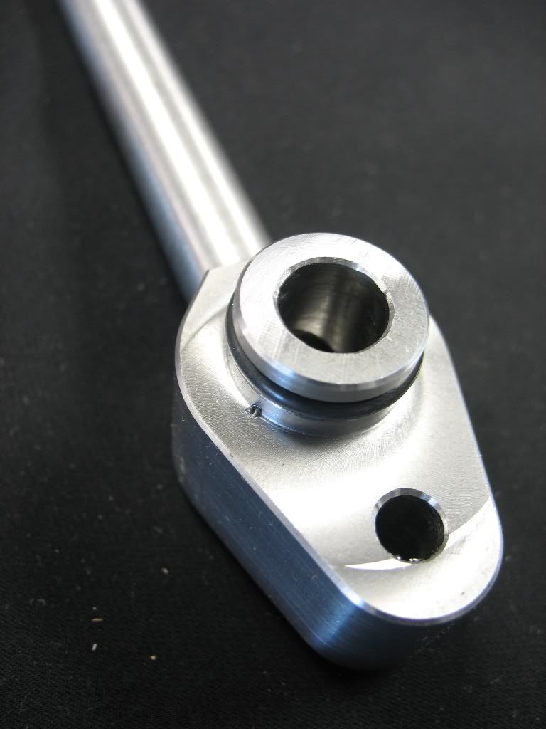

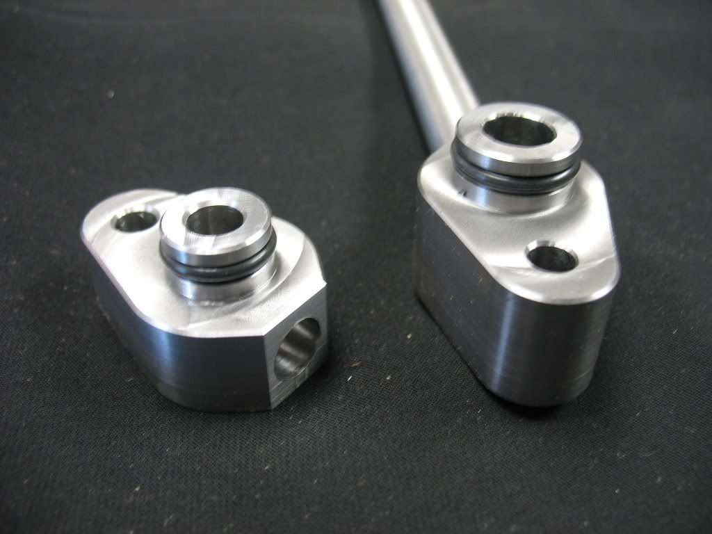

Heres a couple for Vintage Air.....had to machine custom fittings to use the gm a/c compressor/tight clearances, I know I asked you last year about what you were doing for LSA/LS9 AC systems....well here is what we did!
http://i1204.photobucket.com/albums/...o/IMG_6049.jpg
http://i1204.photobucket.com/albums/...o/IMG_6050.jpg
http://i1204.photobucket.com/albums/...o/IMG_6070.jpg
http://i1204.photobucket.com/albums/...o/IMG_6089.jpg
http://i1204.photobucket.com/albums/...o/IMG_6102.jpg
http://i1204.photobucket.com/albums/...o/IMG_6076.jpg
http://i1204.photobucket.com/albums/...o/IMG_6104.jpg
Ran it last week.....wow does it sound nasty! Yeehaw!!
