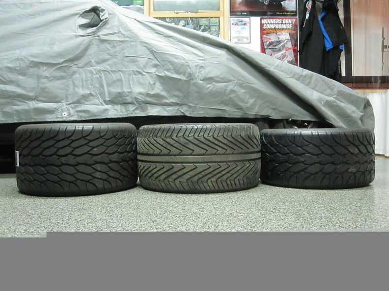

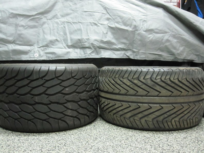

Last week I was looking at the tires stored in Mario's 69 Camaro. I couldn't help but notice that his tire
looked skinny compared to the 335 BFG tire sitting in my garage. I kept telling Mario that my 335 was
much bigger then his 345 and he said no way. So I took his tire home to find out if I was correct. I figured
a side by side test would be the only way to prove that the BFG KDW 2 are indeed bigger.

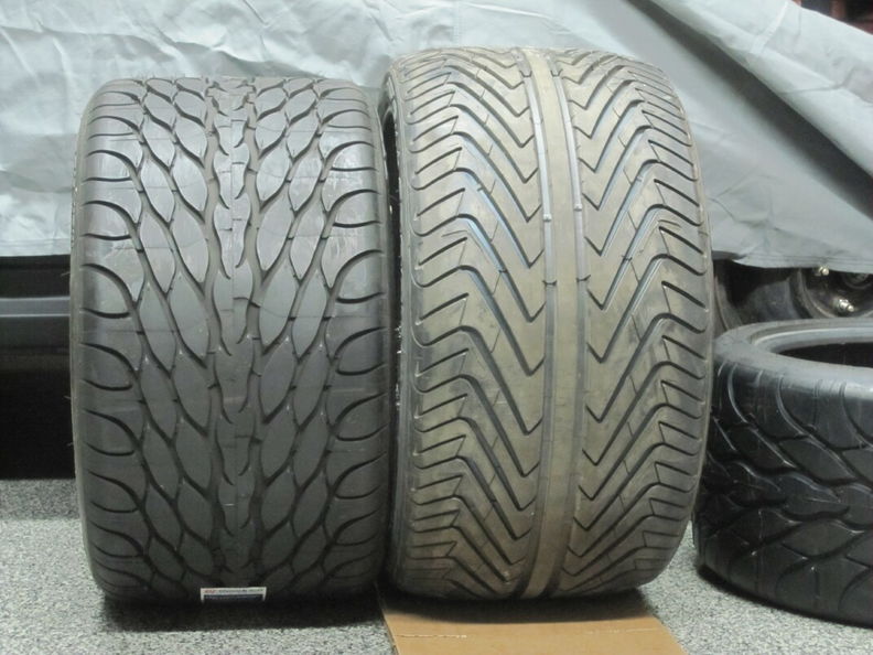

Left: BFG 335 35 18 ( 14" Wide )
Middle: Michelin 345 __ 19 ( 13" Wide )
Right: BFG 295 35 18 ( 12" Wide )
http://garagescene.net/_data/i/uploa...98838d7-me.jpg

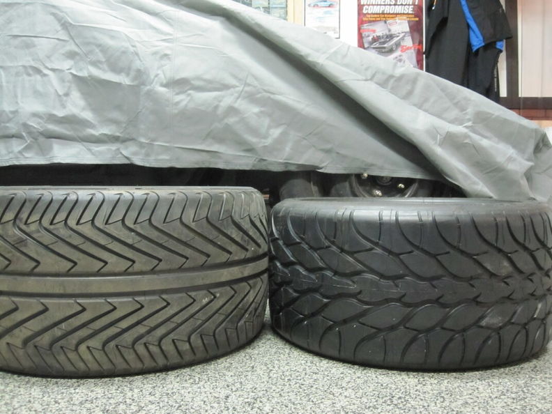

Close up of the BFG 335 & Michelin 345 -- The BFG is 1" Wider
http://garagescene.net/_data/i/uploa...5a61fdb-me.jpg
Close Up of the Michelin 345 & the BFG 295 -- Not much of a difference
http://garagescene.net/_data/i/uploa...7daef51-me.jpg
The BFG 335 height compared to the BFG 295 - you can see the difference is much greater
Also the height is much taller on the Michelin.
http://garagescene.net/_data/i/uploa...e7e5271-me.jpg

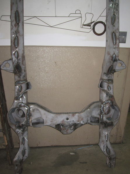

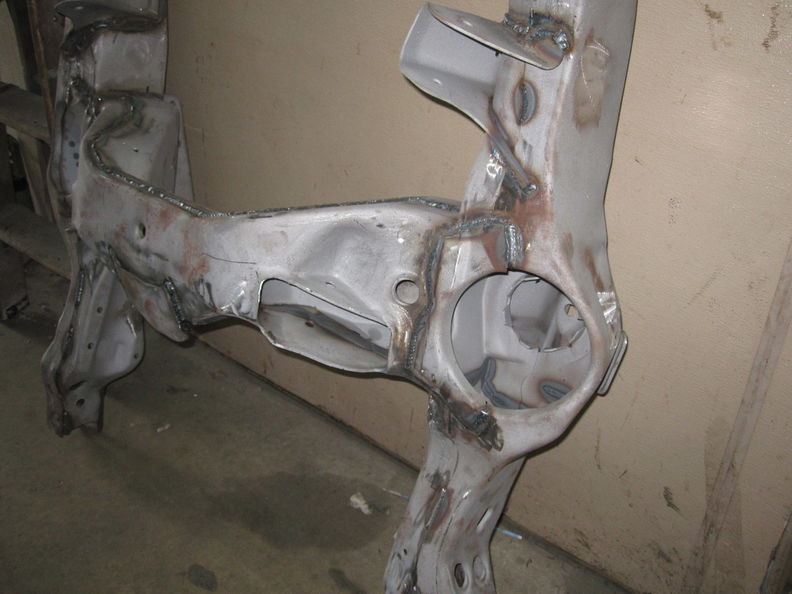

Once I hauled the car over to High Speed Welding Dennis quickly made up these support brackets to take the load
off the lower body mounts. It's amazing how much the chassis mounts flexed or should I say bend when it's be
supported by the factory mounts.
http://garagescene.net/_data/i/uploa...3211c81-me.jpg

Last week I was looking at the tires stored in Mario's 69 Camaro. I couldn't help but notice that his tire looked skinny compared to the 335 BFG tire sitting in my garage. I kept telling Mario that my 335 was much bigger then his 345 and he said no way. So I took his tire home to find out if I was correct. I figured a side by side test would be the only way to prove that the BFG KDW 2 are indeed bigger.
http://i996.photobucket.com/albums/a...compare001.jpg
http://i996.photobucket.com/albums/a...compare002.jpg
http://i996.photobucket.com/albums/a...compare003.jpg
http://i996.photobucket.com/albums/a...recompare1.jpg
http://i996.photobucket.com/albums/a...compare004.jpg
The plan has to been to run the 295's on the street and the 335's for Good-Guys events. In the end I may only be able to run the 295 on the back of 2nd Chance Camaro because I can't get the bracket from DSE.
Why you ask ?
The Mini-Tubs I purchased from DSE will fit the 335's. However, since I didn't buy there complete leaf spring conversion kit I am unable to purchase the front offset sping pocket I need to complete the conversion. Where I am confused is I can buy offset shackle & spring perch's but not the lower spring pocket - odd. I had the Allen (really nice sales guy) ask Kyle if I could purchase them and Kyle said no dice which kinda sucks.
So now I may be forced to run only the 295's full time. So Buyer Beware if buy the DSE Mini-Tubs you are going to have to make your own lower mounts for the front or by one of there 3 kits DSE offers. Sometimes you
win sometimes you lose.
I do have a couple Options
Option A:
Buy there Mini-Tub Kit # 041221 $1699.00 which doesn't include Leaf Springs & Shocks which will give you an 1.5" drop and then sell the other parts you don't need. Seems expensive but it's only money and you can't take it with you.
Option B:
Would be to have a local fab shop make a set of offset shackle mounts to complete the conversion. If I go this route I will make a couple extra to help out the two other guys I know that are in the same boat as me.
Marty bring the car down I can move the frame rail in so you can run the 335.:thumbsup:or you can install the new ridetech 4-bar rear suspension which will let you run a 335 also.Call me Bud.

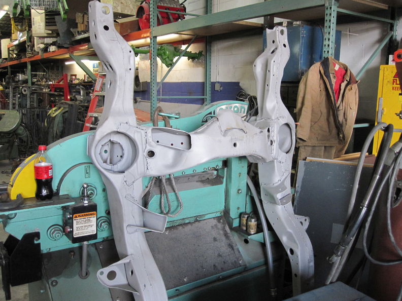

Now that the frame is blasted I can haul it to High Speed Welding. www.highspeedwelding.com Stubby is
going to clean up the welds and add some new weld to stiffen up the frame. Not going crazy just a little clean up.
http://garagescene.net/_data/i/uploa...d172f4f-me.jpg

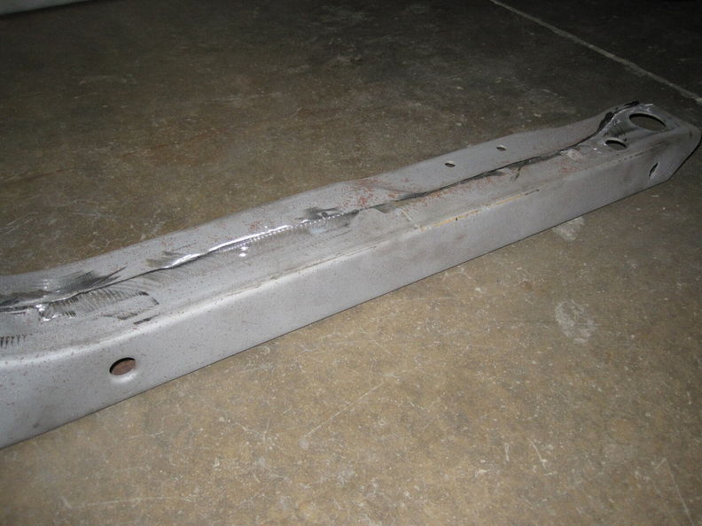

The guys at High Speed Welding did a great job cleaning up the old welds. I'm very happy with the progress.
http://garagescene.net/_data/i/uploa...56080a7-me.jpg
http://garagescene.net/_data/i/uploa...6a2189e-me.jpg
http://garagescene.net/_data/i/uploa...1f90069-me.jpg
http://garagescene.net/_data/i/uploa...42888af-me.jpg

syborg tt 01-09-2012 05:40 PM
2nd Chance Camaro - We have a few new Welds
2012 01-09 Update - We have a few new Welds
Posted: Jan 09, 2012 www.2ndchancecamaro.com
Good Evening all,

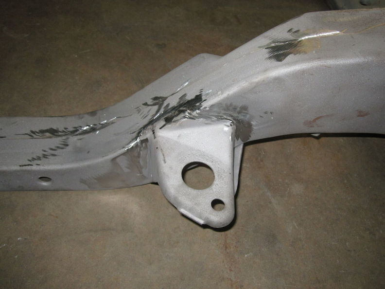

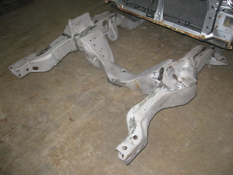

Some quick pictures of the new welds on the subframe.
http://garagescene.net/_data/i/uploa...aa678b0-me.jpg
http://garagescene.net/_data/i/uploa...bc09fae-me.jpg
http://garagescene.net/_data/i/uploa...7d2886d-me.jpg
more pictures when I get it home.
Pictures hosted by www.garagescene.net
