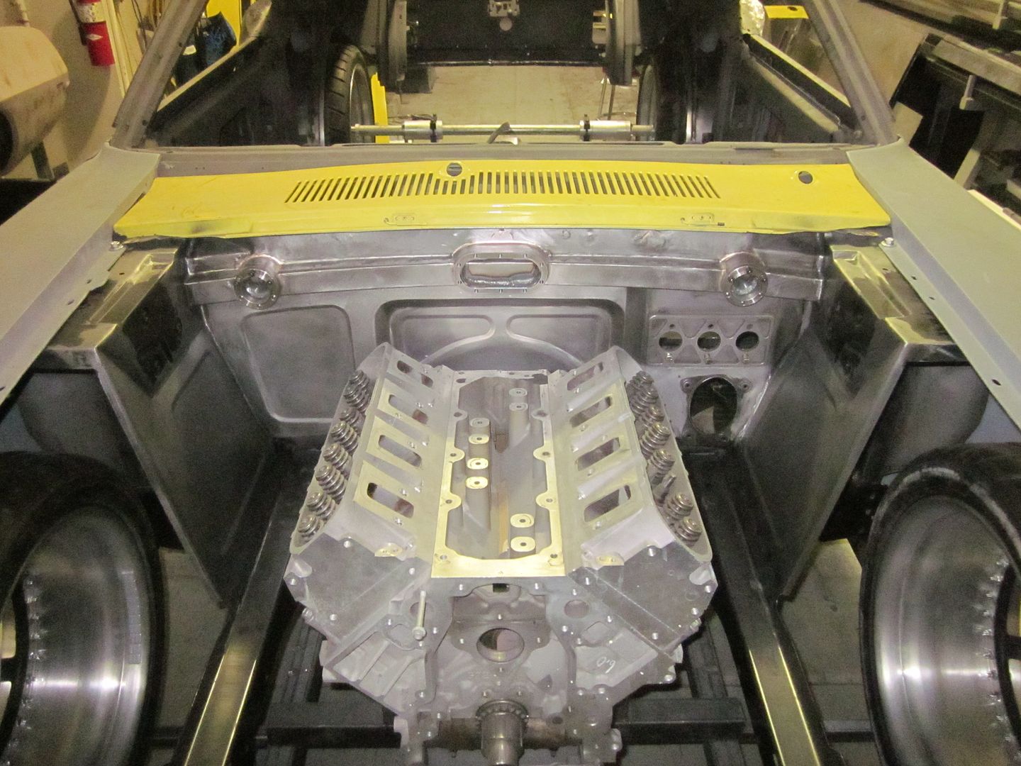

Looks like we have alot of room.. but when we install the aprons.. we start filling up the engine compartment..
The LS engine in this build will make this car perform as the owner wants it too & easy to service.. The goal is for Nick to attend all the events with his dad.. go to driving school.. have fun! In the end .. we want a car that can be upgraded as easy as possible.. The LS engine does that..

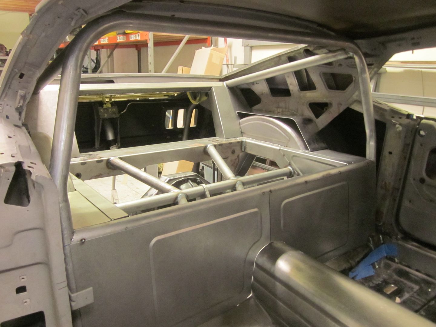

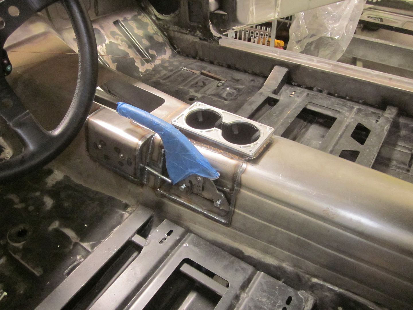

I finally got a bit of time today to post some updates on the Mustang.. We finally got all the firewall done with a part of the trans tunnel.. next phase is to finish out the tunnel, floors & Rear suspension...

68RS350 02-09-2012 05:17 AM
Hey Cris,
Did you push the firewall back to make the pedals more comfortable for the driver? Also which master cylinders are those? I am running into some issues with pedal placement in my camaro and was debating on pushing my firewall back to move the pedals back or just putting the master cylinders inside and then running a remote line through the firewall to reservoirs. Thanks! Car looks awesome though!

Cris@JCG 02-11-2012 05:18 PM
Yes.. We pushed back the firewall but for the purpose of getting the engine back as far as we could... The pedals did end up moving back about 1 inch..
The pedal base & M/C are Wilwood ..
Thanks for the props!

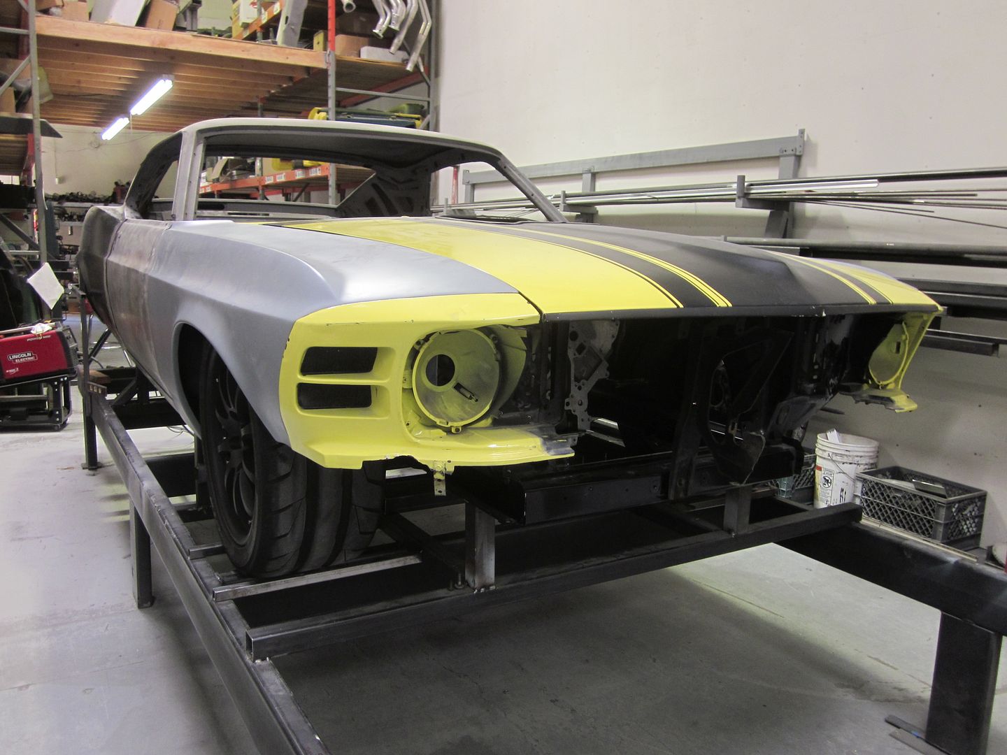

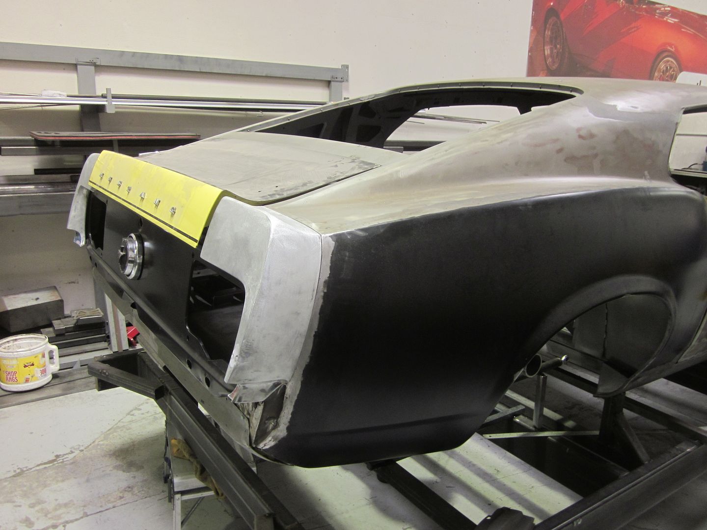

Cris@JCG 02-17-2012 10:25 AM

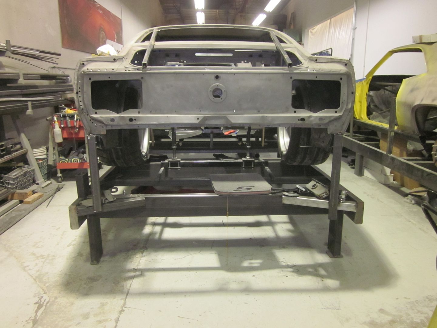

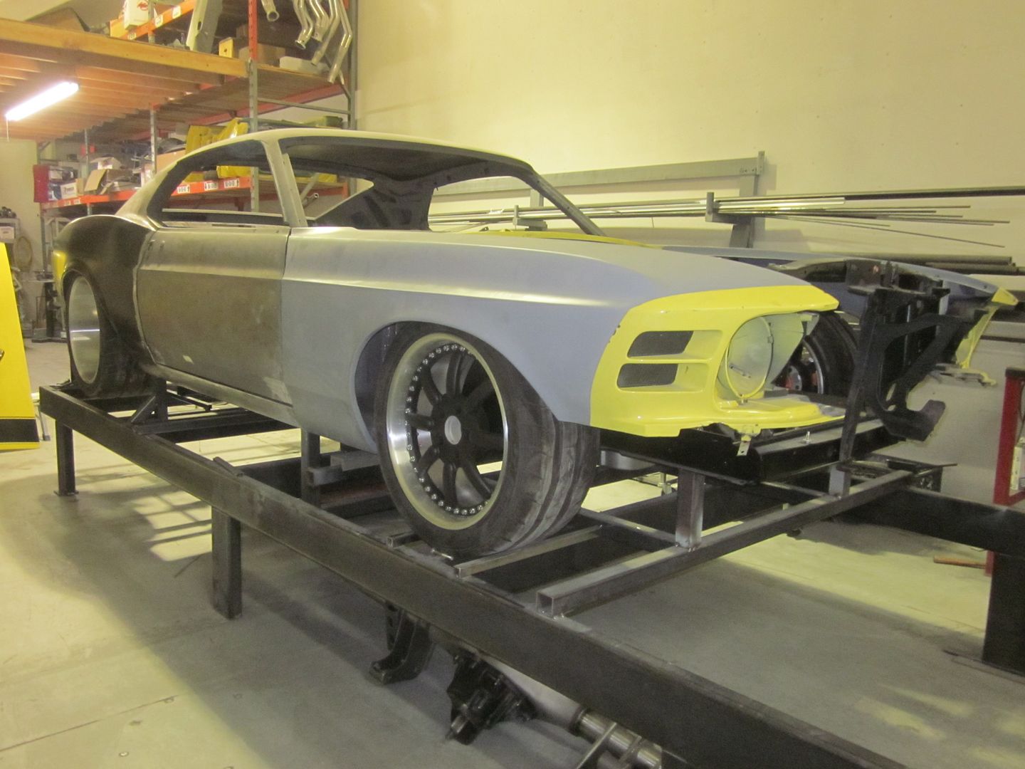

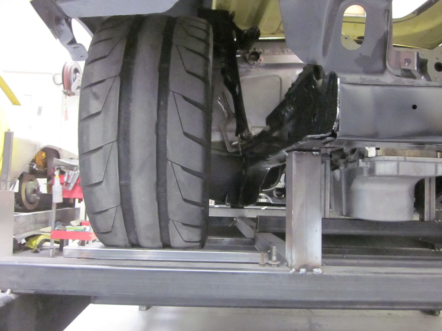

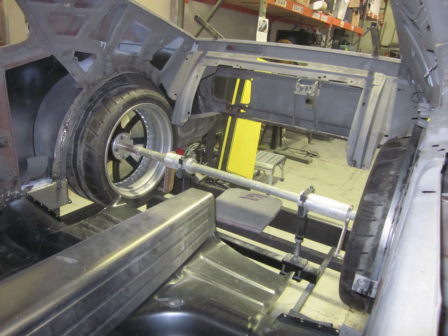

We need to start building rear frame rails but needed to find out how big of a tire could fit in the back with maintaining the the rear fold down seat.. So.. it was time to stretch the car.. We have pulled it about 2 inches per side without losing the look of the car...
We fab'ed some jigs to maintain a even stectch on the car & here are some of the results so far.. She's got some hips now!

Cris@JCG 02-20-2012 07:14 AM
We managed to get 15.5 inches of wheel tub space with the stetch & a small mini tub.. the 335-30-19 should fit with no problem!

Cris@JCG 02-21-2012 07:53 AM
We are gonna keep the tire size the same as Blu Balz.. The owner wants to have one size fit both cars so that tires & wheels are kept in stock for events...

Cris@JCG 02-22-2012 02:00 PM

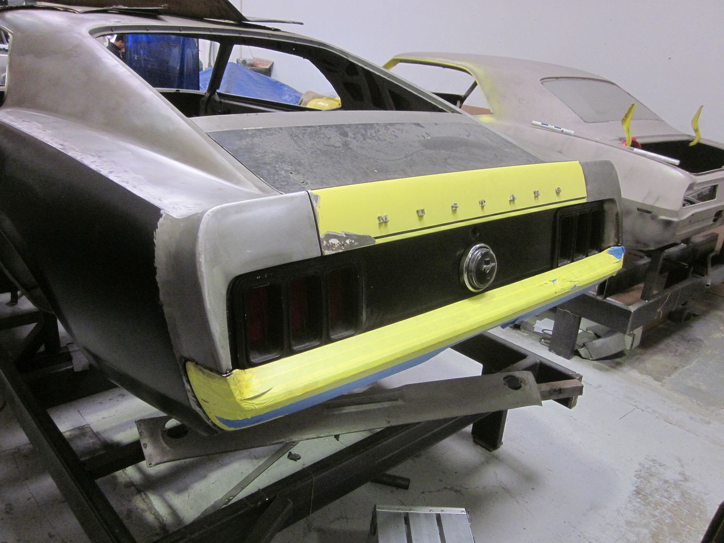

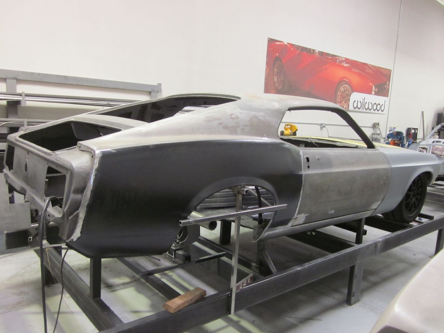

Yeah! The Stang is getting a serious butt lift.. Butt I think we are keeping the shape of the car without distorting it to much..

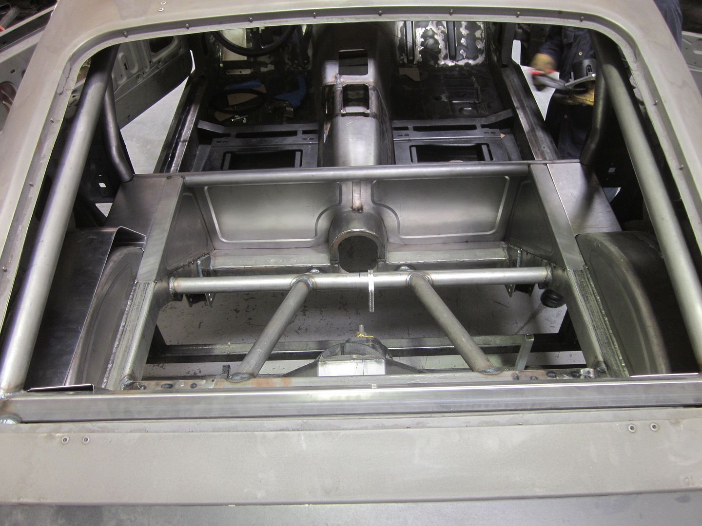

I will have some update pics later this week... The whole floor structure is done & currently working on the rear suspension...

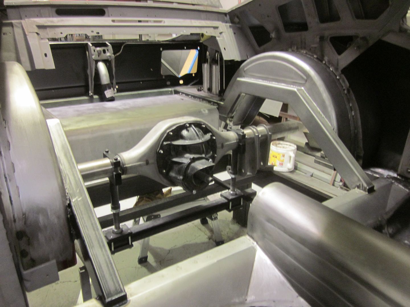

Cris@JCG 07-10-2012 10:21 AM
We finally got around to finishing the rear suspension design on the Mustang.. We are getting pcs laser cut this week.. We are building a cage right now & finishing up the rear stucture... next week we finish the design on the front suspension...

The orignal Pot metal bumper extensions were not working for us with the stretch & the carbon fiber rear bumper... So.. We made our own out of sheetmetal & built them into the body...

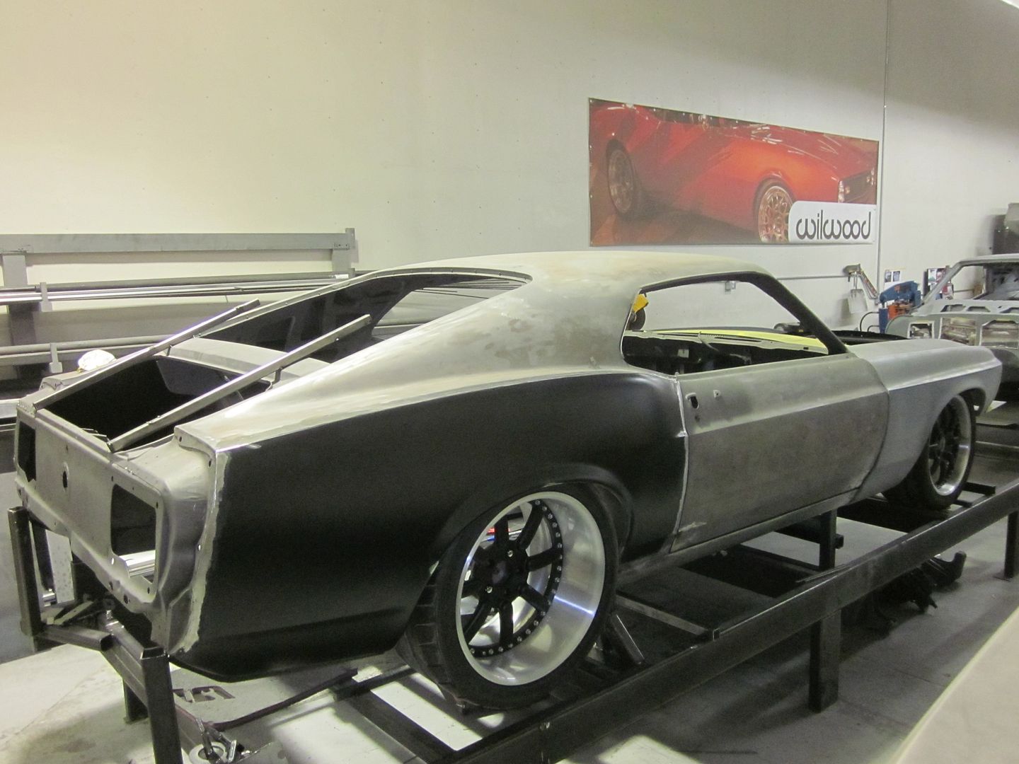

Cris@JCG 08-06-2012 11:32 AM
It has been a while since I have any updates but here are a few... Still have parts being laser cut for rear suspension & parts are being machined... I have a few more new parts coming here pretty soon that I will show when I have the rear suspension done..
