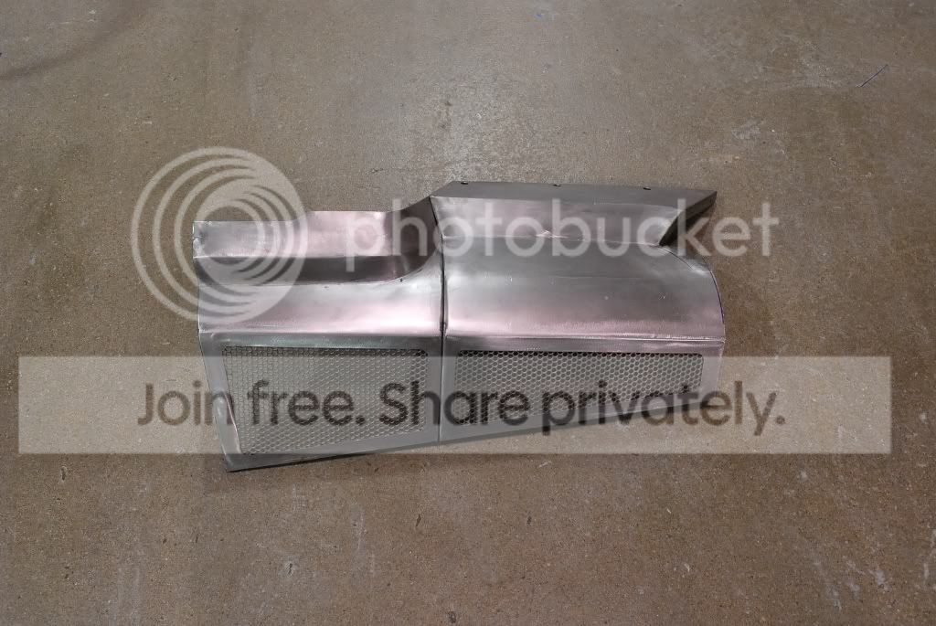

There is actually a lot of room there. The bottoms of the inner fenders are not attached to anything in these pics and are way closer to the motor than they will be when completed.
Originally Posted by DJW32 (Post 357506)
Looks like those vents are functional...damn... very nice work.
The vents are functional. They house K&N air filters and there is then duct work that runs under the inner fenders to the intake.

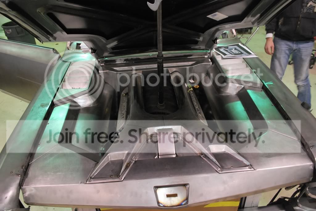

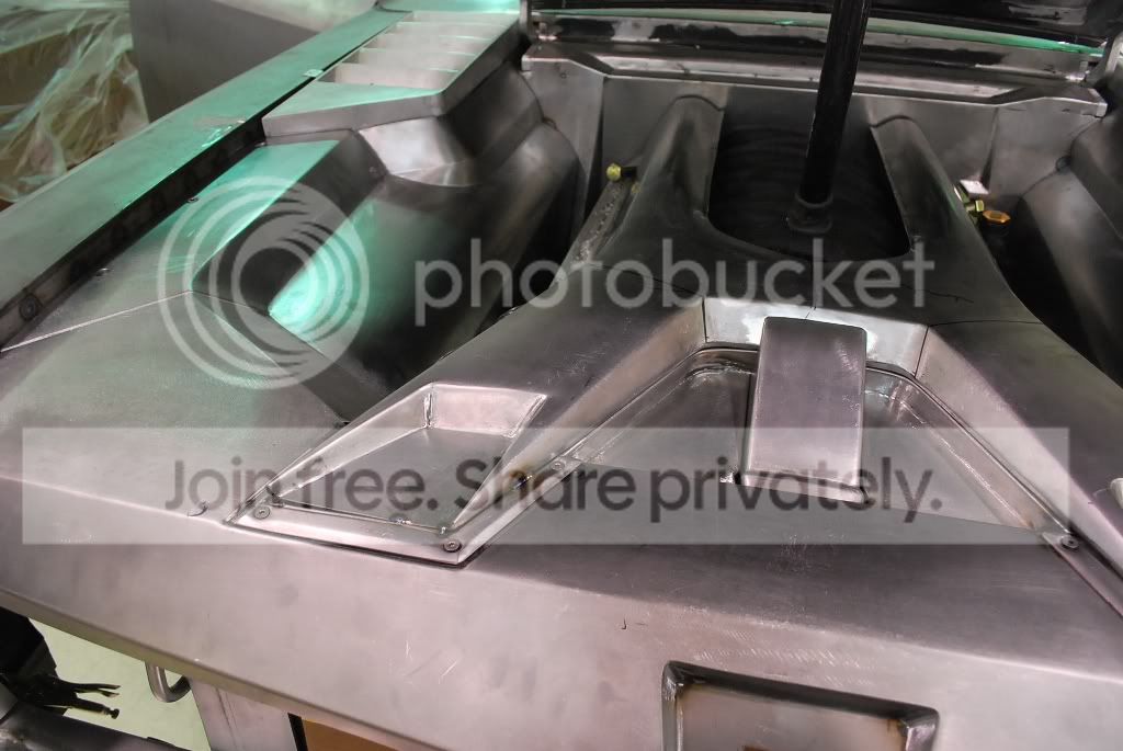

Roadster Shop 07-02-2011 10:39 AM
Inner fenders further along and engine detail starting to take shape:
http://i563.photobucket.com/albums/s...ne%20Bay/7.jpg
http://i563.photobucket.com/albums/s...ne%20Bay/8.jpg
http://i563.photobucket.com/albums/s...ne%20Bay/9.jpg
http://i563.photobucket.com/albums/s...e%20Bay/10.jpg
http://i563.photobucket.com/albums/s...e%20Bay/11.jpg

Roadster Shop 07-03-2011 02:27 PM
Originally Posted by strtcar (Post 357552)
Looks great.
Question, do you guys put anything in the metal/body while working on it so it doesn't flash rust? About to get my 70 Chevelle blasted and then start body work/panel replacement. Was thinking about leaving it bare until metalwork is done then epoxy prime.
We leave all cars in bare metal through out the build process. While under construction we generally use just a scuff pad to keep the metal clean. When the car is ready for body work we spend a lot of time metal prepping the entire care to make sure that all rust and traces of it are gone.

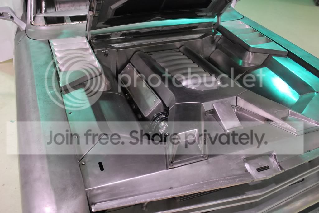

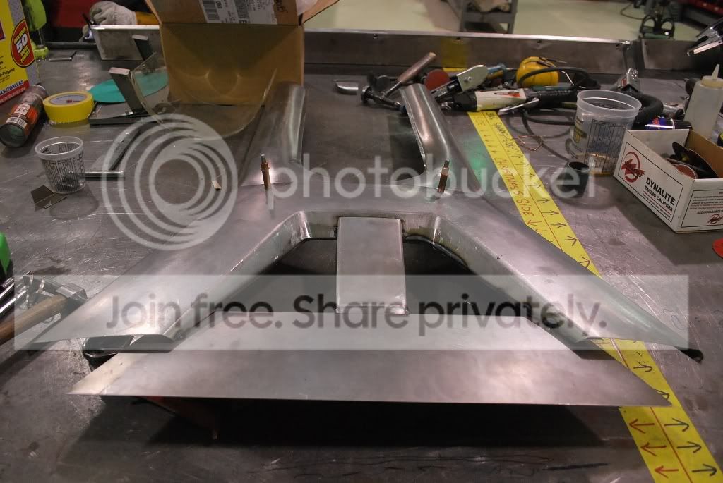

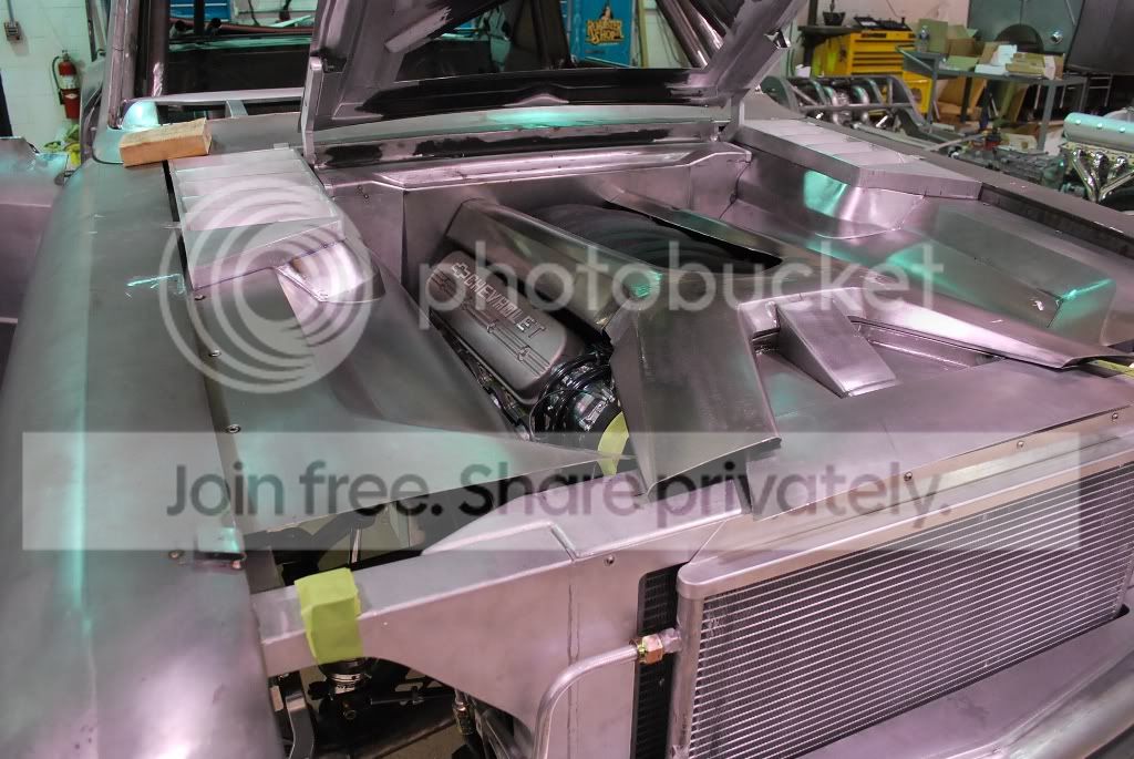

Roadster Shop 07-03-2011 02:40 PM

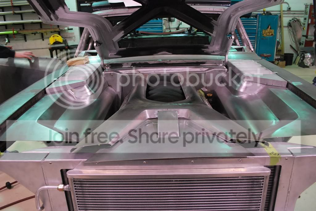

Continuing fab work on the engine detail:
Beginning to fab the recessed center portion.
http://i563.photobucket.com/albums/s...e%20Bay/12.jpg
http://i563.photobucket.com/albums/s...e%20Bay/13.jpg
Pocket detail added to front.
http://i563.photobucket.com/albums/s...e%20Bay/14.jpg
http://i563.photobucket.com/albums/s...e%20Bay/15.jpg

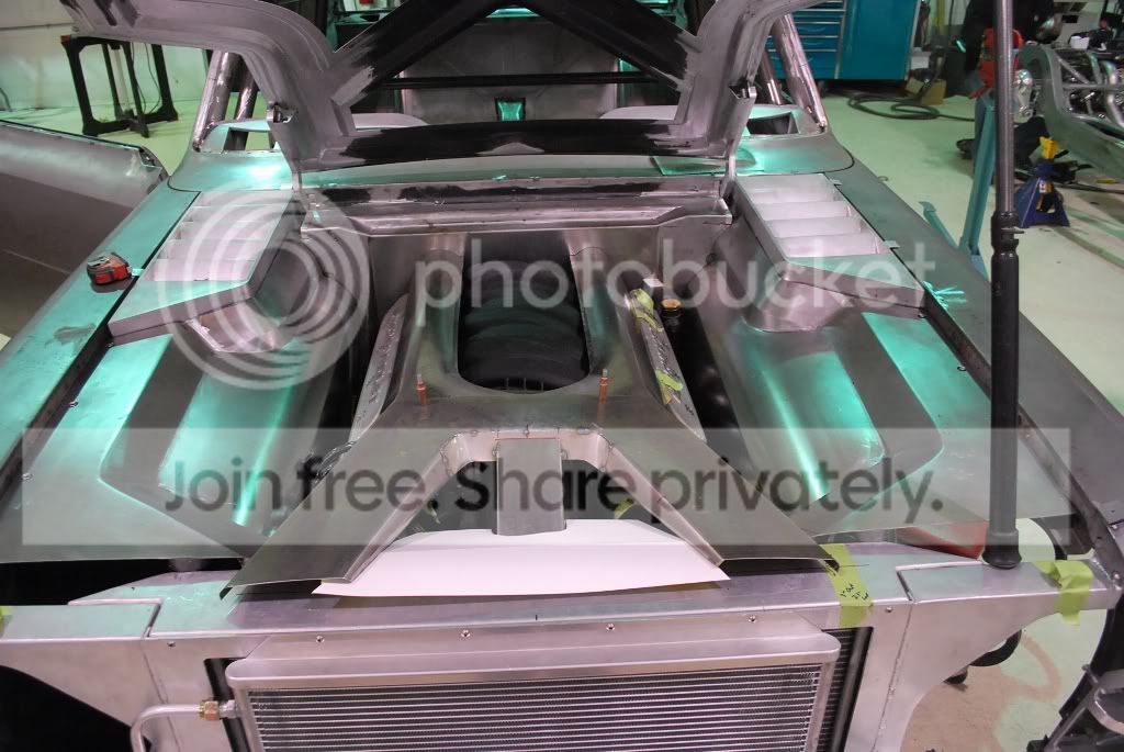

Start of the upper radiator close out panel. Also fabbed a template for the grille.
http://i563.photobucket.com/albums/s...e%20Bay/16.jpg
black2002ls 07-03-2011 02:48 PM
What are you doing for the stereo, looks like an opening left for a double din type radio. GM Factory unit perhaps?

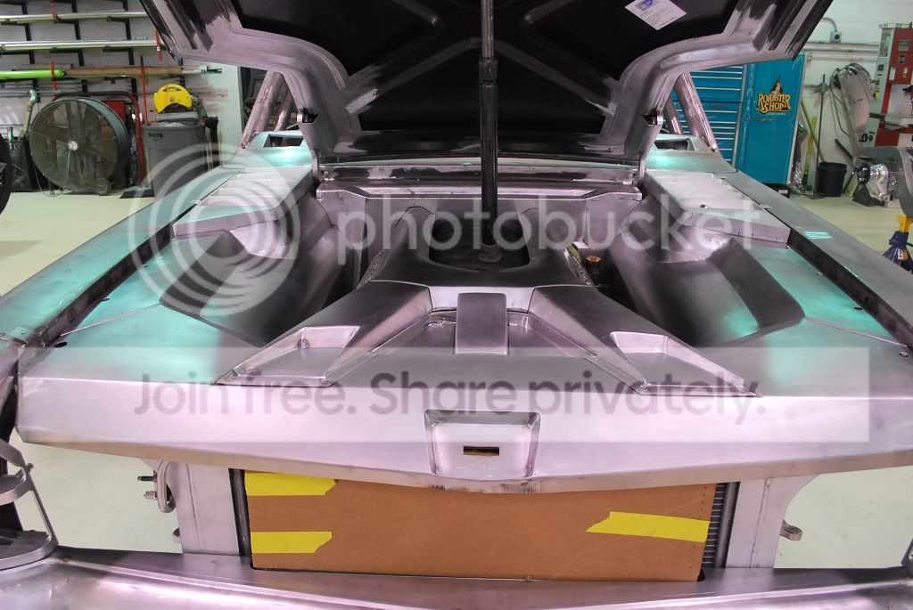

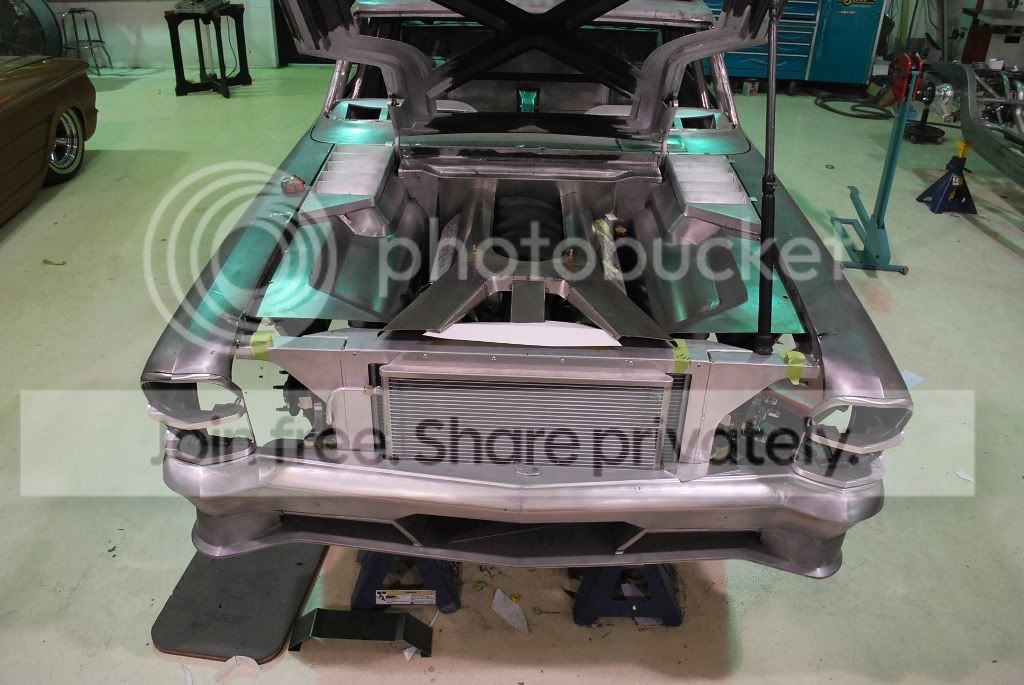

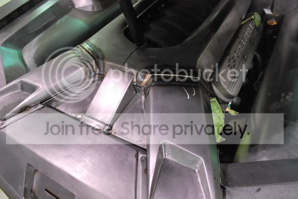

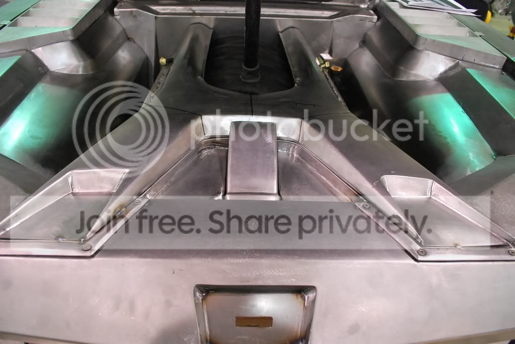

Roadster Shop 07-03-2011 03:38 PM

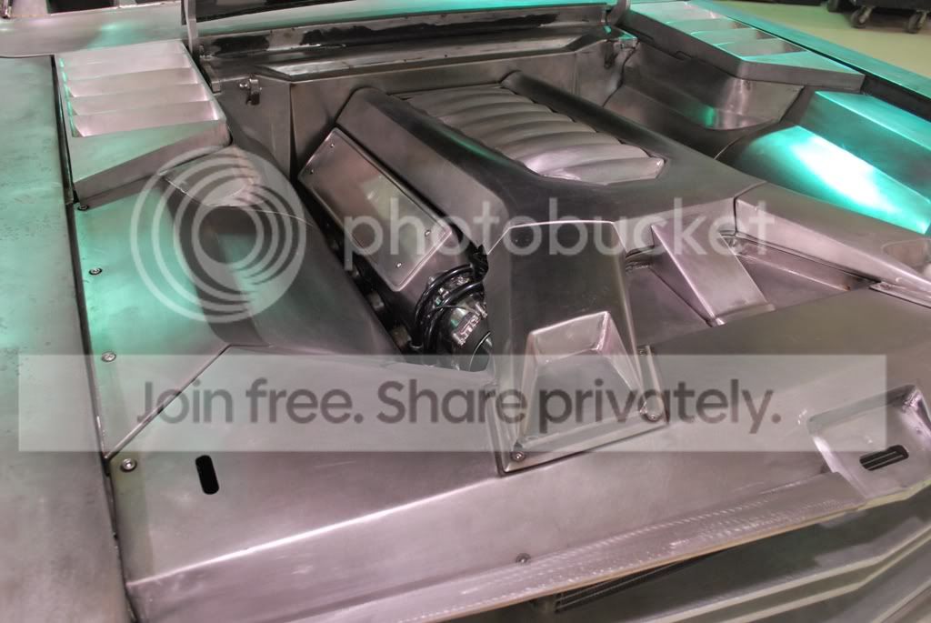

Upper radiator close out panel completed and transitioned into the inner fenders. We went back and put a seam in the the inner fender before it meets the radiator close out panel to add more detail to it. Also have the pocket installed for the BMW hood latch.
http://i563.photobucket.com/albums/s...e%20Bay/17.jpg
Start of the trim piece around where the engine metal work meets the close out panel.
http://i563.photobucket.com/albums/s...e%20Bay/18.jpg
http://i563.photobucket.com/albums/s...e%20Bay/19.jpg
We then went back and put another seam in the forward panels coming off the intake.
http://i563.photobucket.com/albums/s...e%20Bay/21.jpg
http://i563.photobucket.com/albums/s...e%20Bay/22.jpg
Everything metal finished.
http://i563.photobucket.com/albums/s...e%20Bay/23.jpg

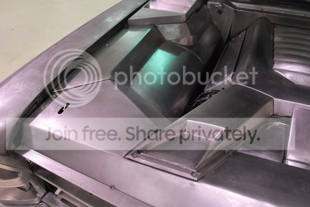

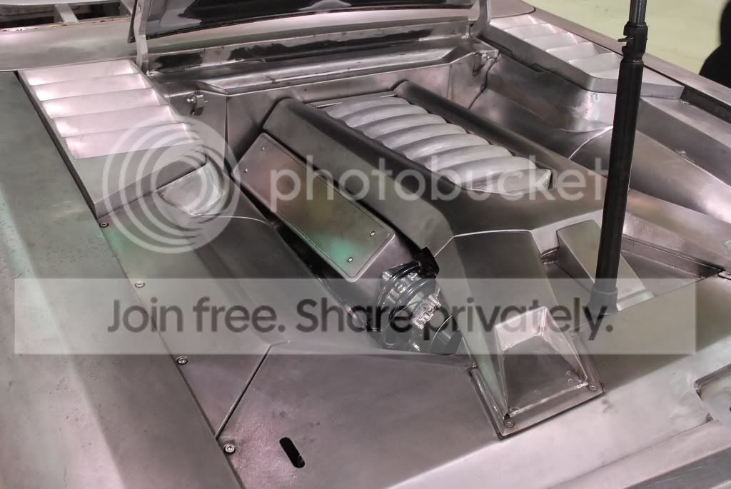

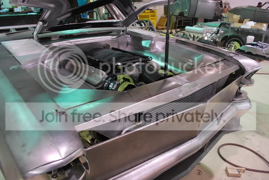

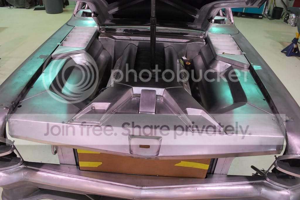

Roadster Shop 07-04-2011 10:28 AM
http://i563.photobucket.com/albums/s...e%20Bay/24.jpg
http://i563.photobucket.com/albums/s...e%20Bay/25.jpg

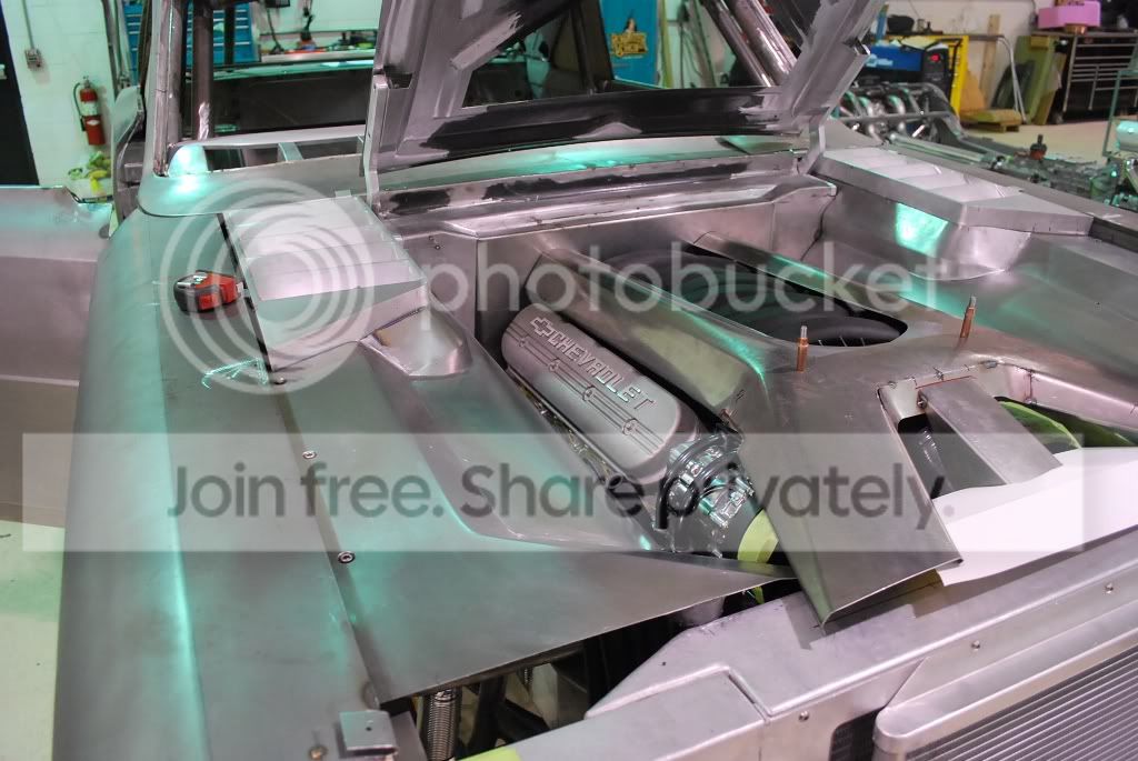

Start of valve cover design. Also have the center intake cover installed. We didn't like the look of the stock GM intake with with the rest of the metal work around it, so we fabbed a cover out of aluminum that had a similar look only with a more uniform rib design.
http://i563.photobucket.com/albums/s...e%20Bay/26.jpg
Inner fenders were removed and perforated metal inserts were added to help get heat out of the engine compartment.
http://i563.photobucket.com/albums/s...e%20Bay/27.jpg

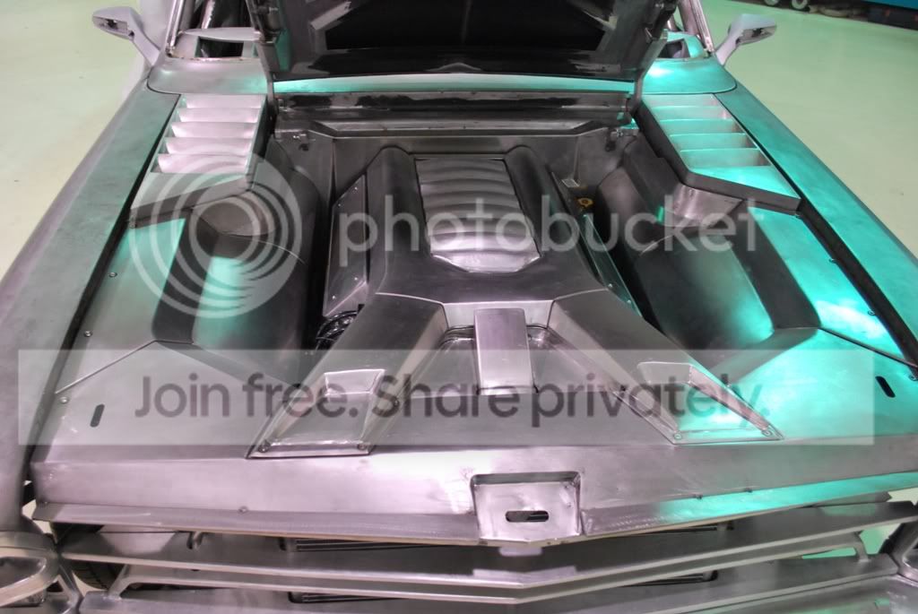

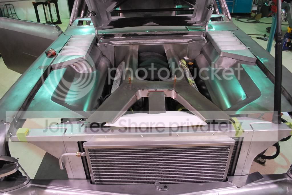

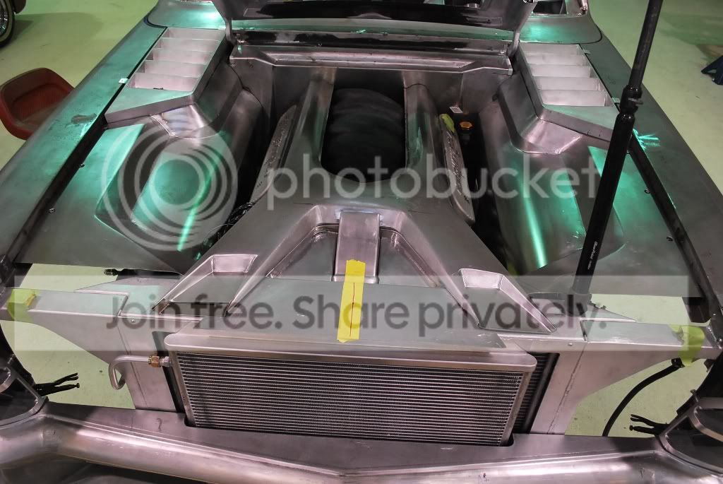

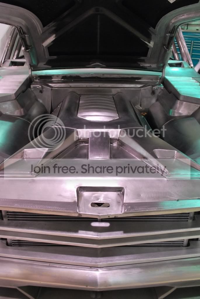

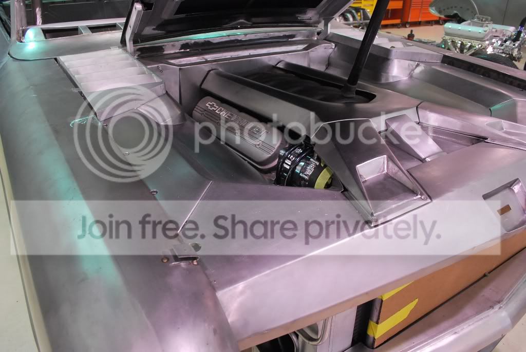

Roadster Shop 07-04-2011 10:33 AM

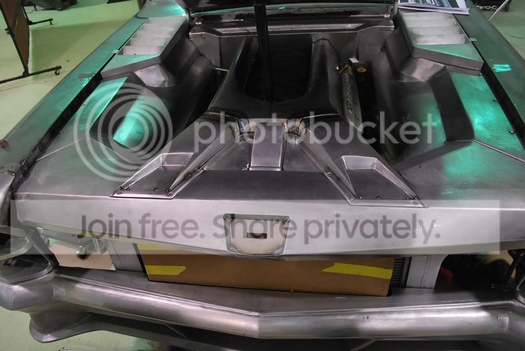

A few completed pics of the engine bay in bare metal. I'm still blown away by how cool this turned out.
http://i563.photobucket.com/albums/s...e%20Bay/33.jpg
http://i563.photobucket.com/albums/s...e%20Bay/34.jpg
http://i563.photobucket.com/albums/s...e%20Bay/35.jpg
http://i563.photobucket.com/albums/s...e%20Bay/38.jpg
http://i563.photobucket.com/albums/s...e%20Bay/37.jpg
http://i563.photobucket.com/albums/s...e%20Bay/36.jpg

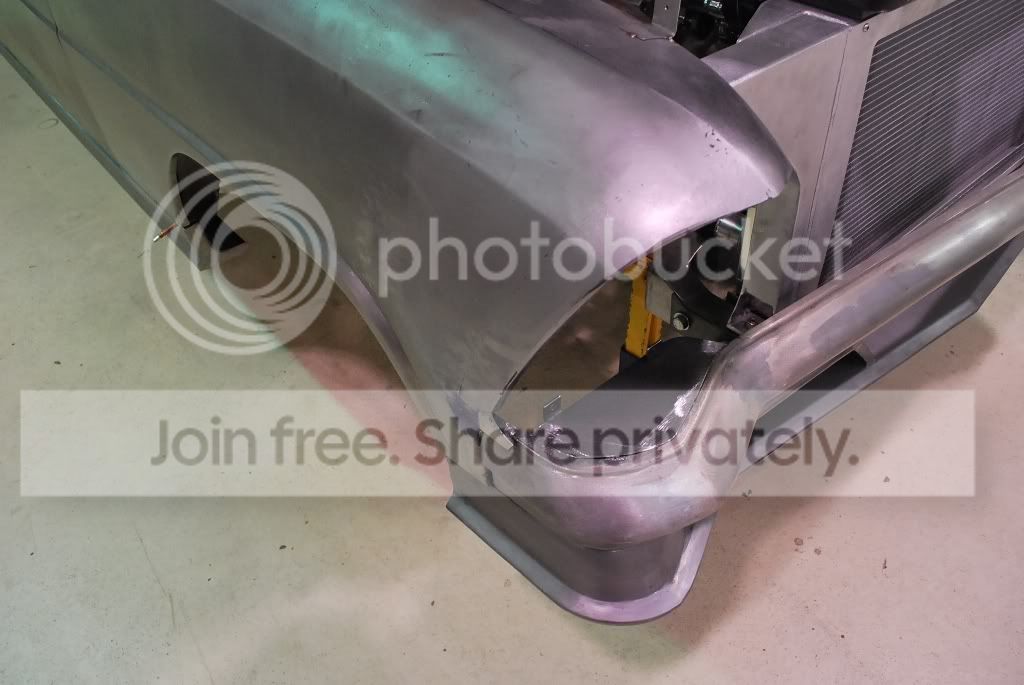

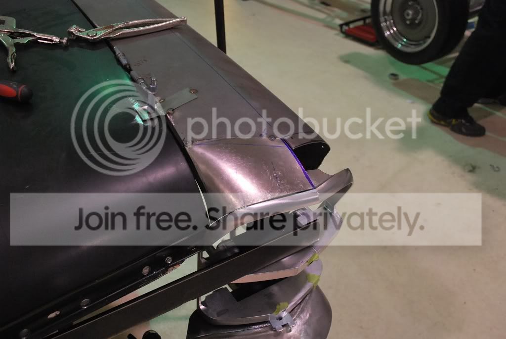

Roadster Shop 07-05-2011 02:10 PM

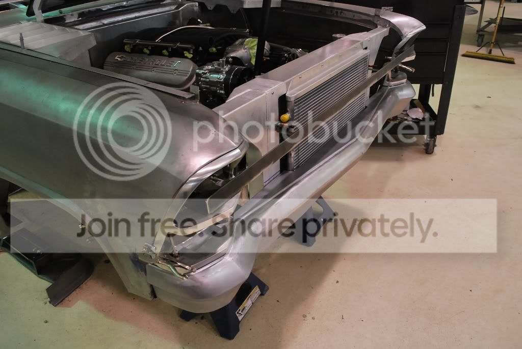

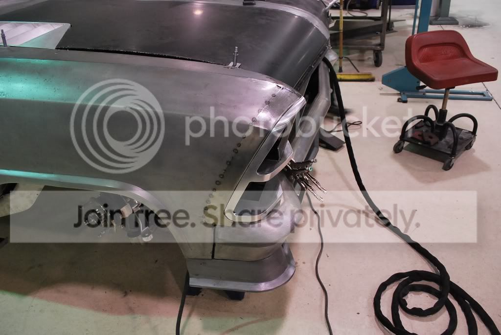

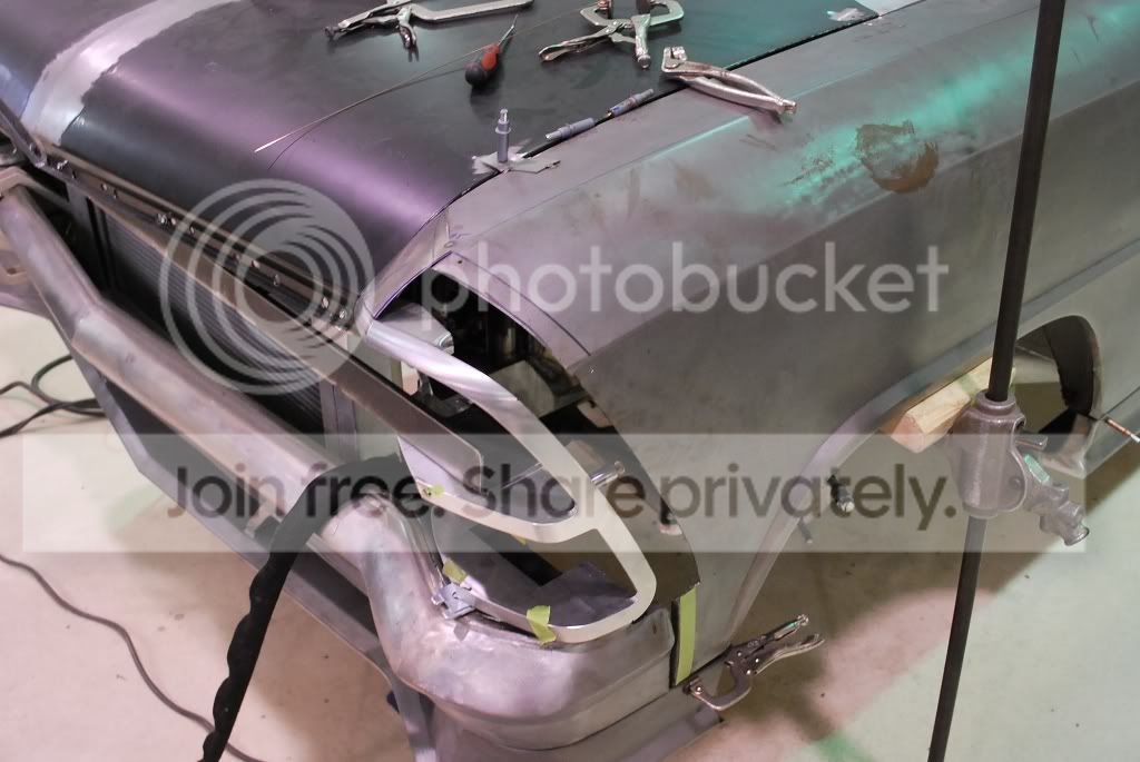

Re-shape of the fender to add a more aggressive look and meet up with the 1-off headlights that GAC/Millwerks machined up for us.
http://i563.photobucket.com/albums/s...ightcut2-1.jpg
http://i563.photobucket.com/albums/s...ovator/122.jpg
http://i563.photobucket.com/albums/s...ovator/123.jpg
http://i563.photobucket.com/albums/s...ovator/124.jpg
http://i563.photobucket.com/albums/s...ovator/125.jpg
http://i563.photobucket.com/albums/s...ovator/126.jpg
http://i563.photobucket.com/albums/s...ovator/127.jpg

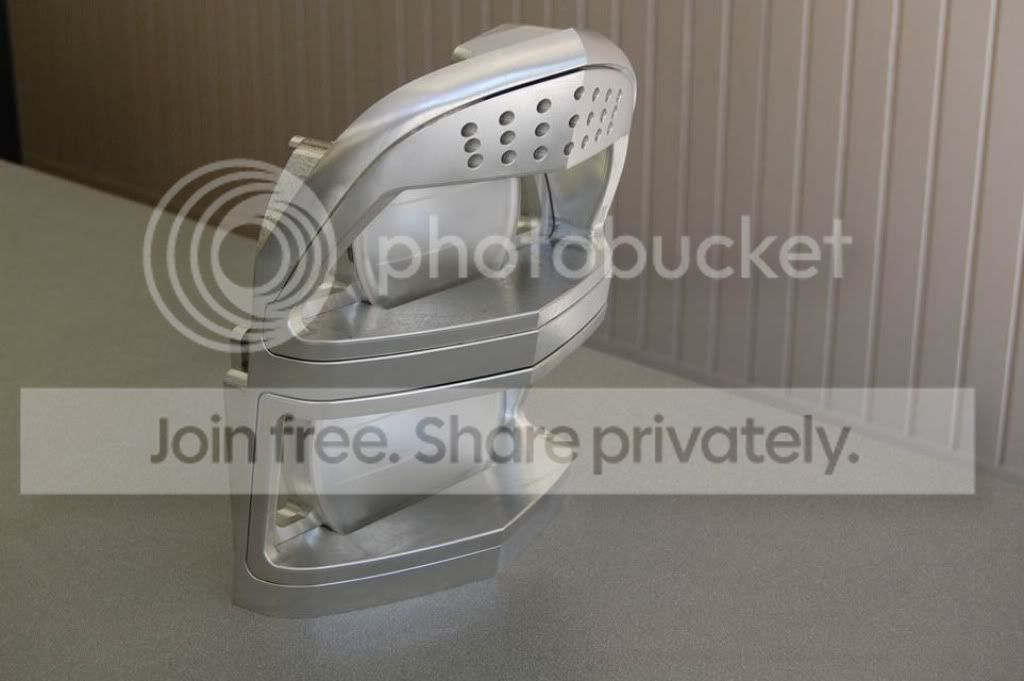

Roadster Shop 07-06-2011 12:34 AM

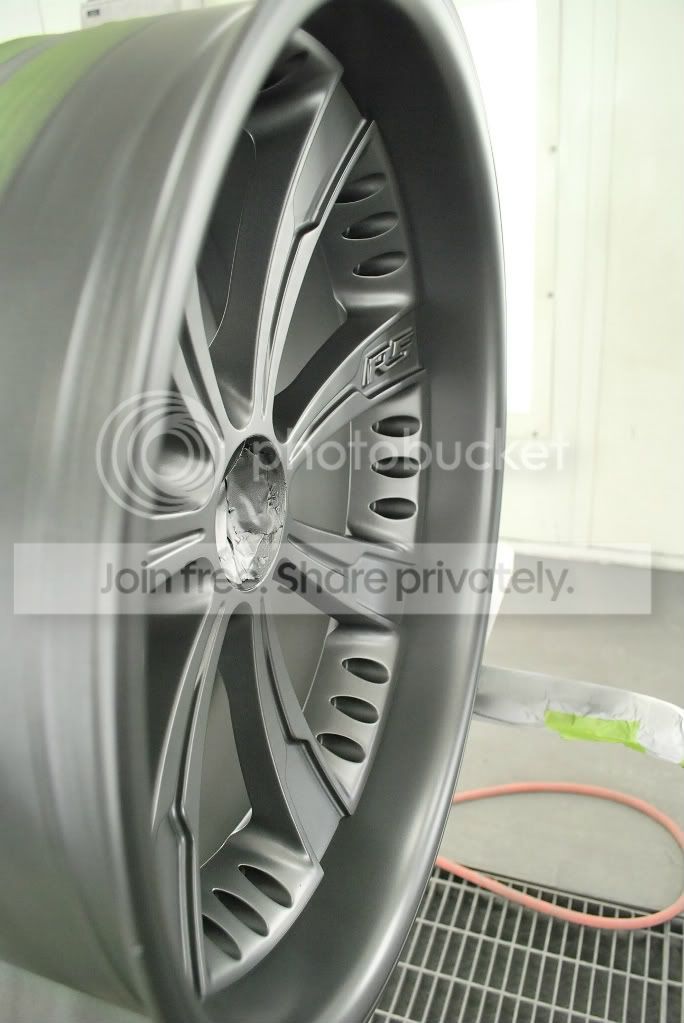

Burning the midnight oil on the last leg before Columbus. Here are a few of the 1-off billet parts for the car.
"RS" center lock wheels
http://i563.photobucket.com/albums/s...arts/wheel.jpg
Shift knob, a/c controls, and vents
http://i563.photobucket.com/albums/s...Picture169.jpg
http://i563.photobucket.com/albums/s...Picture180.jpg
http://i563.photobucket.com/albums/s...Picture172.jpg

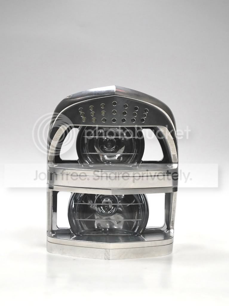

Roadster Shop 07-06-2011 12:36 AM
I'm not sure if words can do the headlights justice so.....
http://i563.photobucket.com/albums/s...dlightcut1.jpg
http://i563.photobucket.com/albums/s...htcropped4.jpg
http://i563.photobucket.com/albums/s...htcropped1.jpg
http://i563.photobucket.com/albums/s...htcropped5.jpg
