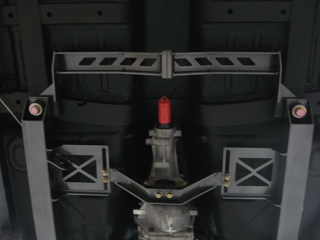

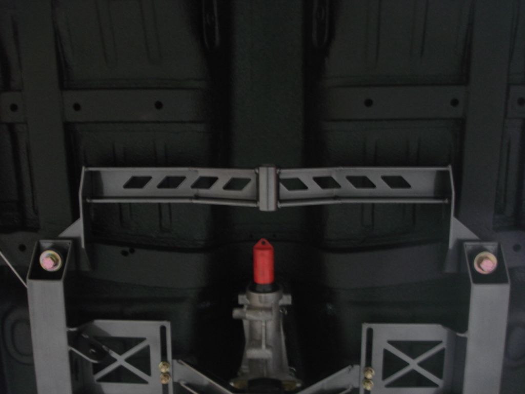

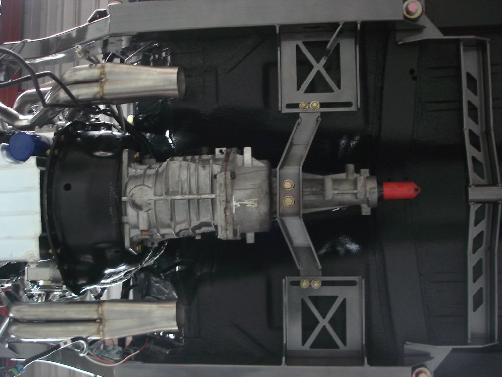

Blake Foster 05-29-2012 09:13 AM
Sure can, I have them in my Nova
http://i1235.photobucket.com/albums/...nnectors-1.jpg
you can see them welded into the floor. in this shot.
Musclerodz 05-29-2012 04:19 PM
Originally Posted by Vegas69 (Post 416955)
Doug, it's my opinion that any rear suspension design could compromise these paper thin frame rails. I push things until they break or prove themself. I'm not sold that a panhard bar is the answer.
One of the reasons i like the quadralink so much. plus the panhard mount reinforces the frame rail as apart of the design.
XLexusTech 05-29-2012 05:38 PM
cool but how does the connectors front Sub and front torque arm all meet up?
Blake Foster 05-31-2012 02:49 PM
Here are some more detailed pictures
http://i1235.photobucket.com/albums/...a/DSC09300.jpg
http://i1235.photobucket.com/albums/...a/DSC09299.jpg
http://i1235.photobucket.com/albums/...a/DSC09298.jpg
hope that shows what your wanting to see.
