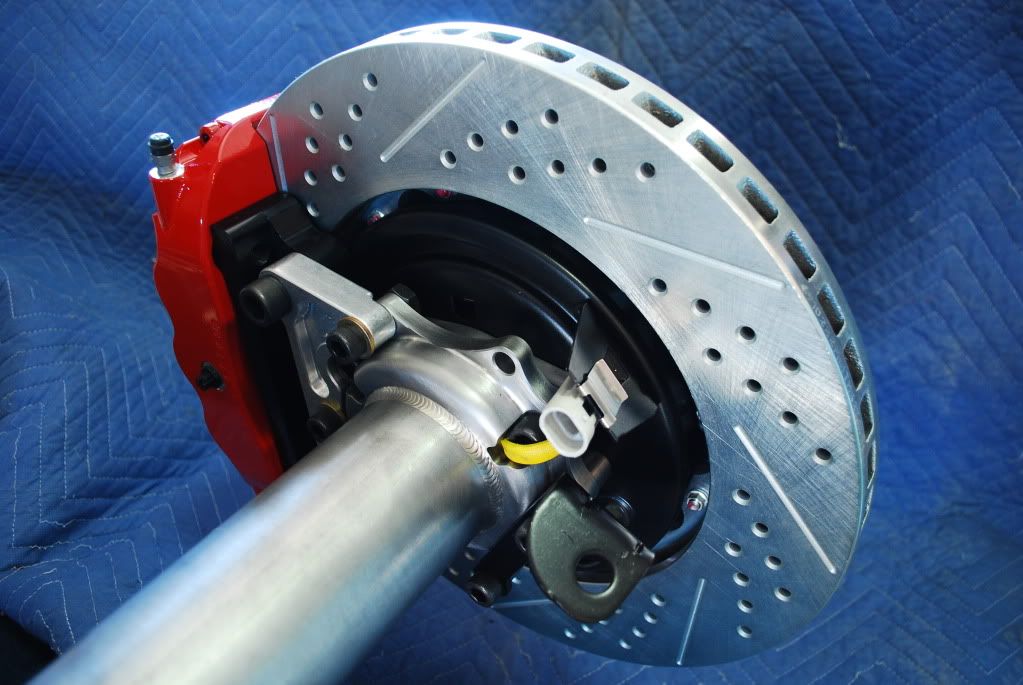

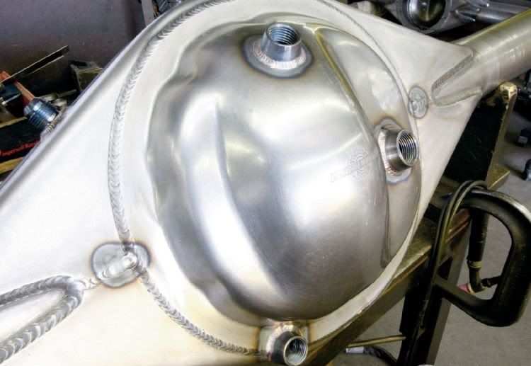

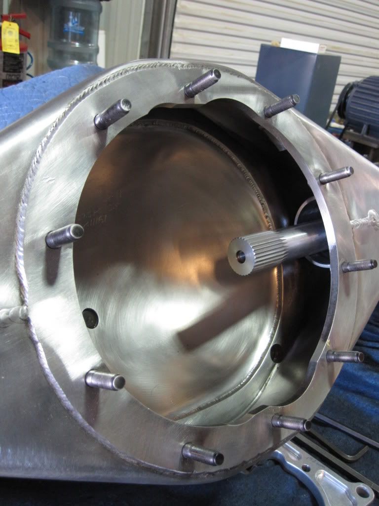

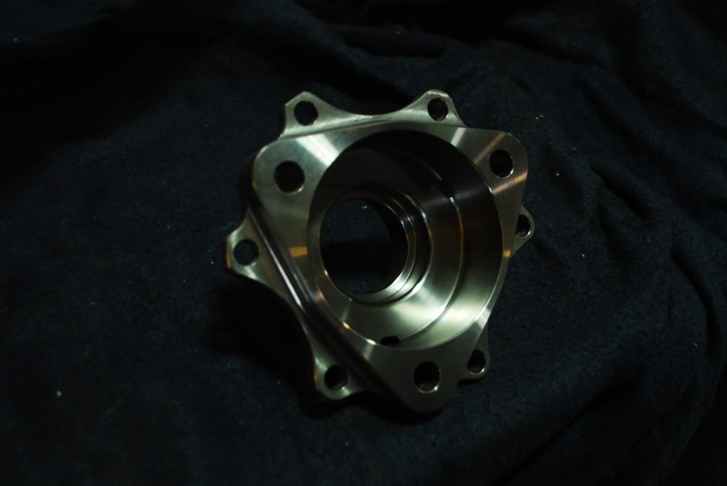

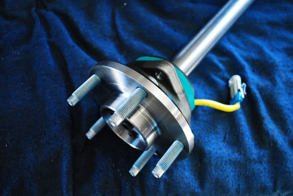

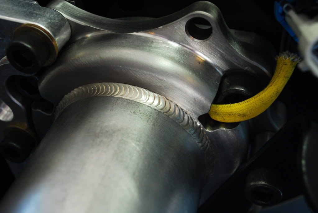

Blake Foster 01-27-2012 08:23 AM
Figure it's time to post up some pictures of this unit.
http://i1235.photobucket.com/albums/...housingend.jpg
http://i1235.photobucket.com/albums/...hubandAxle.jpg
http://i1235.photobucket.com/albums/...ousingweld.jpg
http://i1235.photobucket.com/albums/...oaterbrake.jpg
http://i1235.photobucket.com/albums/...terhousing.jpg
[IMG]http://i1235.photobucket.com/albums/ff425/killer72
nova/SpeedtechPerformanceSpeedwayHousing.jpg[/IMG]

Blake Foster 01-27-2012 08:31 AM
one more
http://i1235.photobucket.com/albums/...wayHousing.jpg
I said it was nice didn't I ???

With a third member approx 4200.00 just paint it and bolt it in.

like the post above says if you have a current 9" 3rd member it will fit. and you can reduce the price by 1500.00
Ron in SoCal 01-27-2012 04:57 PM
Originally Posted by killer69 (Post 392182)
Currently we are ready to start production, I have a few being built now for customers as well as one that will be in ResurreXion (my Nova) for RTTC, I will also have a display unit at RTTC.
There are some limits to the ordering of these rearends,
1. NO you can not oreder the parts seperately and install them your self. The housing alignment is to critical.
2. NO you can not retrofit the ends to your existing housing, feel free to sell that one.
3. NO you can not order the housing with out suspension brackets and weld them on yourself. again housing alignment is critical.
4.YES you can get "NEW" suspension brackets from the company who's suspension you are running, supply all the dimensions required to attach them and for an additional labour fee of 65.00 per hour they can be installed.
5. The housings are available with out a 3rd member in 31 spline. 35 spline is an option CALL if that is what your interested in.
6. YES you can run any Corvette rear brake kit.
7. Yes there are options for different widths
8. YES We can also supply Very high quality all American made Center sections to complete the packace. ( Trutrack and Aluminum case upgrades if desired.)
9. YES there will be provisions for fluid circulation and cooling if requested.
10. YES for an additional charge you can request ARP wheel studs in 12mm or 1/2
This Floater will ONLY be available for 9" ford rear ends, NO others sorry
Camber and Toe adjustability and or preset is NOT an option at this time, we are working on getting more information on the possibility of being able to do this in the future, I know Chicane has been working on this and can probably give an update soon.
If anyone is interested call me directly, I can even deliver no charge to RTTC if you place an order in the next couple of days. sorry about the short notice.
Blake
