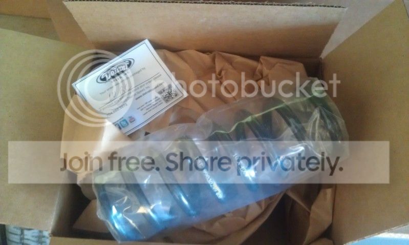

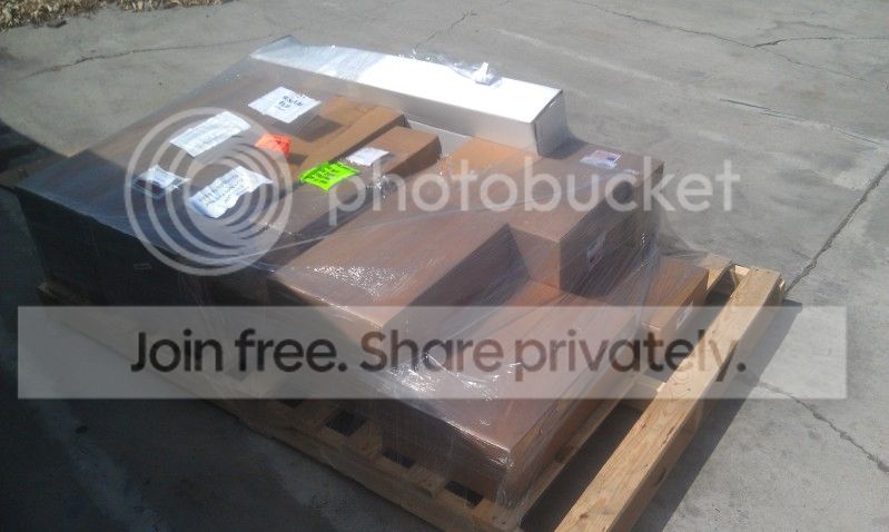

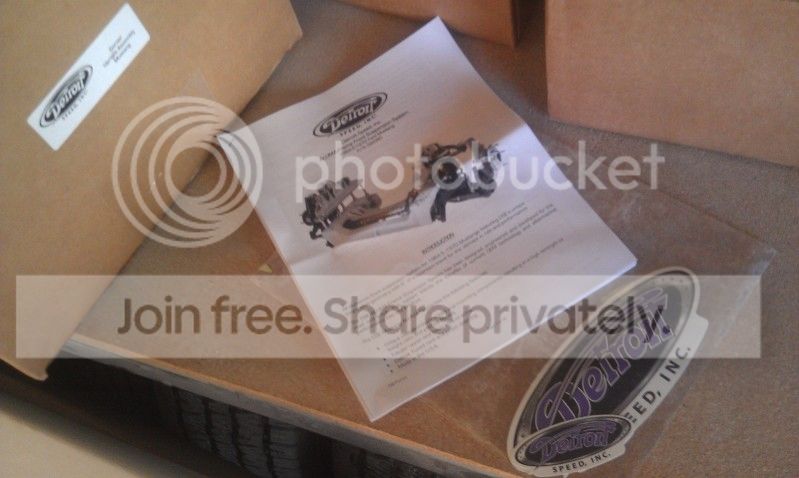

Alright, new page, time for car stuff again. I had a little bit of free time yesterday, and couldn't keep myself from opening up my pile of boxes. I was like a kid at Christmas, okay better than Christmas.
Here is what arrived on Friday.
http://i366.photobucket.com/albums/oo103/69MSA/-5.jpg
http://i366.photobucket.com/albums/o...A/IMAG0631.jpg

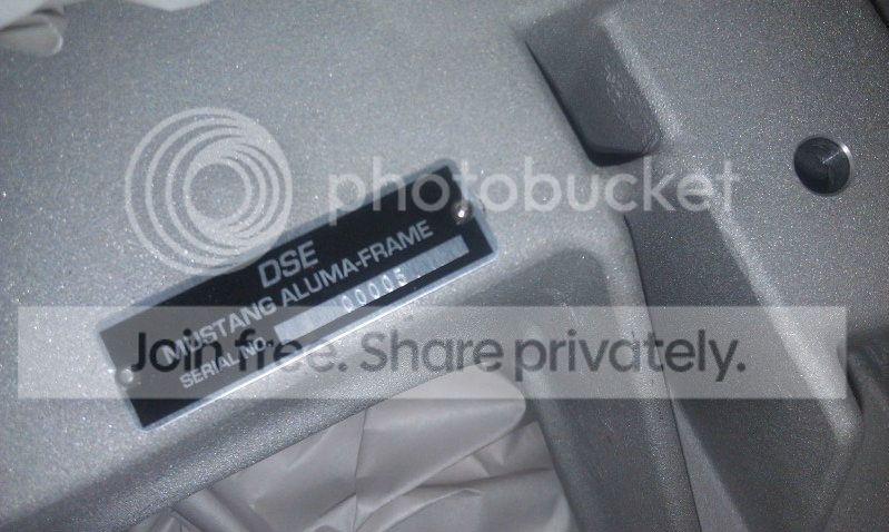

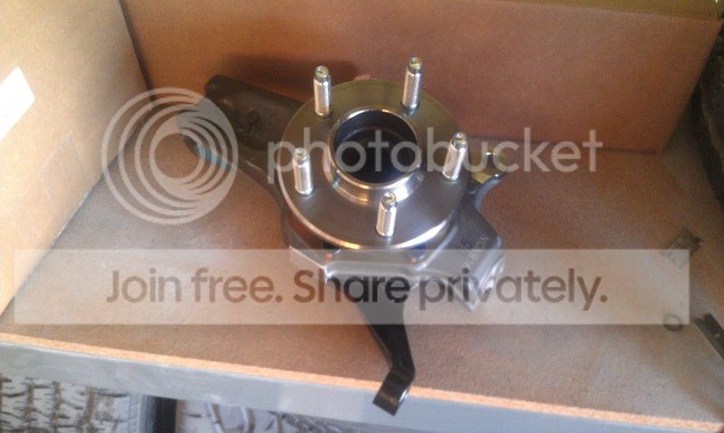

Alright, who has one of the other four before me? I know Strope got his a couple weeks ago.
http://i366.photobucket.com/albums/o...A/IMAG0629.jpg
C6 spindles with 5x4.5" bolt pattern hubs, "severe duty" units will be available later in the year.

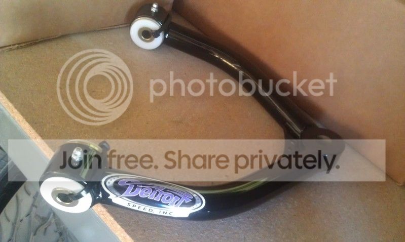

Cast aluminum shock and control arm mount, with tubular upper and lower control arms. I'm looking forward to seeing how the new Speed-LIGN adjuster works for changing camber and caster. I cannot believe how much adjustability is built into this front end. I won't go into detail about all of it at the moment though.

JRI Shocks. These just look well made, I really want get this car on the road to see what all the fuss is about with these. That probably won't be for a while though. These shocks are double adjustable for high and low speed rebound, unlike the former Afco units, which I believe had adjustment for low speed rebound, and compression. As for springs, this kit ships with with 400lb 10 in. front springs. My first thought was that this seemed a little under sprung, but I suppose with an aluminum N/A mod motor up front they really aren't that heavy. Somehow I have a feeling I will be changing things up for my needs.
http://i366.photobucket.com/albums/o...A/IMAG0630.jpg
http://i366.photobucket.com/albums/o...A/IMAG0626.jpg
Overall, I have to hand it to DSE, I have never seen an aftermarket part that comes close to resembling this. Their front subframe for the Camaro is amazingly well built, but this actually has aspects of today's OEM quality, coupled with the expected delrin bushed control arms, etc. :bow:

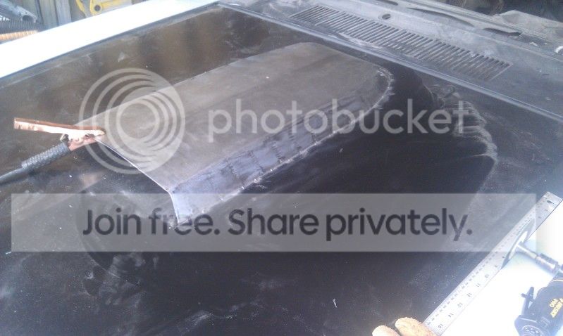

Matt@BOS 10-19-2012 09:22 PM

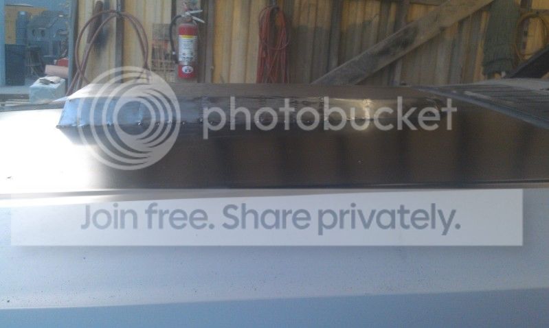

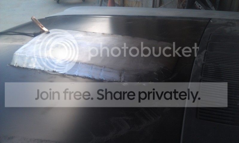

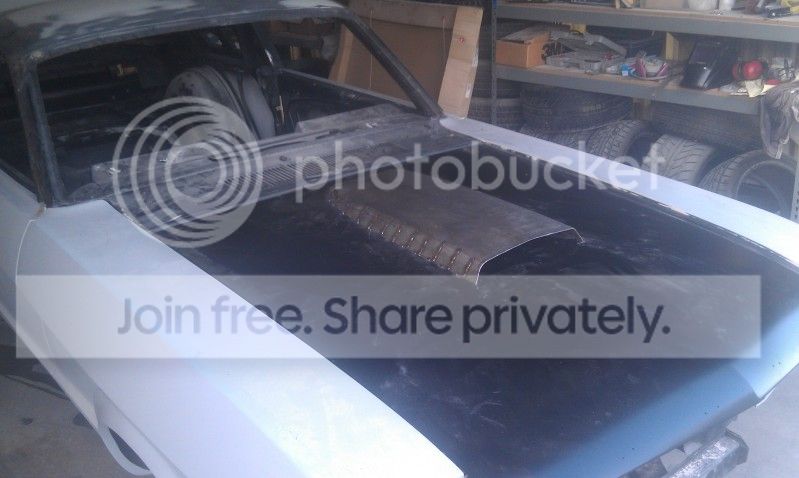

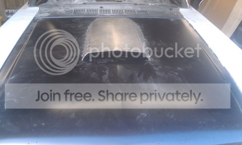

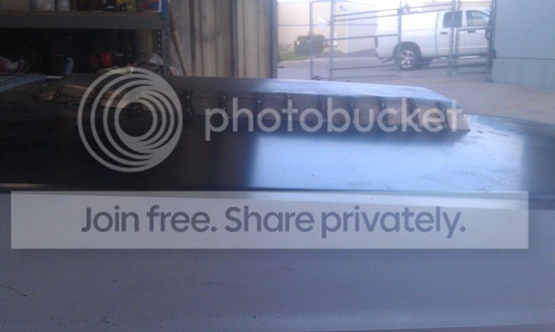

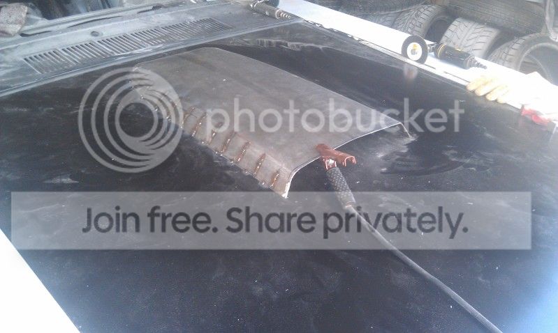

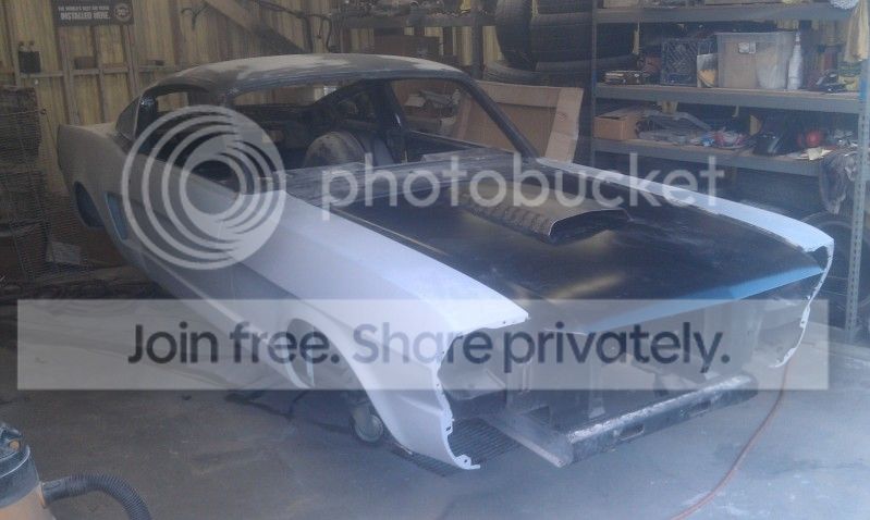

Update! Been busy patching rust in the drip rails and replacing the panel behind the rear glass. That stuff really is no fun at all. I had to make some of that stuff from scratch. Everyone shaves drip rails, and now I think I know why. I probably had 30 hours into making and fitting the front corner on the driver's side drip rail so that the trim would fit over it perfectly.
Anyway, I started working on something a little more interesting, so here are some pictures. This was my first time playing with the English wheel, and I'm pretty happy I haven't had to make more than one hood scoop... at least so far. Still need to do some more hammering and grinding on it, but it is really starting to come around. Really wish I had big shrinker/stretcher. Making a bunch of cuts probably isn't the cleanest way of doing things.
The scoop is just a little bigger than stock, and will hopefully fit the engine I don't have yet :lol: The idea was to make something that looks vintage GT350ish and won't draw too much attention to itself.
http://i366.photobucket.com/albums/o...A/IMAG0725.jpg
http://i366.photobucket.com/albums/o...IMAG0724-1.jpg
http://i366.photobucket.com/albums/o...A/IMAG0723.jpg
http://i366.photobucket.com/albums/o...A/IMAG0730.jpg
http://i366.photobucket.com/albums/o...A/IMAG0731.jpg
http://i366.photobucket.com/albums/o...A/IMAG0729.jpg
http://i366.photobucket.com/albums/o...A/IMAG0728.jpg
http://i366.photobucket.com/albums/o...A/IMAG0726.jpg
