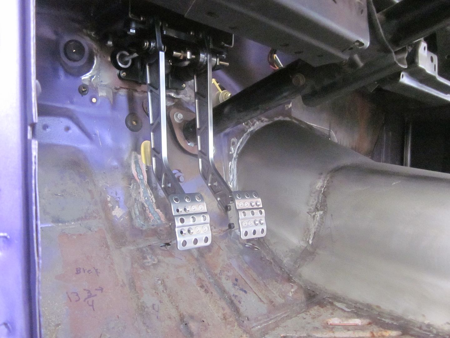

Just completed this project… been thinking about this for some time & finally got around to making a set.. pedals that are adjustable from side to side & little adjustment from up & down.. This will should help with heel & toe.. Plus I wanted to increase the pedal ratio.. the Wilwood’s have a 6.25 ratio & now we have increased it to 7.25 ratio.. this should give a bit more leverage.. We will need to play around with M/C bore size to find one that is not very firm but will give us a small amount of travel for modulation..
http://i1015.photobucket.com/albums/...ps9e8bc9d5.jpg
http://i1015.photobucket.com/albums/...psbf3687d2.jpg

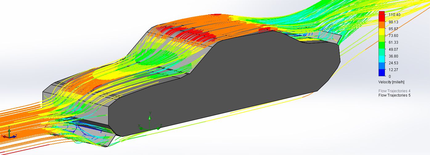

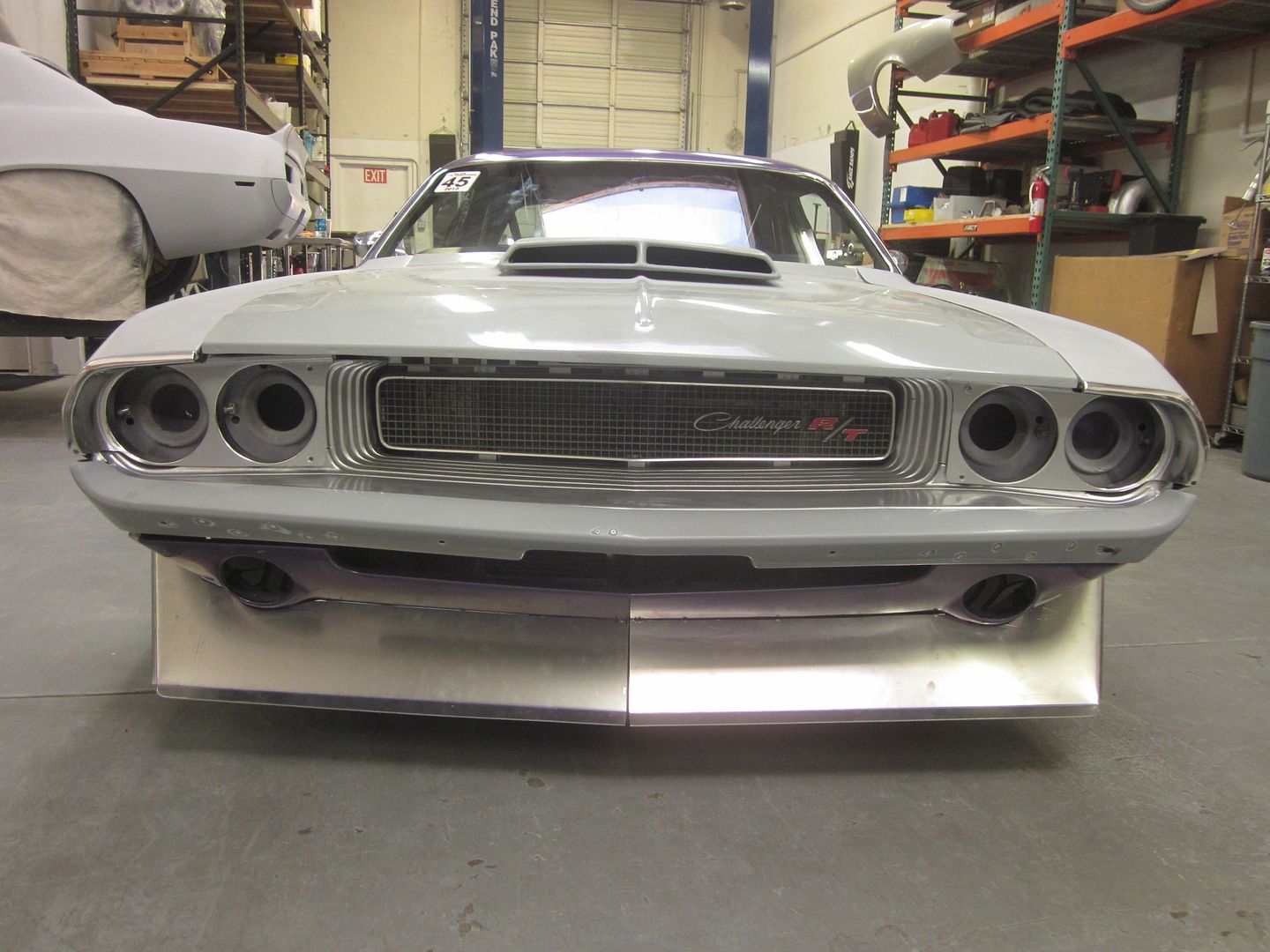

We've been experimenting with various aerodynamic improvements on the 70 Challenger. In order to aid our development, we've generated a rough model of the Challenger center profile to study the characteristics of airflow over the body. By creating a virtual wind tunnel with the aid of CFD simulation software, we can evaluate how changes in spoiler angle, height, and profile--for example--affect the overall lift and drag generated throughout the body. While this model only gives us a partial representation of the aerodynamic behavior of the car, it is a great starting point in evaluating how certain changes alter the pressure zones and air velocity over and under the vehicle. As we develop a more comprehensive model of the car, more and more aspects of the car's behavior at speed will be realized.
http://i1015.photobucket.com/albums/...ps329eec1b.jpg

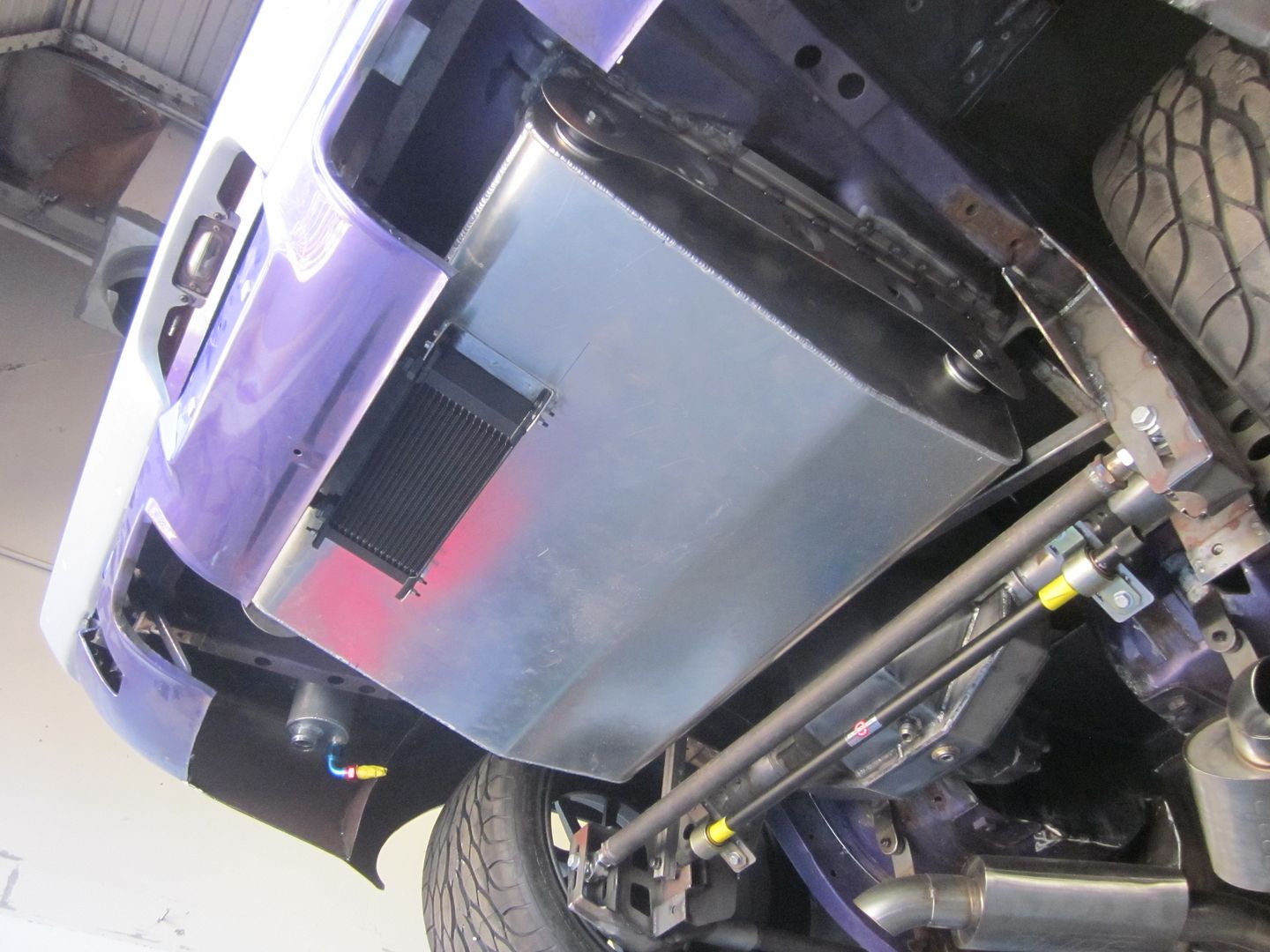

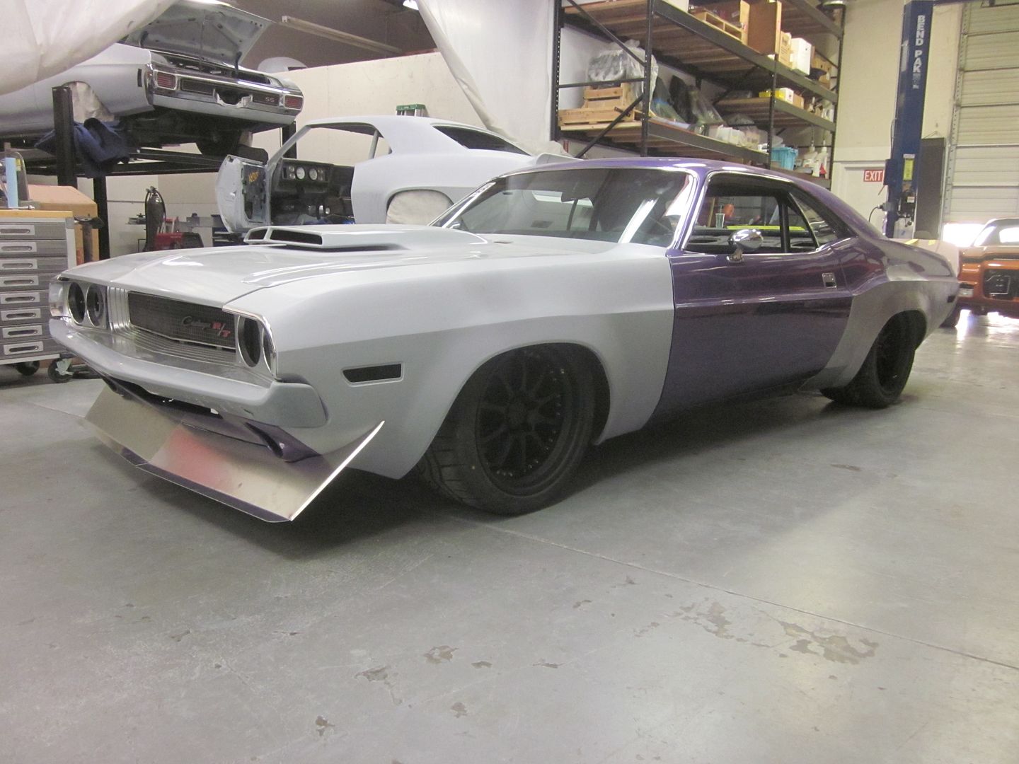

Here are few progress pics..
http://i1015.photobucket.com/albums/...ps463ddc05.jpg
http://i1015.photobucket.com/albums/...psb6b3cdaa.jpg
http://i1015.photobucket.com/albums/...psfcd6ff7c.jpg
http://i1015.photobucket.com/albums/...ps68aebc38.jpg
tones2SS 07-29-2013 04:56 PM
Awesome work Cris. That car should handle very well.

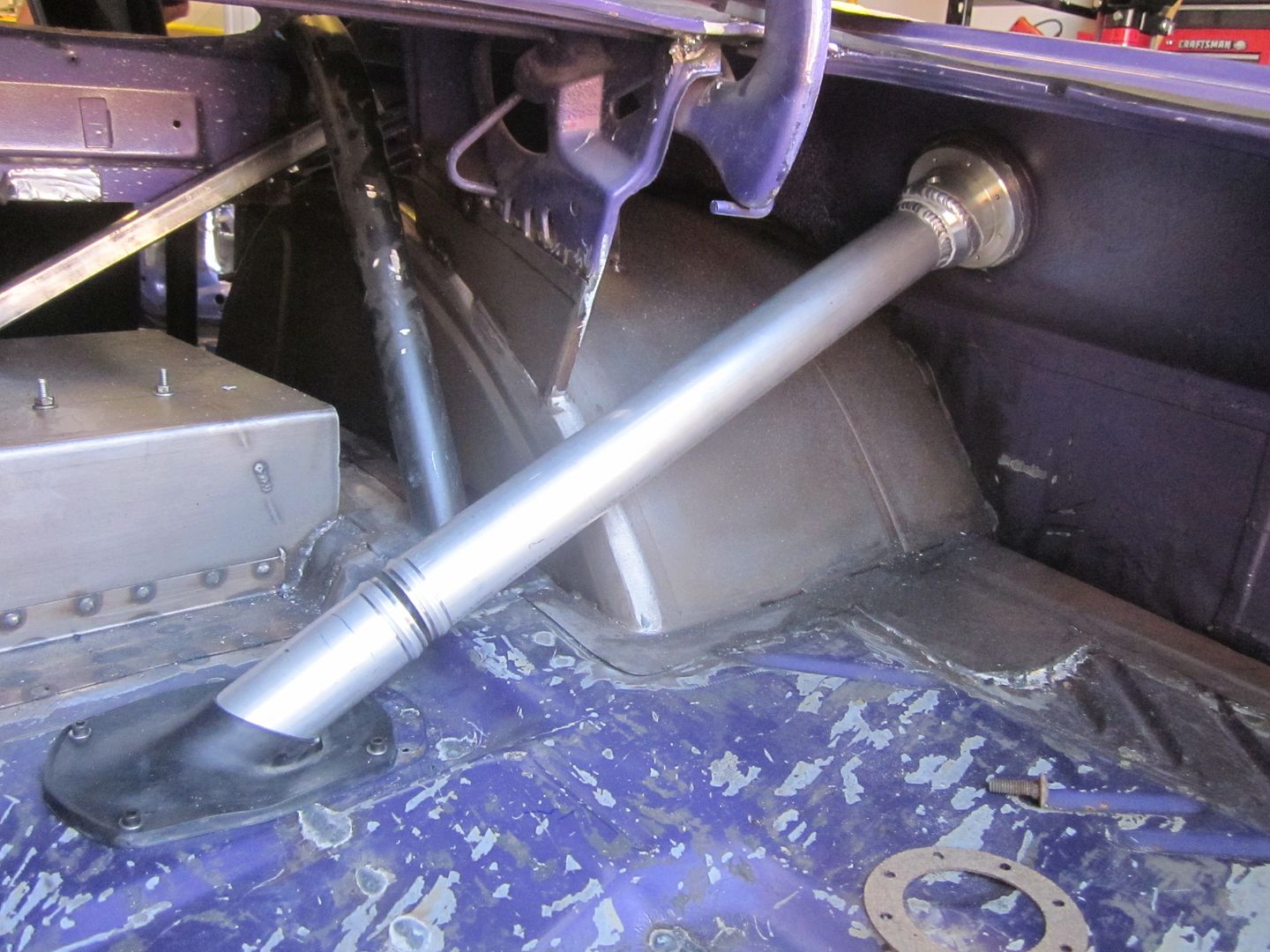

GrabberGT 07-29-2013 05:21 PM
Is that a fuel or rear diff cooler?
Cris@JCG 07-29-2013 05:30 PM

That is a diff cooler.. We left enough space to run the lines thru the tank & trunk..

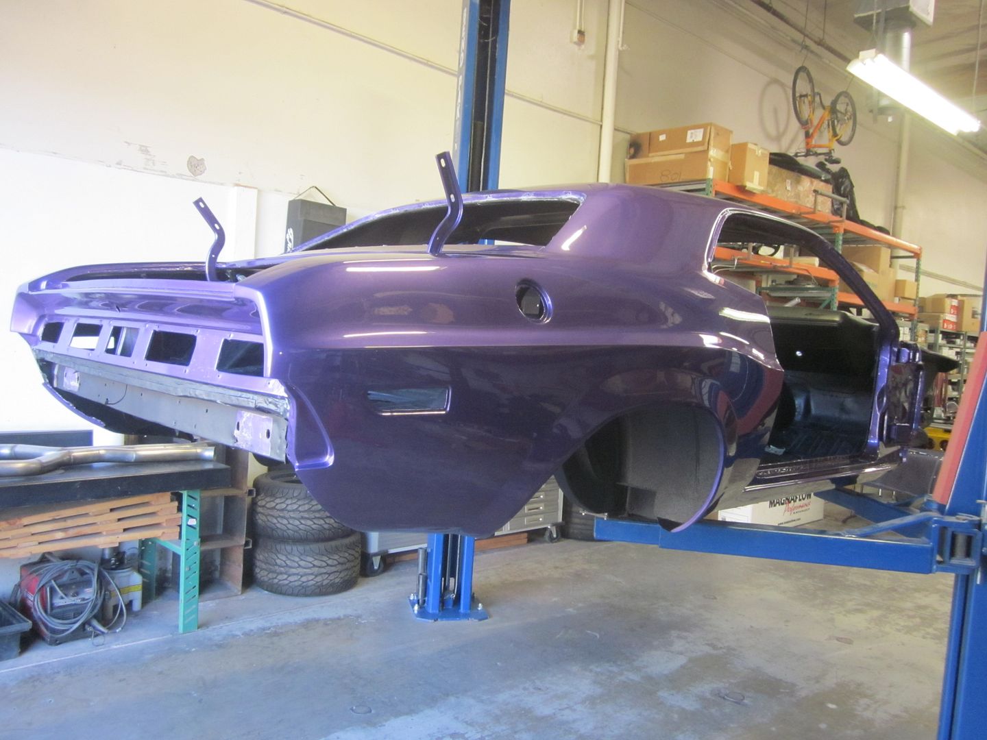

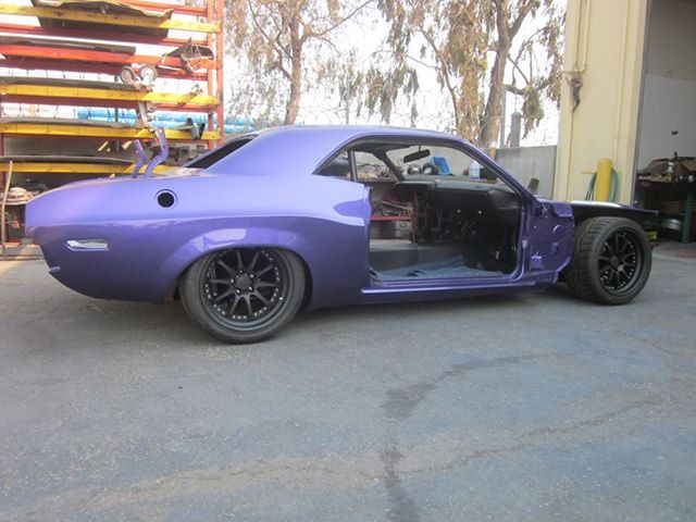

Finally got the car painted! Now the fun begins.. I am behind schedule on this build... So hoping to make up some time in the assembly.. Here are some shots of the quickie paint job..
:thankyou:
http://i1015.photobucket.com/albums/...ps8e6a893a.jpg
http://i1015.photobucket.com/albums/...psc7087d32.jpg

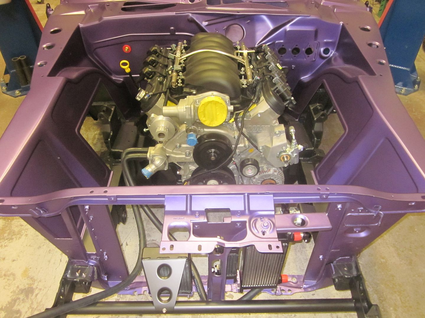

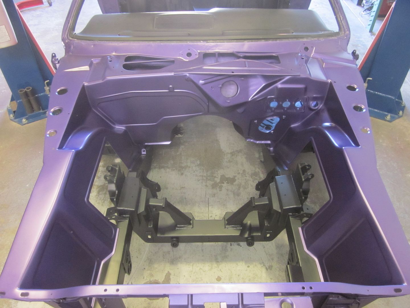

I like the matte finish of the engine bay. Good idea!
Cris@JCG 08-29-2013 07:13 PM

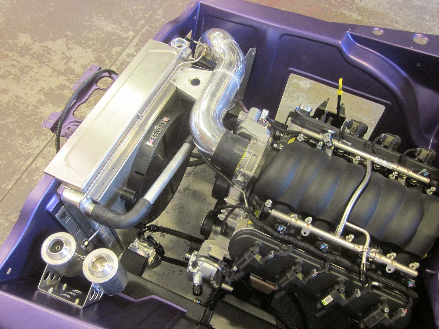

Thanks! Here is a pic of what it will look like with the engine.. Very simple!
http://i1015.photobucket.com/albums/...pse72f44a8.jpg

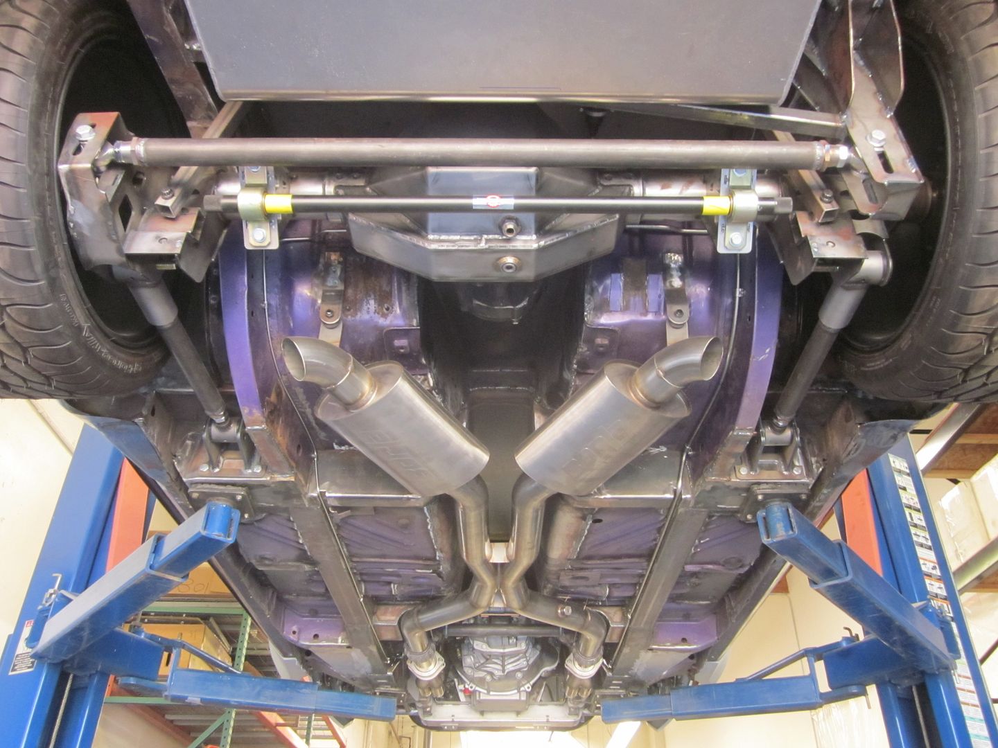

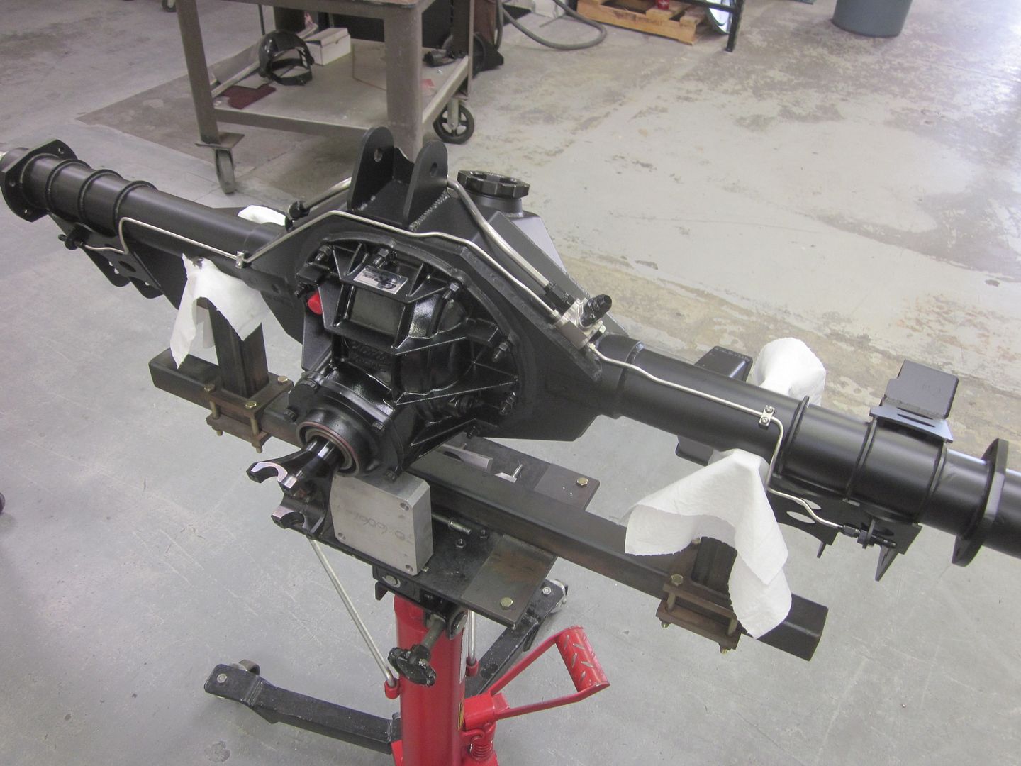

Plumbing complete & the C&R third member installed.. We got floating rear rotors for the rear Wilwood brakes but need to machine a few components..
http://i1015.photobucket.com/albums/...ps4ef29338.jpg

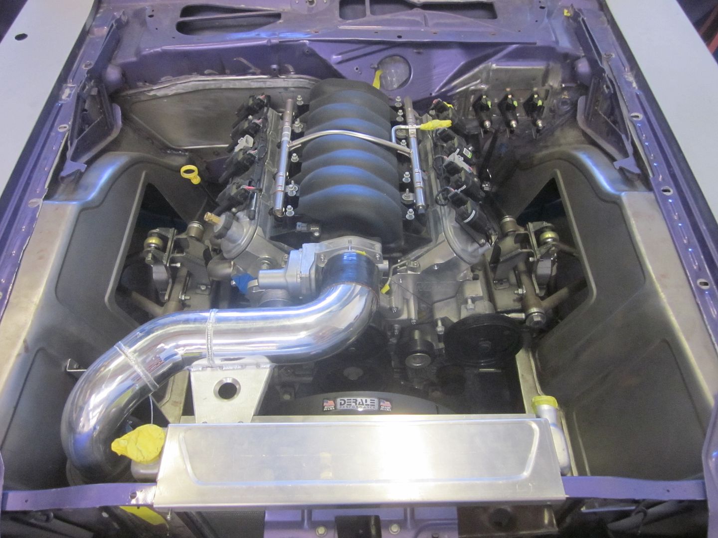

Thank you! here is a pic of the last few things we need in the engine bay.. Keeping this one very simple & clean.. & most important easy to service!

All parts are made by JCG.. we grafted a Camaro sub-frame that we designed for our shop builds.. The sub-frame connectors were something we whipped up just for this project but are easy to make..
This is a car we built to test our suspension.. Yesterday it hit the ground!

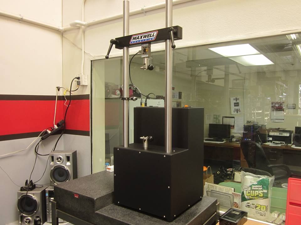

Today we just picked up our Maxwell Industries shock dyno.. to support our testing of this build.. We will be doing custom valving on the RideTech shocks.. Thanks to Brett for the full support on our in house shock program!
