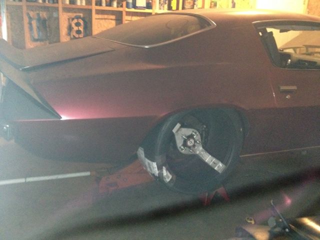

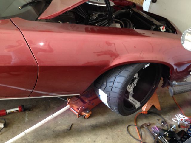

Thanks. I now feel your pain with the project...Mine was supposed to be a quick change out of a few parts... Wasn't your deadline for completion about now???

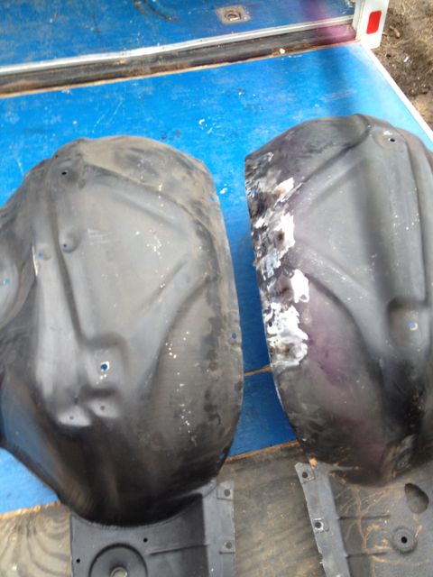

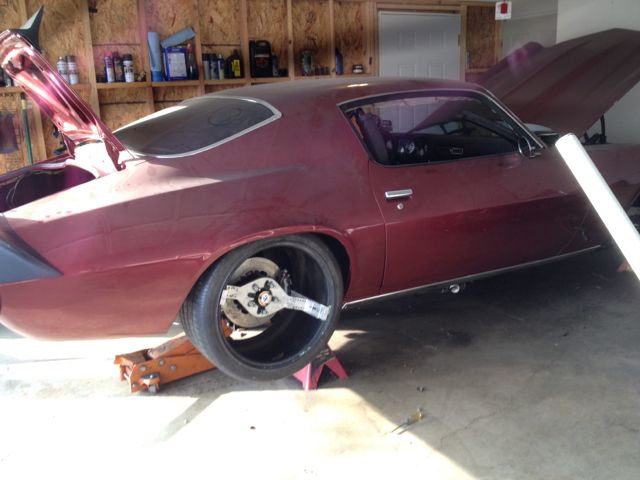

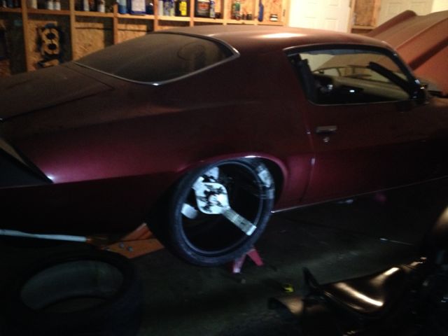

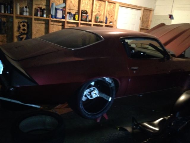

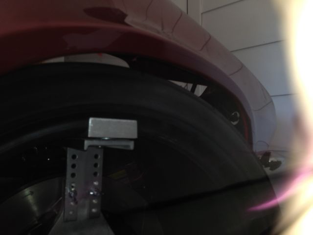

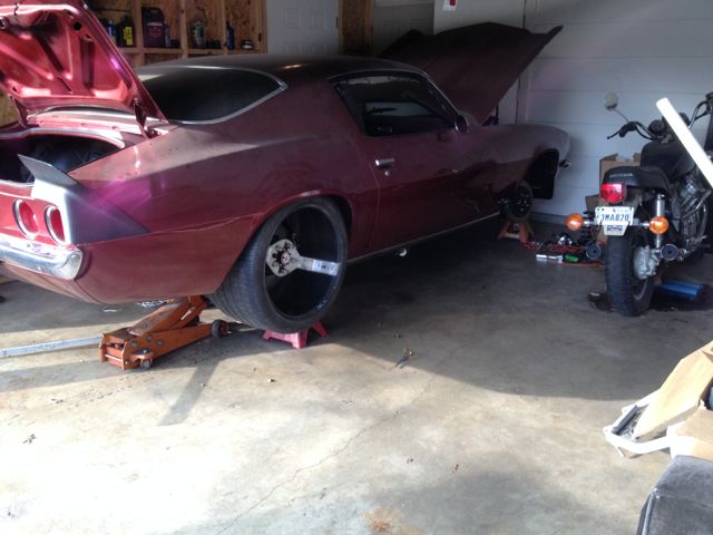

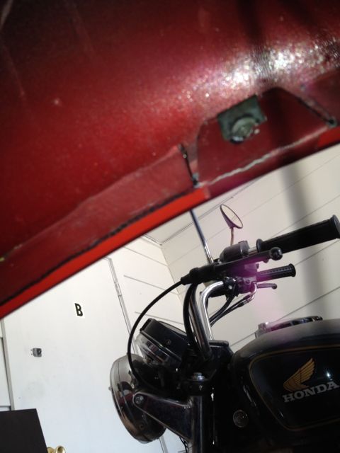

In my ever change tire size dilemma I have now pulled the front inner wheel wells and cut/rolled the fenders. I'll cut the inner fenders as needed to make them fit as well. Mocking things up I decided to try the 315 on an 11.5 setup. Based on previous ride height it doesn't seem too bad of a fit. Am I nuts to try this? Anyone know what the min steering angle I should aim maintain is so I can actually drive the car? It seems to turn pretty decent and has ~1" of suspension available at previous ride height. Is that even close to enough compression?
Am I getting greedy and stupid trying to fit this on the front?
Attachment 45520
Attachment 45513
Attachment 45514
Attachment 45515
Attachment 45516
Attachment 45517
Attachment 45518
Attachment 45519
Vince@Meanstreets 02-09-2014 02:25 PM
greedy nope....ambitious yes. throw a couple shims on your control arm too. Lets get more camber. If you have a digi angle finder put in a negative 1.2
Also if you do that mod, be careful of your bolt length. ask me how i know.
you'll find that the more backspace you use the more the tire will clear that rear part of the well.

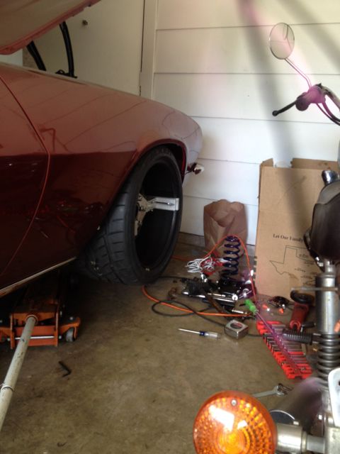

gerno 02-09-2014 03:40 PM
BS is limited where the tire tool is hitting the LCA and Sway bar when mocked using a 11.5" wheel. I'm not sure how a wheel compares to the tool. I could go to a 11" wheel and have no problems but I'm thinking it would be sub optimal and at that point a 295 may be better due to tire/wheel fitment. The 315 is a 12" tread so even a 11.5 is a little small. 295 may be perfect since it's 11" tread. Only think I don't like is the additional height using the 295
gerno 02-10-2014 07:36 PM
After talking to Travis a decision has finally been made. I'll be ordering wheels tomorrow. Going with a 295 front on a 10.5 rim with 7.25 BS. I measured based on the 275 and offset the tool to make up the difference. Using a 275 with a 10" width 6.5 BS is perfect. I've offset the BS to compensate for 1/2" wheel width plus an additional 1/4 for tire width/height front and rear. I think it's a safe measurement....
I lose ~1/4 steering wheel turn from the 275 so I think it's ok to drive on the street too. I'll find up shortly...:EmoteClueless:

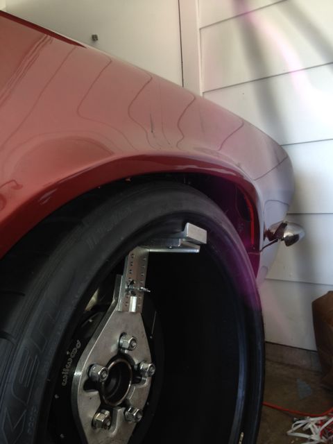

MX145 02-10-2014 08:27 PM
Steve. Glad to see you're getting it all dialed in. I'm looking forward to seeing the final result! :thumbsup:
Man I sure wish I had a wheel measuring tool like that when I did my mockup although I don't know if it would have helped my indecision. Figuring out the tire/wheel combo was more stressful than installing the mini tubs for me. I kept going back and forth on things and was worried I was getting to greedy too.

I debated buy it but could not imagine fitting the wheels without it. Completely worth the money.

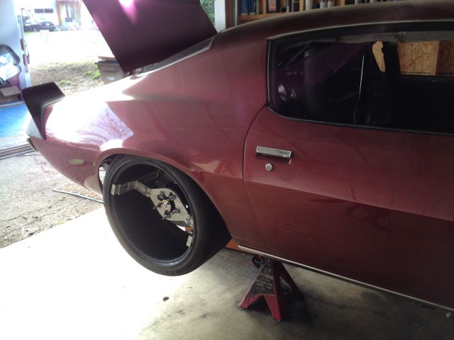

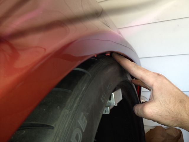

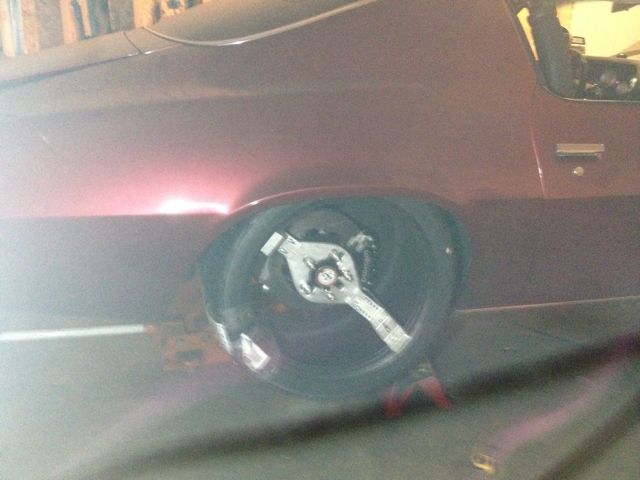

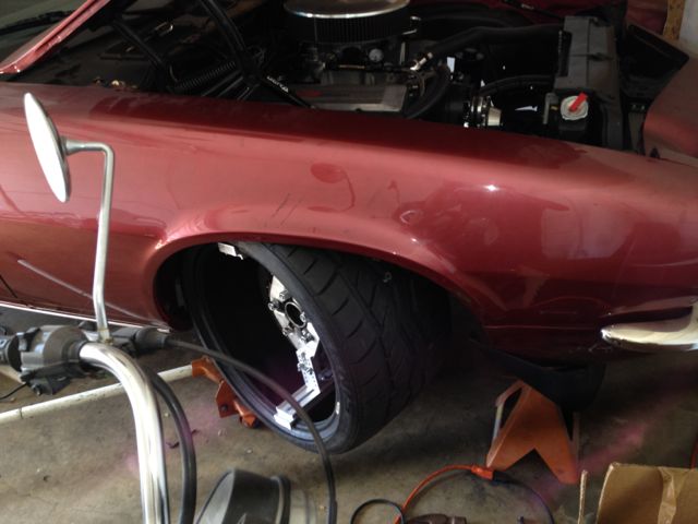

Finally decided on a 18/19 stagger setup. 18x10.5 (275-285/35/18 depending on tire) front and 19x12 (325/30/190 rear
Rear test with 325/30/19
Attachment 45881

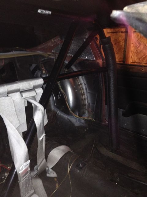

gerno 02-16-2014 07:26 PM
10 Attachment(s)

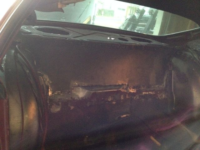

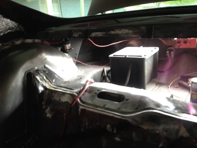

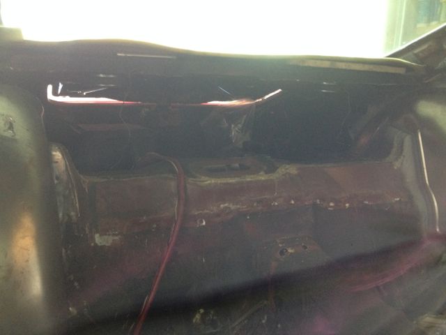

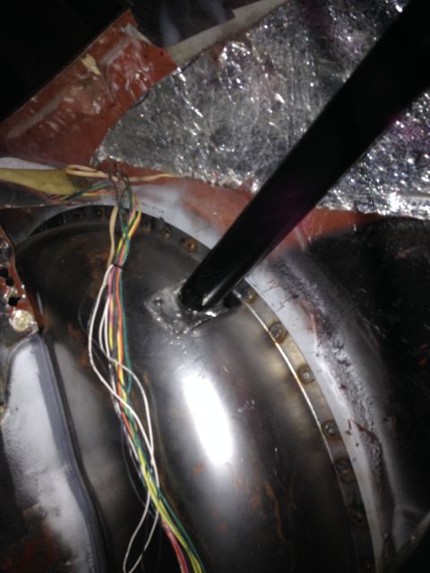

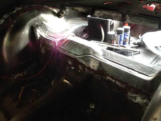

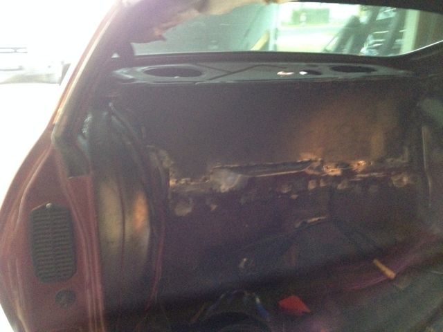

Got a few more things done this weekend

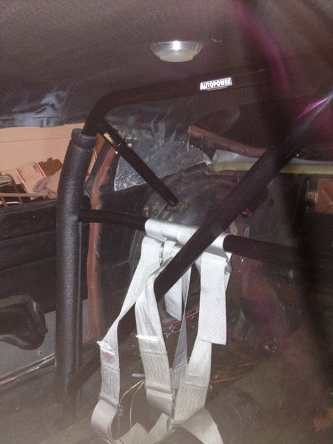

Fitted the bolt in roll bar to the new wider wheel tubs

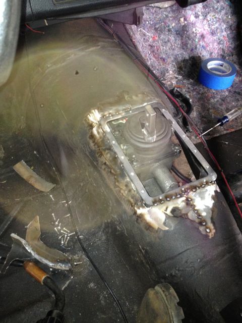

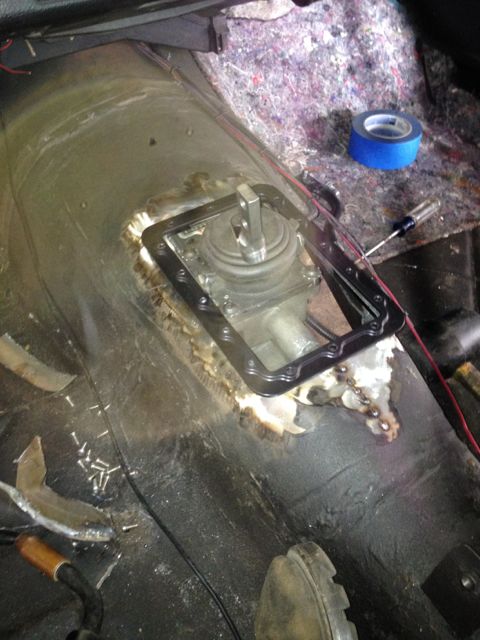

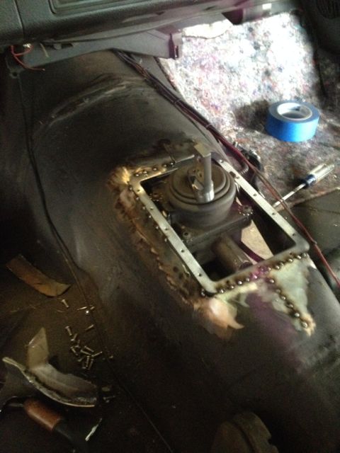

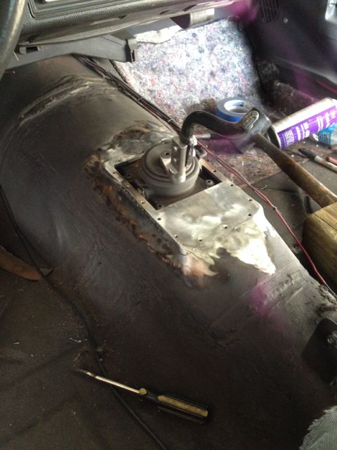

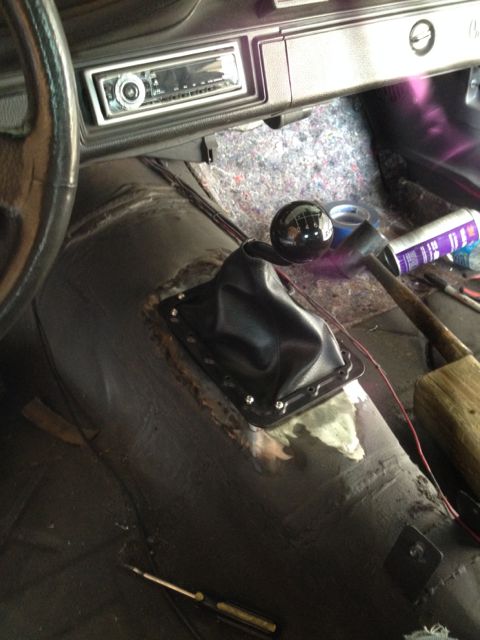

Installed Finch's new shifter boot. I assume it was meant to expose the entire shifter assembly but I spaced it back a bit to fit better.
Attachment 45891
Attachment 45892
Attachment 45893

glassman 02-16-2014 09:07 PM
Shifter looks just right. Did you install that LS already on the down low?????
295 up front? daaammmm....thats a lot of traction....btw, those tires in the back look huge.....

No LS swap yet. Going to get it driving with the current engine and then work the swap in a month or two....at least that's the current plan.
No longer going 295 on the front. Decided the wheel would be too narrow to allow the 295 to work right. Decided a 275-285 on a 10.5 rim would be better. This way I could take Ron's advise and stretch the tread a little.

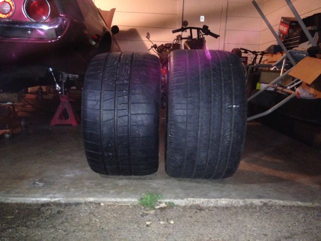

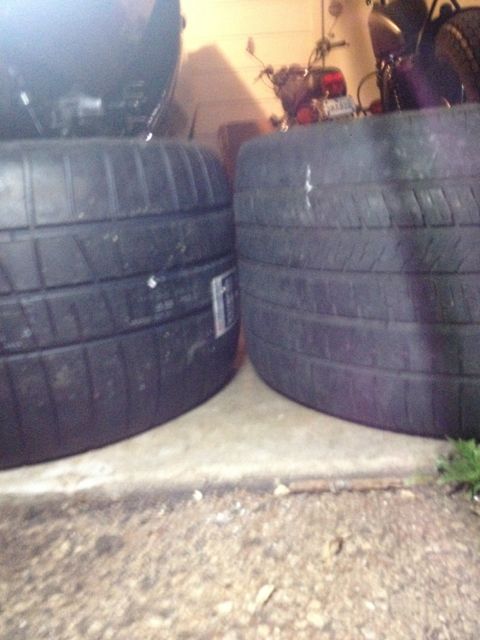

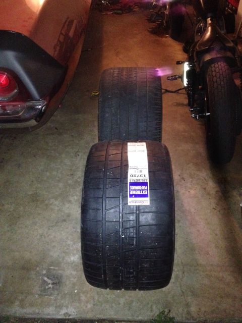

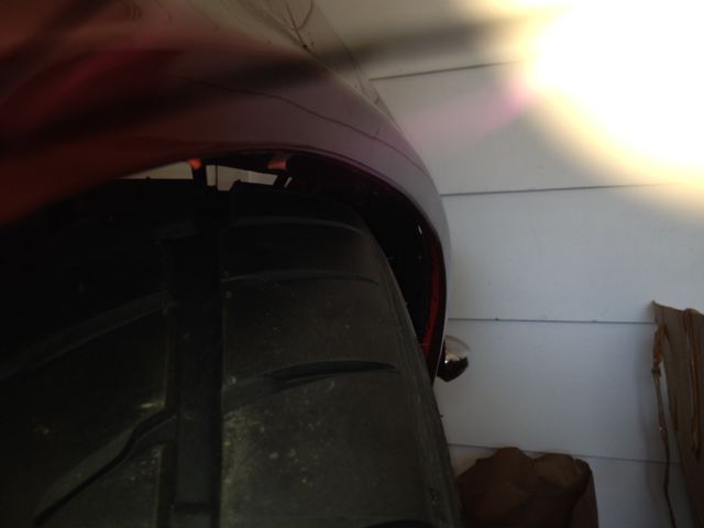

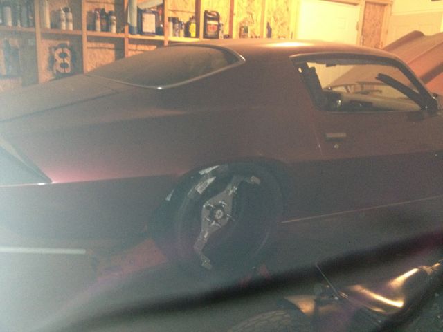

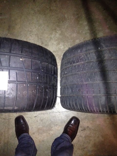

:waveflag: I'm going nuts again on my wheel/tire selection. I had some 335/30/18 rivals on hold due to potential backorder. Apparently these tires shipped because they were at my door this morning. Given I had the tires I decided to test out the fitment. Now I'm really confused again. I still have time to change my wheel order and think I may go with the 335 since it's only slightly widens and much shorter than the 325.
325
Pro - slightly narrower but not much
Con - increased height interferes with Qtr flare
335
Pro - shorter height fits flare and lip
Con -Just wide enough to barely fit. Overall ~3/8-1/2 max inside and out. Possible rubbing issues
Tire selection - Overall I feel its pretty equal if not better for the 325.
325 - mainly Michelin, Goodyear, Bridgestone and Hoosier
335 - mainly BFG, Hoosier, Michelin, Toyo (R888)

Vince@Meanstreets 02-20-2014 10:07 PM
Get the cut off wheel out.....:bur2:

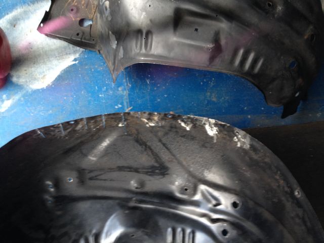

I have the front inner fenders reshaped to clear the wheels but I have to say it's not the best work. Good thing is that it can't be seen. Bad part is, when I get back to having a full shop I will need to redo the work. I now have A LOT of respect for the work people post on this forum.

Decided on the 275/35/18 with 325/30/19 in the Bridgestone RE11. I just hope all my measurements were correct....

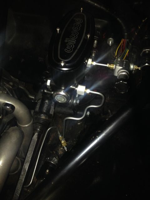

I have done a few more things to the car. After looking at the cars at the USCA event I decided the rear seat needed to go. I pulled the factory rear panel out and installed a a flat sheet. I need to decide what to do with the factory floor seam. Most likely I'll cut this out too but wanted to test with it in place first.
Attachment 46893
Attachment 46894
Attachment 46895
Attachment 46896
Attachment 46897
Attachment 46898

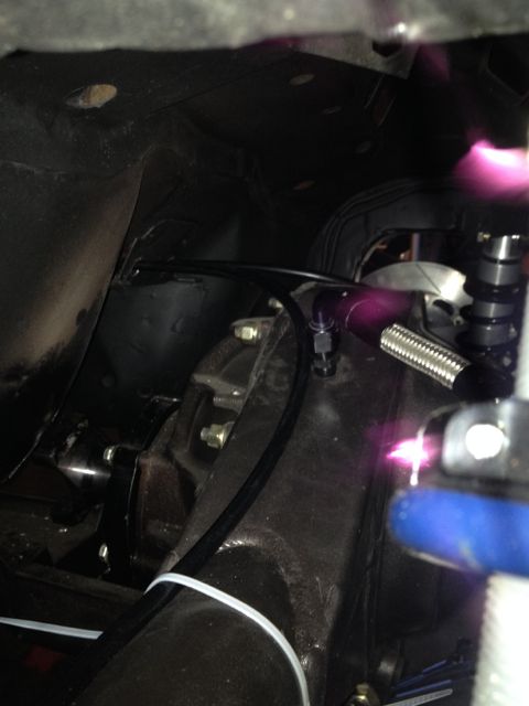

I also plumbed all the brake lines and routed the parking brake cables.

The biggest issue was the front inner fenders. They aren't pretty but they now clear the wheels...at least I hope they do. I'll find out tonight.
Attachment 46901
Attachment 46902
