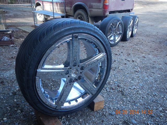

temporary rollers
2 Attachment(s)
found these in town for cheap.
it's a square setup of used 18x8 momo gtr with 235/40 rubber.
Attachment 47763
the plan is to use these only temporarily until i can get measurements at final ride height for the custom wheel/tire package.

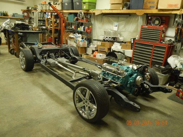

1968 GTO Resto-Mod 05-01-2014 10:44 PM
2 Attachment(s)
Attachment 47896
Attachment 48723

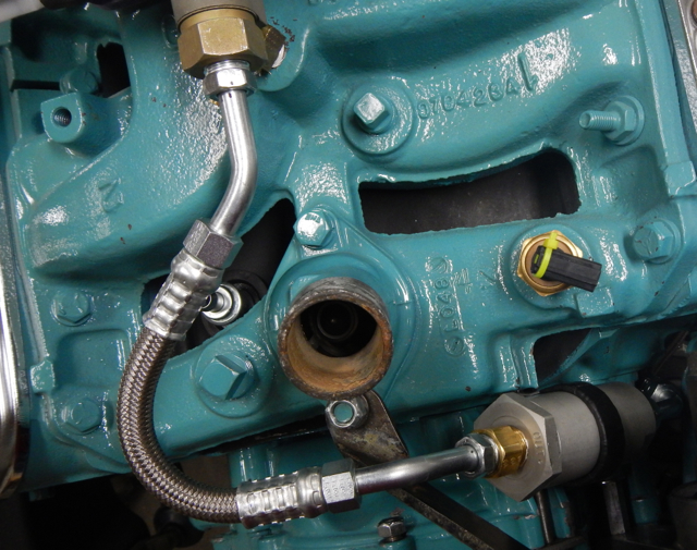

as far as recent progress is concerned, i do have a few pieces of good news to report...

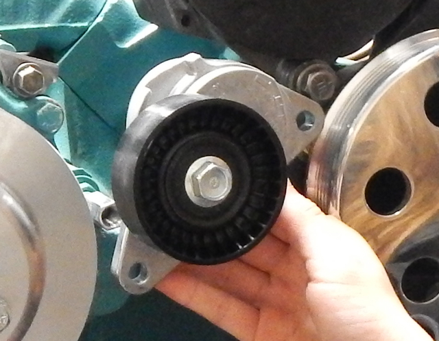

i believe i've solved the tensioner pulley puzzle.
after countless hours of sorting through pulleys at parts stores and salvage yards, i finally found a general motors manufactured tensioner pulley that might work for the serpentine accessory drive.
Attachment 51324
at 4.00" the dimension between the two mounting holes in the tensioner is exactly the same as the dimension between the threaded stud on the timing cover and the lower alternator mount!

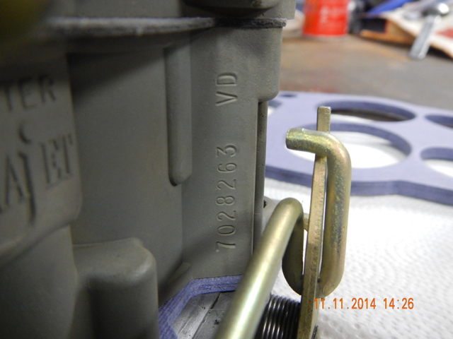

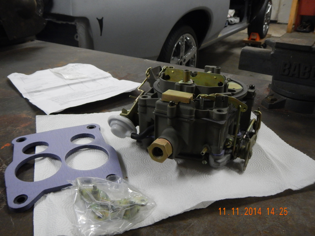

also, after months of screening ebay and other online sources i finally found a spread bore, four barrel, rochester quadrajet carburetor for 1968 pontiac manual transmission application.
Attachment 51325
huge credit to cliff ruggles and his team at cliff's high performance for their effort in remanufacturing and refinishing this quadrajet.
many sources claim no one has more skill and knowledge with the rochester quadrajet than cliff ruggles, so i am very fortunate i was able to coordinate with him on this project.
Attachment 51326
702 => 1960's
8 => 1968
2 => quadrajet (4 bbl) federal standards
6 => pontiac
3 => manual transmission
thanks again for your interest in this project.

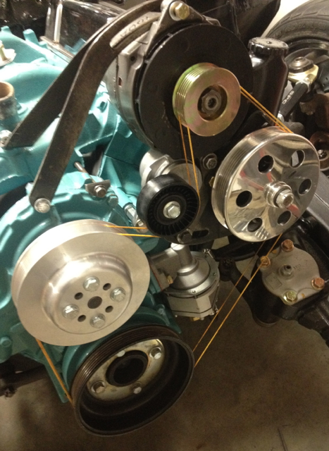

1968 GTO Resto-Mod 12-15-2014 06:11 PM

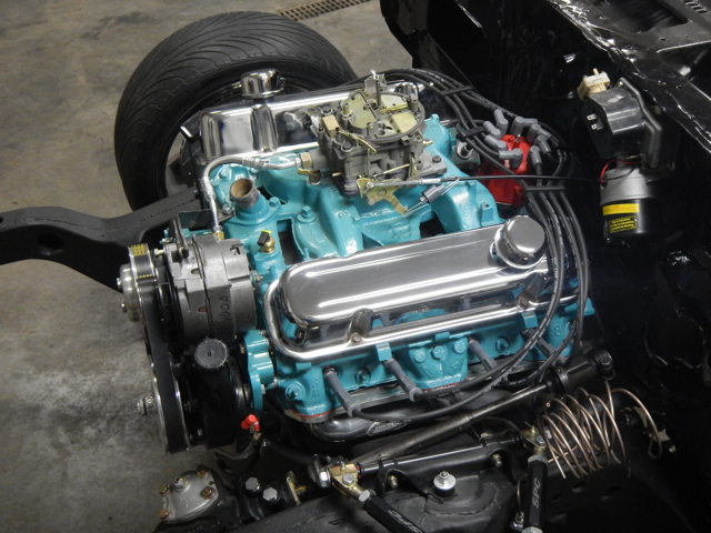

serpentine conversion
7 Attachment(s)

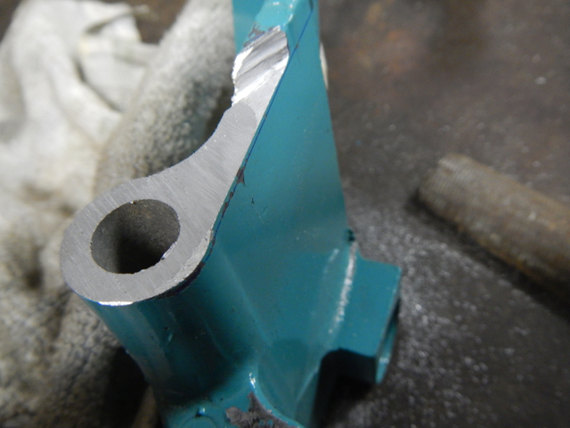

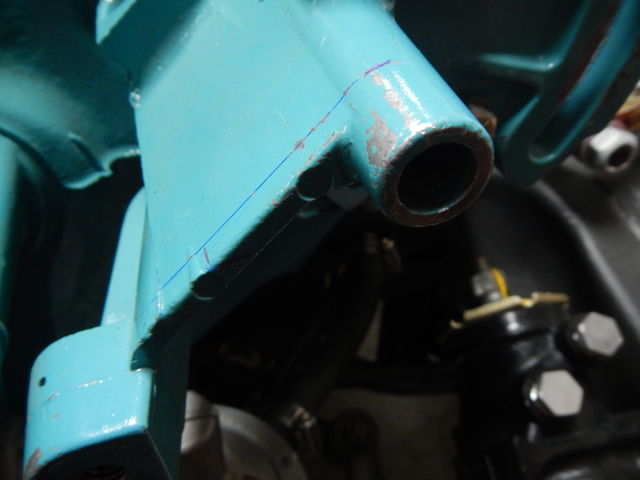

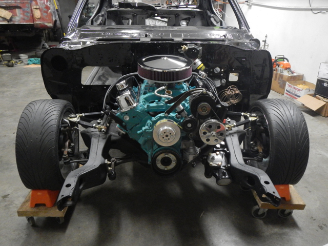

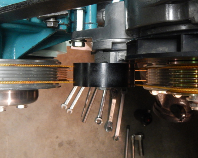

recently made some progress getting the serpentine accessory drive assembled.
Attachment 51832 Attachment 51833

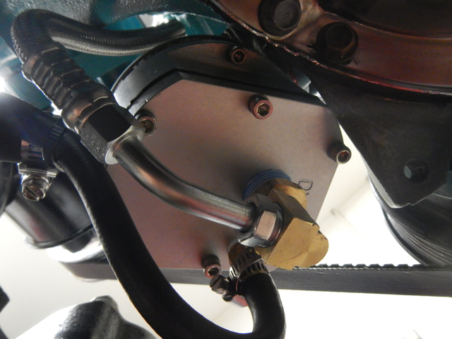

the tensioner was pulled off a shelf at my local NAPA parts store.

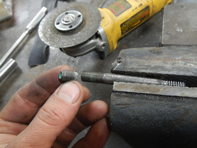

getting everything to line up properly didn't happen without a little cutting and grinding.
the threaded stud at timing cover was shortened 0.75" then a 1.00" long coupling nut threaded onto it allowed thru-bolt for the lower mounting point of tensioner.
Attachment 51830

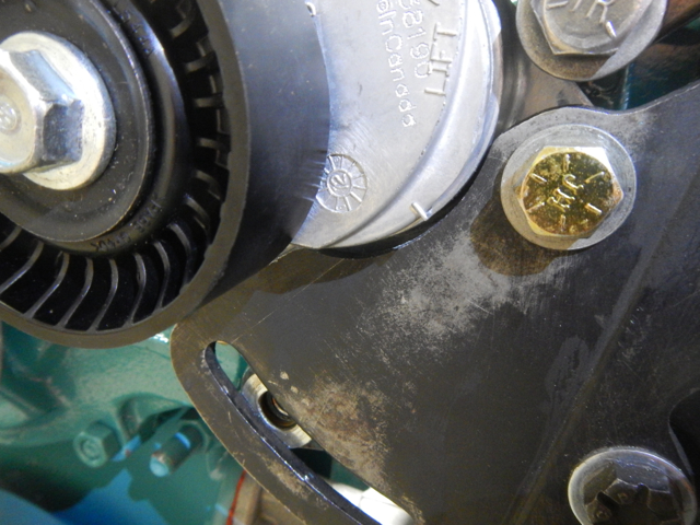

upper mounting point of tensioner at upper power steering bracket thru-bolt.
at this location i had to push the tensioner back into the alternator bracket to line up with the other pulleys.
Attachment 51827
Attachment 51828

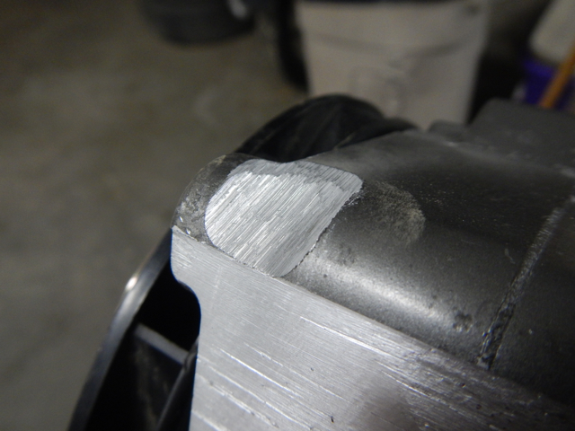

underside of lower alternator mount needed to be slotted to align mounting points.
Attachment 51829
power steering bracket was shaved to fit tensioner housing.
Attachment 51831
thanks for your interest!
danny
:lateral:

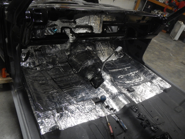

1968 GTO Resto-Mod 12-22-2014 04:58 PM

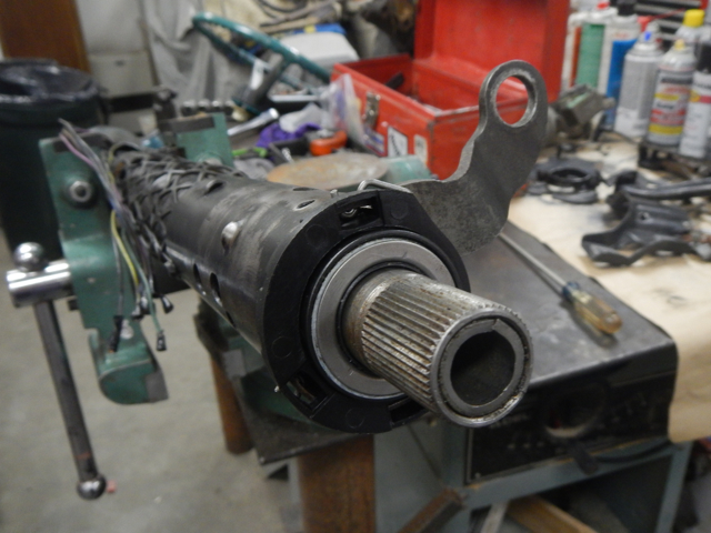

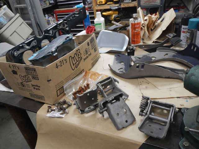

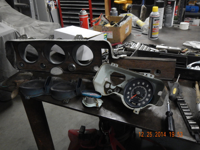

5 Attachment(s)

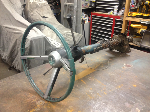

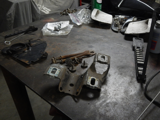

it seems like i can spiff-up the steering column with replacement bearings, bushings, etc. from inline tube and ames.
i'll just remove the column shift handle, clean it all up, replace worn or un-useable equipment as necessary, paint it and re-install.
and yes, as you can tell from the original paint on the steering column, the stock interior color of this vehicle was turquoise. someone painted black over it before my parents got the car.
Attachment 51993

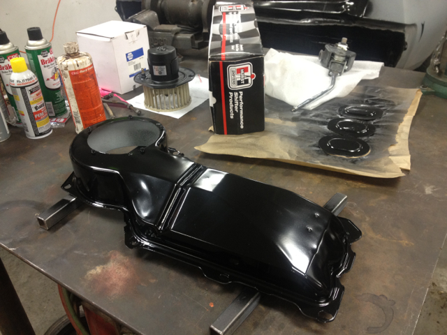

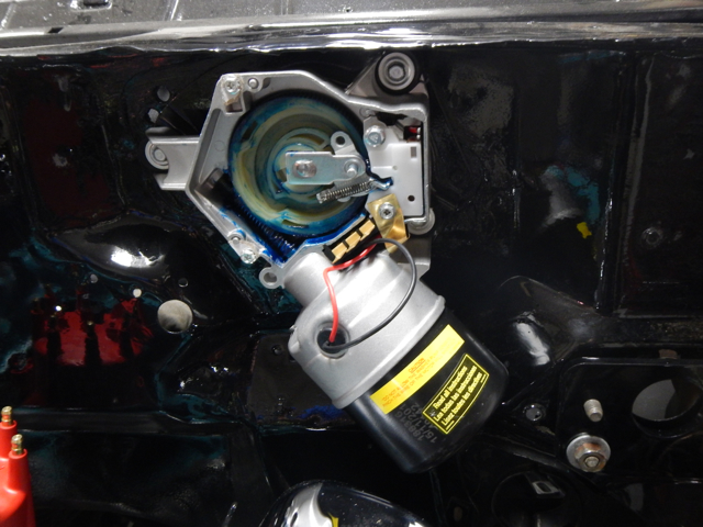

the blower motor box cleaned up pretty nice and i found a replacement blower motor in town.
the heater box which mounts to the inside of the firewall will need to be replaced because at some point my father modified it to install a larger heater core.
Attachment 51990
i knew i was going to have to cut a hole in the floor at some point... and the other day i finally got down to figuring it out.
also, i got all the shifting rods and the speedo cable installed with no major headaches.
from here i plan to order a shifter porch, console mounting bracket kit and console kit from ames/inline tube/opgi/etc.
Attachment 51991

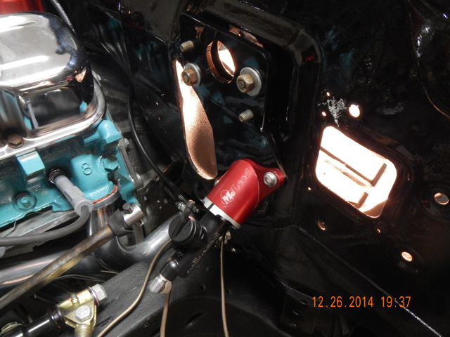

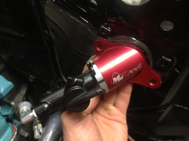

thankfully the firewall was equipped for stock clutch linkage so i plan to mount the mcleod/wilwood clutch master cylinder at this location.

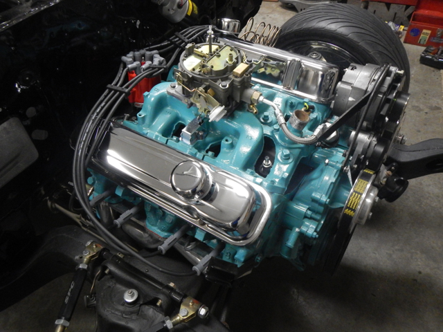

Attachment 51992

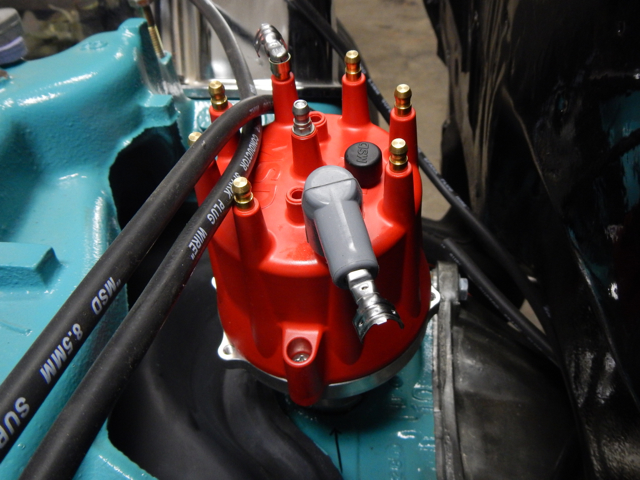

i also recently began installation of the msd pro billet distributor and the rest of the ignition system.
Attachment 52002
i placed an order last week for ron davis dual electric fan radiator, master grounding kit, wiring harnesses and some other bits and pieces.
i will update again as progress continues.

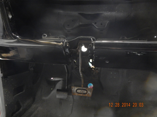

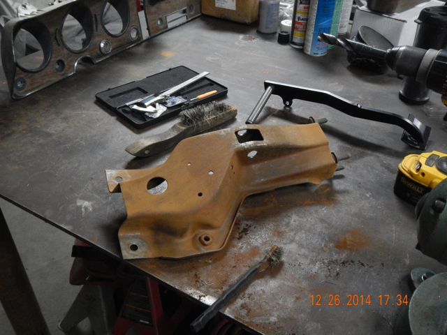

1968 GTO Resto-Mod 12-29-2014 09:28 PM
6 Attachment(s)
here are some photos of what i've been busy with lately.
starting to get a better idea of what it will take to get the clutch master cylinder in place.
with the arrangement shown in the photograph the rod lines up with the pivot on the pedal very well, but i needed to cut a hole in the firewall to make it work.
Attachment 52129

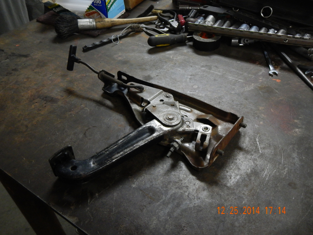

got the pedals hanging for a look at what i need to do there.
of course the brake pedal is for automatic transmission application.
i would like to use a replacement from manual transmission application, so i'm looking around online for one.
Attachment 52130

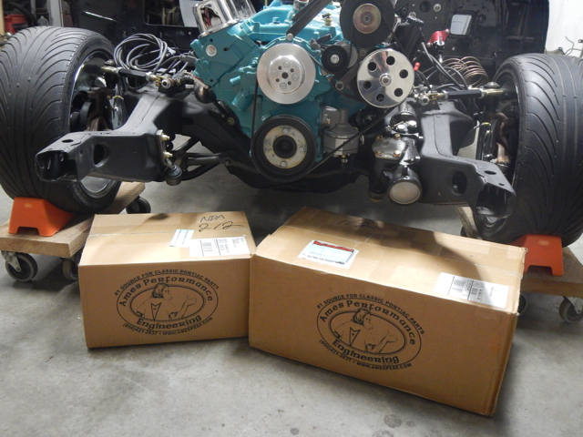

also recently placed an order with ames for many things i know i need right now to move forward... except wiring harnesses.

i recently received a delivery of parts from ames so i'm hoping for a good bit of progress in the near future.
Attachment 52398

WSSix 01-16-2015 05:57 PM
Looking good, Danny. That serpentine setup is nice. Good luck moving forward!
1968 GTO Resto-Mod 01-22-2015 09:09 AM
6 Attachment(s)
Originally Posted by Justin@EntropyRad (Post 589880)
Homegrown builds and everyone else's skills make me jealous:king:
Originally Posted by jarhead (Post 590097)
such a clean build, just awesome!
Originally Posted by tones2SS (Post 590133)
Looking good.
Keep the updates coming.
:thankyou: :thankyou: :thankyou: :thankyou:
Attachment 52518
Attachment 52519
Attachment 52523
Attachment 52520
Attachment 52521
Attachment 52522

various bits and pieces starting to come together... and still doing a lot of detailing on original parts which have been bagged up since disassembly.
last night i worked on running the spark plug wires up to the distributor.
Attachment 52552
Attachment 52553
still wondering where to put the ignition box.
it absolutely needs to be kept dry at all times...(that's a no brainer, eh?)
...and separated from the blaster coil as much as possible?
any suggestions here?
can it be safely mounted on the firewall above the heater box?
also been rethinking my plan to install hydratech hydroboost for the brakes.
i have read stories in some threads where people claim to be satisfied with manual brake set-up when properly adjusted.
it seems to be a matter of using a master cylinder with appropriate bore diameter and mounting the clevis on the brake pedal to achieve favorable pedal ratio.
baer is selling a very nice looking billet aluminum master cylinder which can be installed with optional bolt-on proportioning valve.
according to baer tech support it is adaptable to hydratech hydroboost but i would likely need a different diameter master cylinder bore if i wanted to switch it up later on down the line.
do any of you guys care to share your thoughts on this one... manual or hydroboost?
are there considerations to be taken into account that i'm not yet aware of?

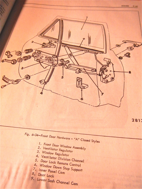

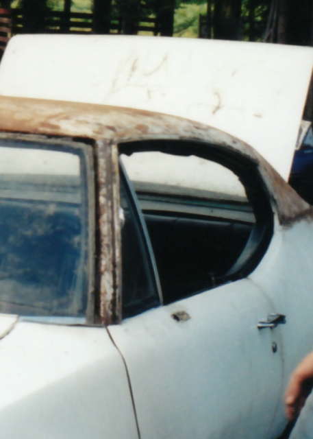

and here is another issue i've been struggling to come to a decision on:

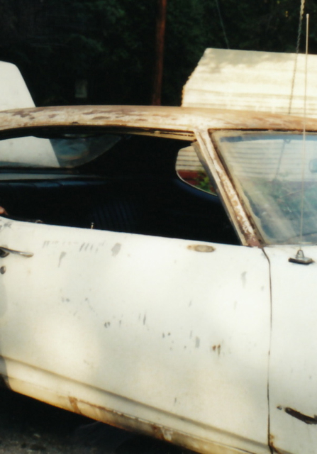

before my parents got the car the passenger side door was replaced with one from a 1969 car.
on the driver's side door i have a wing window and on the passenger side i do not.
Attachment 52550 Attachment 52551
also, the 1969 door has a different interior door panel.
i have been able to locate replacement 1968 doors but getting one to alaska may be quite expensive and it's difficult to verify the condition of the parts.
some guys want to sell a door for $850 but won't even email a photo!
i really want the car to look right but i'm not sure how much i should be willing to lay down for this type of thing...
also really, really need to resolve this one before going to paint, right?
any opinions are welcomed and appreciated.
thanks in advance for your input!
danny

tones2SS 01-23-2015 04:55 PM
She's coming along Danny.
Engine is looking good. Keep'em coming.

Roger Poirier 01-31-2015 11:51 AM
Yes, a good spot to put the MSD box is above the heater box on the firewall. Some people also install them on the wheel well.
You should PM andrewB70 about the Hydro-booster. From my perspective I love it. Street driven - it really helps deal with the low RPM's vacuum issues.
Andrew is a knowledgeable person on all mechanical issues. He should be able to steer you in the right direction.
Keep up the good work. :hello: Who are you checking in on a for replacement door? I don't remember my sources off hand, but can look them up if needed.

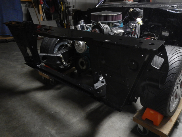

1968 GTO Resto-Mod 01-31-2015 09:18 PM
5 Attachment(s)
Attachment 52650
Attachment 52651
Attachment 52652
Attachment 52653

thank you roger!
the MSD box will probably go in the engine compartment above the heater box as you describe, or possibly on the inside of the firewall behind the glove compartment...
still thinking on it... and looking at a lot of pictures... and reading thread stories...
i am planning to order the hydratech hydroboost unit and the baer master cylinder monday morning.
i have more questions to get answered but based on what i've already been told it seems like that combo would stand a decent chance of working...
will also touch base with andrew to see what he thinks... thanks for the tips.
about the door, ahhh... i've talked to people at butler classics in wisconsin, frank's pontiac parts in california, and i've also searched dale's restoration parts and keep my eye on billions and trillions website too.
swapping the glass is also an idea, eh?
and i'm not particularly attached to the wing window in the 1968 door.
mainly, i just feel like both sides of the car should have the same glass.
here is the drawing of glass hardware for the 1968 door:
Attachment 52649
roger, do you have the 'body by fisher' service manual for 1969 model year?
it would be so helpful to me if i had the picture of glass hardware for the 1969 door.
let me know please.
there must be a way for me to get the glass right without having to get a whole new door...
