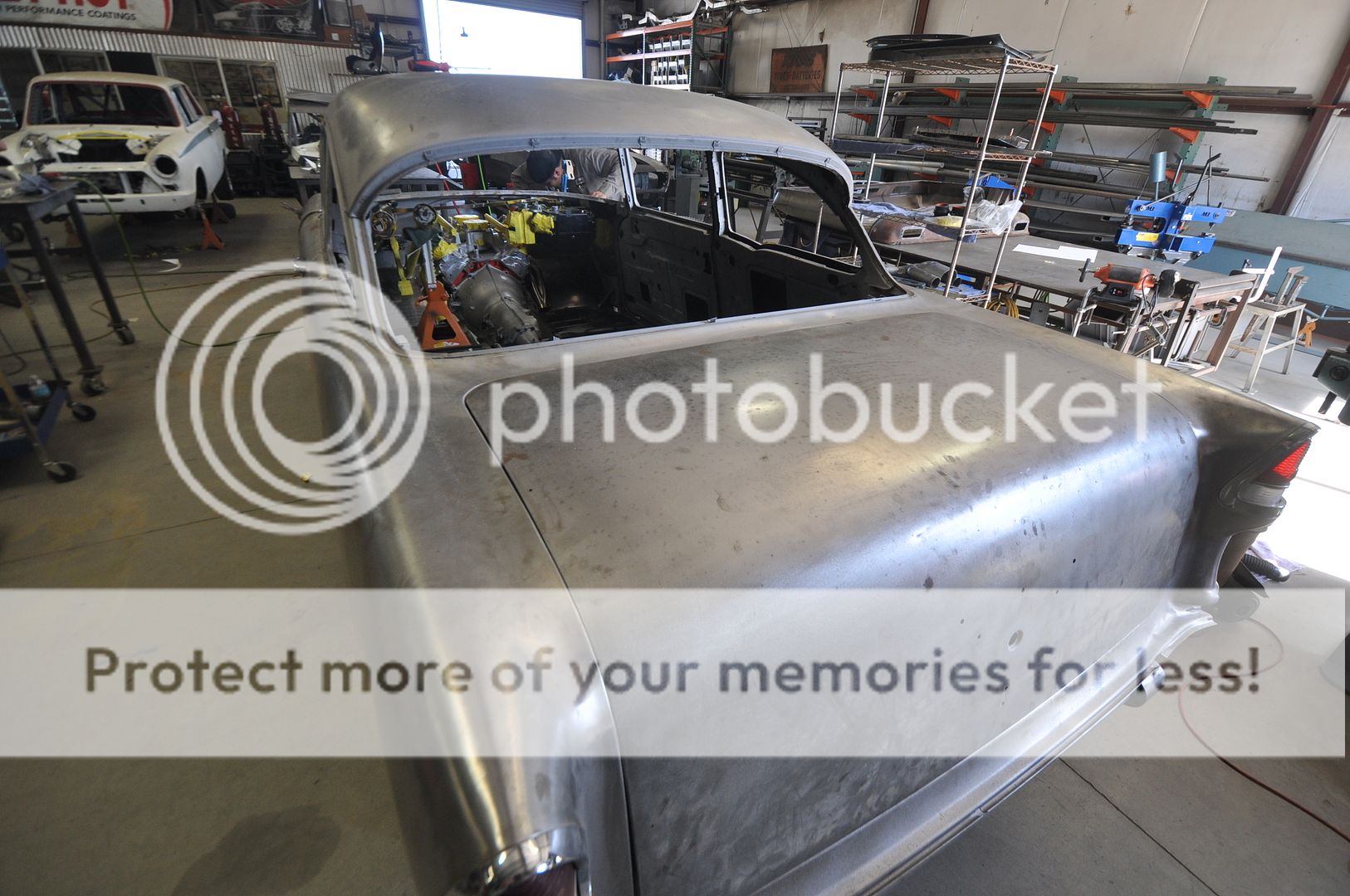

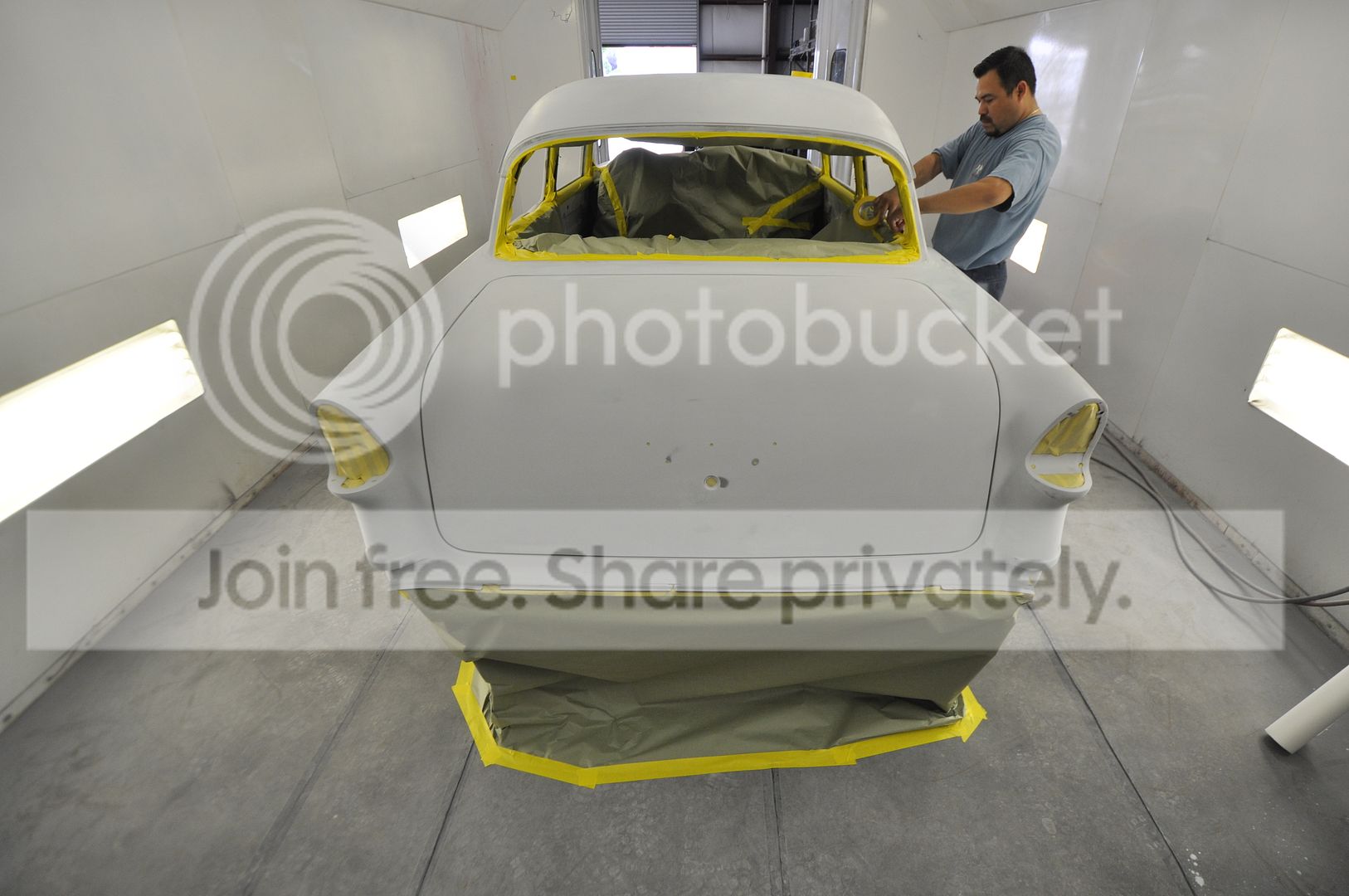

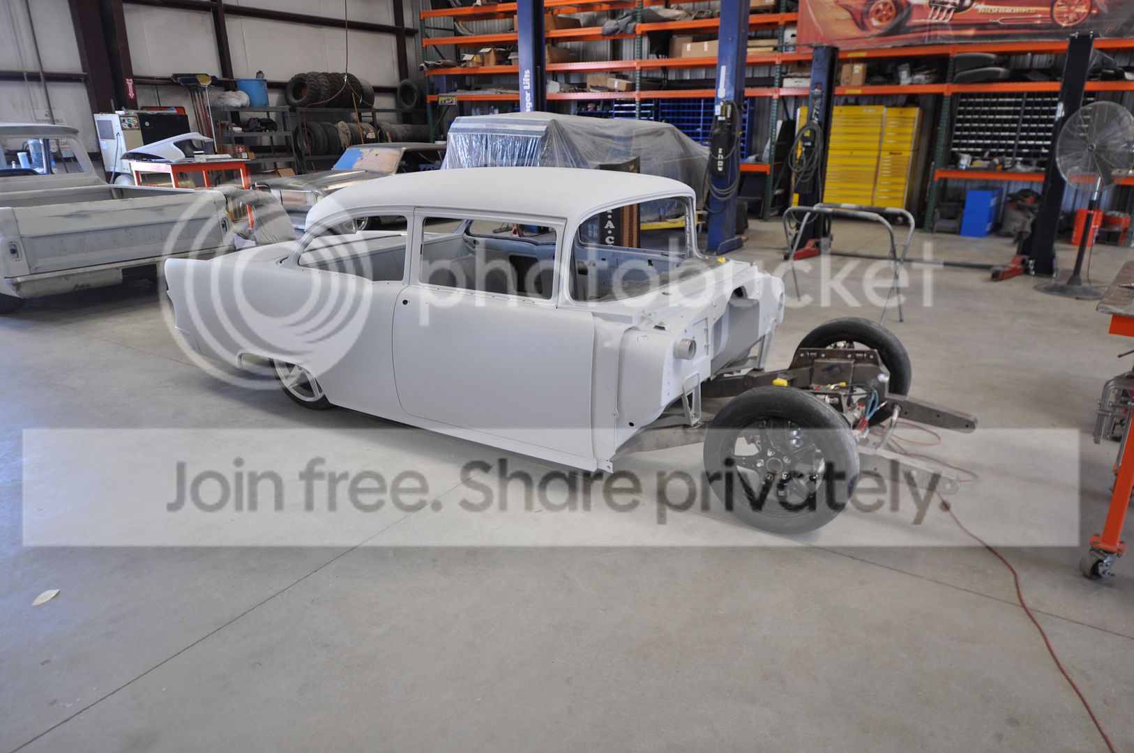

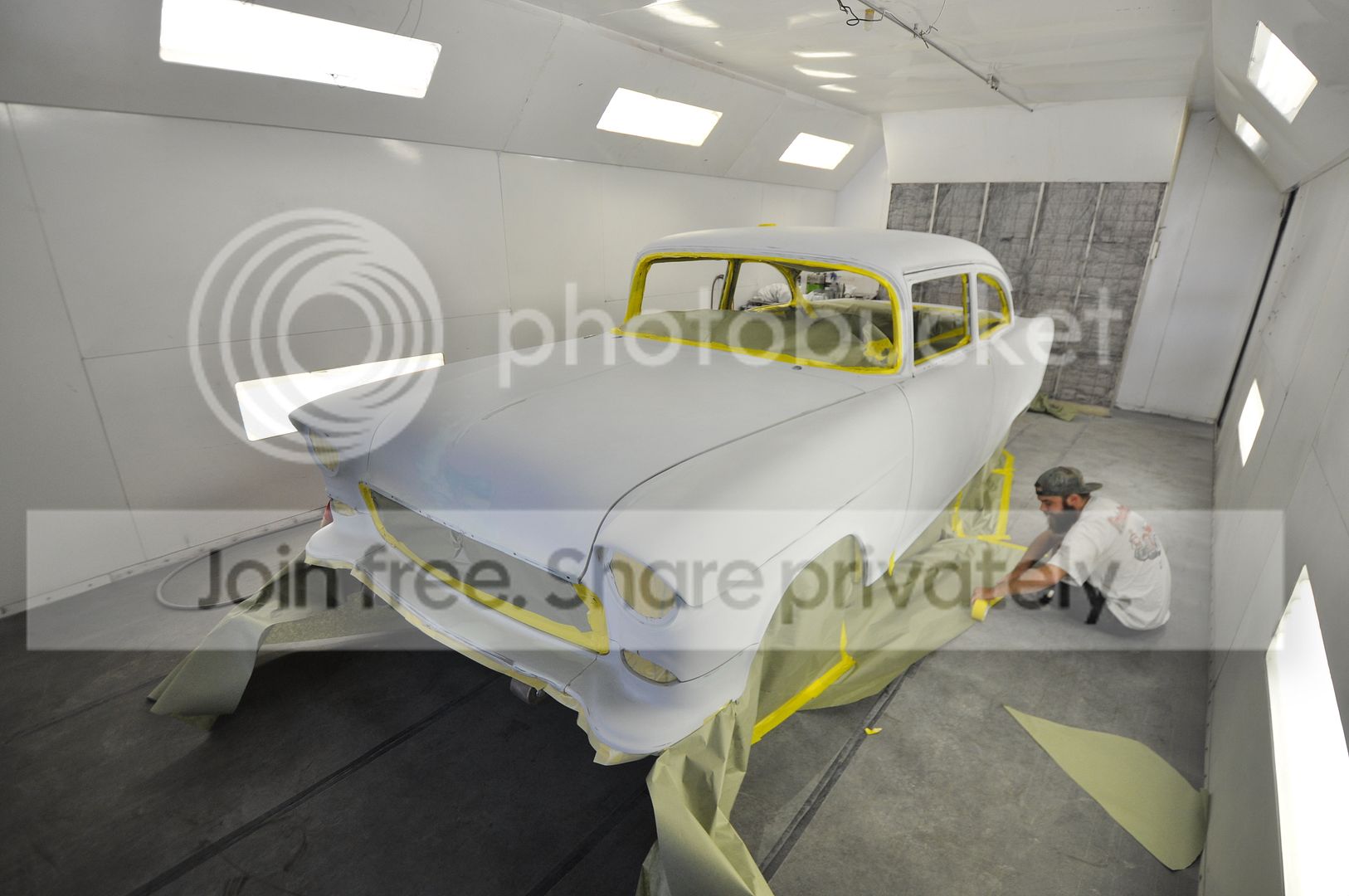

ironworks 06-04-2015 04:37 PM
1st coat of primer.
http://i616.photobucket.com/albums/t...2015%20004.jpg

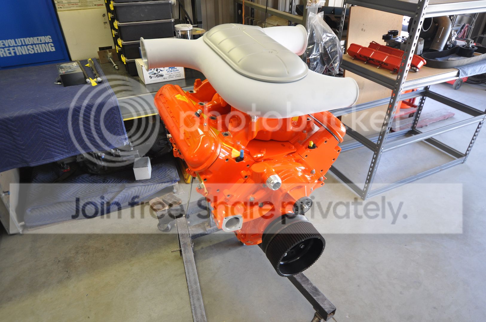

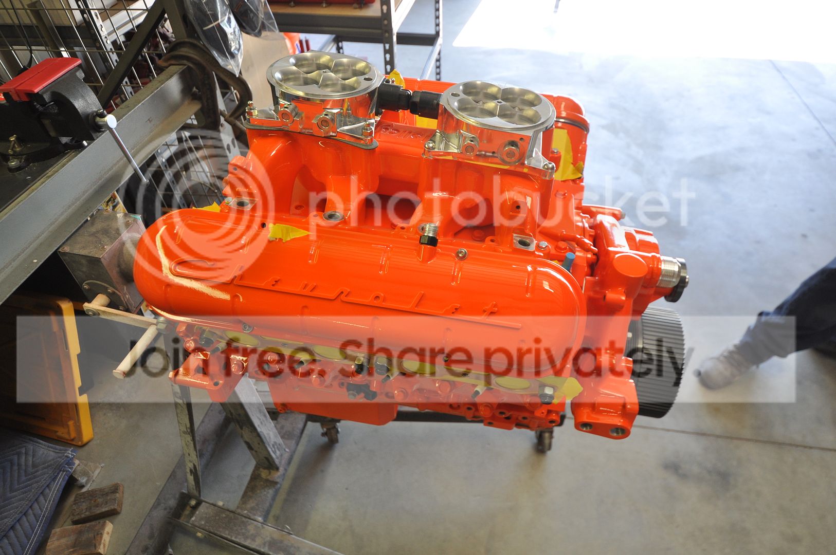

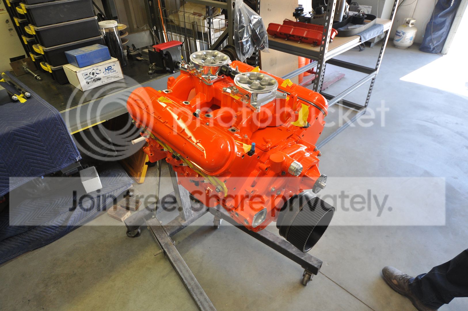

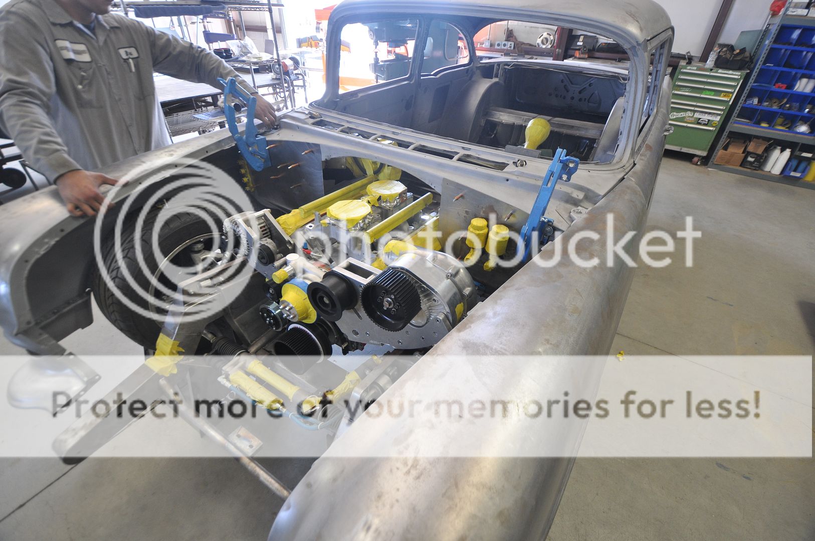

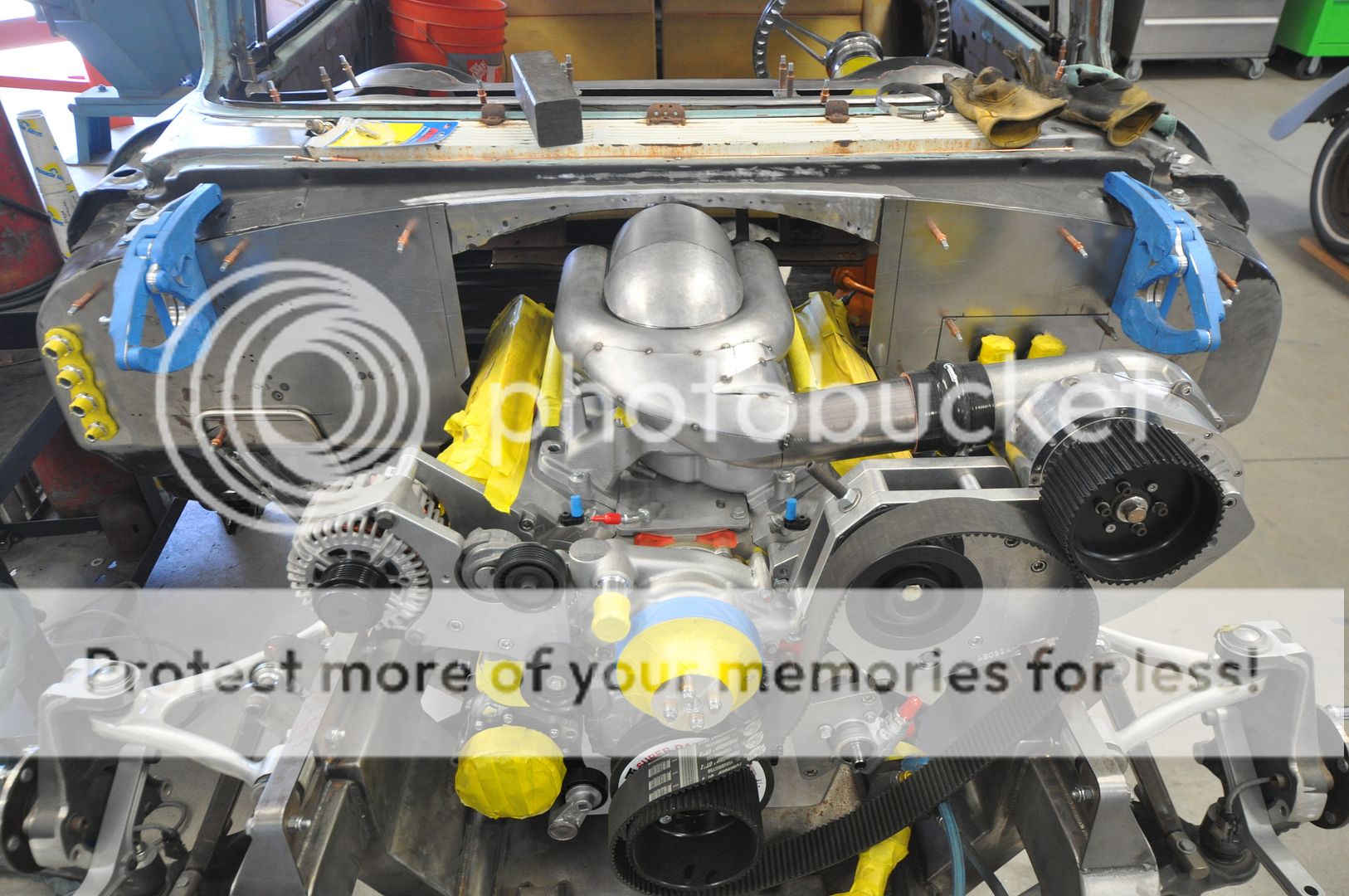

ironworks 06-08-2015 06:55 AM
Some engine progress.
http://i616.photobucket.com/albums/t...2015%20002.jpg
http://i616.photobucket.com/albums/t...2015%20003.jpg
http://i616.photobucket.com/albums/t...2015%20007.jpg
GregWeld 06-08-2015 06:57 AM
Bad ass!!
NOPANTS68 06-08-2015 07:09 AM
This has become one of my all time favorite tri fives- I dig the show car versus gasser vibe you guys injected into this build. Engine looks bitchin dipped in orange.
ironworks 06-08-2015 07:19 AM
Originally Posted by GregWeld (Post 607758)
Bad ass!!
Thanks Guys. I'm not sure these pictures convey how bright this orange is. I love it.

garret805 06-09-2015 01:46 PM
That orange block and heads is killer.

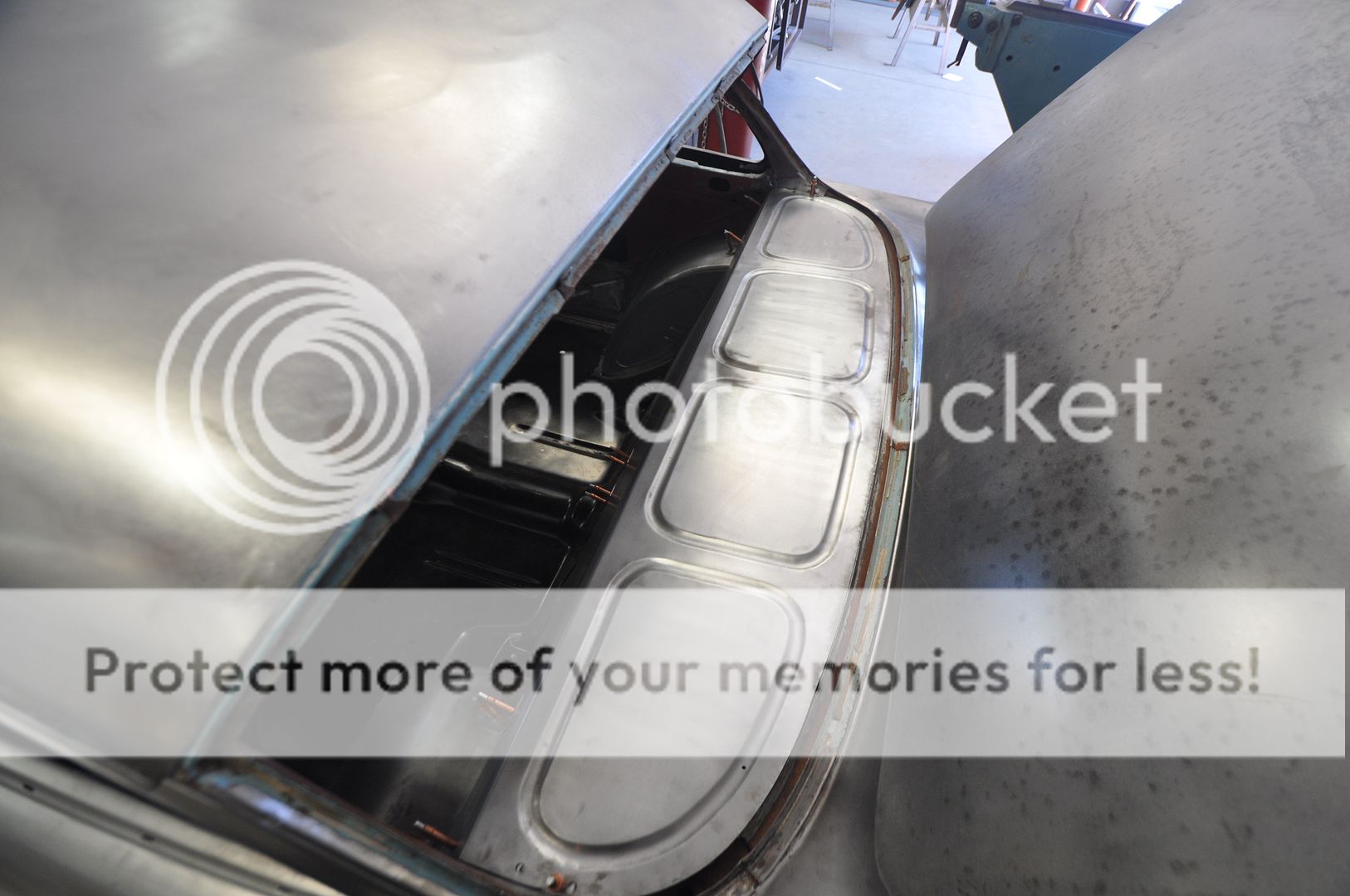

ironworks 06-10-2015 08:33 AM
We are fine tuning the bodywork and trim fit up. The car is coming together nicely.
http://i616.photobucket.com/albums/t...2015%20005.jpg
http://i616.photobucket.com/albums/t...2015%20006.jpg
We are trying to fix a few issues like these. This crap makes me loose sleep at night.

dhutton 06-10-2015 09:04 AM
Are you talking about the consistency of the gap or am I missing the obvious? I thought you had gap spray on hand to get your perfect gaps dialed in? :D
Don
ironworks 06-10-2015 09:28 AM
Don
The gap on the trim is at a different angle then the hood line. Its a factory issue. But it still bugs me to no end.
The consistency also bugs me.
dhutton 06-10-2015 09:46 AM
I think the angle on the trim is determined by the draft angles of the casting. Not too much that can be done to avoid that sort of thing unless you modify and replate it.

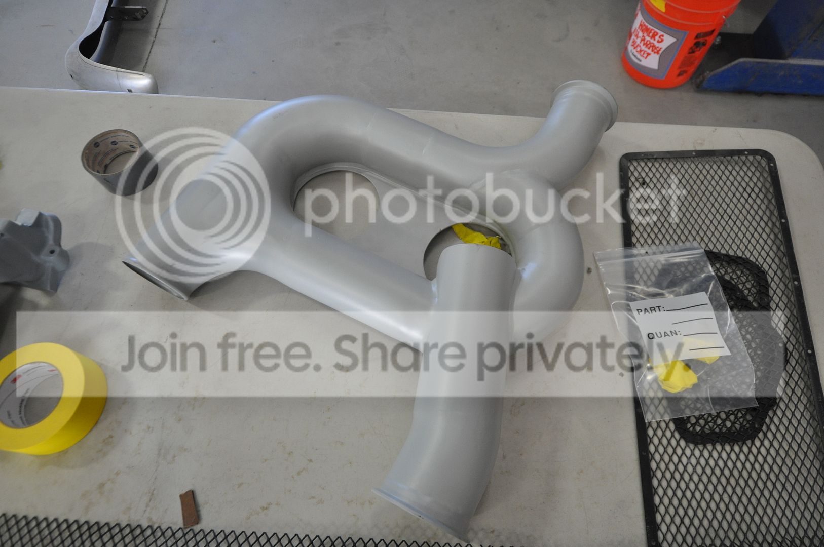

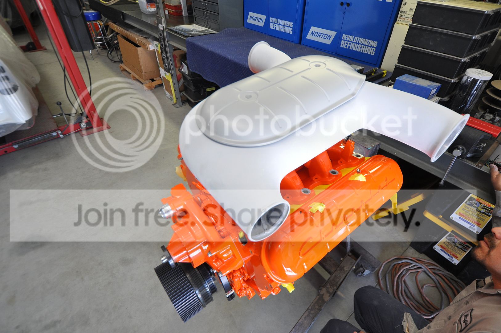

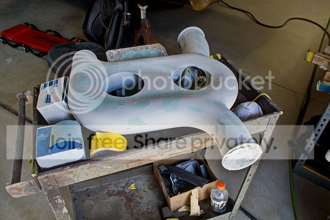

ironworks 06-15-2015 05:55 AM
I have had a few inquiries as to how we went about painting the engine and the aluminum parts like the radiator.
With the radiator and aluminum parts we typically send out the part to be powder coated with some kind of primer. This way they blast the tanks or aluminum parts and then coat the aluminum parts with a primer that is baked on. We have found this to work the best. The obviously don't blast the fins of those come back still clean. But you can do the surround and the tanks on things like radiators, and AC condensors. We also do it on anything smooth that is aluminum as we feel the "BITE" of the primer is better with the blasting and heat for the part with primer. We then stack any needed body work on top. Here are some parts we had blasted and primed that I have pictures of.
http://i616.photobucket.com/albums/t...2015%20009.jpg
Here it is with body work on a 2nd coat of epoxy primer. We are letting the body fill dry before sanding.
http://i616.photobucket.com/albums/t...uction-01l.jpg
You can see the top billet aluminum piece in primer. We really shouldn't have any body work on a billet part.
Now the unpainted fins of the Condensor or Radiator in this project will get sprayed with Krylon to keep the cooling capacity to the highest level with the thickest paint. I had a guy at a radiator shop once tell me they cool better in black spray paint, not sure I believe him. But there is nothing worse then seeing aluminum fins through the grille opening of a car.
Now the engine and manifold parts go through the long deburring process. They are then shot in epoxy primer. The primer is given a good couple days to fully dry and since we are not body working the engine we shoot a minimum coat of sealer and the regular base coat clear. And really just enough to cover the engine.
http://i616.photobucket.com/albums/t...2015%20001.jpg
I help that answers your questions.
